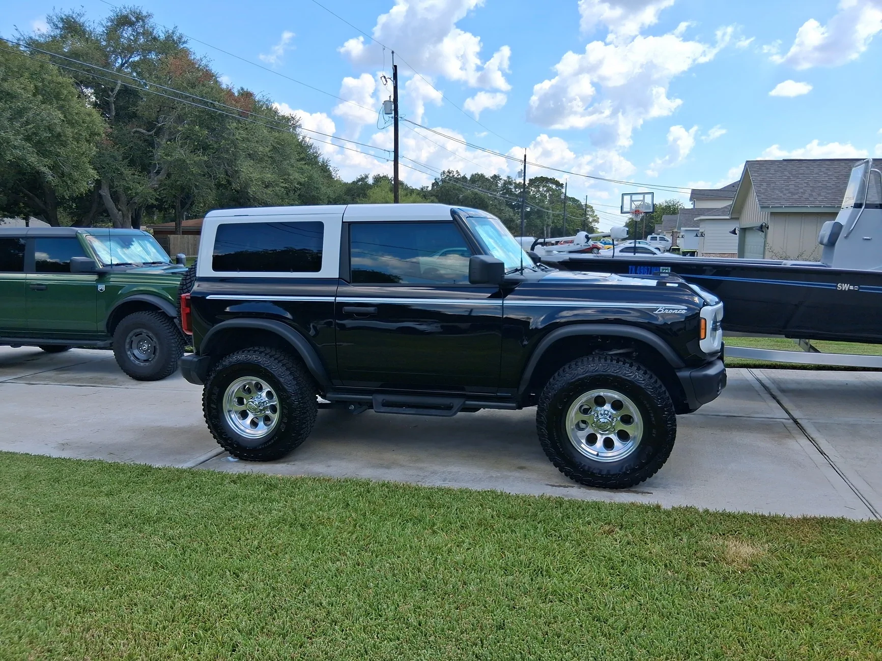

A 17x9 with 0 offset will work with no issues. The picture below is my wife's Heritage Edition with Ion Alloy 171. They are for sale since we just upgraded to Fuel Wheels and 37s.
