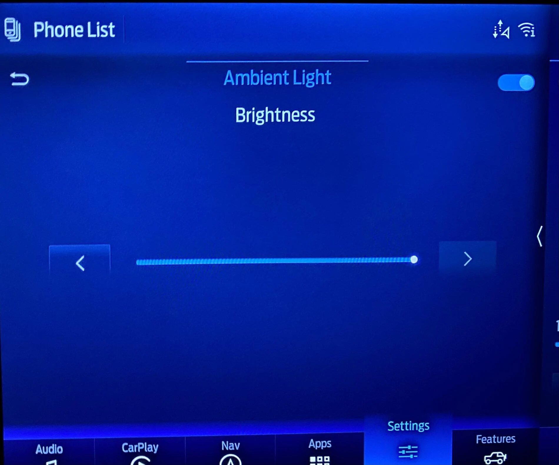

The Factory ambient lighting brightness can be adjusted on the touch screen. Mine was set to the lowest setting when I got it. It also looks like your rear dome light is not on. Here is mine and I have it set about a little over a quarter way on the slider.
Yep this is what I was hinting at.Mine were so obnoxiously bright I had to turn them down.

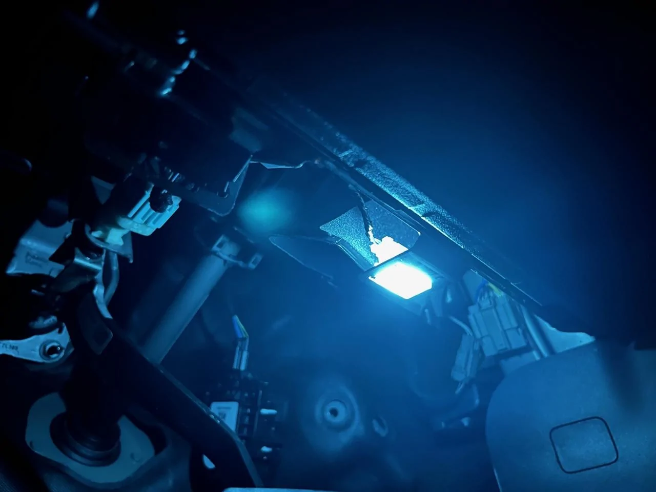

Ford Bronco Adding interior LED ambient lighting (now with working photos!) IMG_4159
The actual light is just a little guy:
Ford Bronco Adding interior LED ambient lighting (now with working photos!) IMG_4163

Mine is all the way up and it doesn't appear that bright. You have some surrounding light outside the vehicle and I pretty much took it in a dark garage. Hard to tell in the picture but it is not real bright.
You think one could replace it with a different color LED?

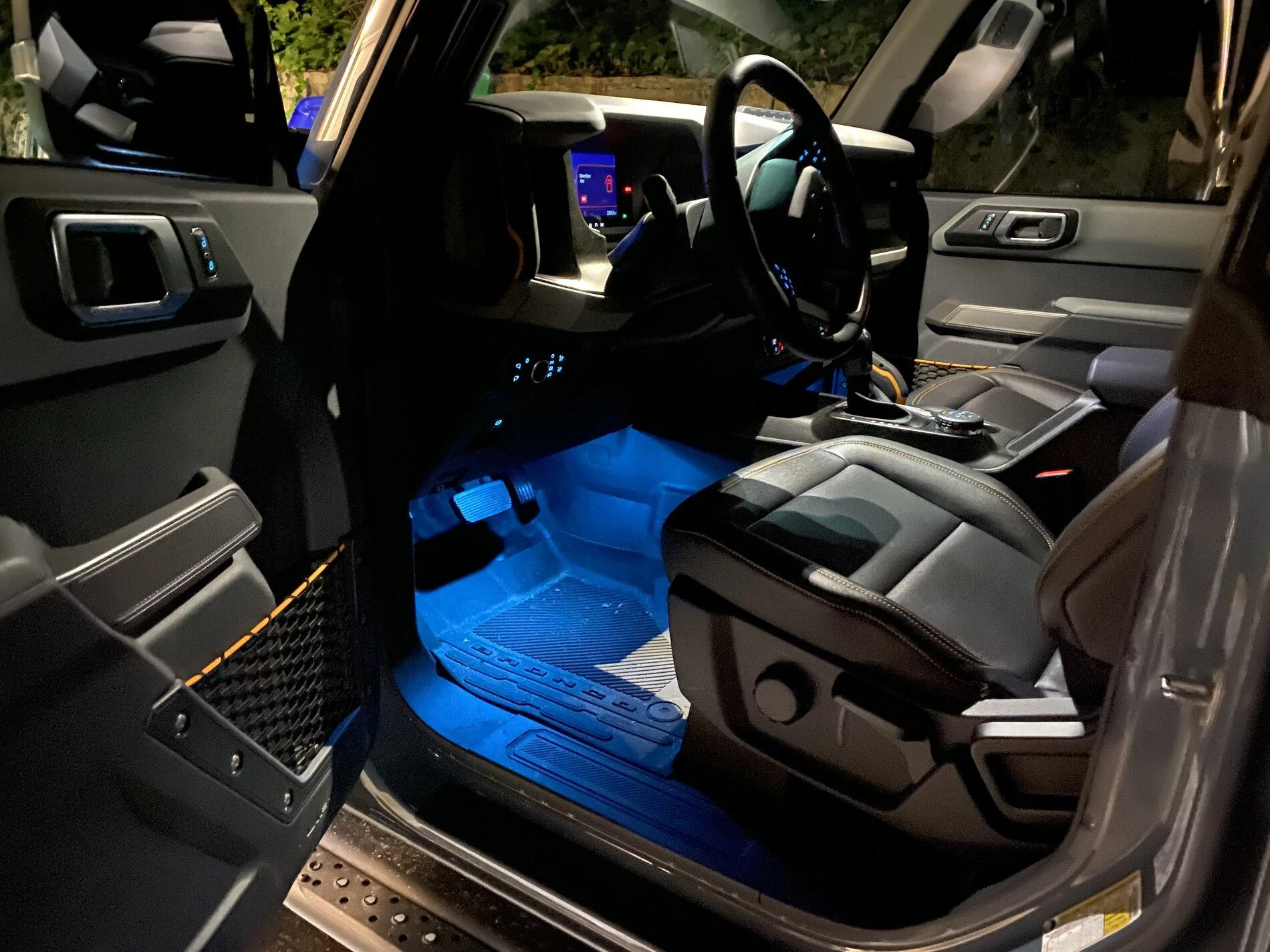

Its on, but very dim. I'm going to check it out tonight when it gets dark and see if maybe the bulb/LED is bad. It puts out light, but nowhere near some of these people are getting.
With that said, the LED install is still totally worth it. Not pictured is me driving down the road with a full disco going on in my back seat. The LED lights I used also go CRAZY bright, which is really handy when off-roading/camping.
Ford Bronco Adding interior LED ambient lighting (now with working photos!) 20211105_181516
Ford Bronco Adding interior LED ambient lighting (now with working photos!) 20211105_181528

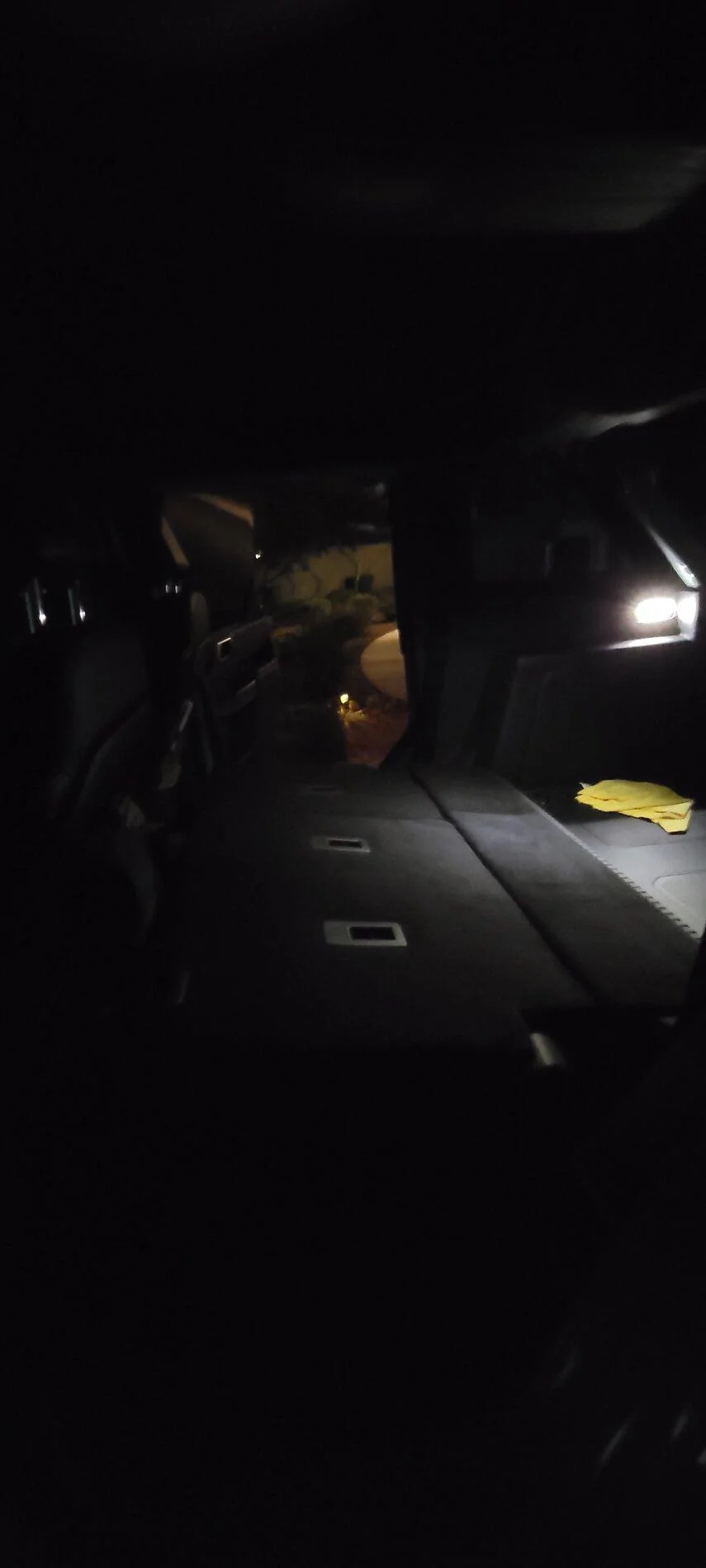

You can see the rear light and ambient light on.. it really is that dark.

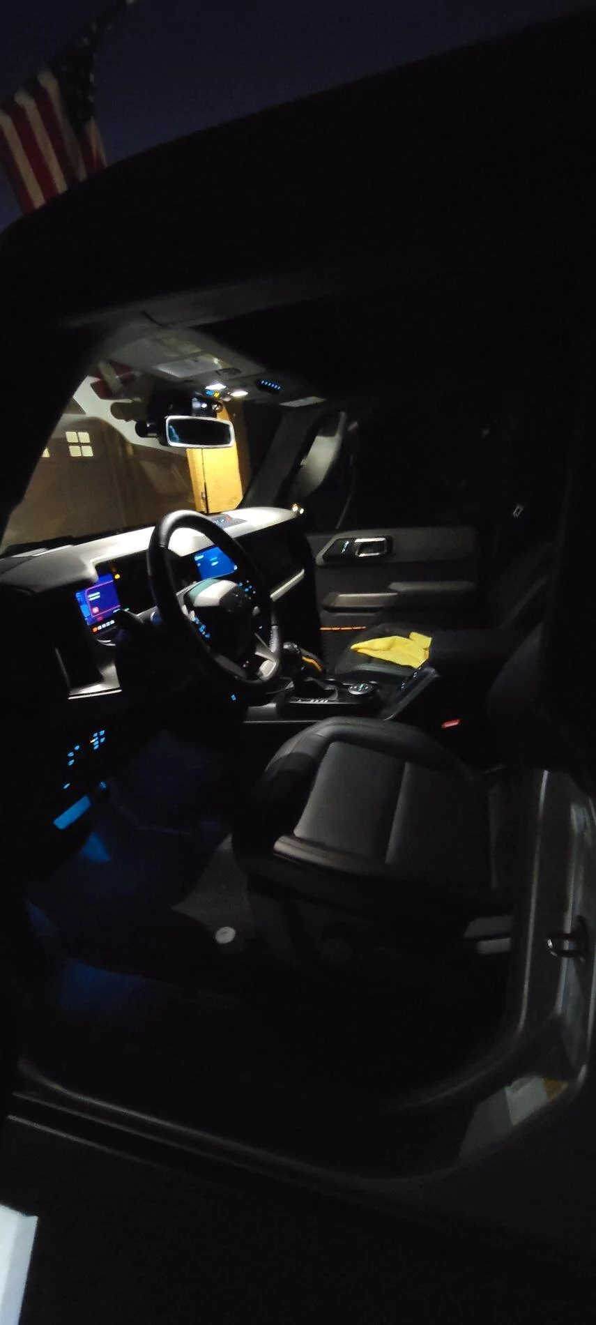

Ford Bronco Adding interior LED ambient lighting (now with working photos!) 20211105_182011
This is the same setup with the seats folded. You can see that all the lights are on..
Ford Bronco Adding interior LED ambient lighting (now with working photos!) 20211105_182457

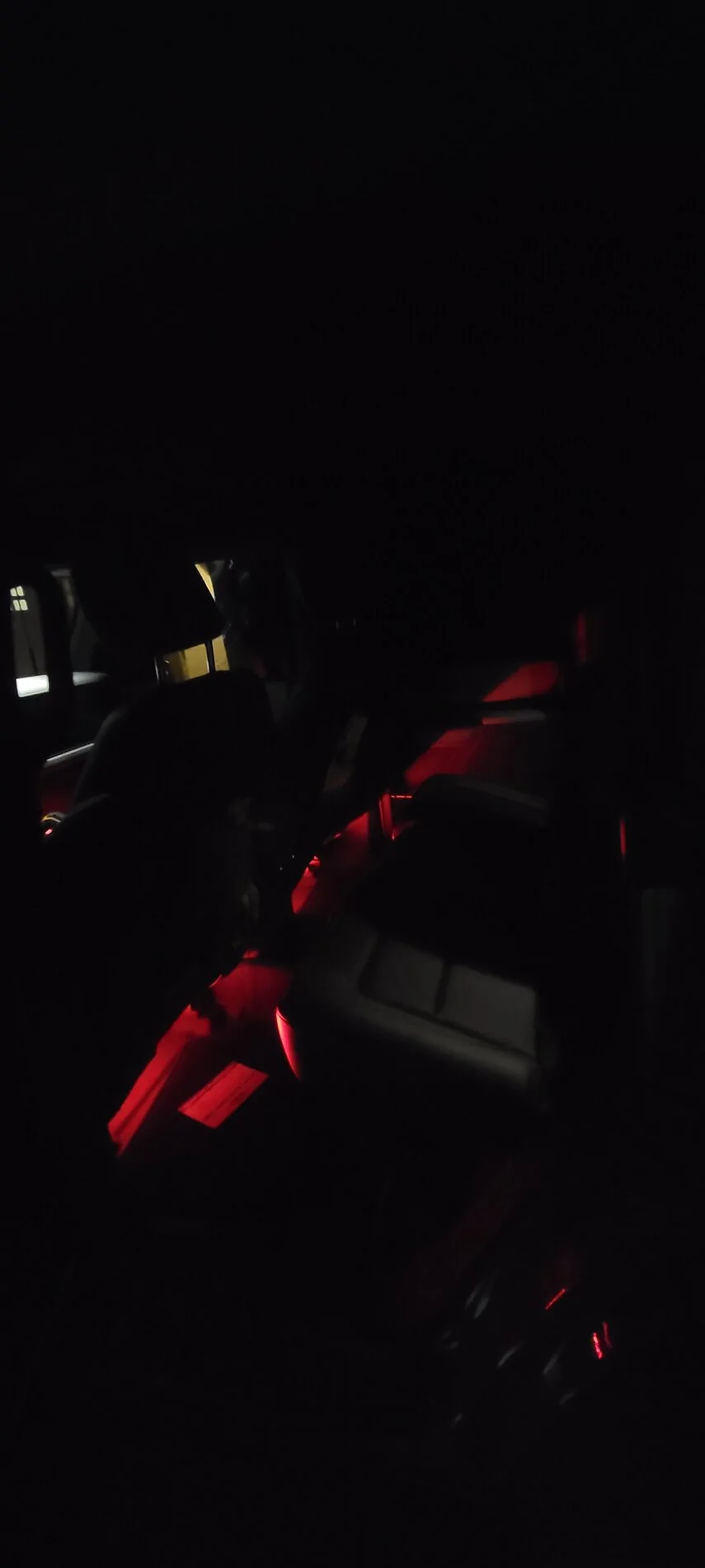

Even with the red I usually have on at night (doesn't hurt night vision), you can actually see your stuff in the back instead of having to bust out my flashlight.

In these pictures your dome light is not on.
If by dome light you mean the small light on the cross pillar, I assure you it is. It's just pointless.

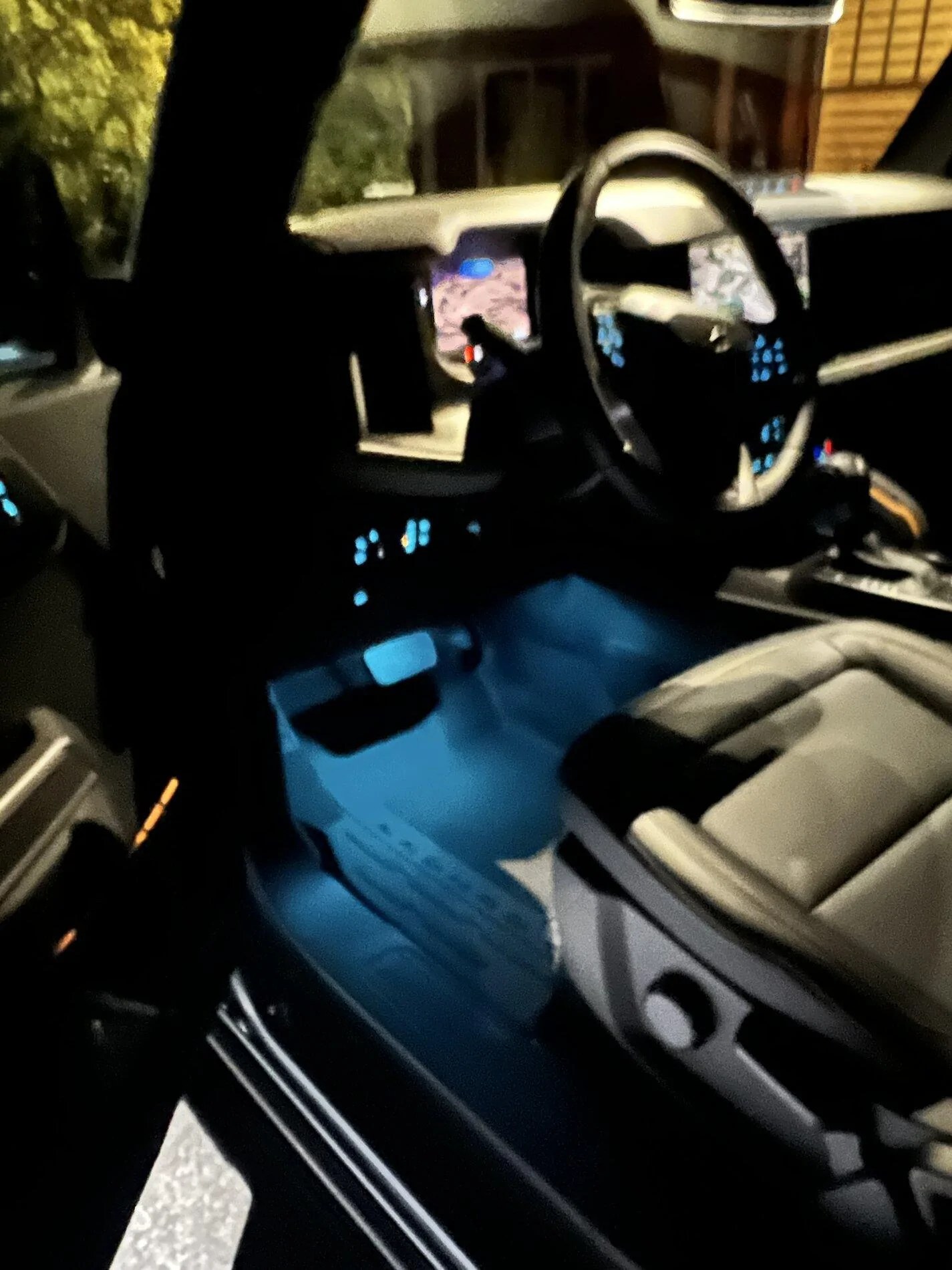

Ford Bronco Adding interior LED ambient lighting (now with working photos!) 20211105_190538
Something is wrong. I agree the interior is dark because of all the black but my dome light is blinding!
