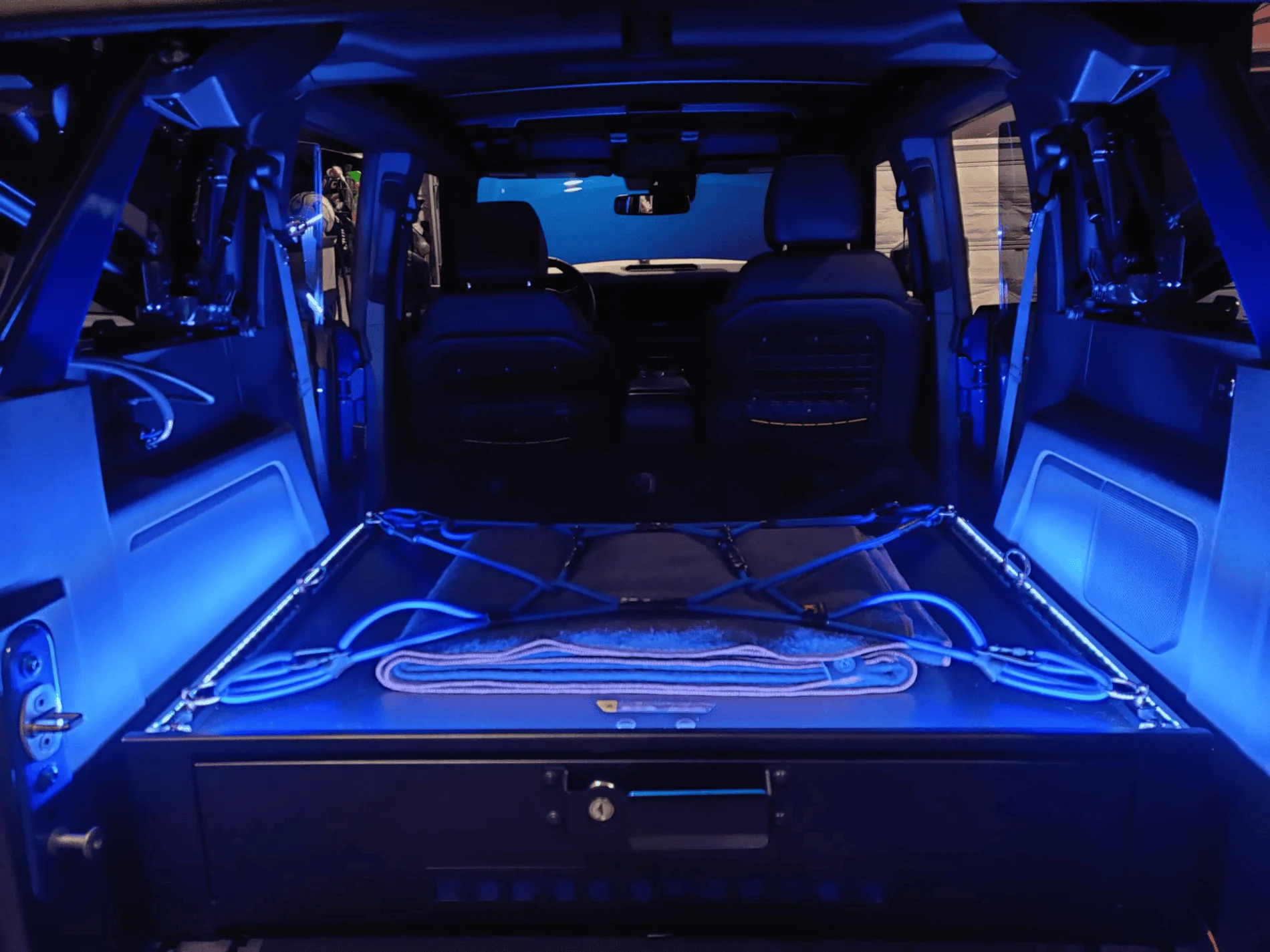

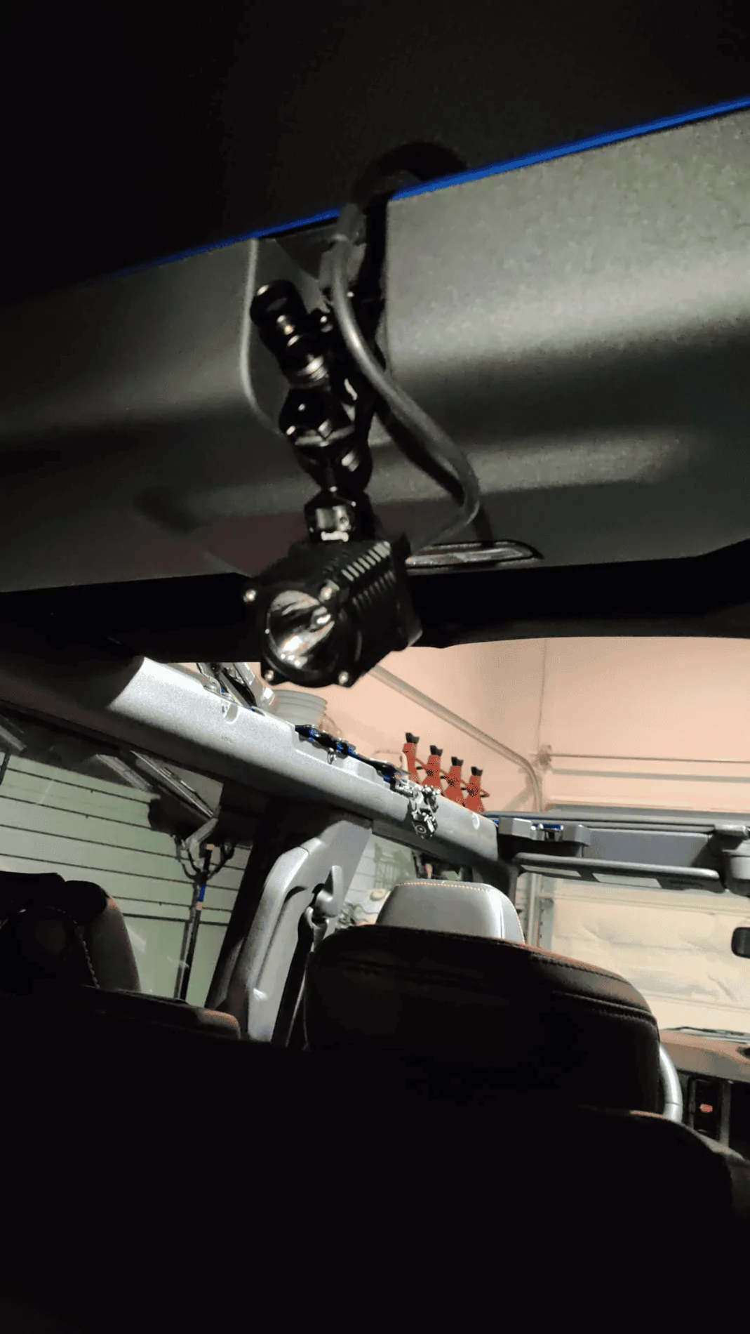

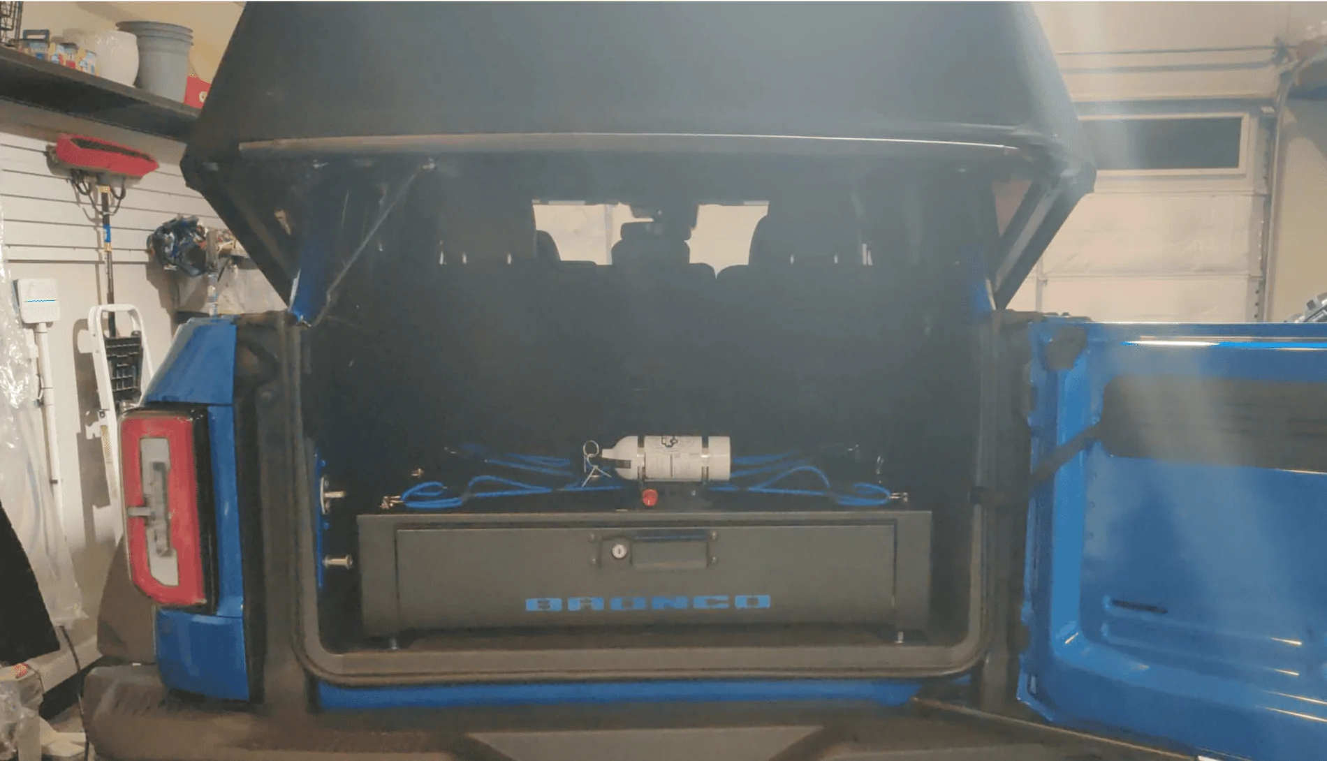

Yeah, I too was not a fan of how dark it was when I got my Bronco a week and a half ago - it was the first thing I noticed having had my first drive in it at night, so after I installed the pile of parts that was awaiting it's arrival, I further modified my cargo box and added some LEDs to it to light things up a bit in the cargo area. I then decided to add a mini work light that I could use for either cooking on the tailgate table (still waiting for that) or that the rear passengers could use for a 'map light'. Here's a few pics:
Ford Bronco Adding interior LED ambient lighting (now with working photos!) 1636169703594
These come on when the rear door opens and had a 55 second 'off delay', or via an RF controlled relay. They appear to be blue, but the lights are white.

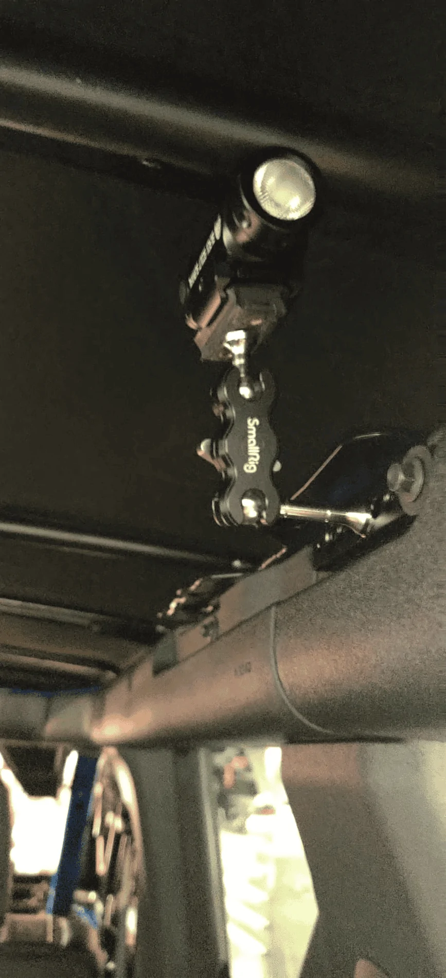

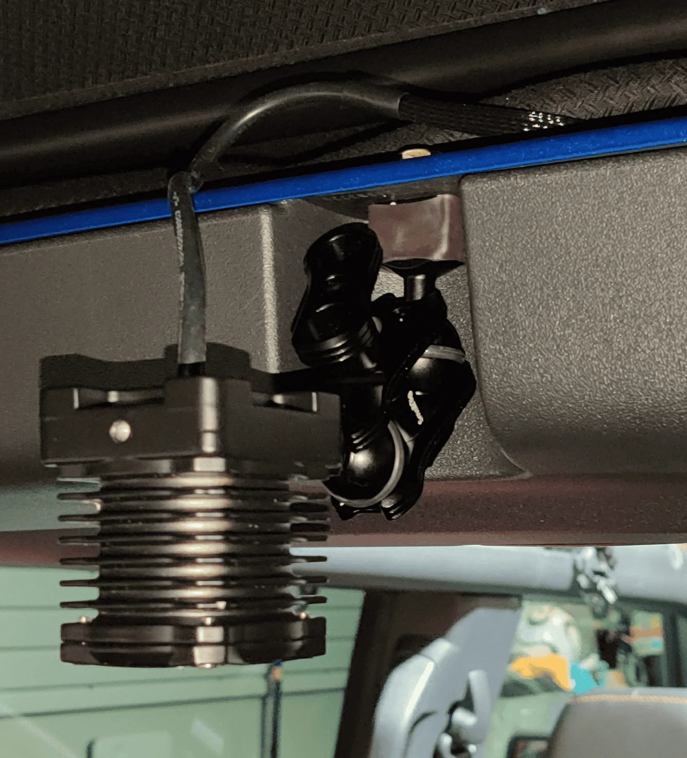

The work light only comes on via the RF controlled (keychain remote) relay, and since it's on a double ball mount it's pretty flexible as to where it can be aimed.

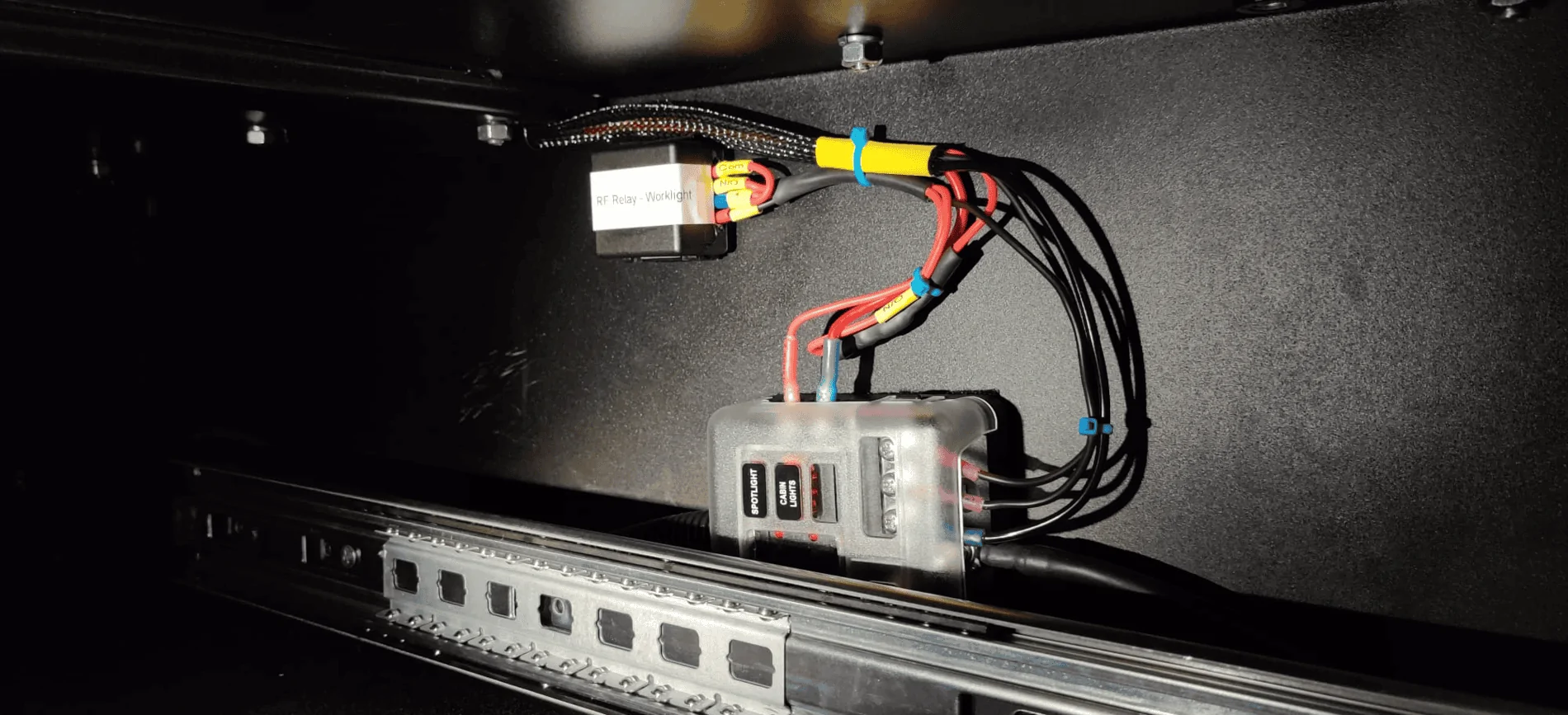

I ended up running an 8 AWG cable from the battery to a separate fuse box that's hidden inside of the cargo box to power this and future items:

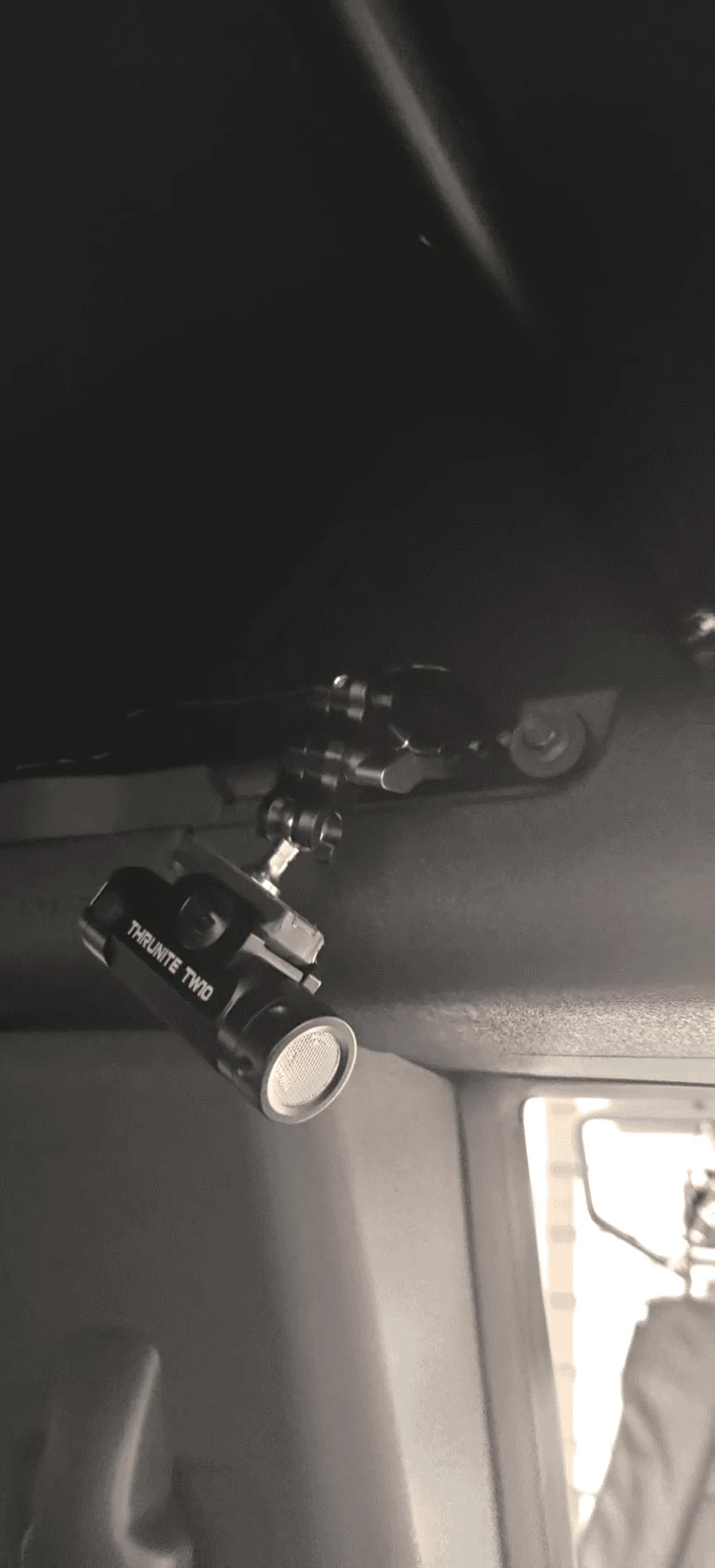

But then I felt that the front needed better map lights, so I added a couple of these (I'm a fan of ThruNite flashlights) to the front that charge with USB-C as needed:
Ford Bronco Adding interior LED ambient lighting (now with working photos!) 1636169457658
It can fold up / out of the way when not in use:
Ford Bronco Adding interior LED ambient lighting (now with working photos!) 1636169535632
Those are just some weapons lights mounted to a mini picatinny rail that's on a double ball mount used for cameras. Works pretty well and easy to remove for securing.

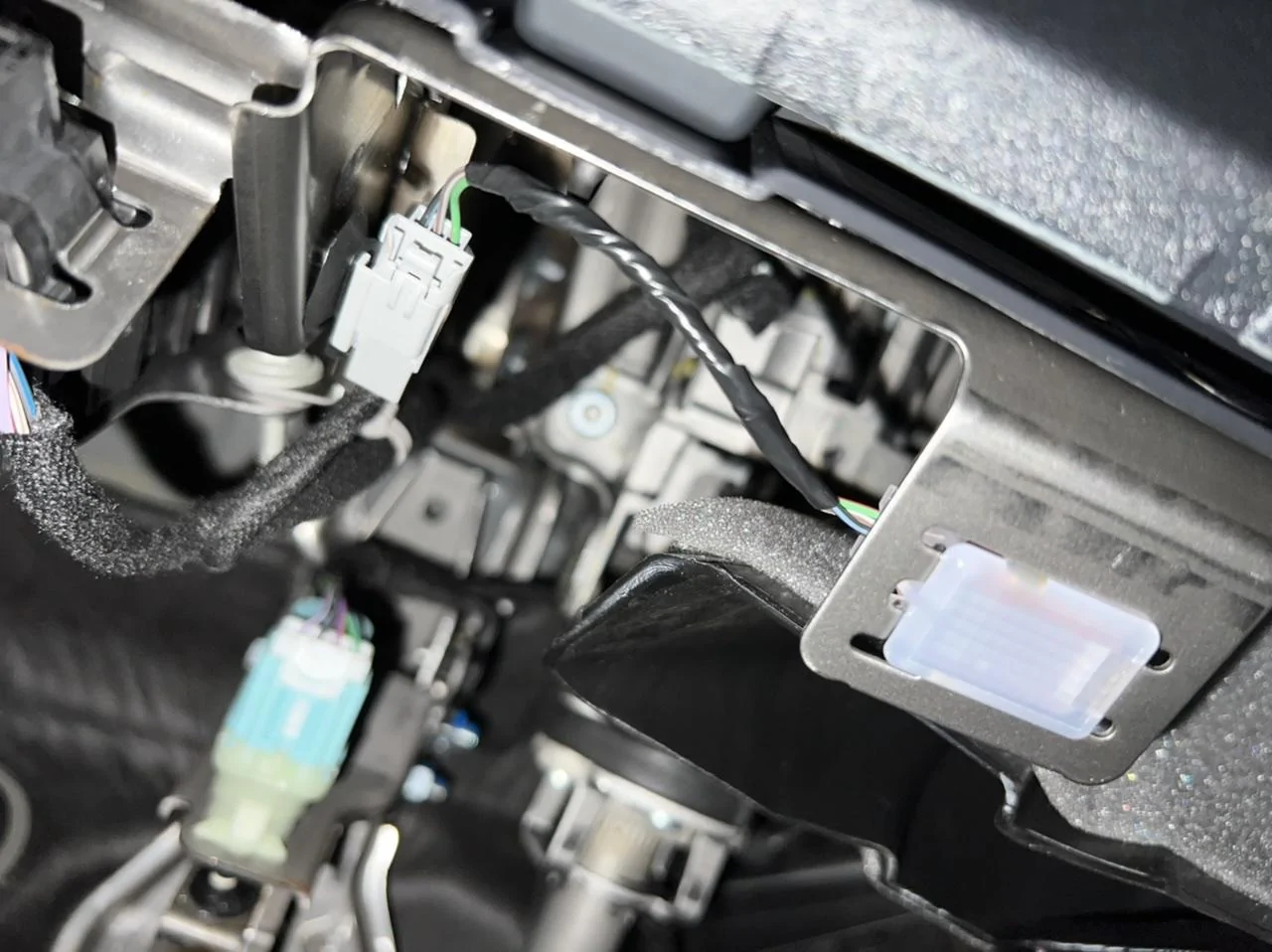

You think one could replace it with a different color LED?
Beyond my skill set. There is a plug 6 inches away and three leads. More going on with these little lights than the hot and ground in my ‘75s courtesy lights.

This is SUPER clean man. Great job, it's given me some ideas.

@Theherofails I don't Know if it is possible, but it looks like you light was assembled or installed backwards. where the reflector is angled towards teh cargo area instead of the back seat.
