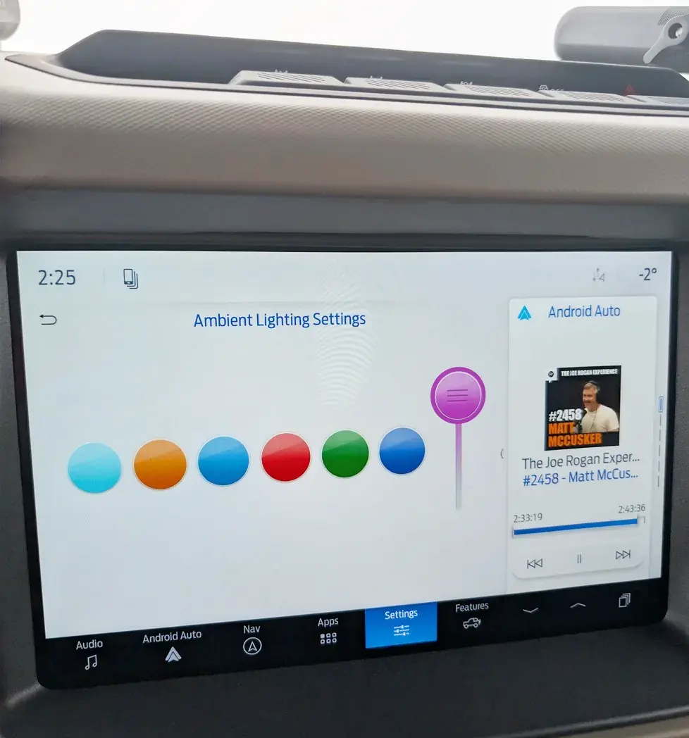

Also, behind the center armrest (for rear passengers) there is a lighting module there as well....not sure if 4 doors had this in previous years?
This should make upgrading older MY Bronco's easier with direct replacement part numbers now...

The 2025 has the same screen for ambient lighting. I think it only controls the lights by your feet.
Oh? First I've heard of it for 25's
(Ambient lighting is only in the foot wells AFAIK)
Does it have a lighted cup holder? Trying to adapt the suggested most similar model I couldnt ever get it to work. So definitely would buy a replacement holder specific to Bronco
Nope...maybe for 2027 lol

I have a 25 and right now I have them set for Orange. I wish it would do more lights as everything else is still the blue color. And I think the orange only comes on after you get in, When you first open the doors it is blue-white color. The 25 got the full digital dash and the 12" screen standard, Ambient lighting was part of all those changes.
