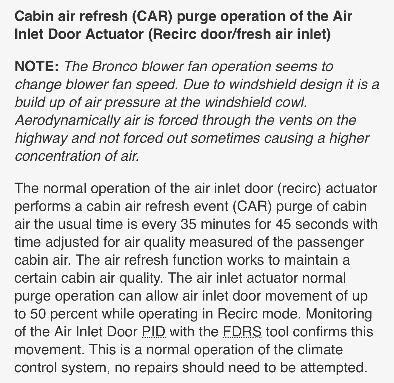

The air inlet door will very often stay open regardless of what the button is commanding due to a strategy built into the system in order to get fresh air into the cabin. Not sure if this is what you were experiencing at the time, but it’s normal.
Ford Bronco AC recirculate door sticks open IMG_1537
The time interval they have listed doesn’t really match what mine seems to do. I can tell it opens usually around 45 minutes into a drive, then it never really seems to close after that 🤷‍♂️
Not sure where you got that info from.
My owner's manual says:
"Press the button to recirculate air currently in the passenger compartment.
Note: Recirculated air may turn off automatically or prevent you from switching on in all air flow modes except MAX A/C to reduce the risk of fogging. Recirculation may also turn on and off automatically in various air distribution control combinations to improve heating or cooling efficiency."
Ford's description (above) in my manual is very confounding. That said, when my recirculating door is open, it stays open forever and I am unable to close it at any time under any circumstances.
What I posted is out of Ford’s workshop/service manual.
