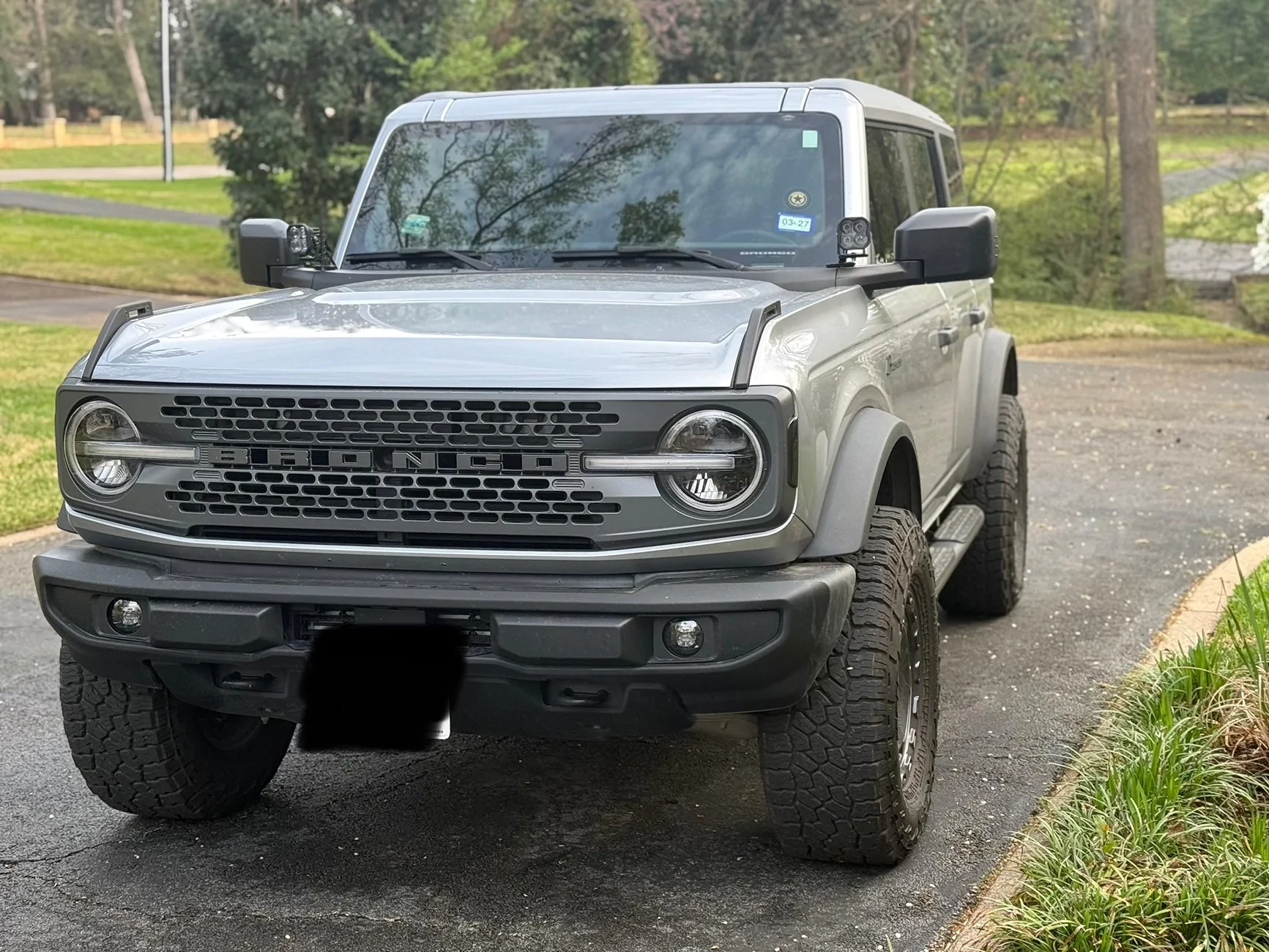

For reference, I have 24 BB 4 door non Sasquatch. I swapped to the Everglades wheels which are +30 offset, and I’m running 285/70r17 falken wikdpeaks. With my standard flares my 285s have about a half inch of poke or so. This is the best pic I have. So with +6 and 12.50s you’ll have about 36.7mm more “poke” than me which is 1.4 inches. So you’ll have around 2 inches of poke.

Thank you so much for the information guys and your rig looks awesome
