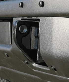

Not saying this is the reason or contributing cause, but people REALLY need to think about which alphabet soup bullshit product brands from China they are willing to bet their lives on. There's a metric ton of cheap untested recovery gear from bumpers to winches, to ropes and shackles floating around Amazon. Here's a smattering of manufacturers from a random search on Amazon.
Ford Bronco My soft shackle failure experience 🤕 -- The Off-Road Recovery That Almost Killed Me alphabetsoupbullshit
