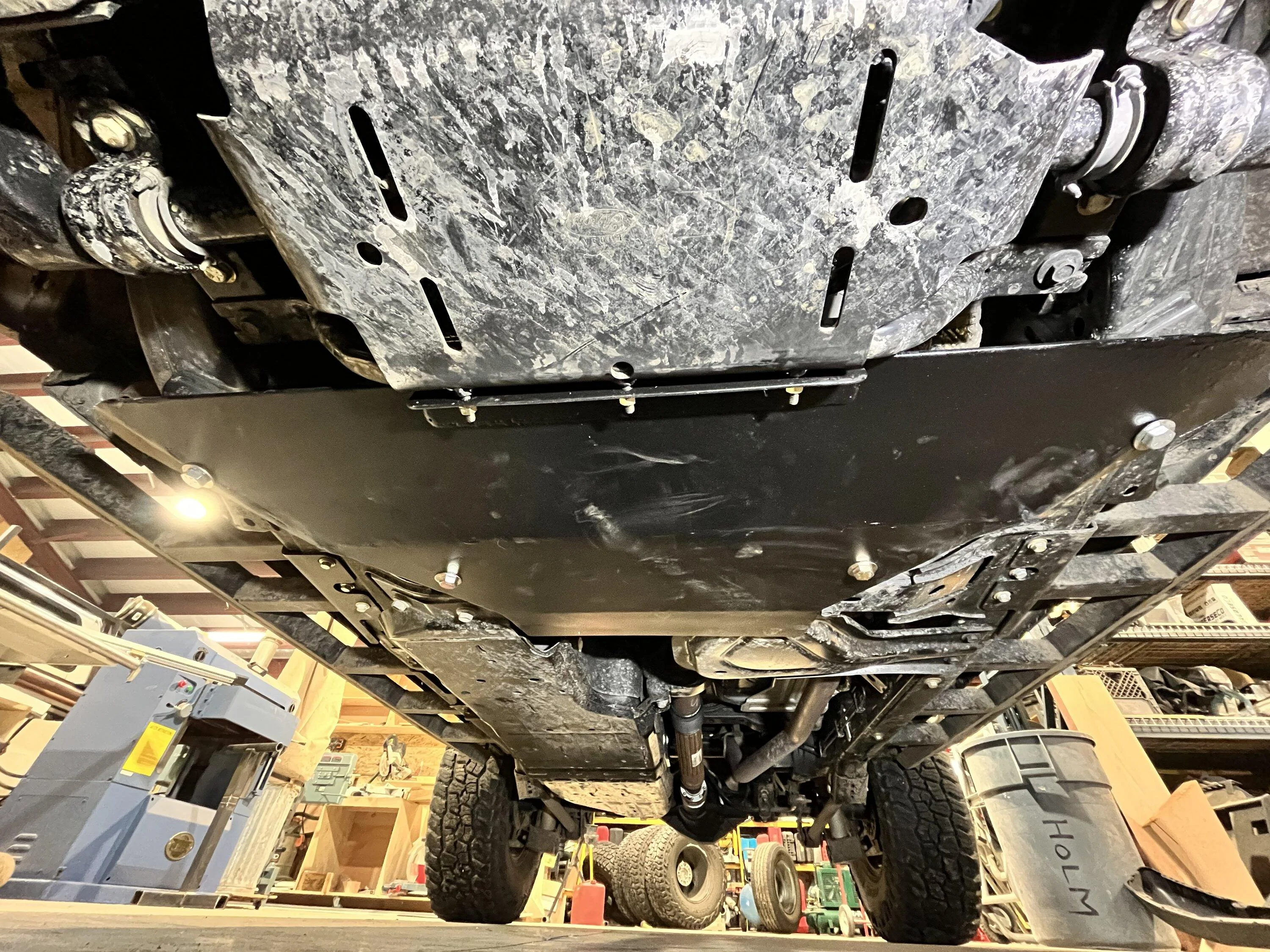

Well I’m cheap and I really needed a transmission skid. I figured that I could make my own cheaper than buying a skid, I have a Badlands so there are already the stock skids on the rig. I decided to start with the trans skid since there is not one and I plan on building the engine and transfer case skid next. My rig has the two cross bars so I decided to mount directly to those bars. I also have Icon coil overs and with the Icon kit they have you lower the Sway bar disconnect, Which makes the Disco skid plate the lowest point on the rig. This is another project for me to tackle in the future.
Ford Bronco Built my own Skid Plates IMG_2445

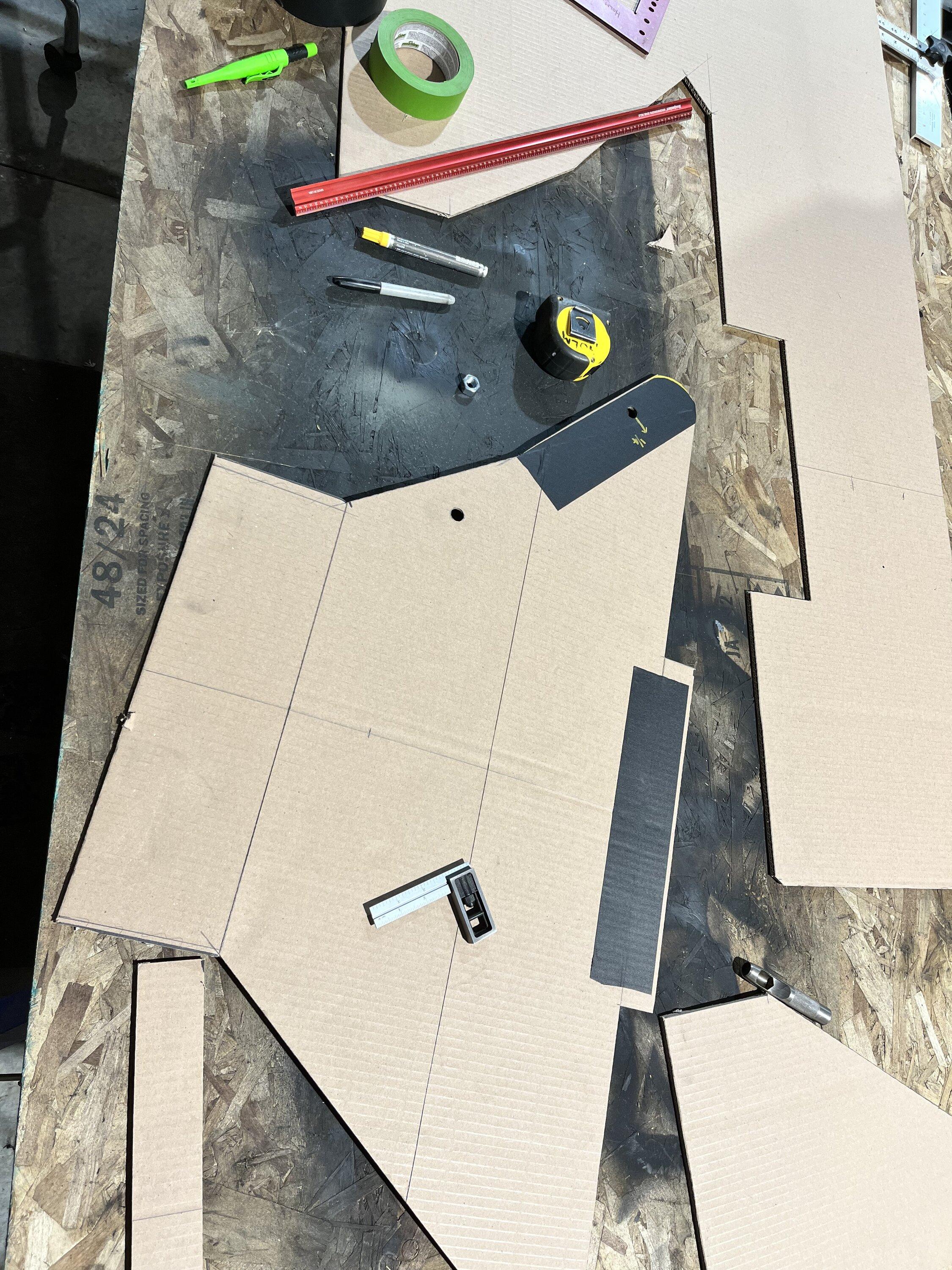

CAD drawing
Ford Bronco Built my own Skid Plates IMG_2449

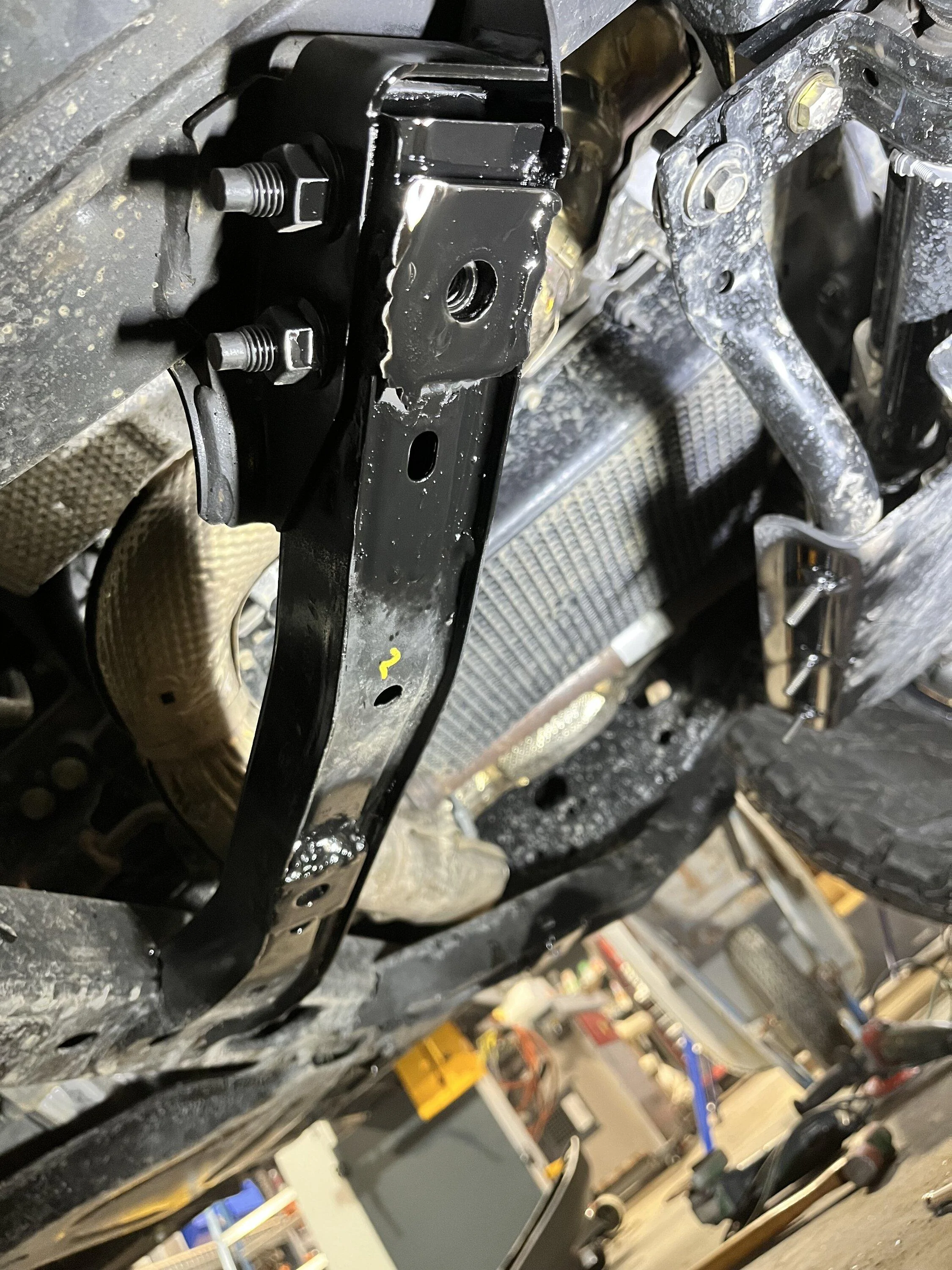

I added bolt plates to the cross arms
Ford Bronco Built my own Skid Plates IMG_2453

Nicely done (y)

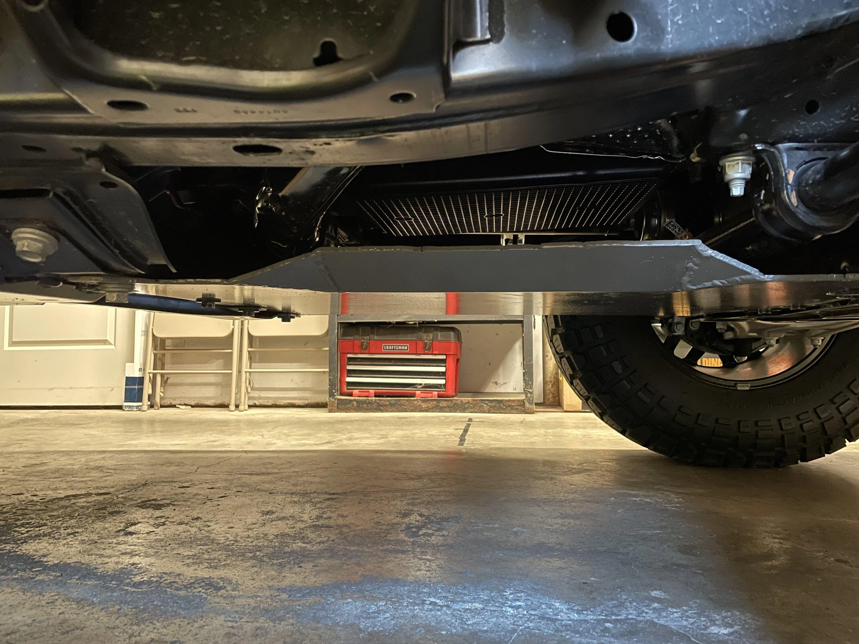

I couldn’t agree more and also made my transmission skid. It’s hard to pay hundreds when they can be built with much less money and some time. may not be as pretty, but I know when I smash a rock, it won’t hurt my feelings as much. I went 3/16” and its heavy.
Ford Bronco Built my own Skid Plates IMG_4690
Ford Bronco Built my own Skid Plates IMG_4692

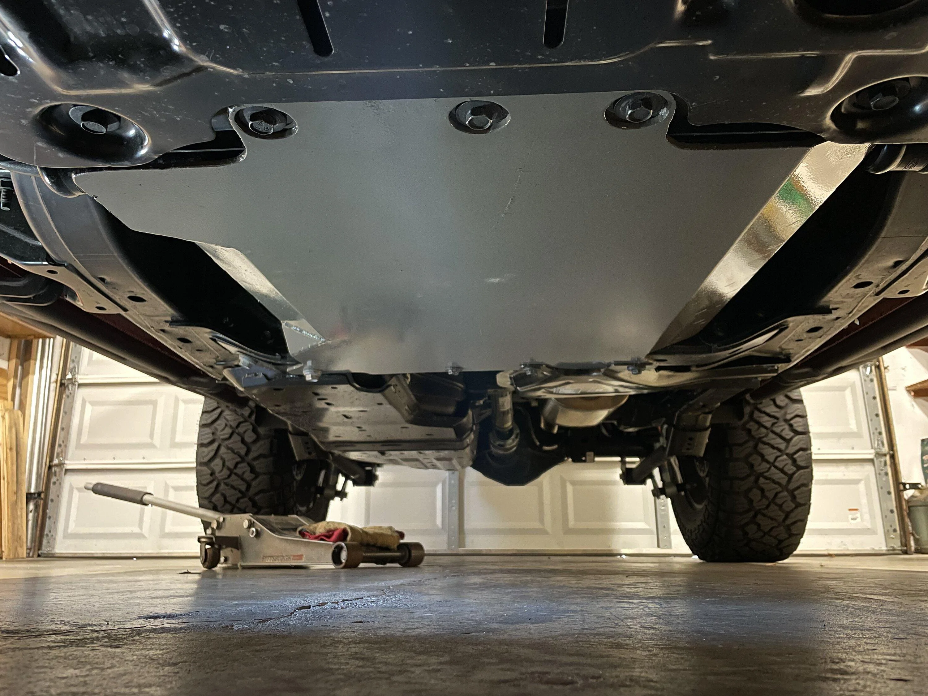

I'm about to do version 2.0 on mine and definitely see some areas of improvement with my quite rudimentary 1st go at it.
1st version was a simple plasma-burned flat plate. Adding some angled plates, stiffeners, and some recessed hardware definitely is an upgrade.
