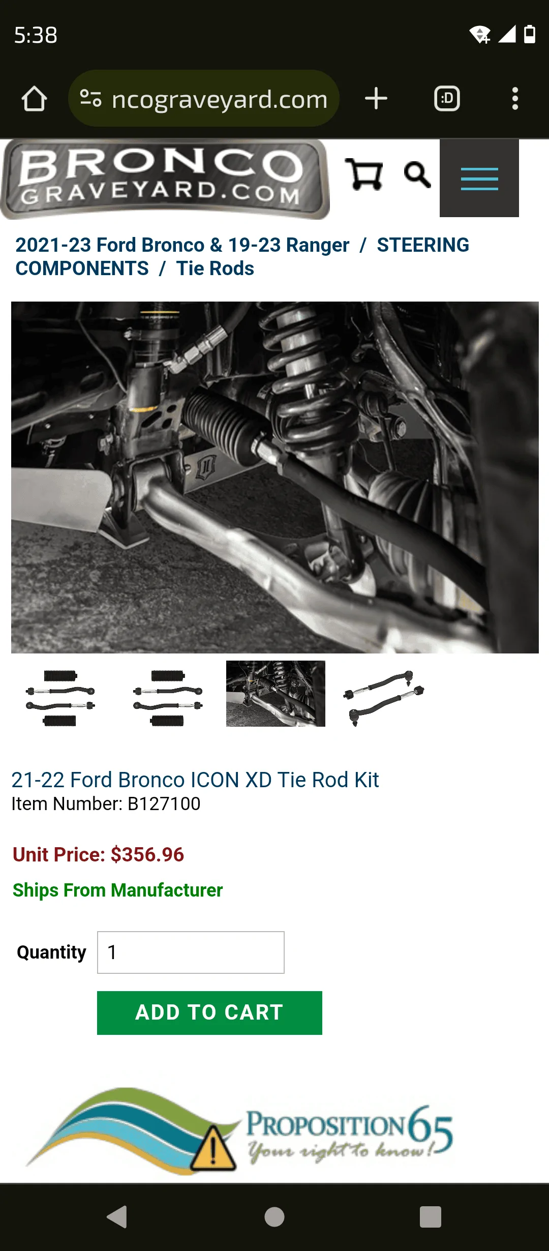

You can't blame the Icon boots, someone failed to put the tie rod side boot clamps on. Water freezes, water in the rack will freeze. Self inflicted.
I just looked at this exact aftermarket part on Jeff's bronco graveyard. The picture shows the boot with a clamp, hehe. I wouldn't say it's clickbait, but a silly goose move to be sure.
