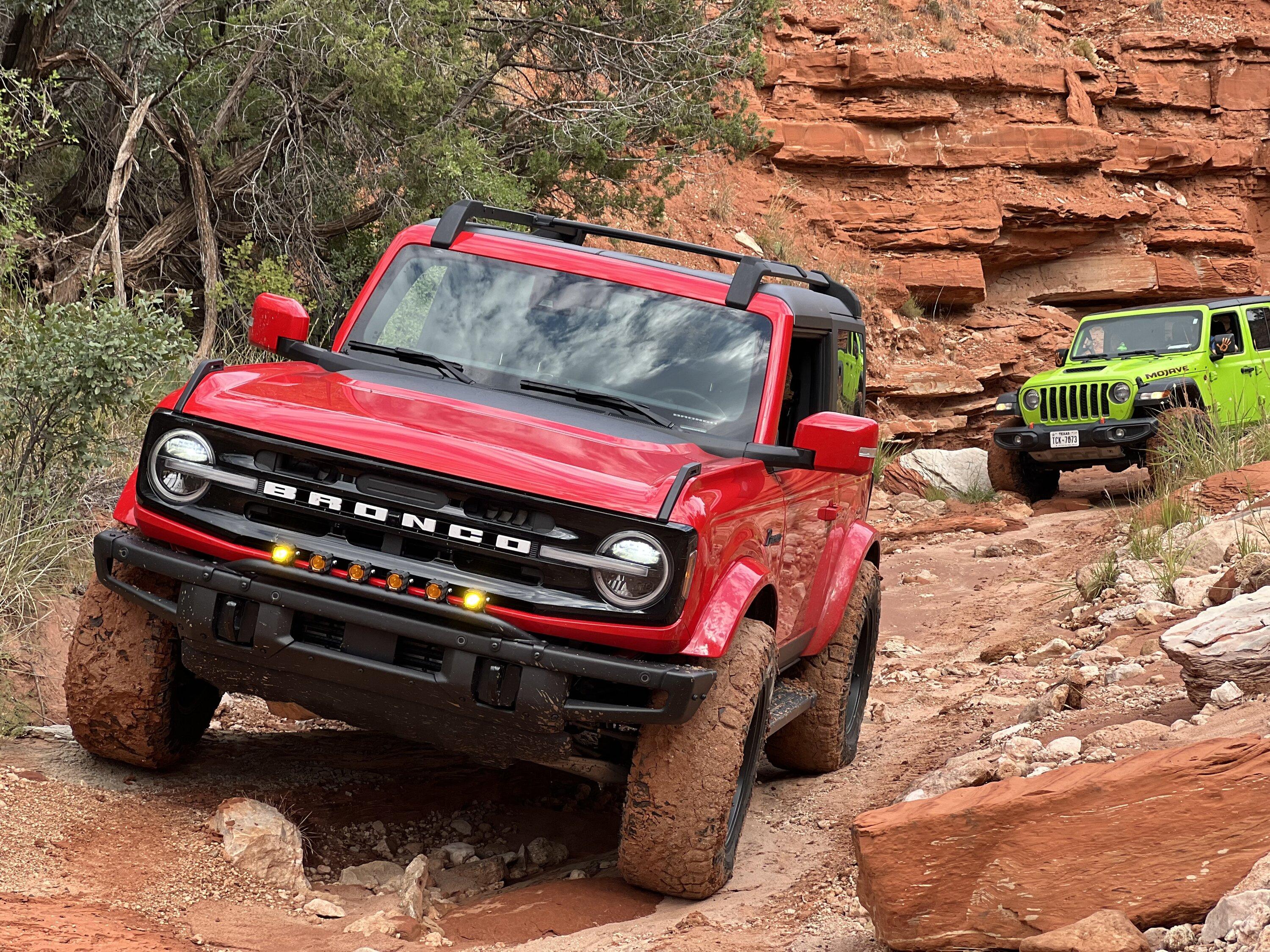

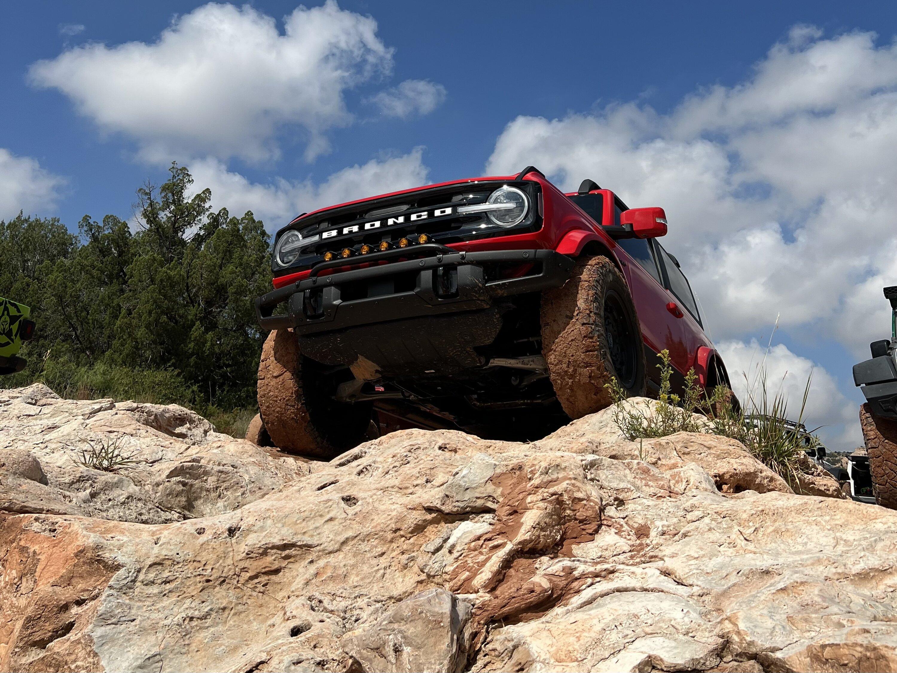

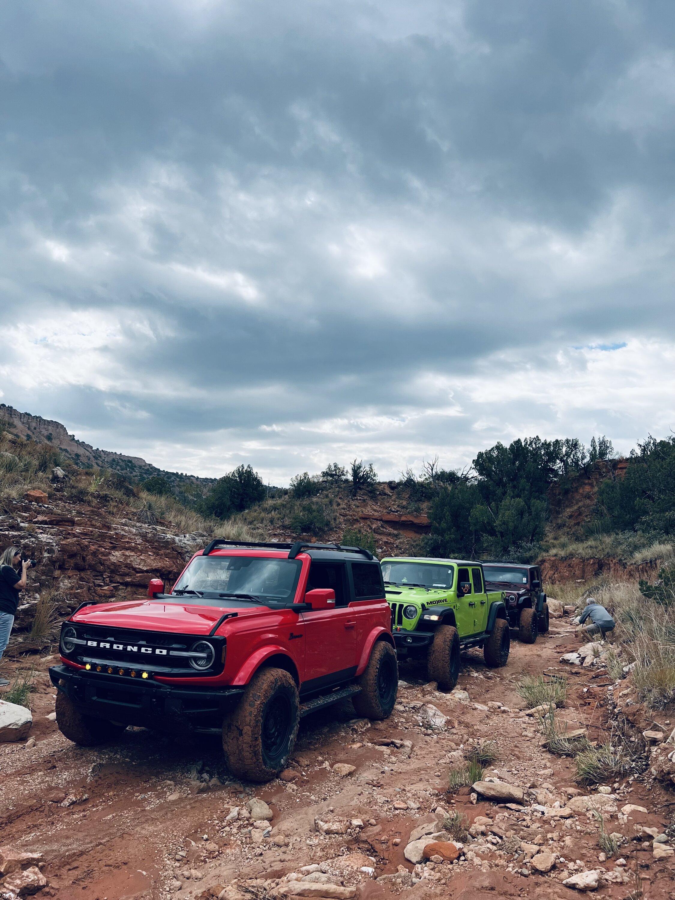

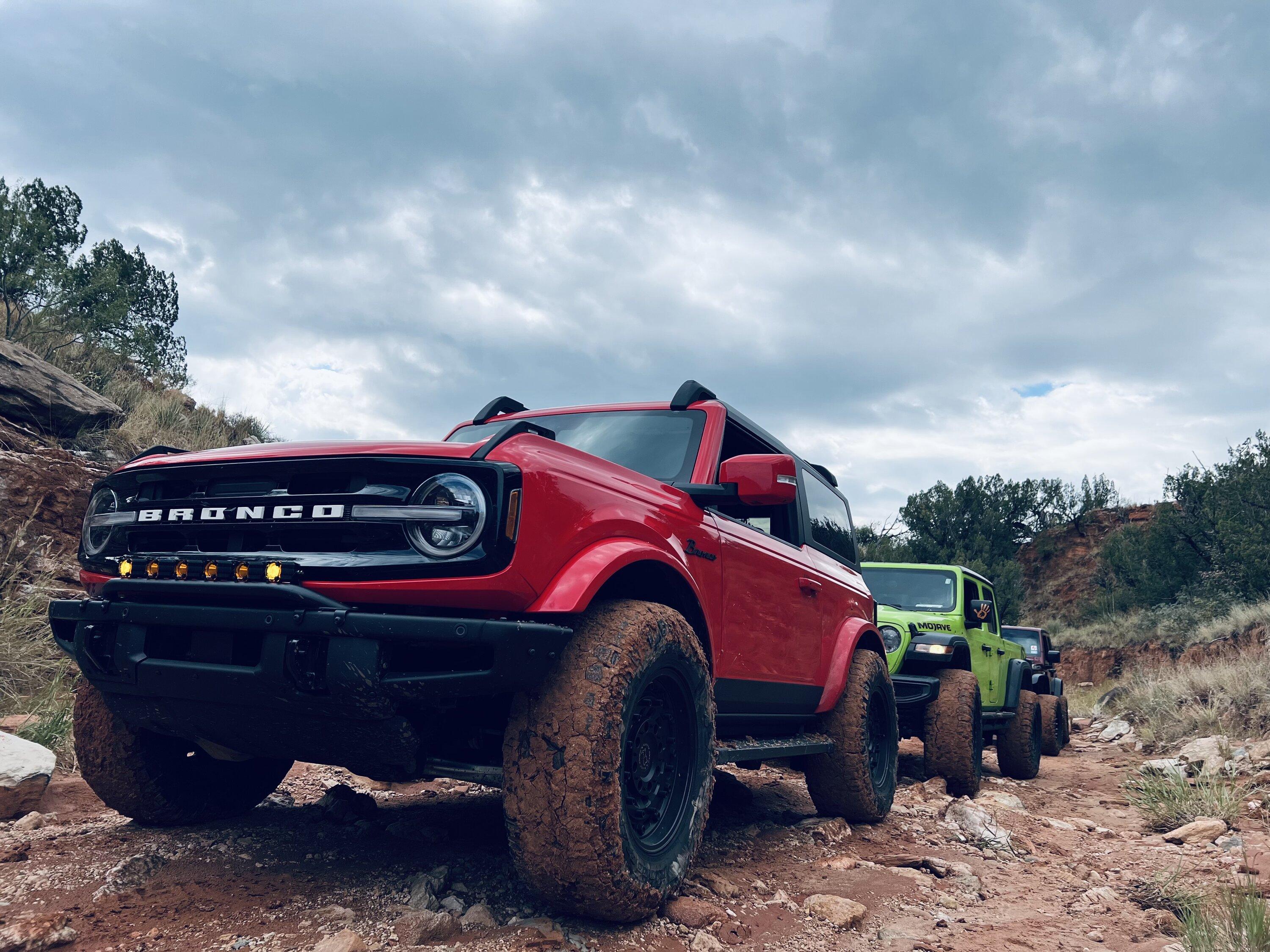

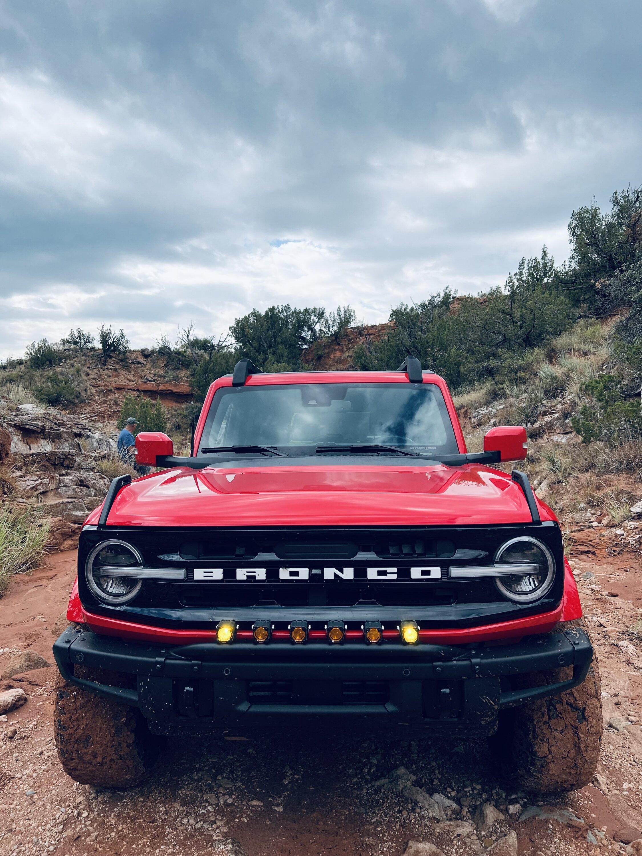

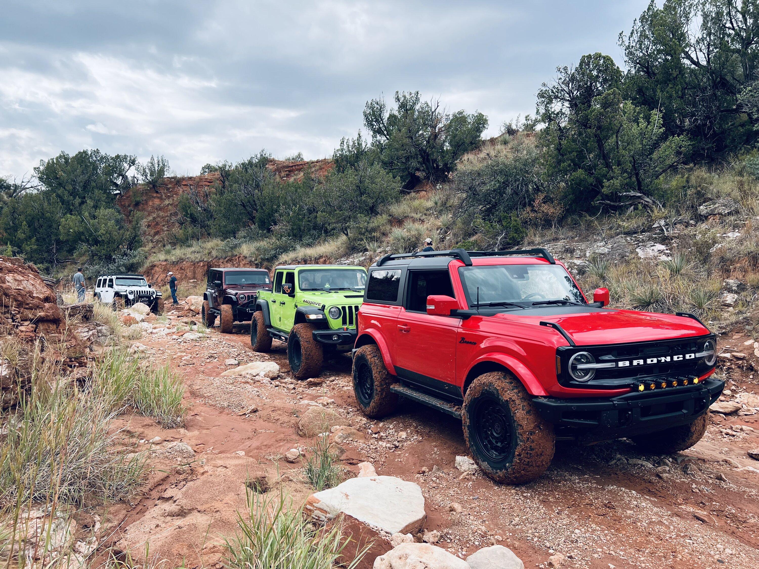

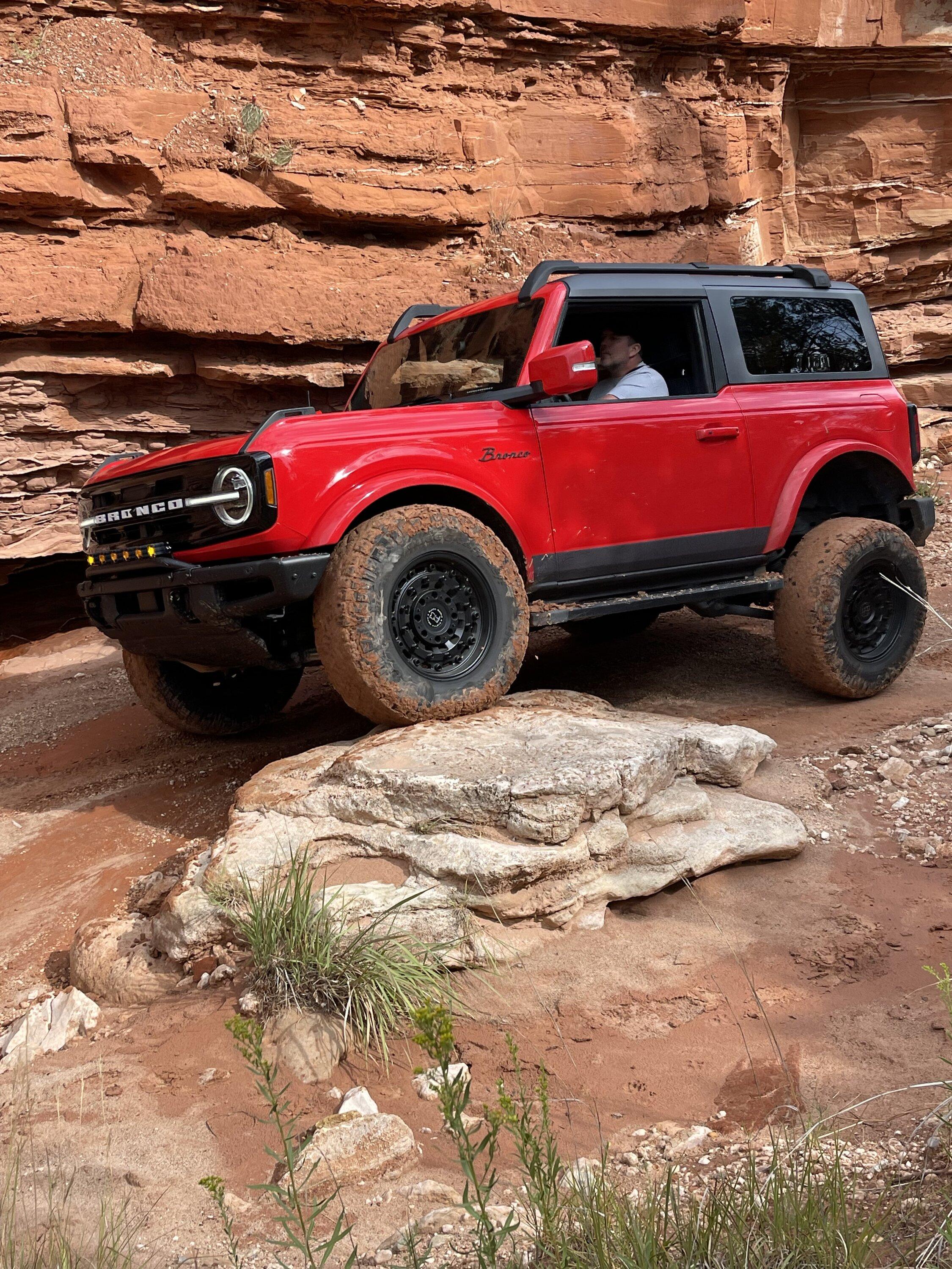

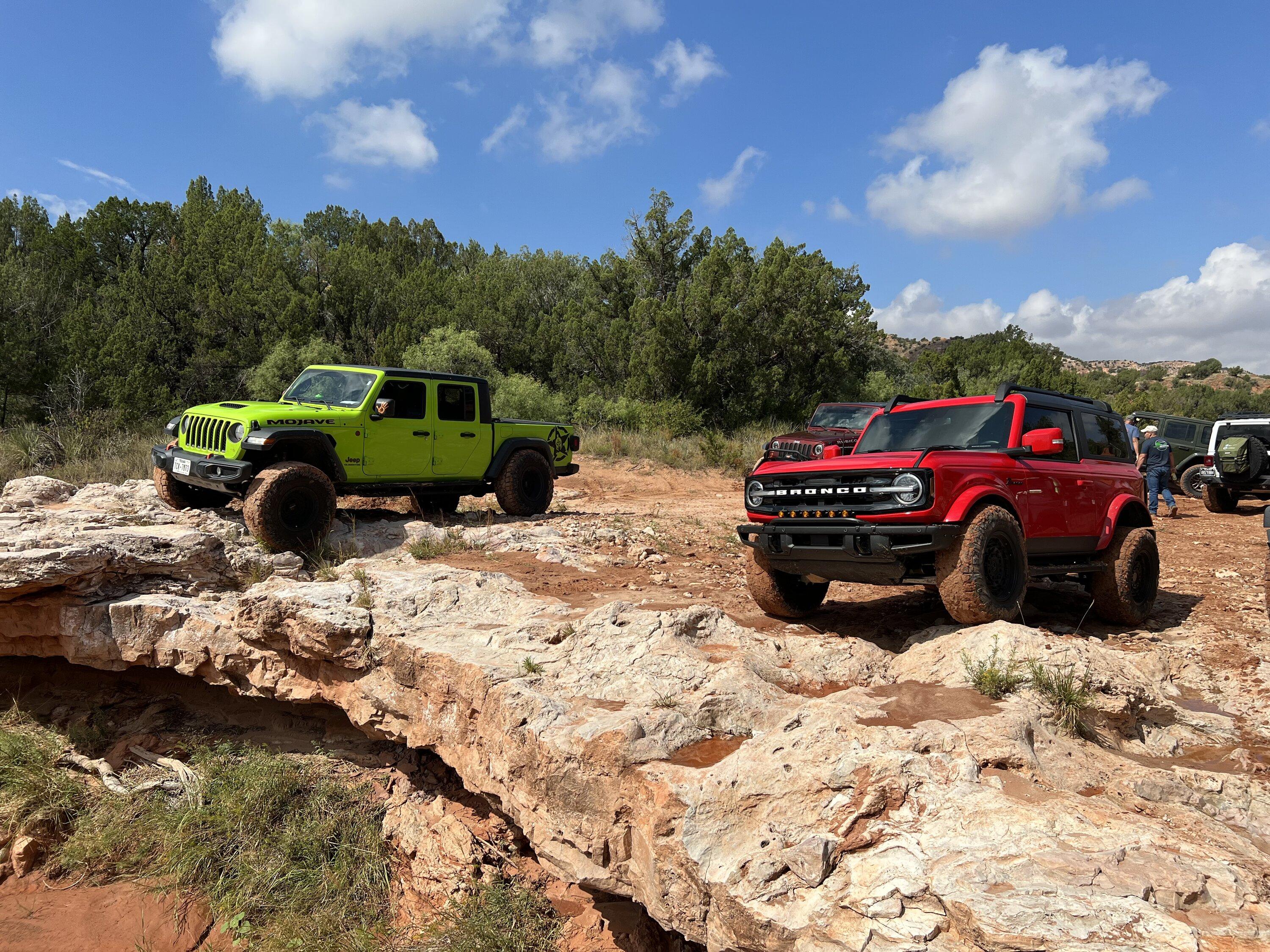

Handled the Blue Tour like a champ! Impressed some jeeper
-creepers with the Trail-turn Assist.
Been out there on blues three times this year, Merus is awesome! Who was your guide?

Five days at the Bronco Safari in Moab and almost a dozen more days on trials like OP's photos and no tie rods. Other breakdowns including an axel, but those came from obvious mistakes and the like.
A forum member with a 3" body lift has no CV angle problems, another with a 2" suspension lift has CV angle issues and both invested in upgrades to the rack and bushings and...
I'm running a stock Sasquatch and have done many days on trails like the OP's photos... with a big smile on my face too.

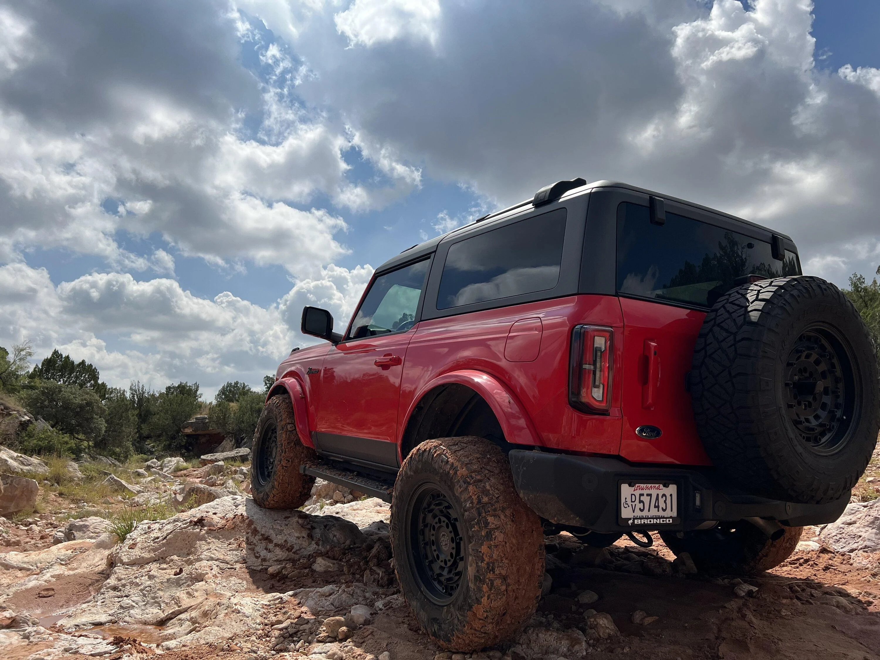

Well, it is a 2 door!
Finally some 2 door love on this feed.
Note the scale of vehicle design. Looks great!
Thank you!

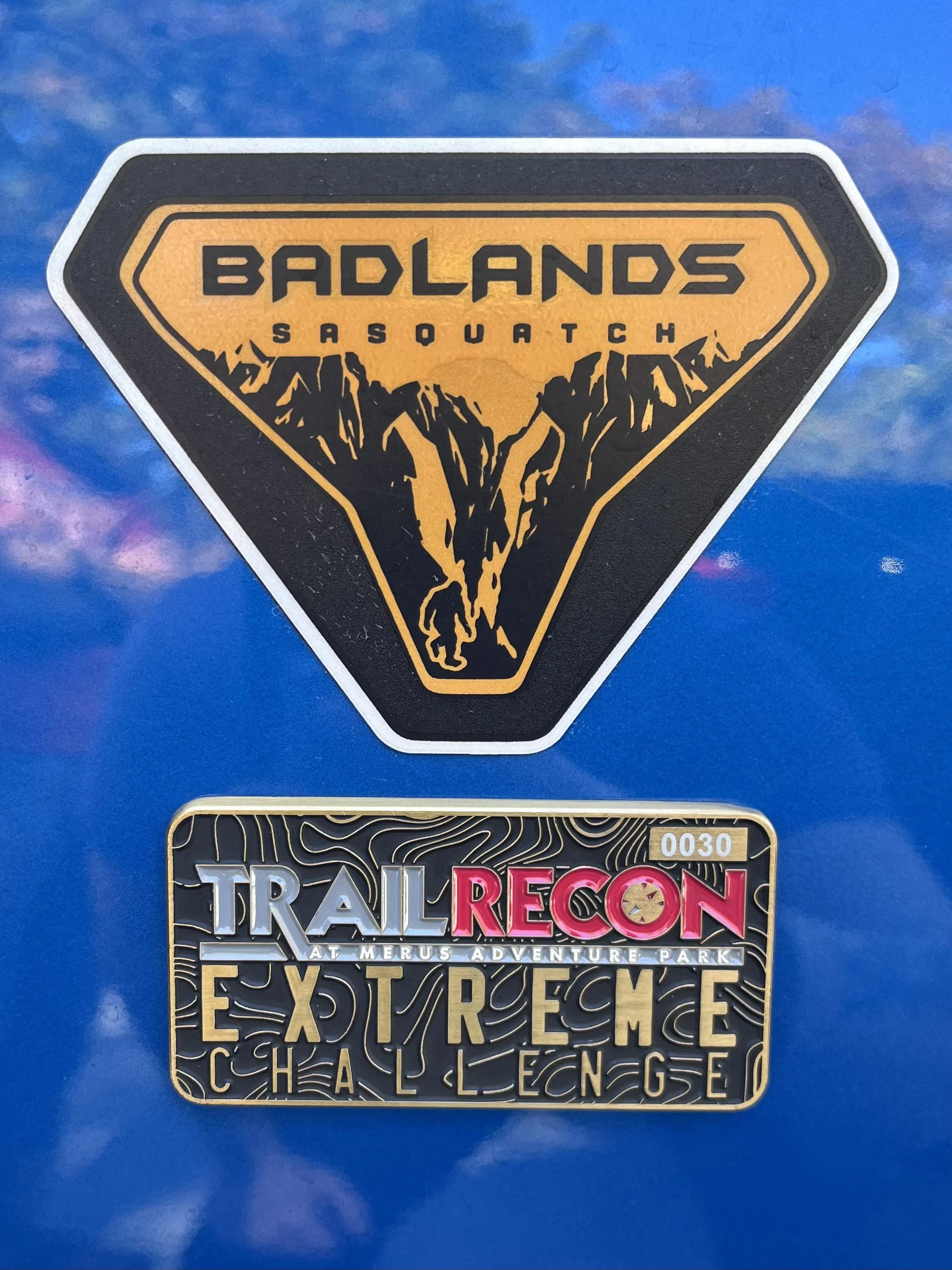

Glad to see other Broncos getting after it in MERUS. We spent three days there at the end of October. Loads of off camber and butt pucker moments. All worth it to be the first Bronco to complete the three day "Trail Recon Extreme Challenge" and earn the 30th badge. Not a badge chaser but that is one I am proud to have on the Bronco.
