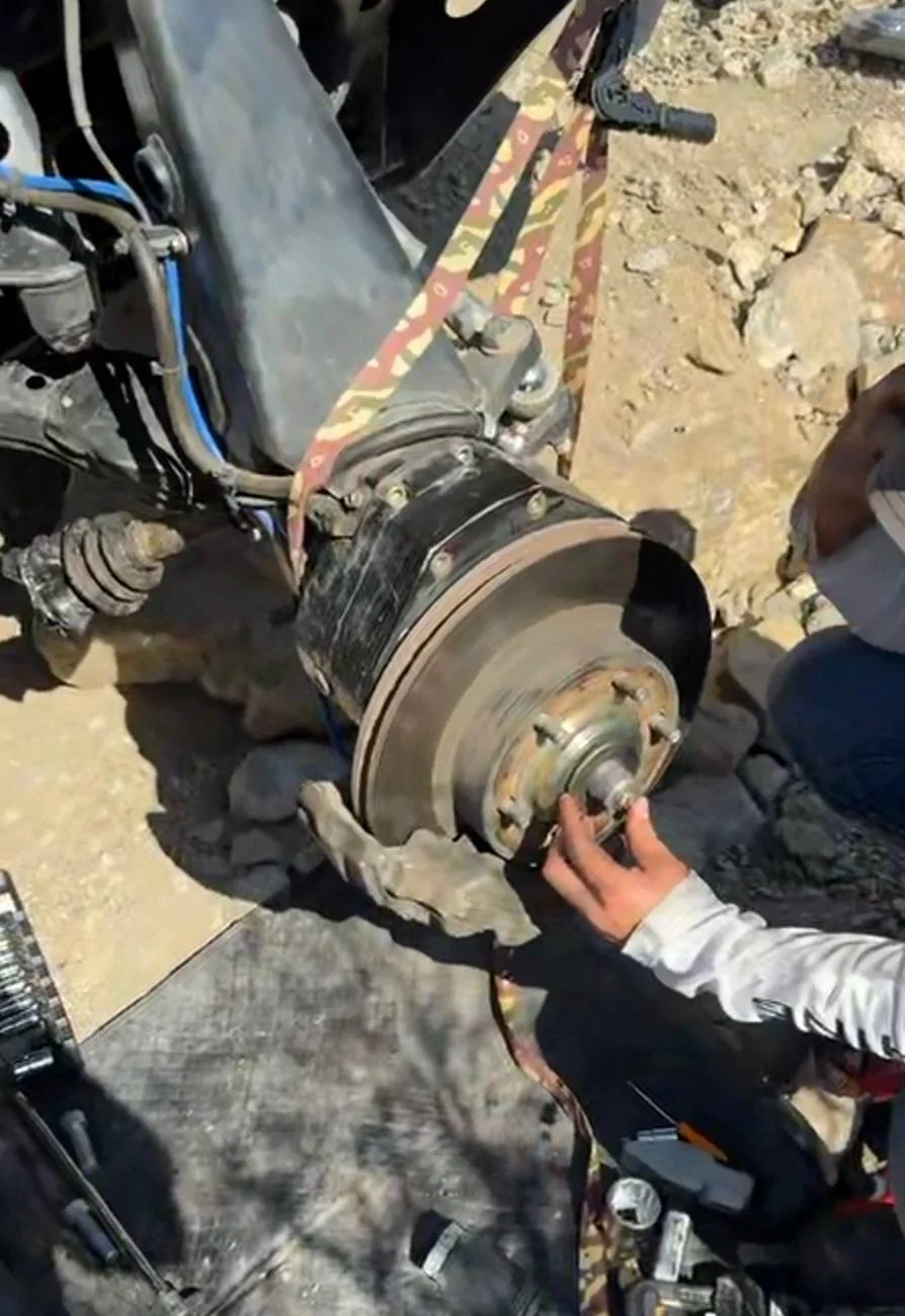

Hmmmmmmmmmmm. That’s a really good question. The additional clearance is nice. Really really nice. It does come at a price of raising your center of gravity, but if you invest in taller shock towers you can drop that back down. The additional maintenance isn’t a big deal, unless you’re counting taking everything apart several times in a short period of time due to manufacturing errors and oversight. At this point I’d say this biggest drawback on them is the effect it has on your steering as a bronco owner. Even with the more powerful motor and in mud mode you’ll bind up frequently on the rocks. You’re just asking a lot from the rack with huge tires, low pressure, the massive scrub radius, and additional weight from the portal box. We did some stuff this weekend on Triple 7’s and Milts Mile that really impressed the bronco haters, but the steering was embarrassing at times. I feel like there’s an opportunity for someone really smurt to dial in a badass electric motor for these things, so maybe that will happen one day.

Funny thing about the shot is that it was due to the steering binding up. We were going to do a three (or seven) point turn to get the steering free’d up and pivot on the slider like the regular cars that turn their wheels do. Once we lifted the tire it started to free up so Kept pulling her forward and she is really doing well on her throttle control. Pulled it up in this position and looking at thought “ya know, I think it’s actually going to settle and be okay.” This wasn’t just a photo opportunity that she then backed out of. She drove through it.

I should add to the review portion of this thread-in person I’ve only seen two rigs running werewolf portals and one running tibus portals. All of them were leaking gear oil. And the design of the 74Weld portals is still better in my opinion as we don’t need to take the portal box apart to pull the axles. Just open the window and remove. Became friends with a guy running werewolf on his toyota and he shelled a CV on his first real run. Couldn’t get the box apart to remove the stub shaft so ended up just cutting the axle and letting it flop around to get back to the trailhead. Our unit bearings also seem to be of higher quality, but I don’t have the knowledge base to legitimately have an actual opinion on that. Just seems more gooder.
