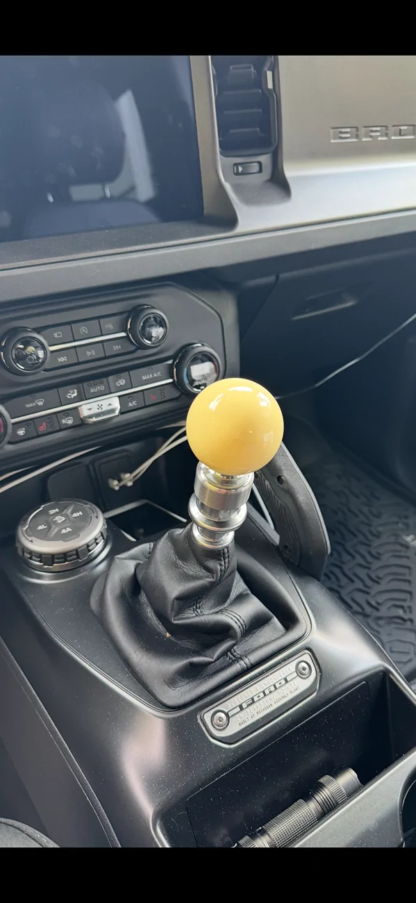

Try Twisted Shifterz. I bought an unmarked knob to further confuse non-MT people, but they claim to do custom logos. The kit I received is good quality but obviously can’t speak to their custom shop stuff.

I went to their site, but could not find the Ford Bronco in their fitment guide. What size did you end up getting?
I don’t remember the thread size, but they have ‘New 6G 7MT knobs’ in the drop down menu. There is a kit with a set nut for the 6G Broncos you may need if you have markings on the knob and want the font to be aligned correctly.

Thanks. Approximately how much higher does it sit? Does it attach using set screws or gluing it in place? Is the item below the shift knob their conversion kit?

I emailed them a while ago.
"Already have bronco 6g adapter version. 1. What size threads do I need to fit the adapter?
Choose M16-1.50 threads on any of our shift knobs to fit our adapter. All knobs available with the shift pattern as well."

The knob is about the same height as the center console arm rest. My forearm is parallel to the ground if I rest my elbow on the armrest while shifting.
IIRC, the metal sleeve / collar slides over the stick and may be secured with a set screw. The knob has female threads and just screws onto the stick. It comes with a nut so you can control where the knob bottoms out if you want the knob to be rotated to a specific position. Hardest part of the install was prying off the original cap without destroying it. 5 minute job.
Not that the original knob was uncomfortable, but the round replacement knob feels much better to me.

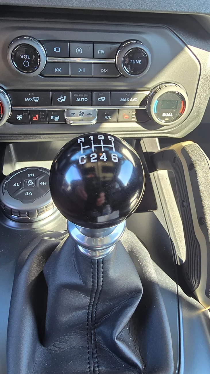

My version came with lock-tight instead of a lock nut. Height is about the same as original.
