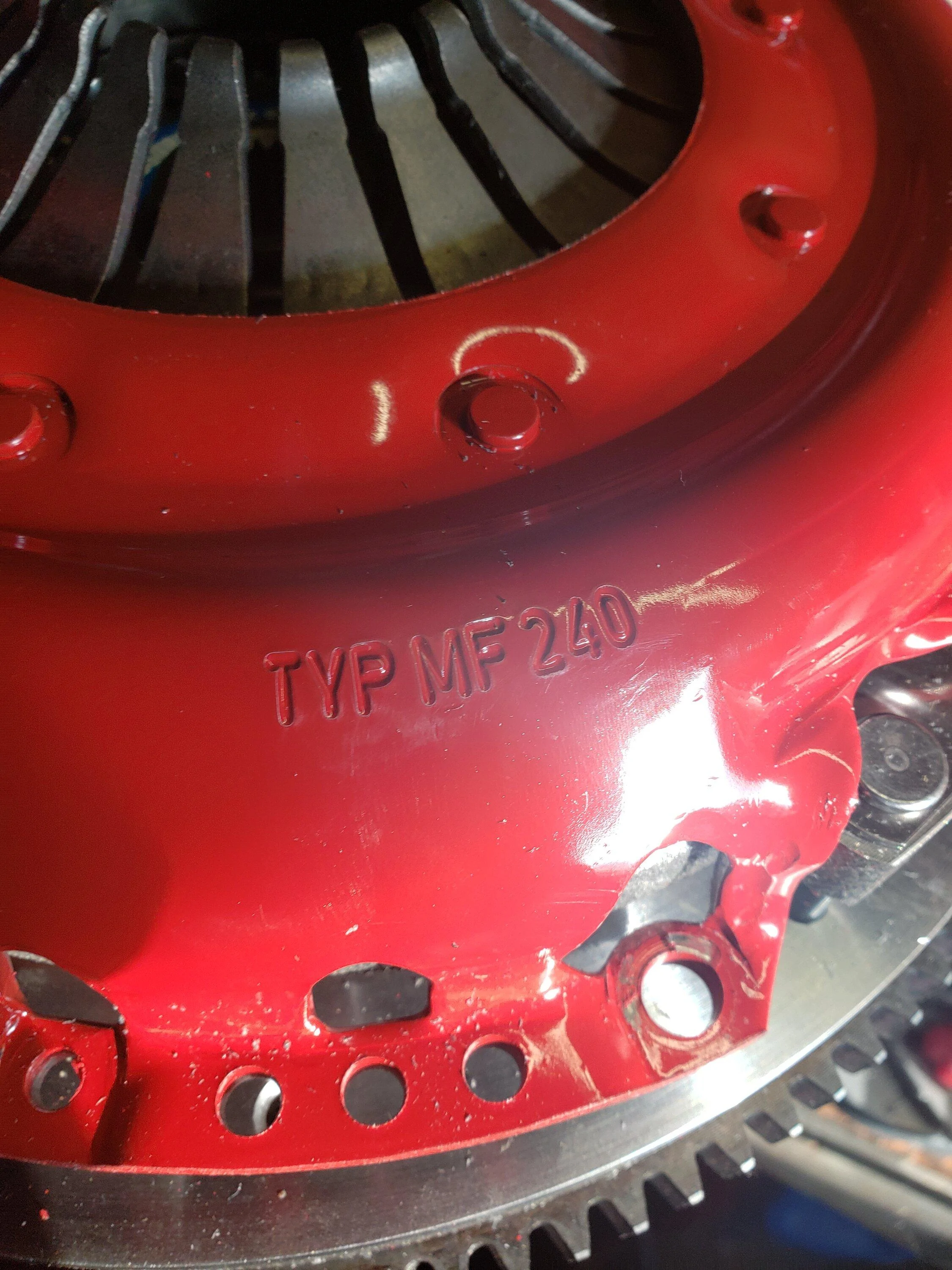

Cool idea! I would assume "race" is party on both sides, and "daily" is all business...dont have those to compare, but makes sense now. The pressure plate has a sachs part # on it, so may cross over to other applications...I don't have catalog info to cypher, but maybe somebody reading this does:

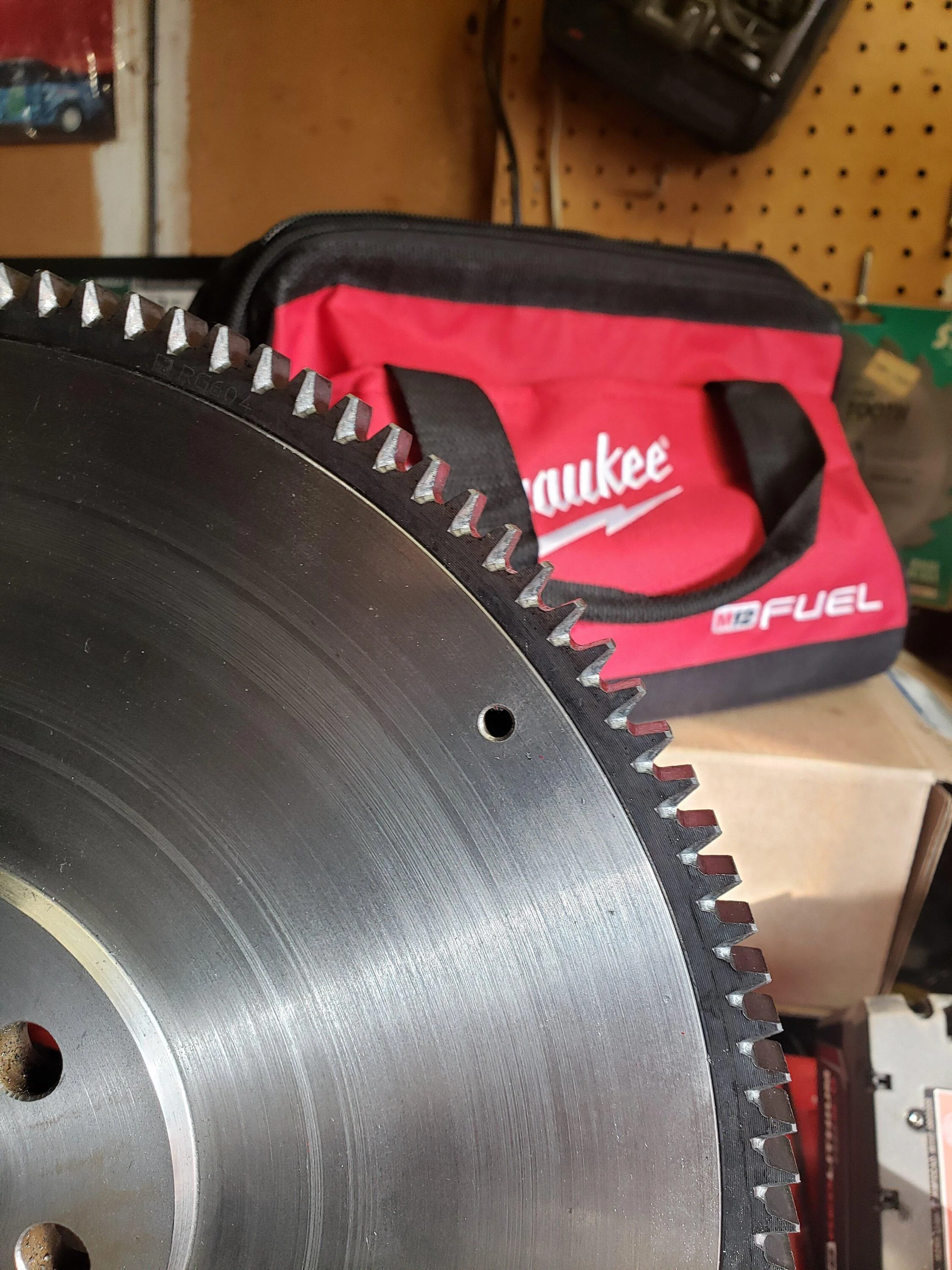

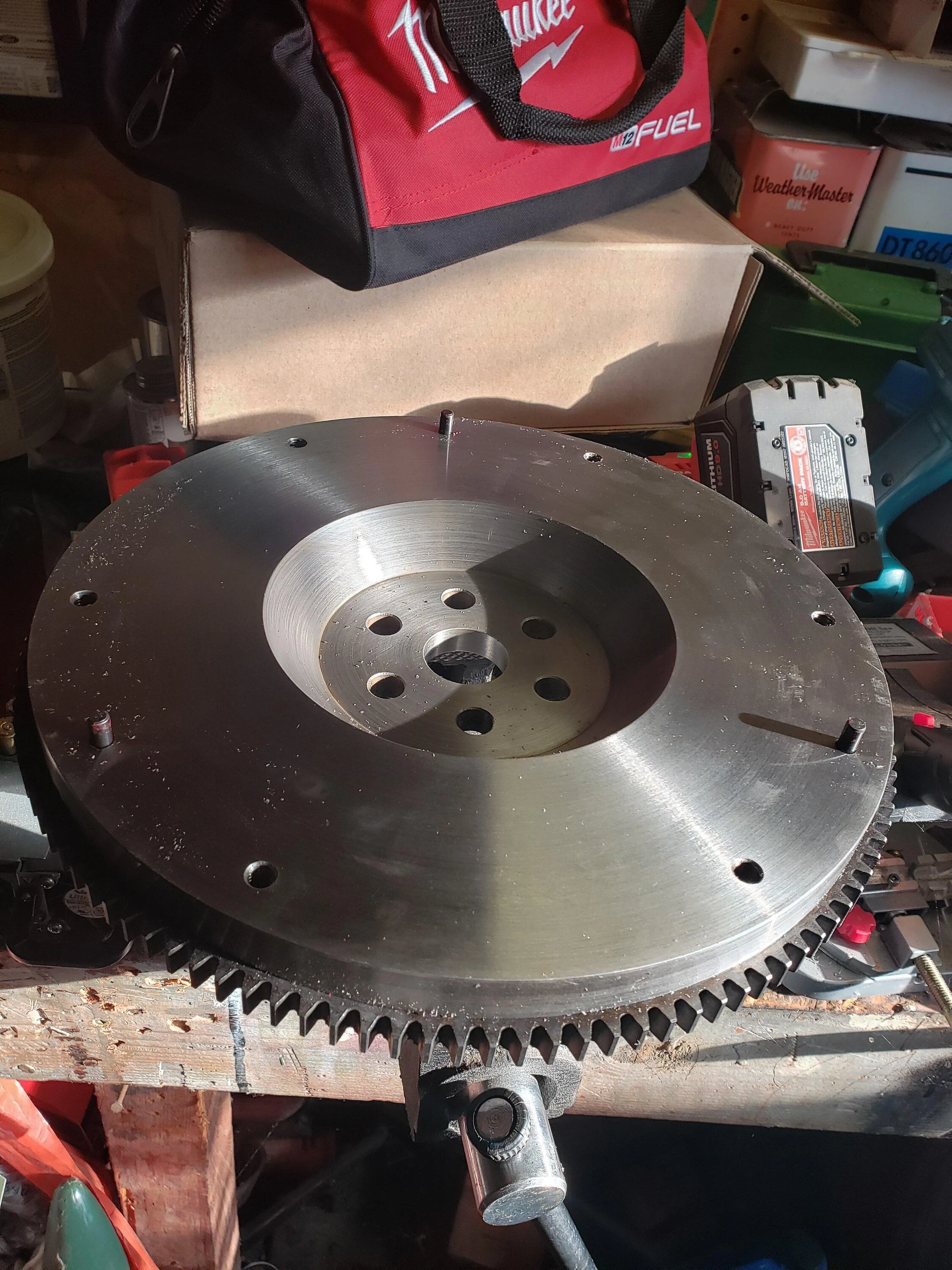

In another thread @kodiakisland asked why they come with flywheels, and the reason for that is to do away with the dual mass flywheel. Engineers love dual mass flywheels, but engineers don't have to work on 100k + mile vehicles. As a profesional, I 100% approve of the included flywheel! It is THE BEST part of this kit! Single mass, completely flat, and dowel holes drilled all the way through! Its like they read my mind on what I wanted! Starter gear teeth are beveled too! Very nice piece!

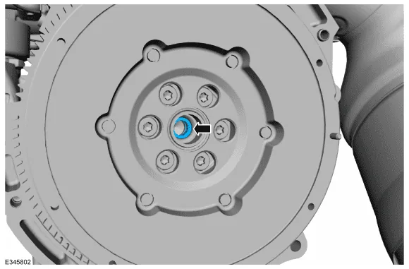

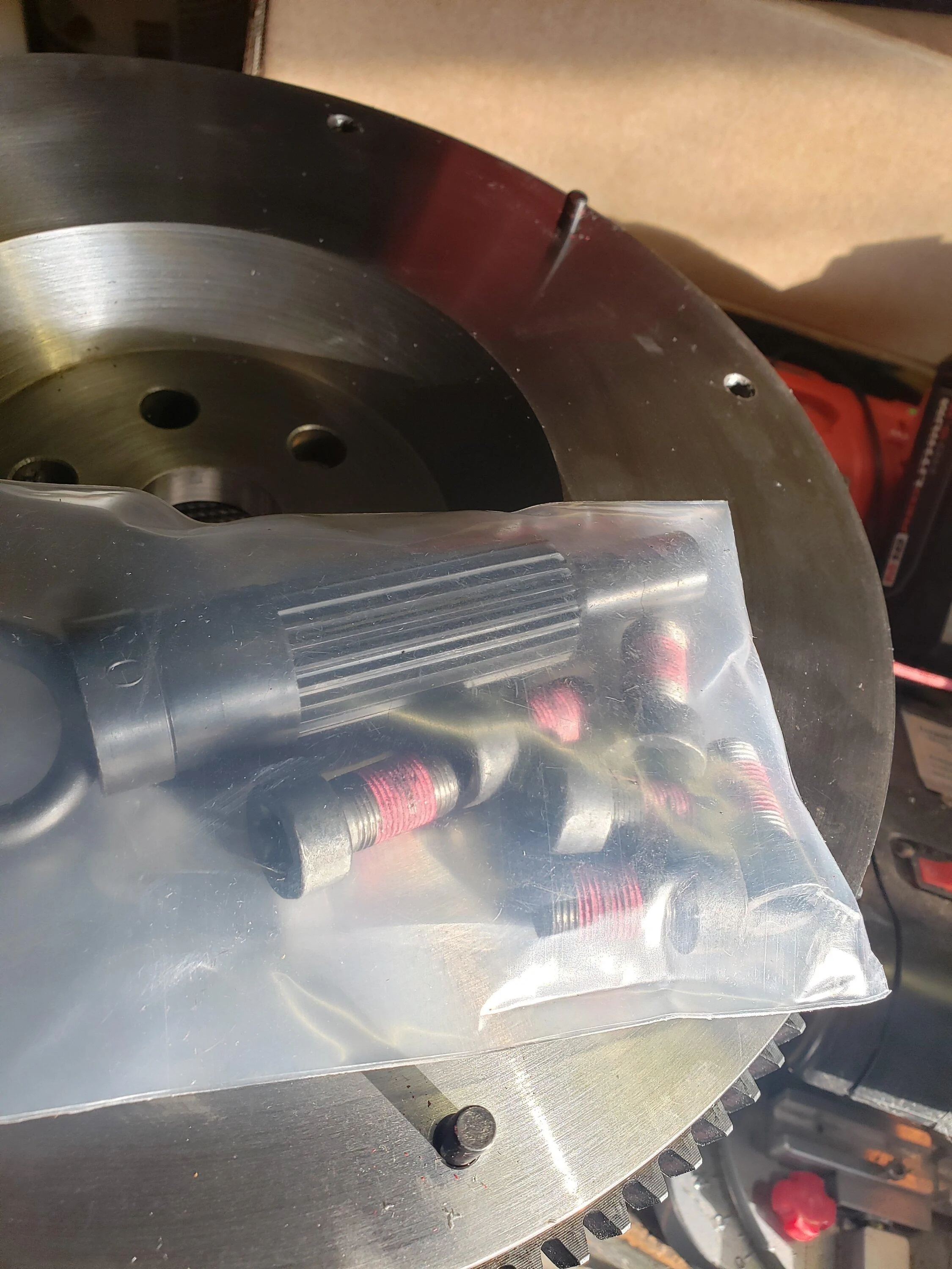

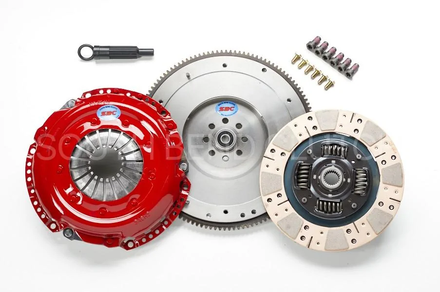

And of course they include alignment tool and flywheel/crank bolts. They are torx(ugh), but oh well, can't have everything! I have an electronic scale, but batteries are dead, otherwise I would get some weights, by feel the weight of the full assy is at least 40lb, and UPS listed the box as 45lb. Dont know how that compares to stock, but doubt its any lighter. The flywheel is probably a bit lighter, but the PP feels quite beefy. Only other thing I noticed is in pics on the website it shows a pilot bearing In the flywheel, but there isn't one in the kit. Don't know if i was supposed to get one, or if I reuse my original or what. Plenty of time to figure that out as my trans won't be going in till I get back from Moab in May.

EDIT: After reading the shop manual, the pilot bearing on this type (like most) is in the end of the crankshaft, not the flywheel, so I should not need one. The picture on SBC's website shows a completely different flywheel:
Ford Bronco South Bend Clutch - Stage 2 Clutch, 1st look and impressions KFB-B_1
here's the shop manual pic:
Ford Bronco South Bend Clutch - Stage 2 Clutch, 1st look and impressions pltbearing
So what I received is completely correct
