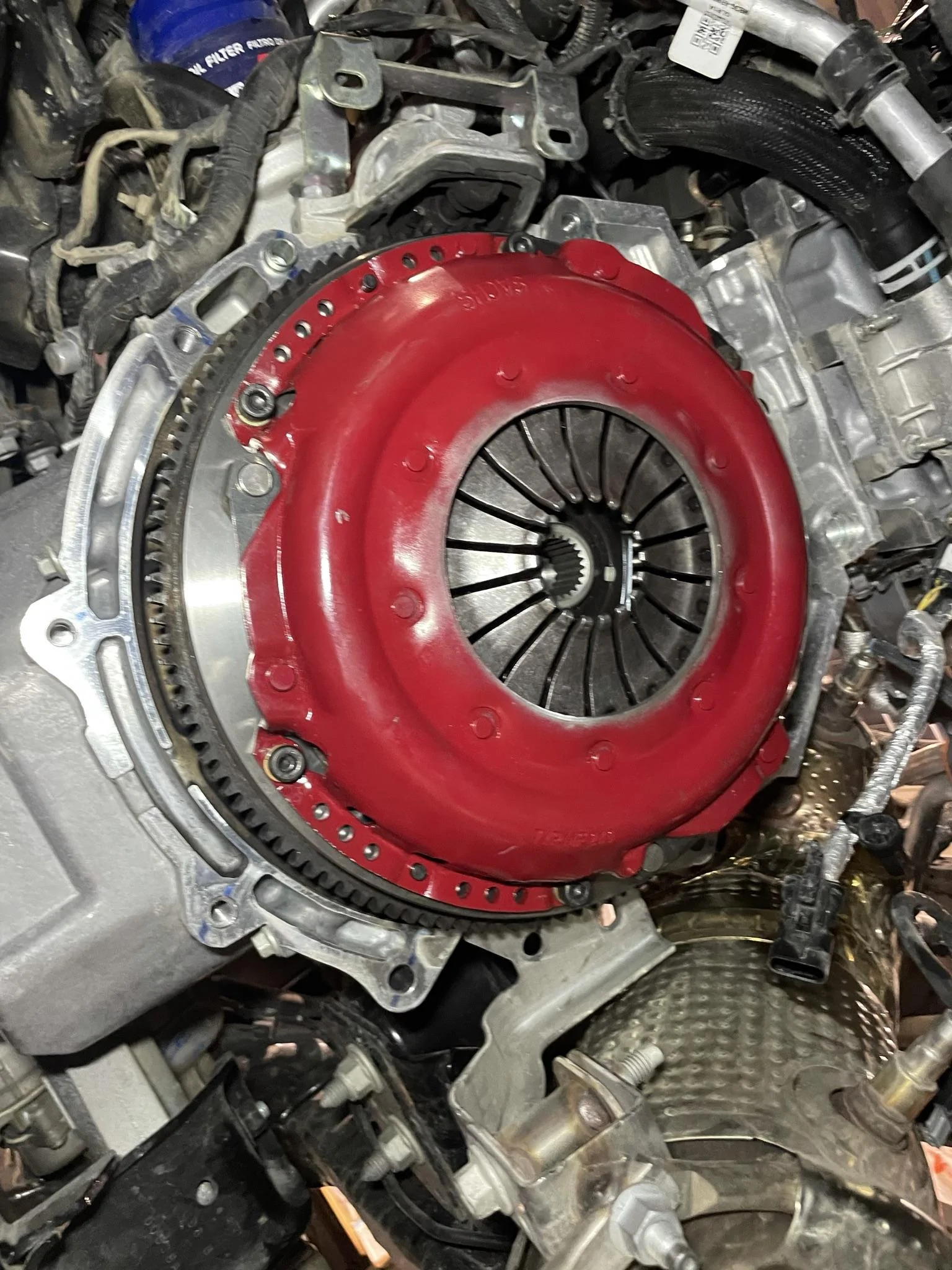

Kirk59
Kirk
Jan 13, 2022
Logandale NV
Ford F-350
South bend and bronc buster is bringing an aftermarket clutch to market, here is a picture of the stage 1 clutch that we tested, right now broncbuster has a stage 3 clutch in it. Very soon they will be available to purchase!
Thanks Ill check him out and see
Ford Bronco Clutch Replacements? 51520A74-D060-40FD-876F-5AF13319C65A
skap407
skap407
Feb 23, 2022
Orlando Florida
Bronco Sport
glad to know. not sure if i'll be able to wait but definitely will upgrade when they come out
redone17
Mar 6, 2021
75
4,774
5,208
Cold Spring, NY
2021 Bronco, 2020 Ranger
How are the tests going?
