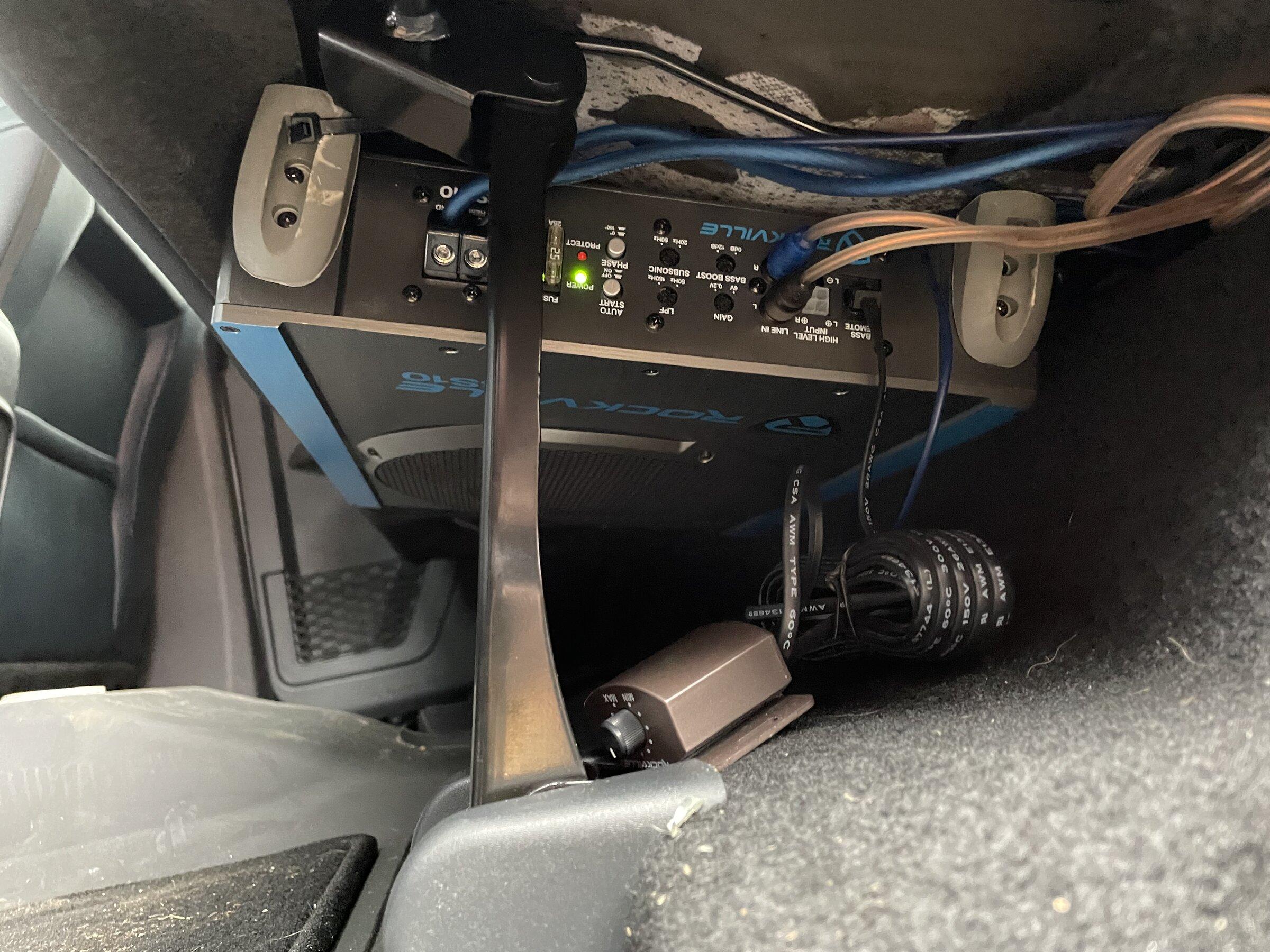

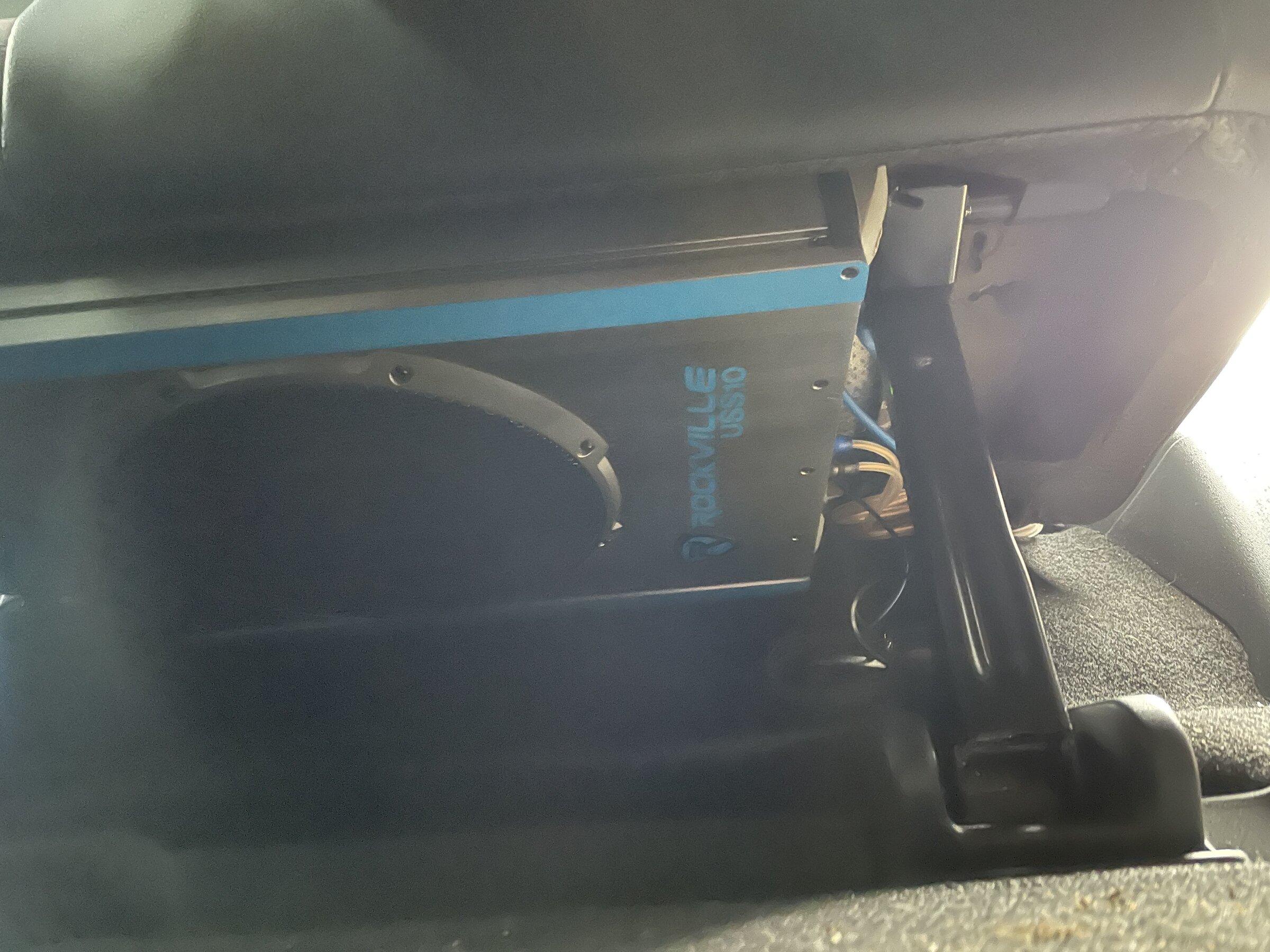

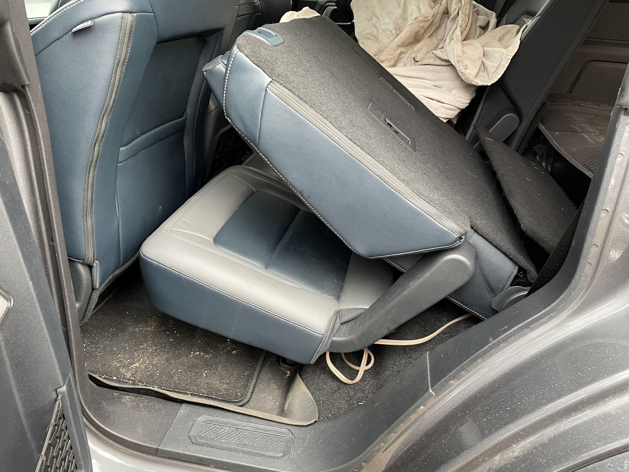

Pic of sub under seat?
I still have to clean up the wires and mount the bass knob somewhere. It does severely limit how far down the seat can fold down. Don’t mind my tarp I had my dog in the car and trying to keep the seats nice. You can’t see it at all standing next to the open door. Or when in the car.
Any reason you didn’t relocate to one of the front seats so there’s no drawback?
I don’t have room under my front seats. They are leather power seats. Plus the heat duct is right there so for 6 months I’d be pumping hot air on it. I maybe could have wedged it under the front if I was the only driver. But my wife would get in and crush it lol.
