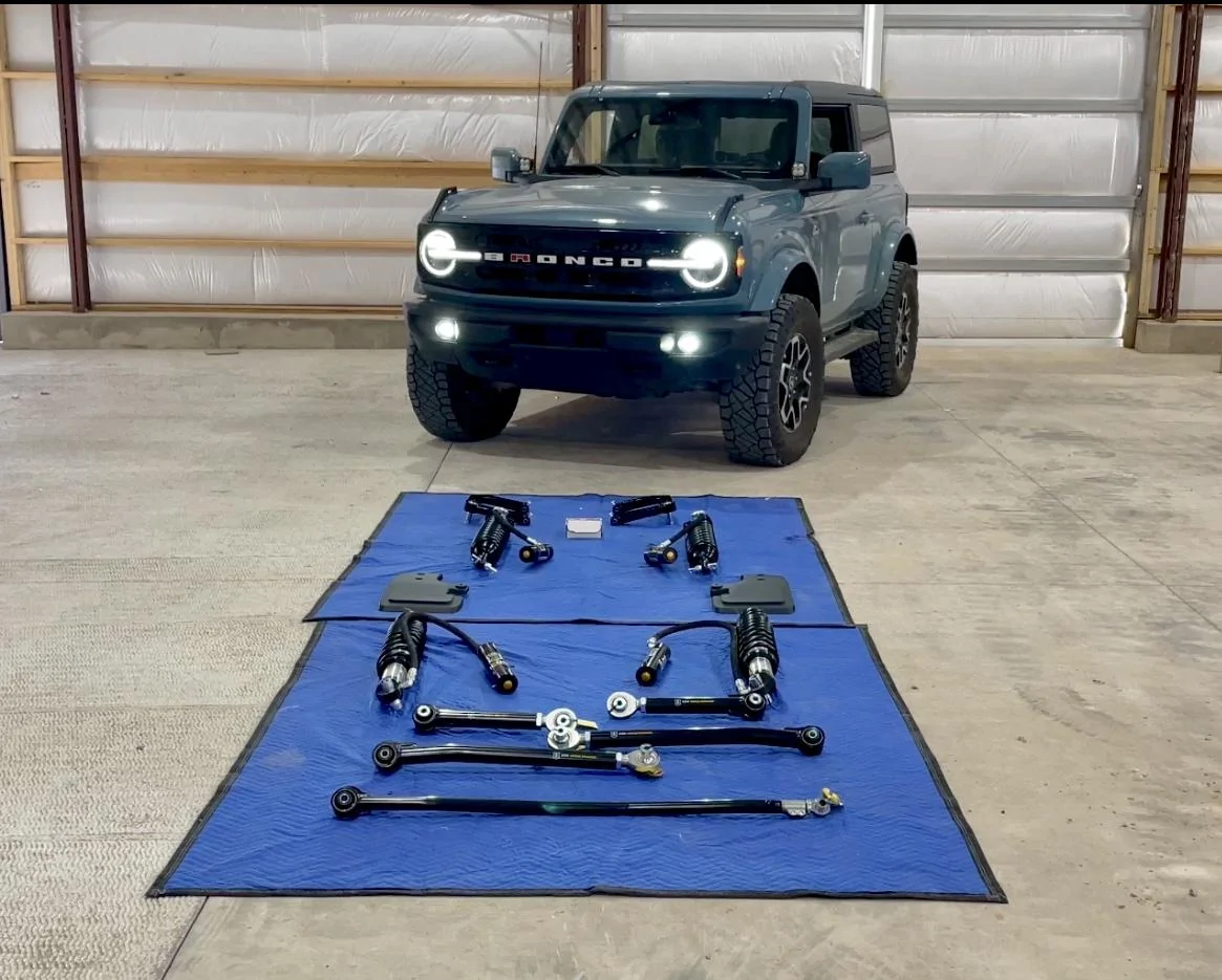

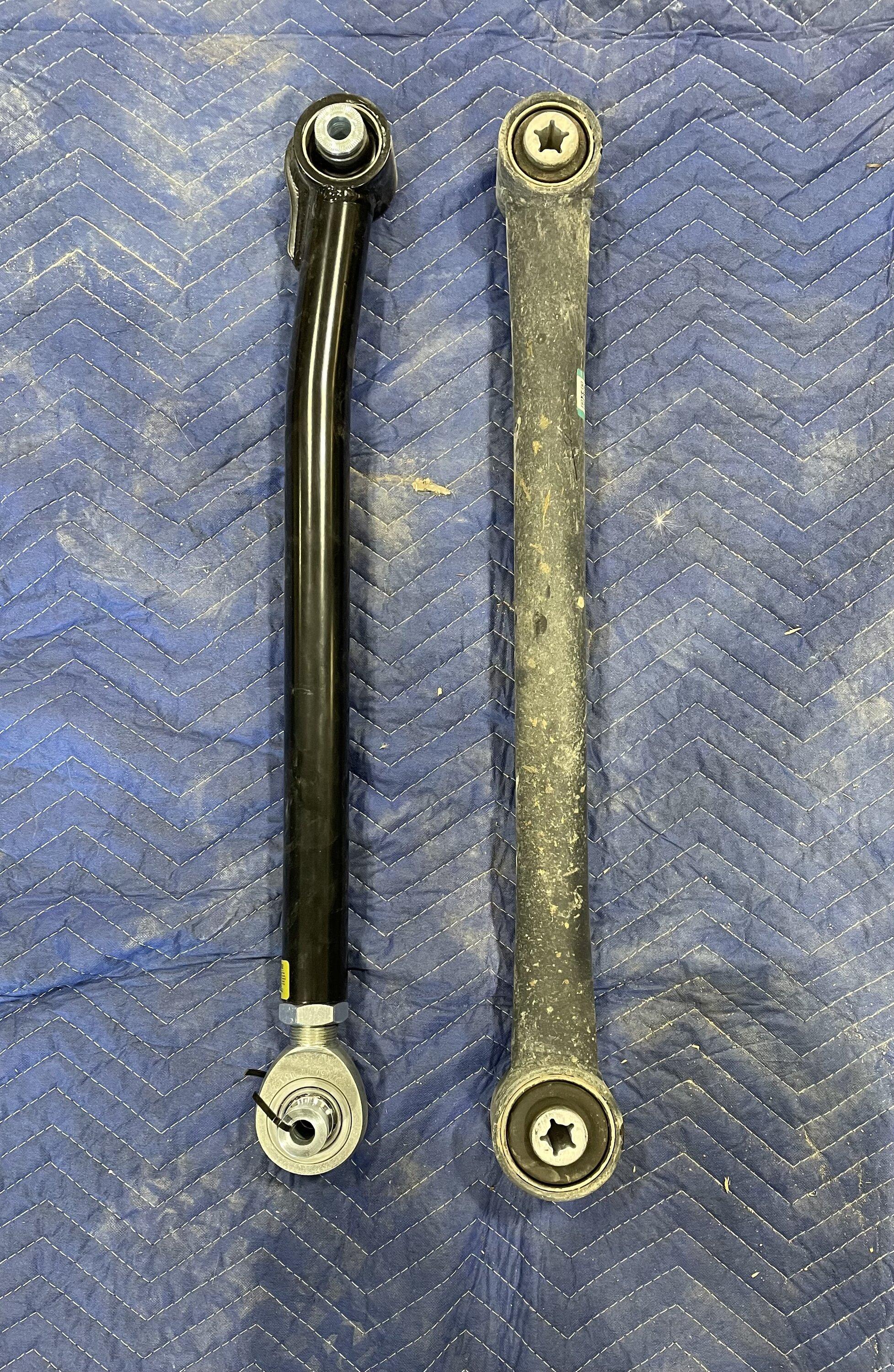

The ICON set-up is amazing, even with 37's, It handles amazing on the mountain roads. My wife could not believe how much difference the suspension made. Even that weird squishy wiggle in the rear was gone, the twitchiness of the Bronco is gone. I think that had a lot to do with the big stock rubber bushing in the rear links compared to the solid machined bushing on the ICON rear links. We have about 2500 miles and 2 months on the suspension now. The first 1000 miles or so, the suspension was pretty stiff, even on the softest setting. It's softened up a bit now, we run the resy's on 3 up front and 4 rear daily for the dirt roads with wash board and potholes. When we are on the Hwy or asphult, I'll run the front on 5 and 6 in the rear. We resently purchased an Airstream 16X to tow behind the Bronco. There was a little squat in the rear and felt a little soft with the 16X in the tongue. But I set the rear resy's to 10 and left the fronts at 5. It did great. Even with Hwy speeds on I-80 (some of you might know what I mean by that). My only disappointment is that the rear coilover bodies started to rust. They still perform great. I did contact ICON and they were great. They are being covered under warranty and looks like they will be sending a new set out for replacement. It seems that there was a platting issue on a few of the rears. Just another reason I really like ICON, their customer service.
When we were at Bronco Super Cel West, I got a chance to speak with Scott from ICON. I had told him about the suspension feeling stiff. He recommended that I give them a little time to see if they soften up. Scott also mentioned that ICON offers free custom tuning. Depending, if you are more Baja, street or rock crawler there is an option to dial your setup. I feel that given a little break in period, the setup that the 2.5 CDCV comes with, will be a pretty good all-round setup for 90% of Bronco owners.
