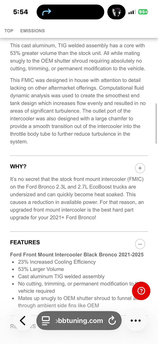

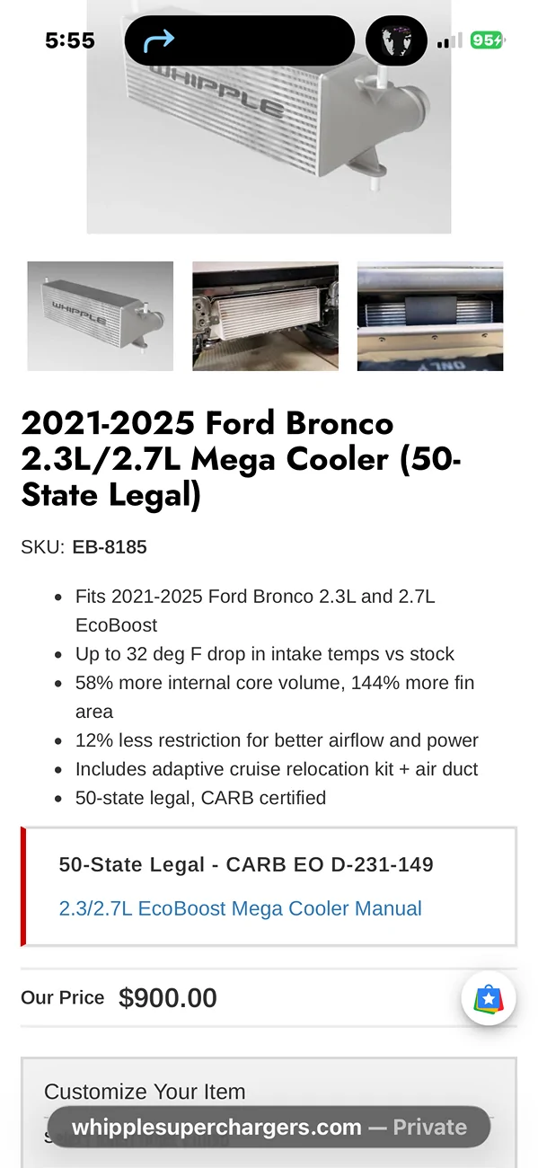

Not a lot of direct dyno comparisons n most are cherry picked attributes but most direct Whipple has 58% volume increase over Cobb 53%.
If anyone know more please correct me
That’s a good find.
The fin area and restriction stats Whipple puts out are the real $$& though. Volume doesn’t mean a lot by itself without those two stats to back it up. But the fact that Whipple knows that and put them out says a lot.
To be fair I’m sure Cobb knows too, juat
not in their advertising, where it should be for people trying to make informed decisions.
Otherwise, you know, we may as well just
compare frontal surface area and call them all equal.

Yea I believe this is a “u can’t go wrong between the two” situation unless u are counting down to the very nitty gritty of gains. Can’t speak for everyone but I certainly won’t be able to tell like <3 hp gain difference.

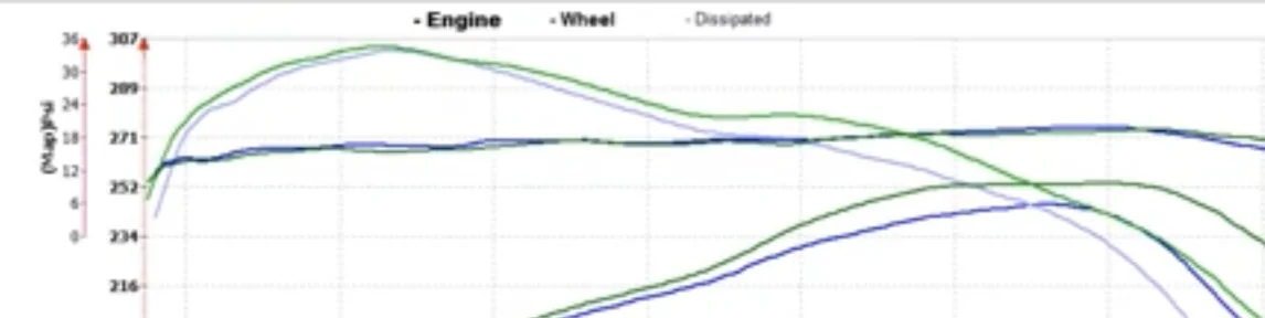

Cobb also has this dyno study but whipple does not, no direct comparison there
https://www.cobbtuning.com/ford-bro...lYgH42Q9LKgOMzprnQA0ZfXvRwDJI0mHJQuDJTZsddd_P
