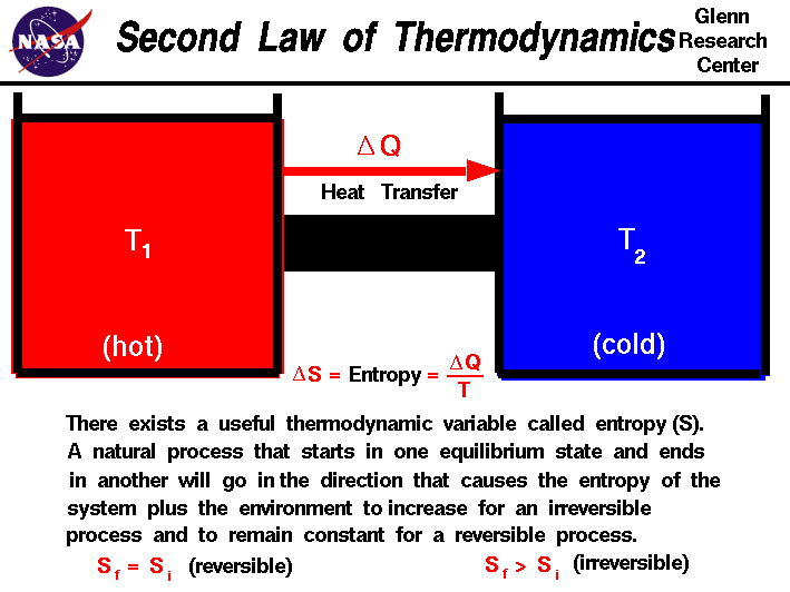

If you read the fine print... neither changed the frontal area... just made them thicker,
Once the air entering the front is heated, it's not going to absorb any more heat ;^) no matter how thick the additional IC is ... law of thermodynamics
  • 23% Increased Cooling Efficiency [neither provided any 'proof' ]
  • 53% Larger Volume [ but not frontal area...]
  • No cutting, trimming, or permanent modification to the vehicle required
  • Mates up snugly to OEM shutter shroud to funnel air through ambient side fins like OEM
