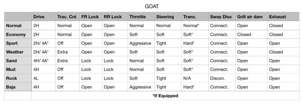

There’s more to the GOAT modes than people realize. Going through the modules it also seems that some parameters for the airbags are disable/modified when in an offroad mode.
Ford Bronco 4x4 performance reduced message after time in the sand IMG_3362
Thanks for posting that, course just after I got all preachy I confess I don't use goat modes excepting sport on the pavement occasionally :ROFLMAO:
Some of that surprises me a little bit, assuming I'm reading it correctly. Rear & front locker in sand? Rear ok, but front seems overkill for "typical" sand conditions - and "extra" traction control in sand? That is counter intuitive, but that assumes driver knows not to dig in so understandable.... No Rear locker in Baja? Also front locked in rock crawling by default? Maybe the driver is supposed to understand that they are to take it out of rock crawling mode between difficult obstacles/sections?
Raptor guy could tell us for sure (pretty sure this is a raptor sheet based on exhaust) but I know on the Wildtrak rock mode doesn’t lock the front. Also don’t know what the “Extra” traction control is. I never used them until seeing the airbag settings and tried to research further if that assumption was true but could not confirm. After a buddy had his airbags go off on a mild obstacle I decided to use them 🤣😬 I assume no rear locker on baja as the locker is turned off regardless above X speed. Hell, F-150 Rappy doesn’t even allow the diff lock in 2WD. And there are definitely times while on the rocks that it’s advantageous to use front locker but turn rear off. Or just leave them both off all the time until necessary.
Nothing is perfect, so I’m sure Ford is trying to appeal to a broad base of experience. And sell more bronco off roadeo tickets.
I also prefer 4L for sand, myself.

Hell, F-150 Rappy doesn’t even allow the diff lock in 2WD...
Say it isn't so...speed limited as well probably?...I guess "baja" just ain't what it used to be
Also that about airbags going off, yikes...maybe I will consider rock crawling mode and make adjustments if need be.
Indeed not. I had a 2018 and 2020 F150 rappy and both of them turned off all the driver aides in baja mode. First time I took the 2022 out I went to drift a corner and…traction control was still on! Daheck? The 2018 had the best settings for Baja mode. The whipple tune might have had something to do with it but it really seemed like it had more effective engine braking in that mode. Lift-off drifts into a turn were no problem with that truck. 2022 not so much, even after tuning.
But yeah-no rear differential lock in 2wd and definitely not above a certain speed. First gen guys were able to put a switch in that would fool the truck and leave it locked for as long as you wanted. Not sure if that ever happened on jennies and up.

Yeah a two and a half ton truck definitely has disadvantages in dunes compared to ATVs. If it was me I probably would lock the front axle in a situation like that (at least at first) and be in 4L as well.
I would also long press my traction control button to make sure it and "advantrac" stability control was as fully disabled as possible, and be sure to not dig in when the going gets tough. Thing is there's plenty of evidence that you cannot actually fully disable Fords stability control, especially in sand. There's a thread here somewhere about pulling a certain fuse that seems to help and guys that run dunes in particular seem to like doing this. I wonder If part of the error code and overheating you experienced has to something todo with traction control not being fully disabled??

like the post about GOAT modes being a "gimmick"
A bit off topic, but
I also share the opinion that the GOAT modes are a gimmick
But
I have to admit they do things that you can't manually accomplish, such as affect throttle and steering sensitivity. I wonder if they make adjustments to the ABS as well for some modes, rather than just blanket on/off (or, for the Bronco, the on, off and Really Off). I've heard rumors some modes can even disable the airbags from deploying, but not sure about the truth to that.
If that stuff is helpful or not, I dunno. So I think both things here can be true. They can be gimmicky, but maybe they can do some useful stuff too. If you didn't know anything at all about the Bronco and just wanted an easy "Get me through this o lord for I have wandered out where I do not belong" - GOAT may be your ticket back home.
A lot of the old GOAT charts aren't entirely accurate, but they are at least close to the mark. Many of them are from pre-release.
