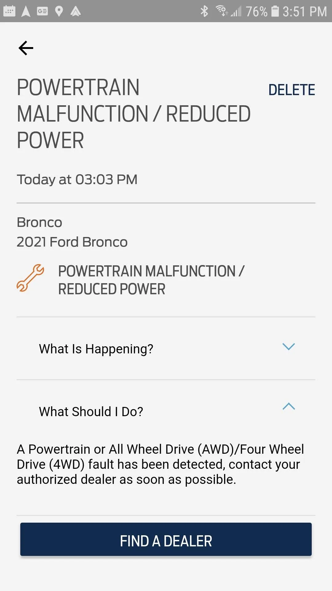

I just picked my Bronco up on Thursday (12/23) and love it. But have had three 4x4 error messages, and haven't even driven it in 4wd yet. The messages state either " For 4L slow to a stop" or "Check 4x4" . All three times, the Bronco has sent me the following notification to the FordPass app.
Has anyone else experienced this or know much about it? I do plan to take by the dealer tomorrow for them to check out.
Ford Bronco 4x4 Error messages - New Bronco Screenshot_20211226-155146_FordPass
