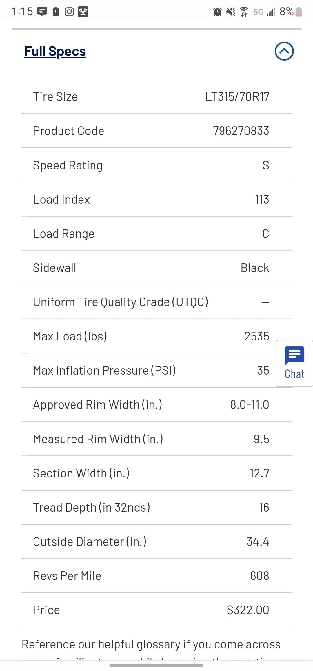

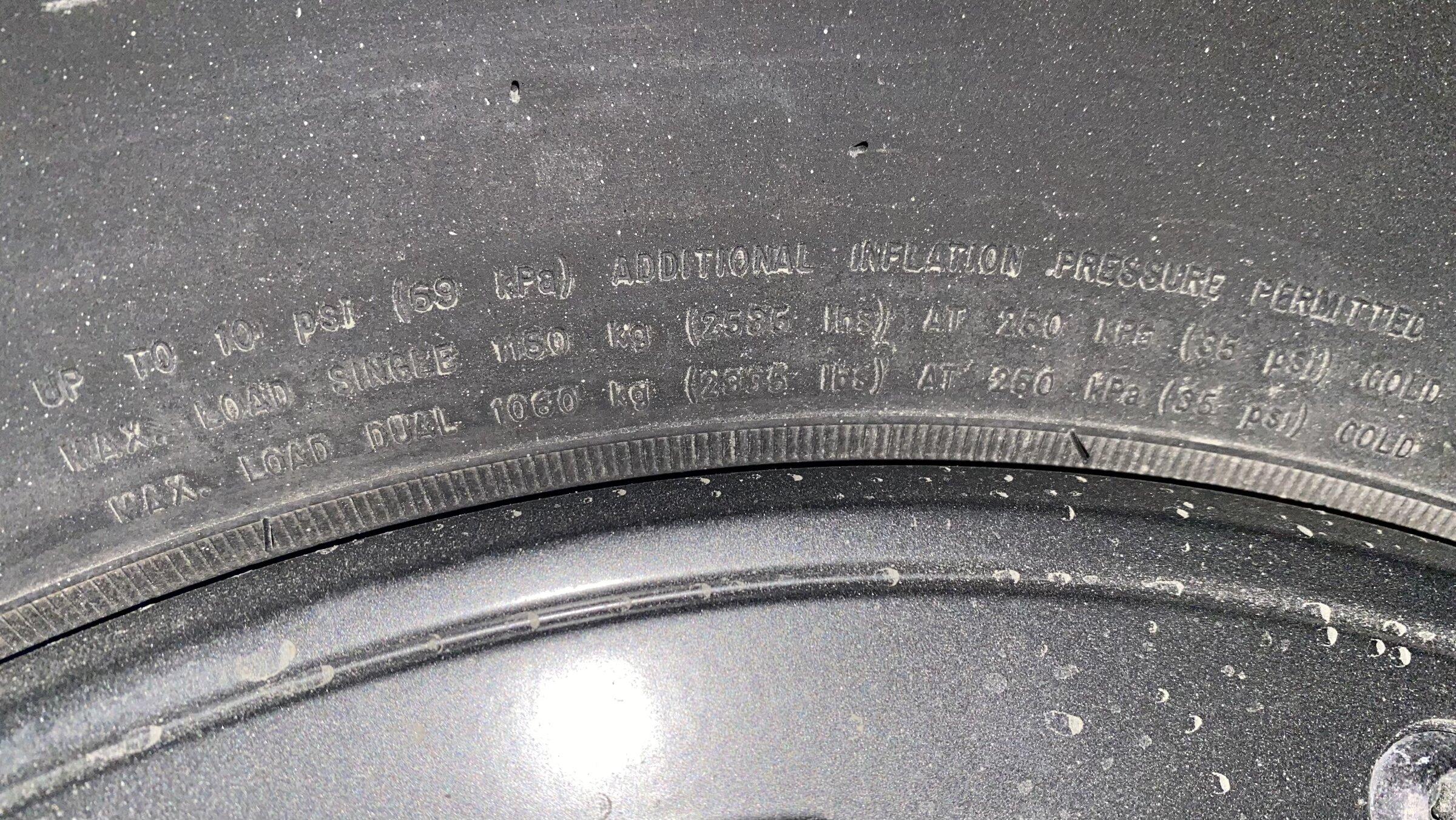

Goodyear is listing the maximum tire pressure at maximum load. The Bronco doesn't put that tire anywhere near maximum load.
The Goodyear Territories are rated for 5070 lbs per axle (2535 per tire). GAWR on the Bronco is 3270 lbs for the front, and 3070 lbs for the rear. So the Bronco's maximum ratings are well below the tires maximum ratings.
Ok thank you. So are we crowning and eventually cupping our tires at 39psi if max load isn't supposed to get more than 35psi?
Agreed!
When I got my Suspension Installed and then aligned, the shop also weighed my Corner Weights of my Bronco. 1470lbs average on the front and 1130lbs average on the rear. This is NO WHERE close to the maximum weight load of the original Sasquatch tires. Why on earth would I run them at 39psi???
I currently have E Rated 37s that have an even higher weight load rating and run these at 32psi front and 30 psi rear. No, this will not damage my tires. There is a nice even contact patch now with no tire bulge on the side. In fact, just this past week I drove my Bronco from Virginia back to Florida and got 18MPG at 75-80 MPH with this tire pressure.
Nah, I don't think so. But I bet you Ford is recommending tire pressures that high largely for fuel economy. So if you are concerned about it, you can drop it 2-4 PSI and should be fine.
The Goodyear Territory tires are not exactly the world's best tire. They are purpose-built for the automobile manufactures to stick on factory vehicles, and they are prioritizing cost, low weight, fuel economy, and decent off-road performance will retaining acceptable on-road performance. I'm personally not expecting them to be a 50,000+ mile tire, probably more like 30k - 40k... but I guess we'll see how it works out.
