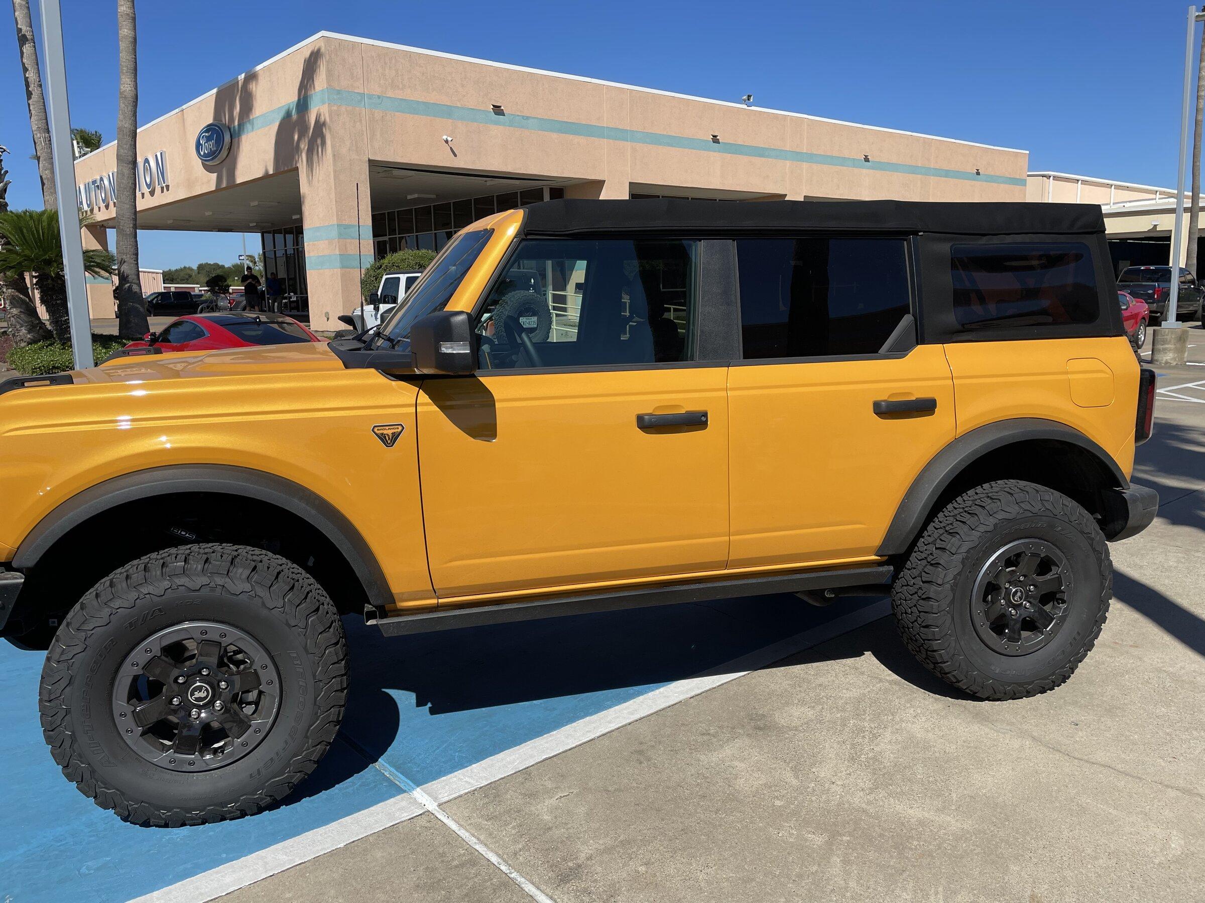

You won’t have any issues. This is a friend‘s Badlands that he just put 35’s on with no lift and crash bars are still installed.

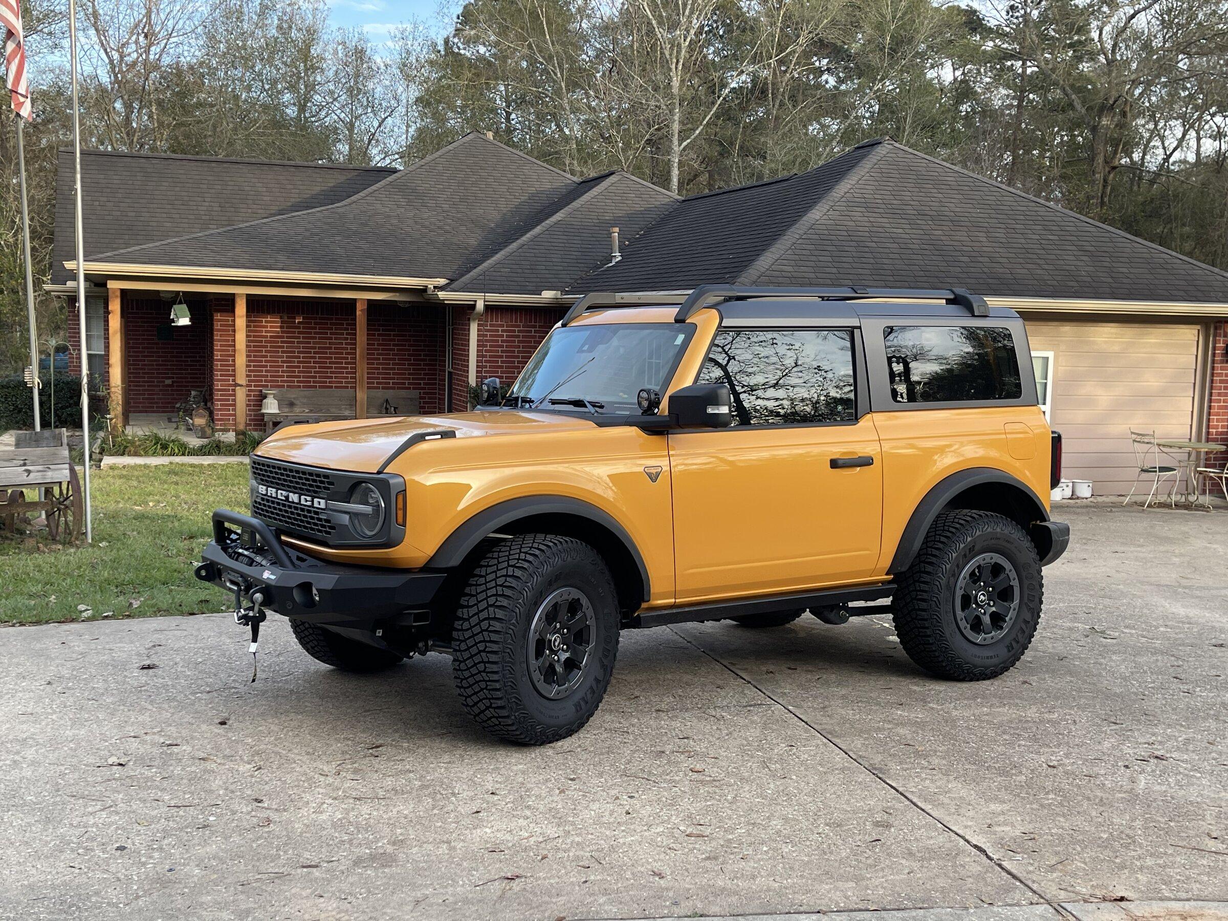

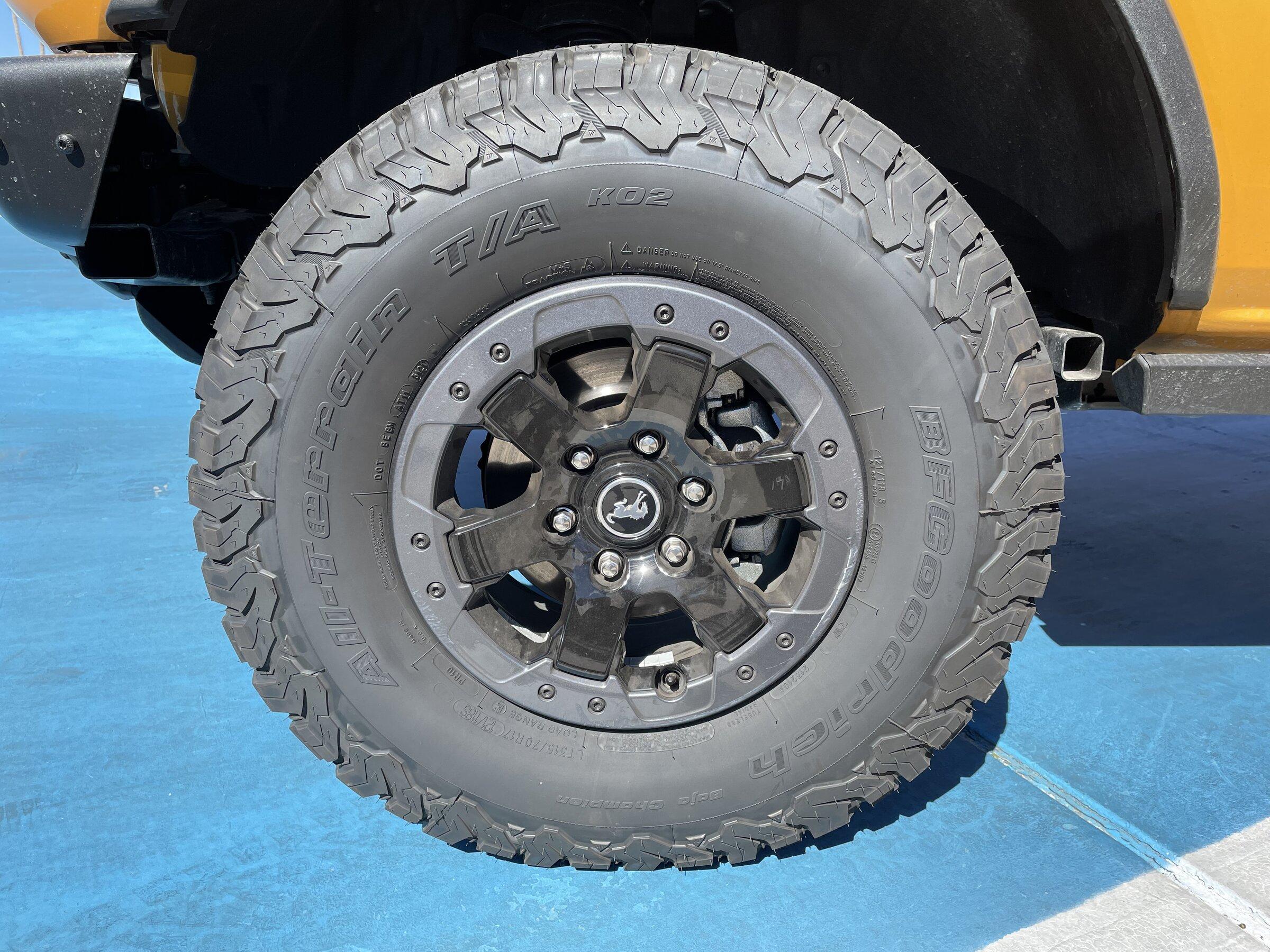

@grayshadow Freaking cool. Can you please tell me what tires he used?
STX Bronco
Jun 15, 2020
541
972
South Texas
F150 SuperCrew 22 Badlands
Local dealer put 35’s on their demo and added. 2” lift.

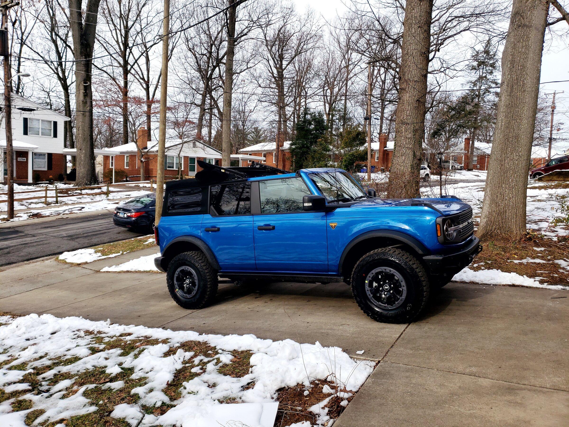

I’m in the same boat as you, And was curious if you did any changes yet? Here is my BL:

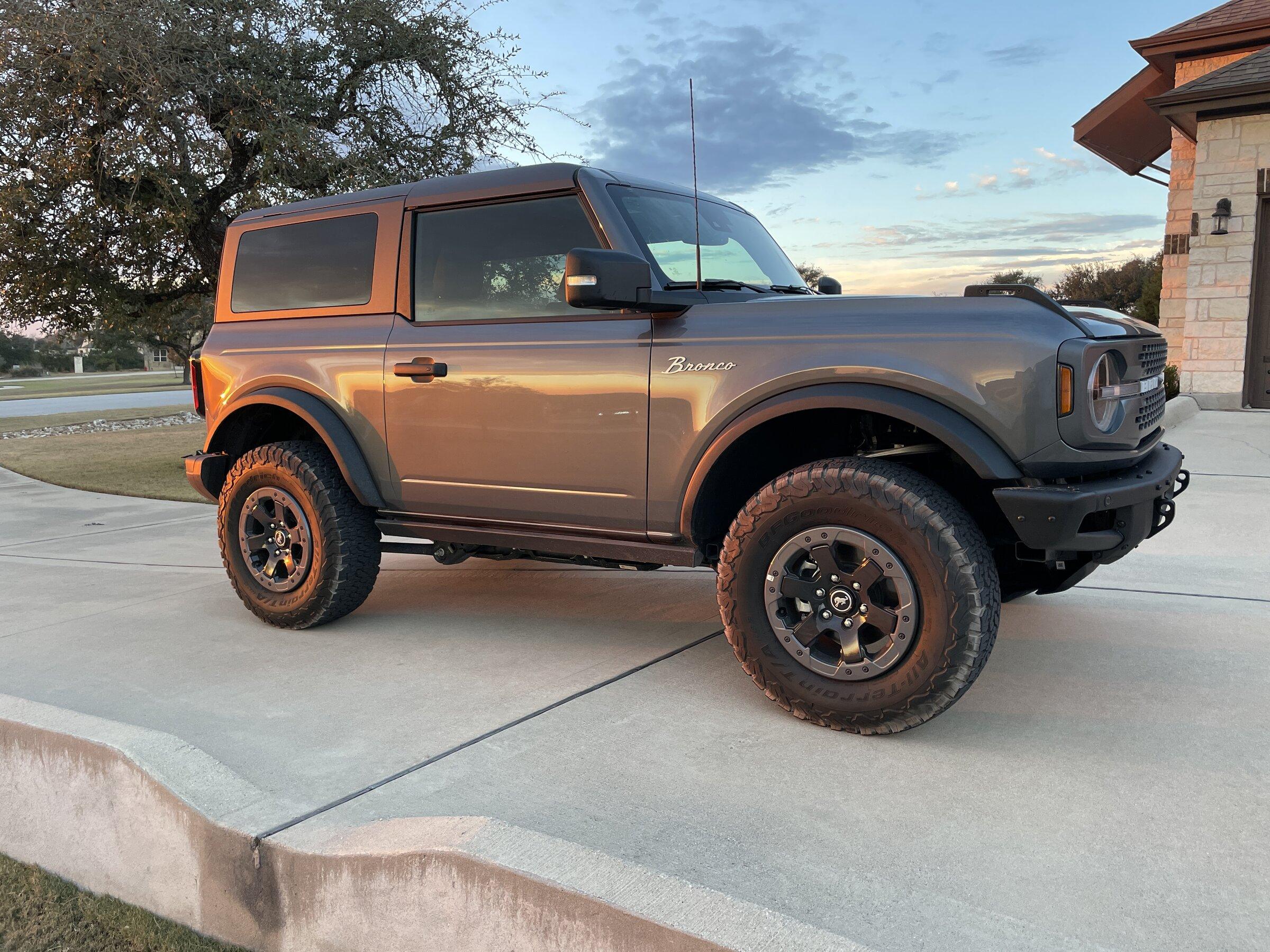

Hey there... actually had mine for about two weeks and love the look and handling as is. I also really like having crash bars for peace of mind. I may move up to 35s* with a lift at some point, but for now loving life.
