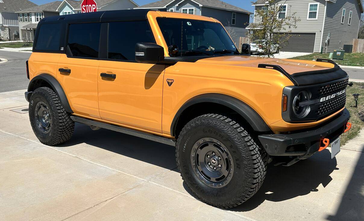

Ford Bronco 35s on a base badlands? 1742774106650-st
Yet another stock (suspension wise) '21 Badlands Non-SAS, with everglades wheels and tires. I did do SAS flares, but they weren't on yet in this picture.
Only removed the crash bars.
BUT if I had the choice, I'd have just got SAS to begin with.. My first Bronco was a demo unit I lucked out on, and this is a used one.. so I didn't really have the choice :)
That's a Turn Offroad hardtop.
Now I need to sell my badlands (bead lock capable) rims and tires and the original flares once I clean em up and make em all shiny.
I might go for some Hoss 3.0 takeoffs... or just bilstein 5100's.. gotta keep it low enough to still fit in the garage :)

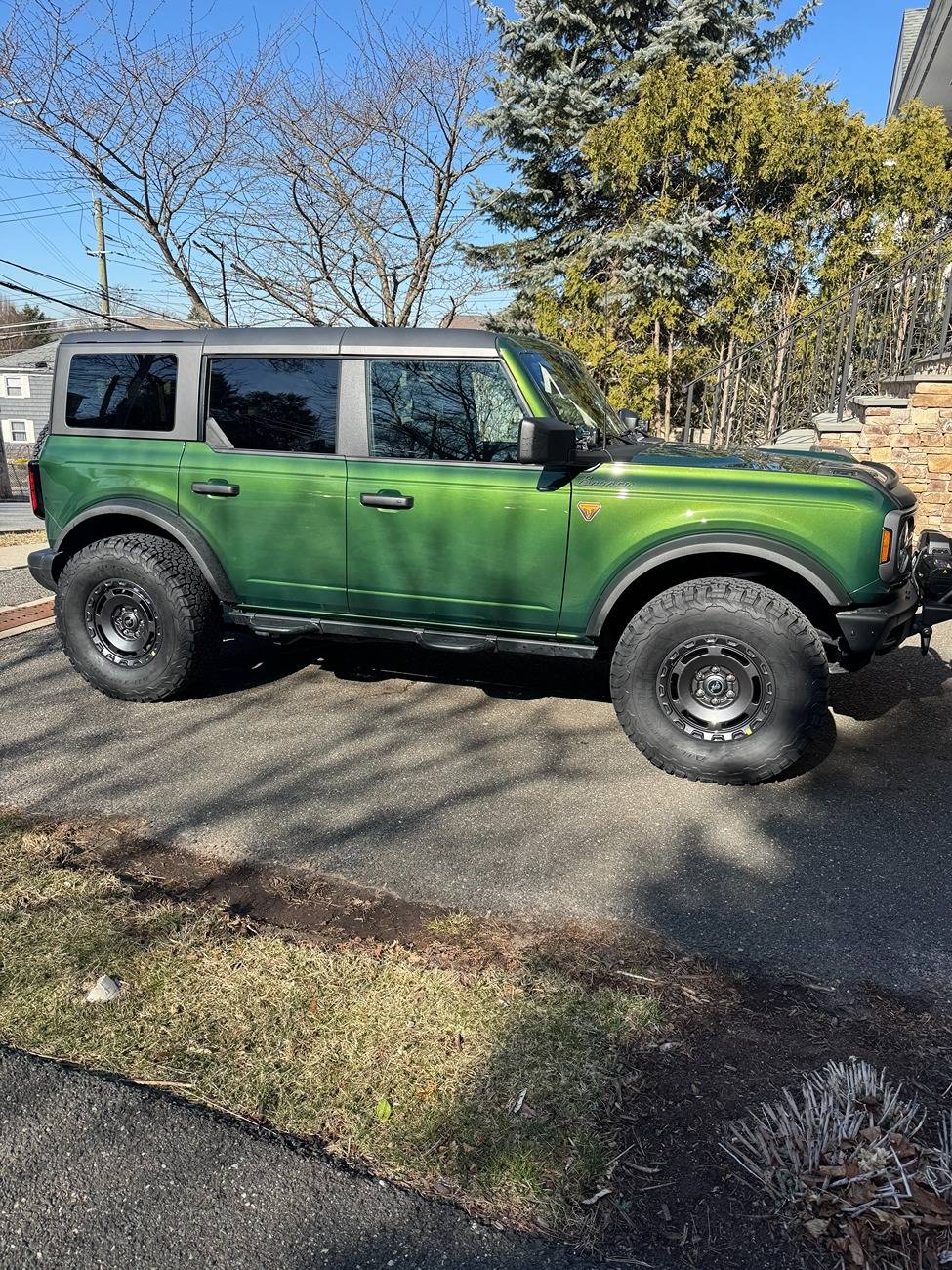

2024 Bronco Badlands
1.5" Level Kit and Crash Bars removed!
Ford Bronco 35s on a base badlands? IMG_0995
