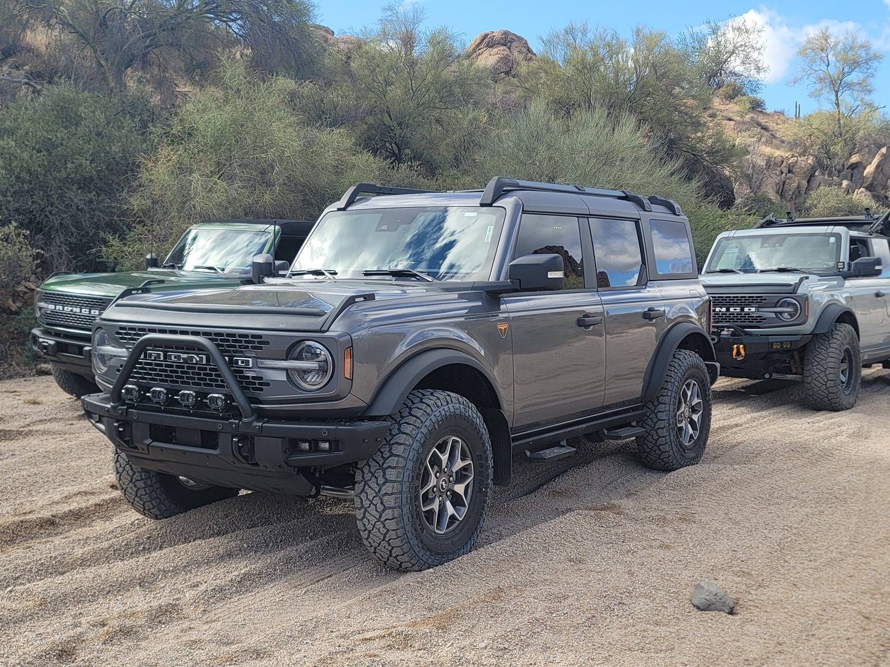

Ford Bronco 35s on a base badlands? a2dd4344-038a-4baf-b877-ececa37f719b-1_all_450
My Badlands non sasquatch. 35 10.50 17 Kenda Klevers. I modified crash bars. 1 in leveling lift on front. Wasn't needed for the tires, i like the look better leveled

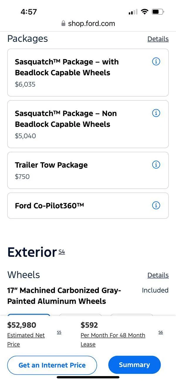

I believe the general consensus is that unless you are really going to trick this thing out with some wild aftermarket suspension and wheels, it is preferable to get the sasquatch package from the factory.
I'd say this isn't bad advice --- except for Badlands trim.
Which already has everything SAS has (or better), just on 33" stock tires.
Like @Tricky Mike said, all you need to do is get a set of take off SAS wheels, new wheels with a bit less positive offset, or use a 1" spacer... and 35"s fit perfect on Badlands.
SAS on a badlands is essentially spending $5,000 for a set of SAS takeoffs that usually run around $1000-$1500 depending on the part of the country you are in. On the other trims, you get a lot more toys, but Badlands already has them, but you still pay nearly full price for SAS uprgade.
The only other thing you are missing is about a 1/2" bump stop on the shocks...
Now if you come across a BadSAS on the lot and get a good deal, I won't look down on you for it or anything. But Badlands trim is the exception to that "just get SAS advice", that otherwise is pretty sound.

Just posting my source, from Build-A-Bronco Badlands 2Dr
Ford Bronco 35s on a base badlands? IMG_2424
