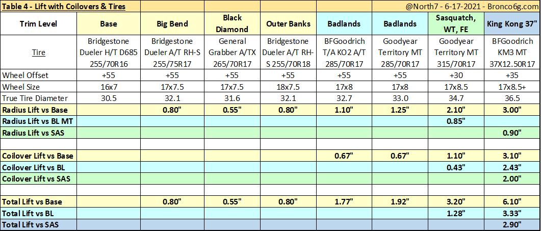

Per the thread below, your Badlands wheel is 8" wide. Per tiresize.com the minimum wheel size for the 35" - 315/70R17 is 8", so the answer to your question is maybe, however as for offset, +55 vs +35, you could run a spacer but some do not recommend them, without it, your tires will rub on the control arms.
Next is lift, the Sasquatch on 35" tires has an additional 0.43" lift vs the Badlands, you maybe okay without it, if you do not intend to do aggressive off-roading but still you want to watch for rubbing.

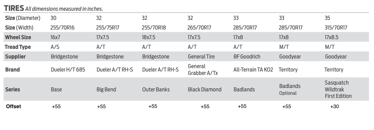

It's pretty well accepted that the 285 is the widest tire you can run on a +55 wheel. Any wider and the tire contacts the Upper Control Arm.
This is why the Squatch wheels are a +30 offset, it pushes the wheel/tire out away from the suspension by about an inch.

You’re going to need 1” wheel spacers to run 35’s on the optional badlands wheels.
Badlands optional offset is 55, Squatch is 30.

Also, here are the wheel specs. As mentioned, optional BL wheels are the incorrect offset and 315 width tires will not clear the UCA. You need an offset of at least something in the +33 for tires that wide to clear.
