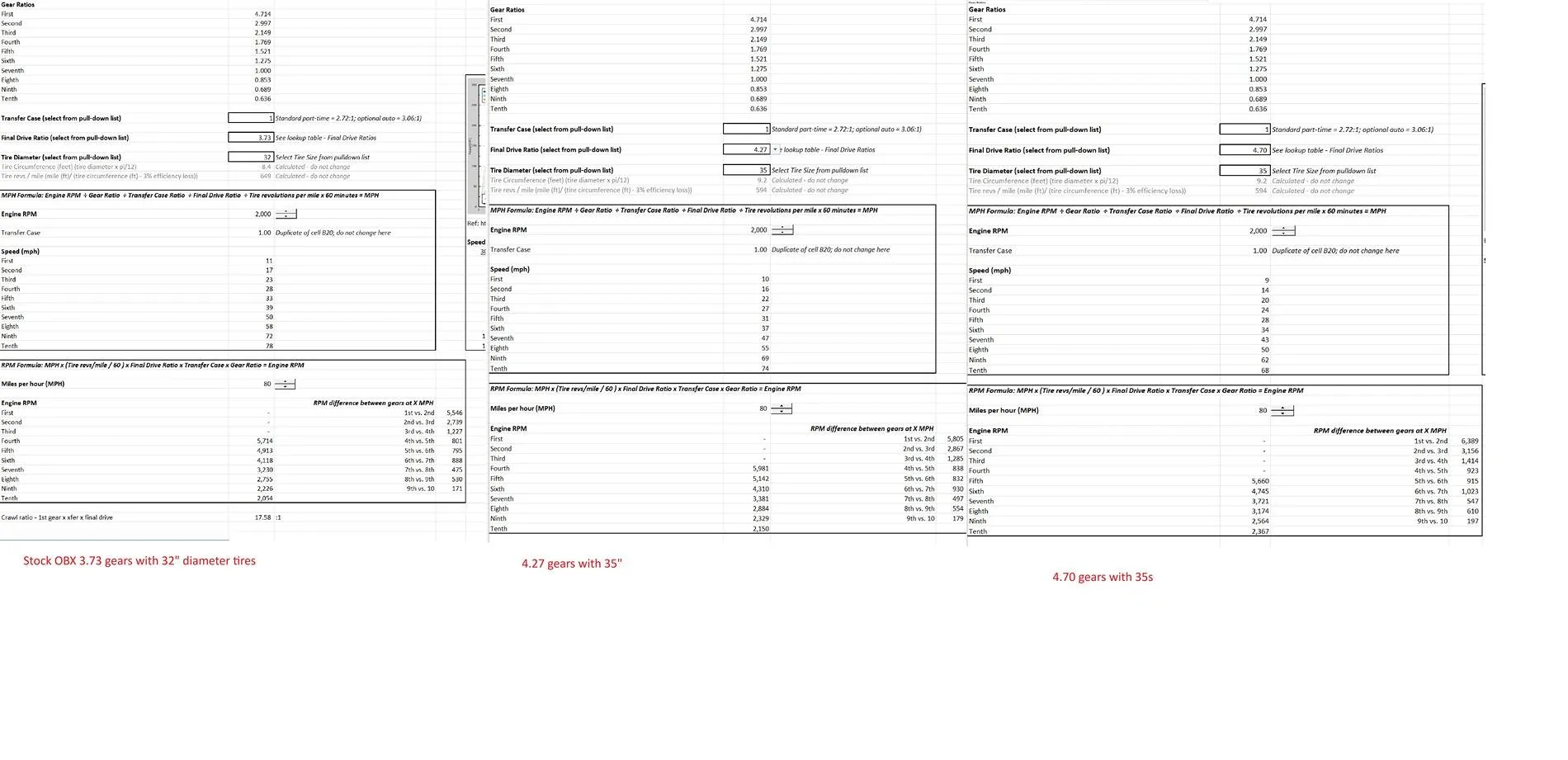

Use a gear calculator. I played around with one before I decided to go 3.73s.
I run 33s now, and am moving to 34s.
35s are OK for 3.73s, but I'd prefer 4.27. The 10 speed really helps there. Just make sure you recalibrate the computer, so the speedo and trans are happy.

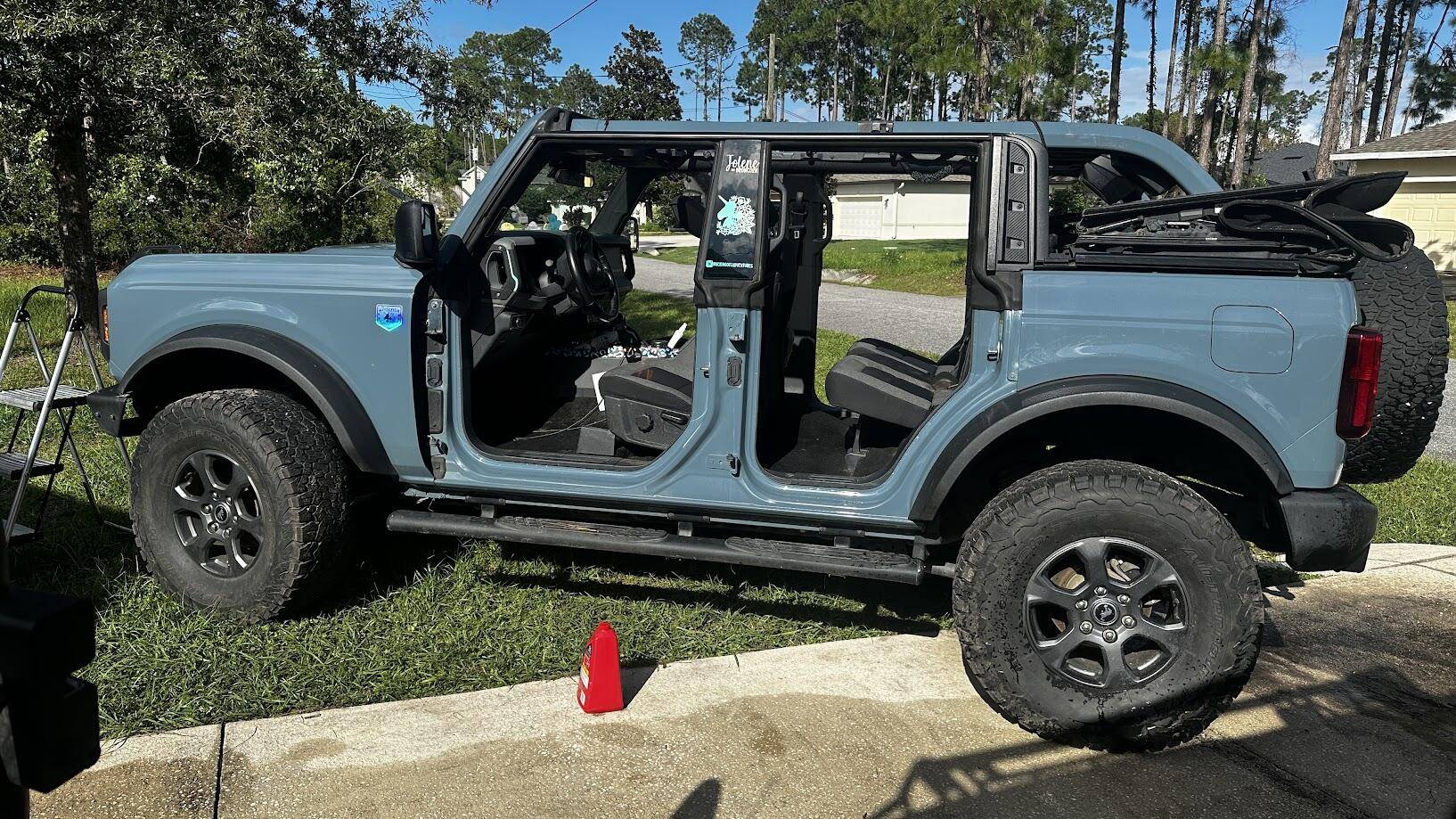

zero issues running 35's on our big bend with 3.73's. it is quite peppy, and holds its own offroad too
Noremac
Mar 6, 2024
359
935
East Coast Florida
2021 Bronco Badlands Sasquatch
2 inch lift for the most part right?
Correct, its a bit taller in the rear right now. about to go up another 2" in the front for 37's
