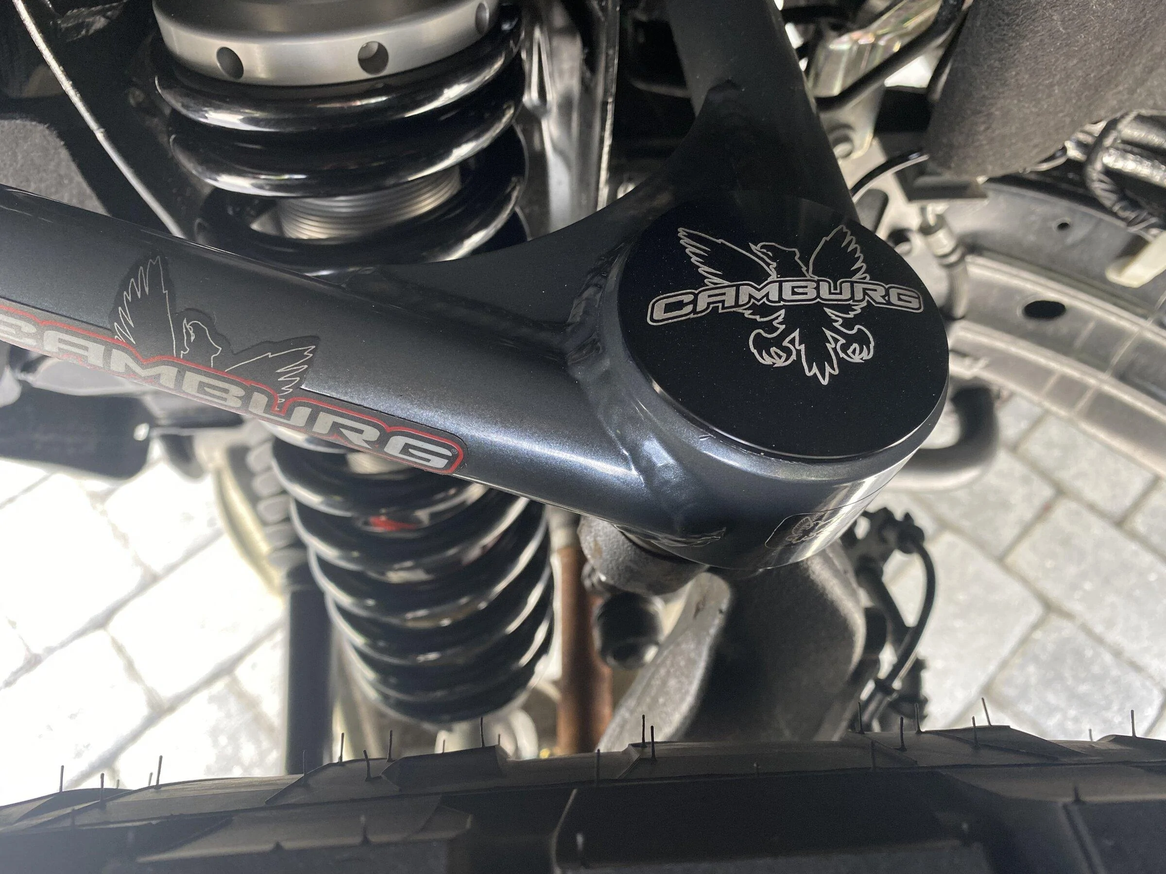

Just to be clear, are you wanting to go 3"-3.5" above Squatch height? There is not an adjustable coilover available that will give you that much height. You would probably need a combination of coilover + spacer lift to go that high and then diff drop, uca, rear track arm and rear lower links.
Now, if you are wanting 3-3.5" above stock height that is achievable with any of the available adjustable coilovers and would give you enough lift to run 37's with out rubbing. Skip the added spacer lift and the diff drop but add the uca, rear track arm and rear lower links.

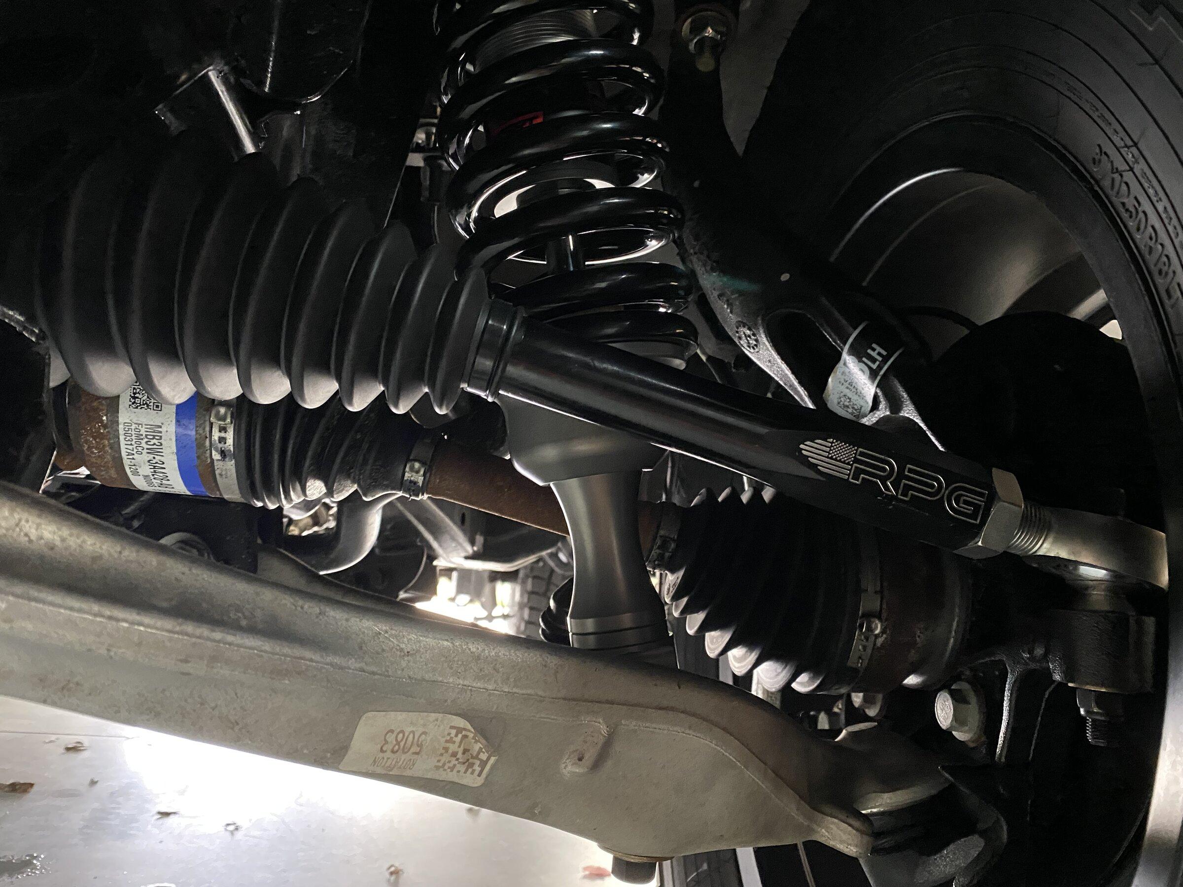

If wheeling hard or rock crawling, some other parts to consider are the BroncBushing, to better keep the steering rack engaged, and possibly some upgraded inner tie-rods (or at least keep a spare stock inner tie-rod with your recovery gear)
