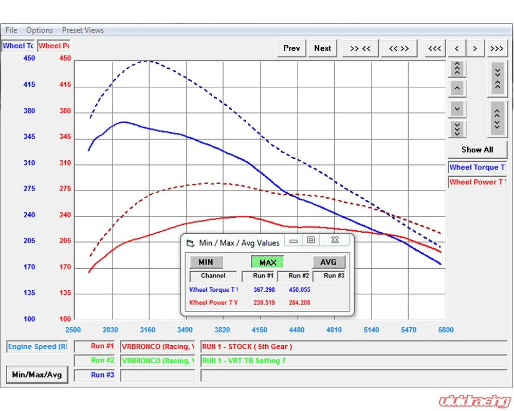

Bump up to 364HP sounds fun. Worried what the drawbacks are

I was thinking the same. I thought the trans was only rated to 450 lb ft or something like that. This tune shows 450 at the wheels which would be even more at the trans input shaft. 🧐

I'll be looking forward to hearing whether this gets rid of the launch nerf and what, if anything, pays the price for 500 torque from a standstill. My gut tells me it's the 4A transfer case clutch and I certainly would tread carefully in 4A with a tune until we figure out how stout it is. Despite the 10R60 disappointment, it's probably going to be fine in the Bronco due to the lame tow rating.

We need more info
It says it has 7 different maps My guess is it has a 87oct Eco, Tow, Race, Then same for the 93oct then a stock mode.
Need more dyno #s (I'm betting the #s above are 93oct Race)
I have a badlands so no Sport mode I would love to have a 87oct race/sport option this may give it to me.
The 600 newton-Meter rating for the 10R60 is a "nominal" rating which generally means a steady state rating and not necessarily a maximum rating. Of course one is never sure what that actually means for any transmission since each is setup by the engineers for the specific application.
