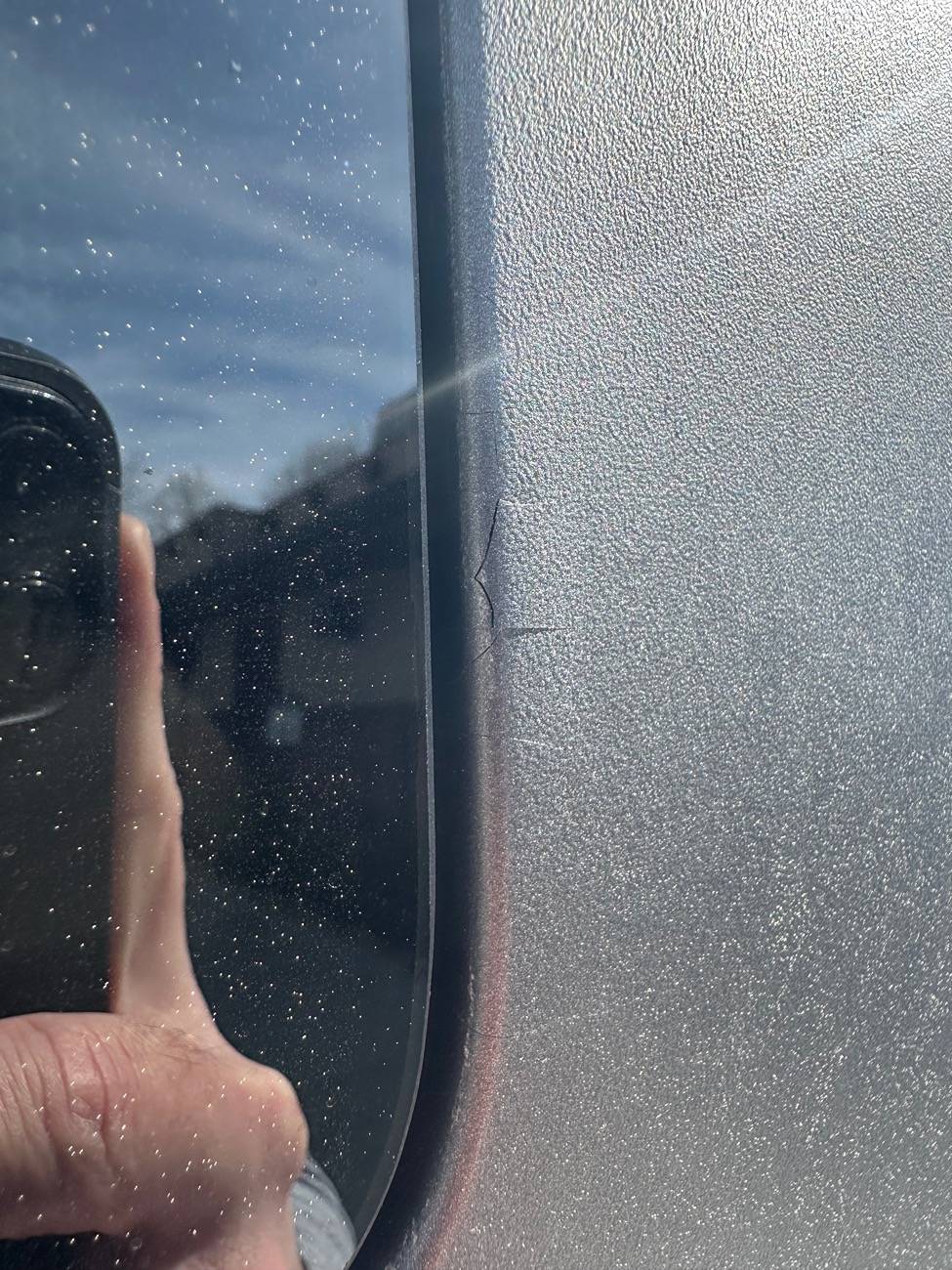

2023 Bronco 4D SAS
Nov 2023 build, badlands SAS 8k miles purchased in July 2024. First crack noticed 2 days ago
Ford Bronco 2025 MIC Top Question IMG_1840

So I ask this question as a perspective buyer, I currently have a 24 Rubicon X. My 3rd wrangler so I know most of the issues with Jeeps (it's usually one of the batteries). What are the issues and causes of these top failures? I've been looking at broncos and scrutinizing the hard tops but I have not found any issues with the ones I've seen. Is this a case of some / a few issues, or most are failing, or it takes several years to develop, happens in cold or hot climates etc.
I can live with having to reinforce tie rods (minor issues - unless it's breaks on a trail :wink:), but the idea of needing a new top, and not being able to easily get one concerns me.
Thanks
When you think you're MIC is safe... it's not. Those cracks will rear thier ugly heads, it's only a matter of time
