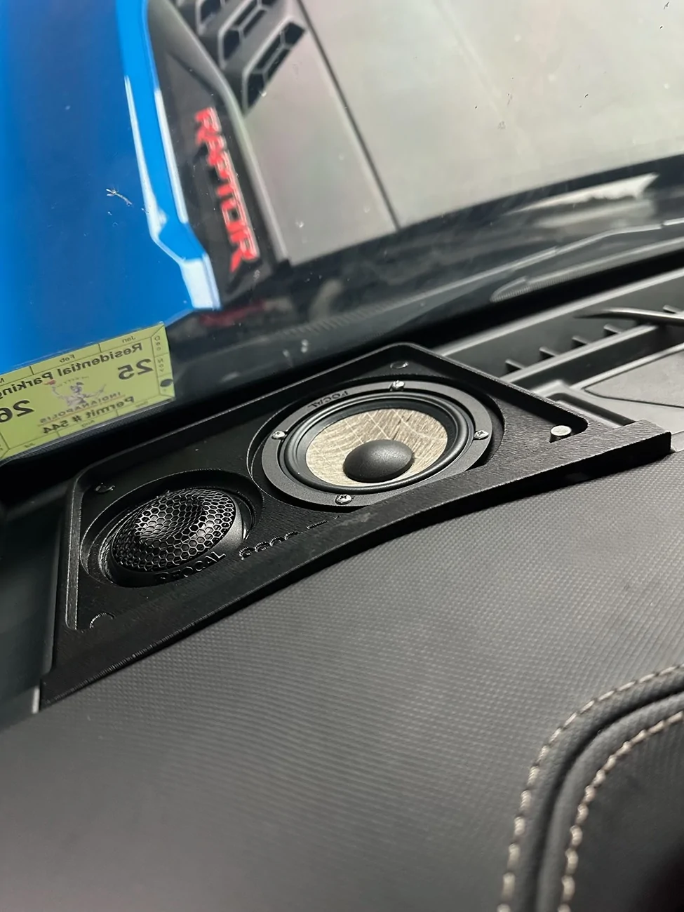

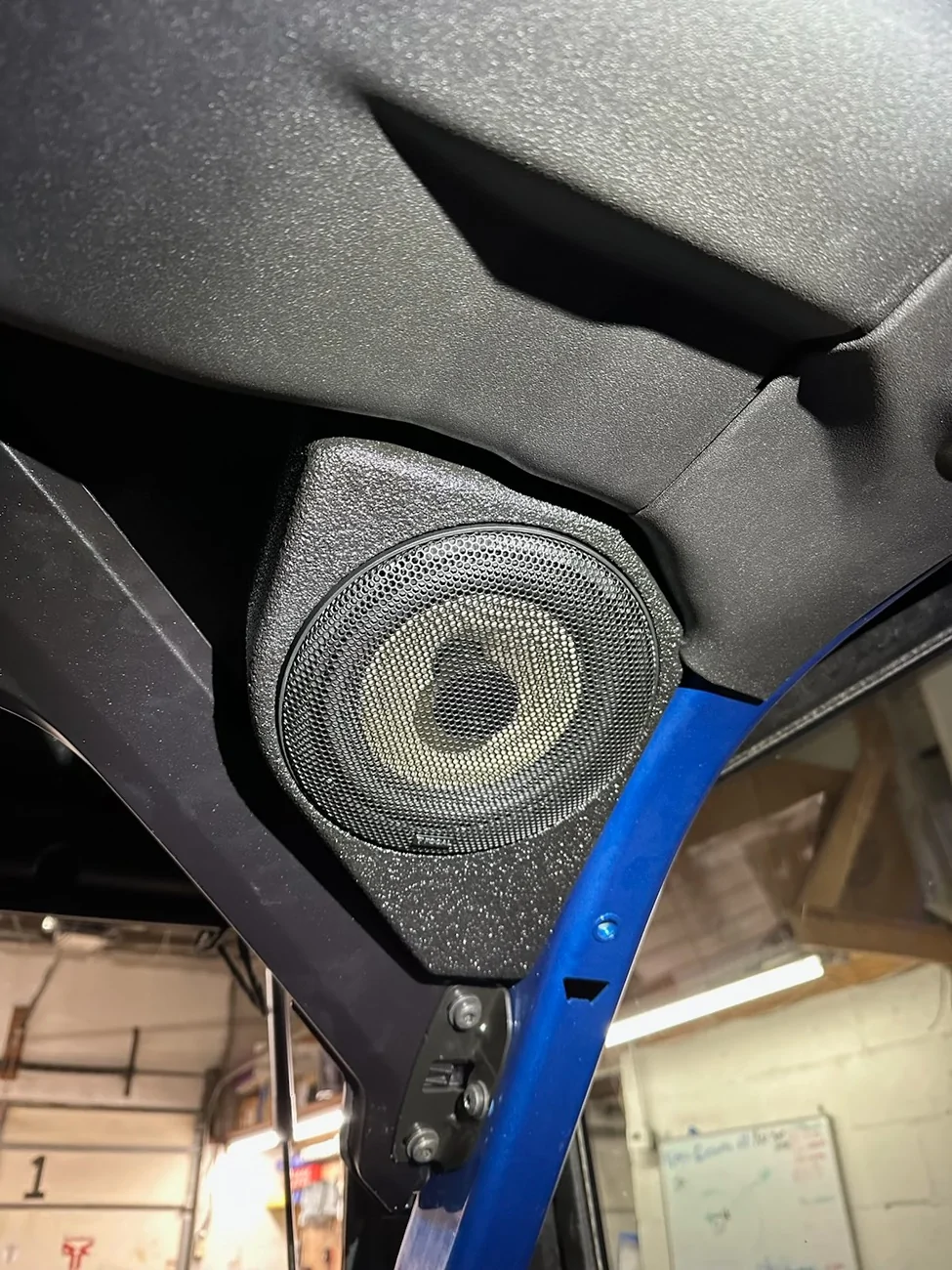

All Focal Flax Evo

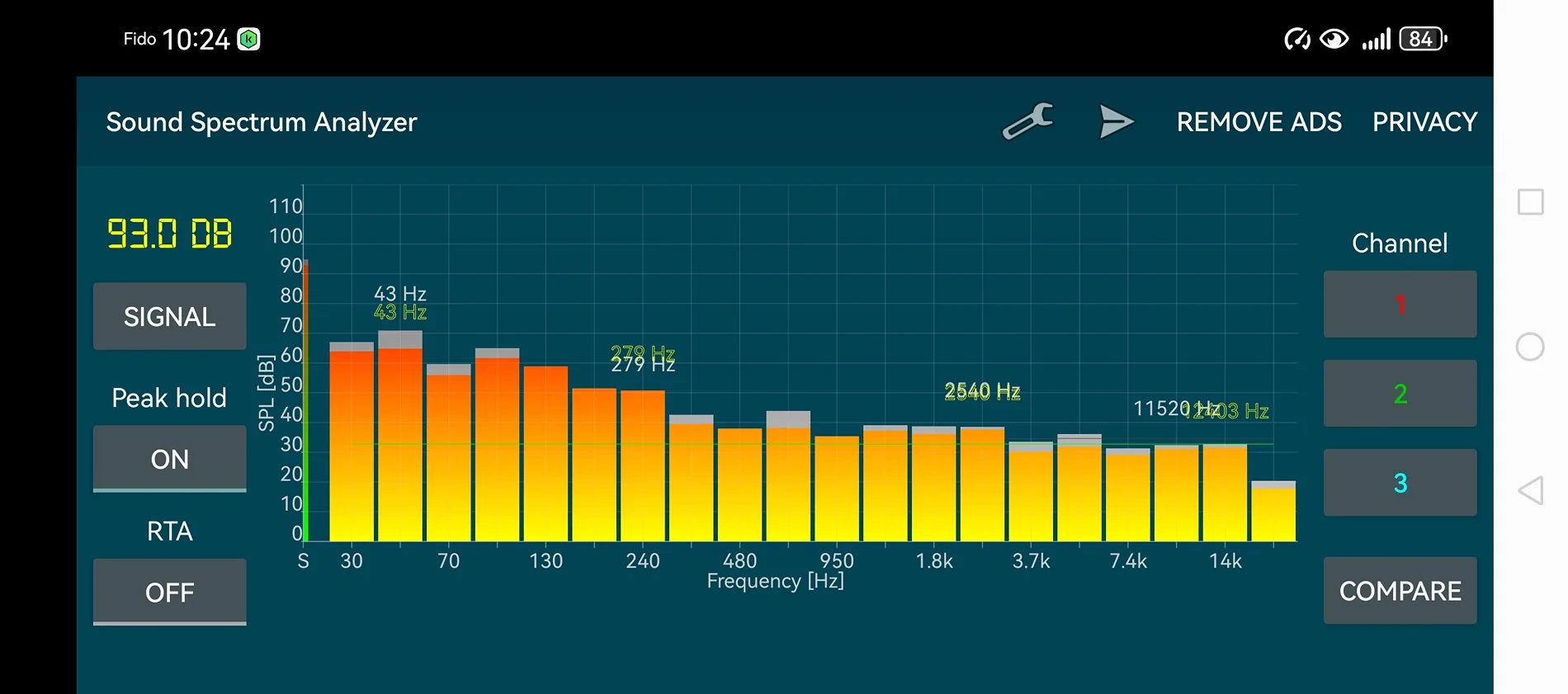

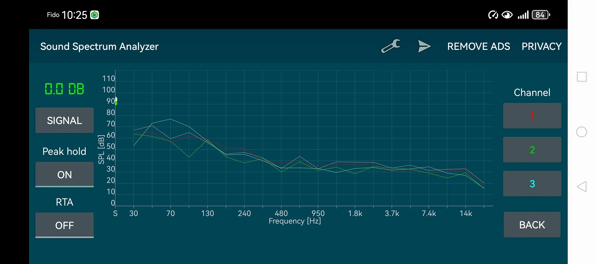

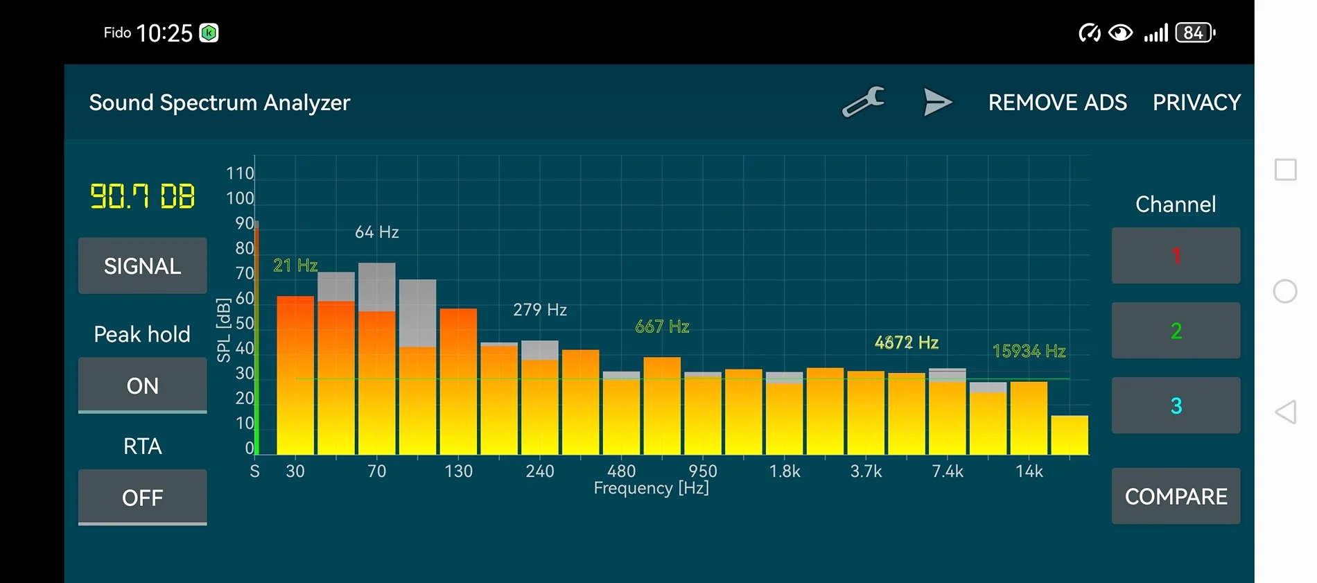

RTA of B&O. with my set up and remote bass adj. Stereo and surround, level 22, drivers seat, Audison wav test track. Taken with Huawei Pura 80 Ultra which has exceptional AV capabilities.
Lots bash the 21-23 B&O but with sound deadening and absorbers, decent speakers and sub, plus sub amp thsy levels high level.signal, its quite good.
Hard to beat the Ford + B&O sound engineers.
