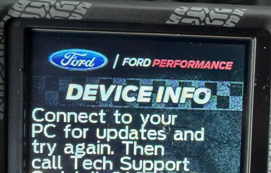

Just realized I forgot to follow up on this in case anyone else runs into issues.
The first to appointment for my tune install it took almost 2.5 hours and they said they could not get the tune to install correctly and asked me to contact FP directly, they did not charge me anything for the failed install.
After I called FP the person I spoke to made a to-do about how he got 20 calls a day from dealers having trouble installing the tune because of their local network security but asked for some information (screen shots from the FP tuning device settings) so he could take a closer look. After about two days of back and forth between the FP support guy and the FP engineering team, they made some kind of tweak on the back end to my device, had me do an update and asked me to go back to the dealer.
Not entirely sure what they tweaked but after going back the dealer was able to get the tune installed successfully in about 45 minutes or so and charged me the quoted $189 (one labor hour for them) to do it.
In case it helps anyone else, when troubleshooting with the guy from FP he had me plug the tuner into my PC and check the Device Info and I had the attached error message that they were able to clear up with whatever they did on the back end.
Ford Bronco 2025 2.3L Ford Performance Tune FP Error
