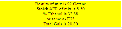

I do about 1/3 tank E85 and 2/3 87. It's like the performance of 93 for less than the cost of 87. I would get a little better range from a full tank of 93 but I don't think it's enough to offset the higher cost. If the OAR gauge is maxed there's not much point in pushing higher octane than it can adjust for.
The issue with that is the amount of E content in the fuel. It can probably handle E30 with no issues but you would be pushing it. If you start to notice rough starts on cold days, this cold be the cause.
Sounds like you know what you are doing. Are you using Swampys calculator?
I can't speak for the Bronco tune, but for my Mustang tune from Ford Performance I did get a sticker to go in the fuel door.
I used the more power tuning E85 calculator to aim for an E30 blend. I started adding like 1/4 gallon more E85 per tank until I found the limit. Above around E33 it threw a lean mixture code and went into limp mode a couple times. It could probably handle a little more since adding a water/methanol kit but I haven't really tried.
What year is your Bronco?
