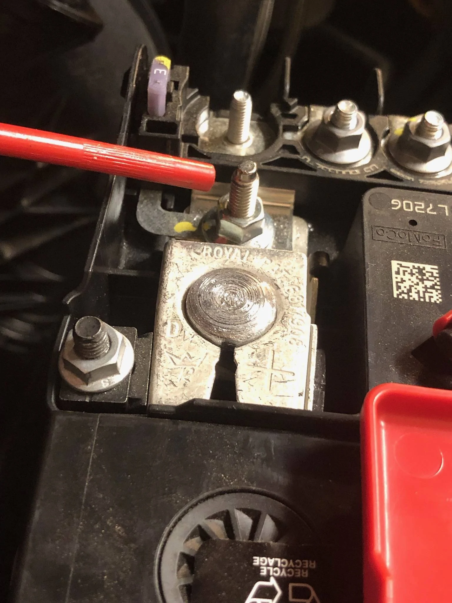

PS.. The only way I see to connect a jump to the positive terminal with via the thin bolt sticking up above it, I see no way to get the large clamp into the actual + terminal.. ??
Shit, might be too late. Can you take photo of that ? In think my POS terminal looks diff.
There's no room on my '24 to connect jumper clamps to the positive terminal or clamp on the terminal, the only thing accessible is the puny 10mm stud shown by the pointer.....

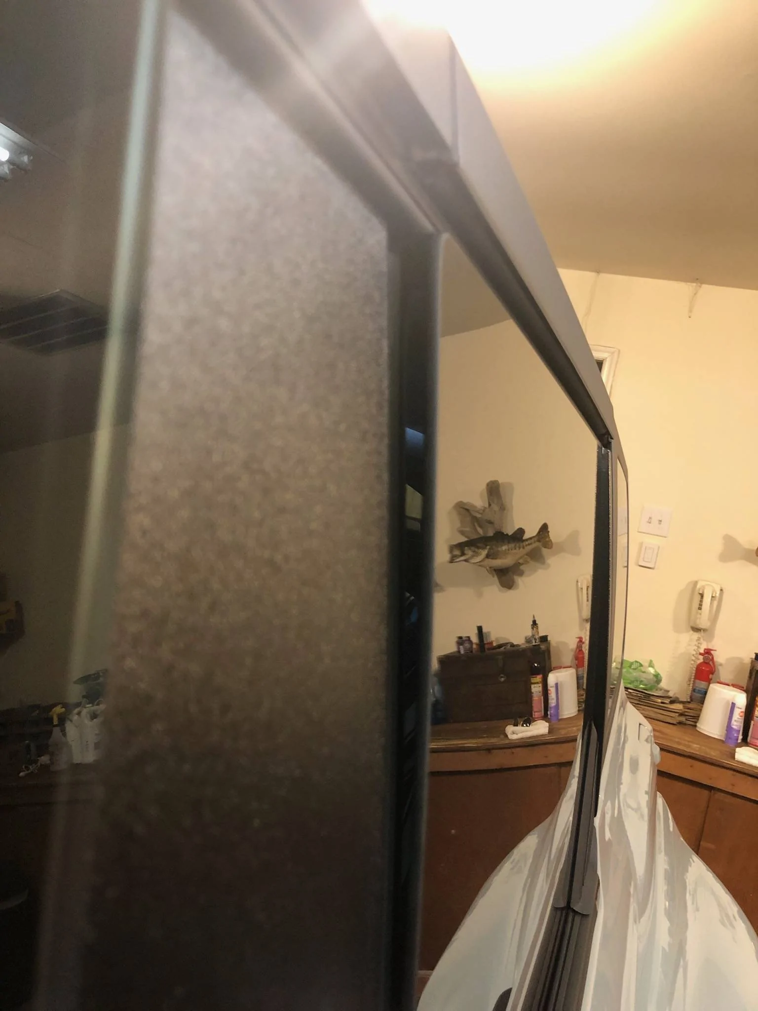

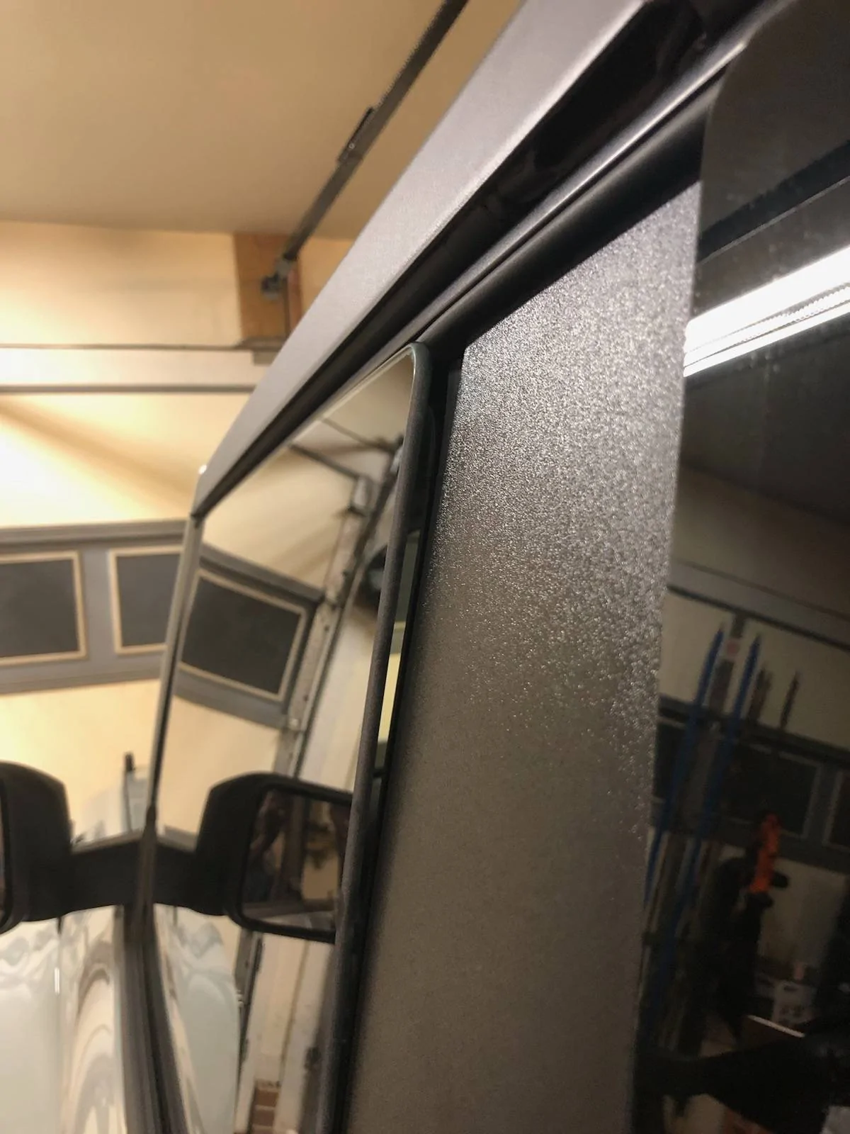

Op here.. This is really weird......
When the battery was at 5.1V I initially attempted to jump the truck with a large jumper pack. The truck acted really strange, a few lights flashed on the dash, the brake pedal pulsed really hard, windows moved, etc. but it wouldn't come close to turning over.. i just noticed this, all (4) windows are now hyper extended... Look at the gap and how high they are.... and I never touched the window switches. Hopefully the new battery and voltage resets everything back to normal.....
