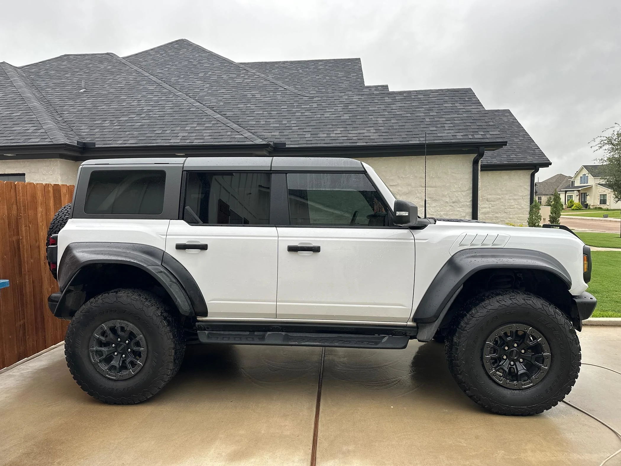

Hey all. I upgraded from a Wildtrak that had some rear wheel issues and eventually had to have the axle replaced so it wouldn’t throw codes and systems not work properly. Now I have a 2023 Bronco Raptor. It’s my daily driver. Drove it on Friday. Did not drive it Saturday went to start it Sunday and the entire car was dead. It threw brake codes and a few other things, anybody had issues like this before? I bought it brand new. Little over 10,000 miles. Pic for tax😉

Haha noooooo! It started again after one hell of a recharge. Just no idea why it went dead in the first place.
