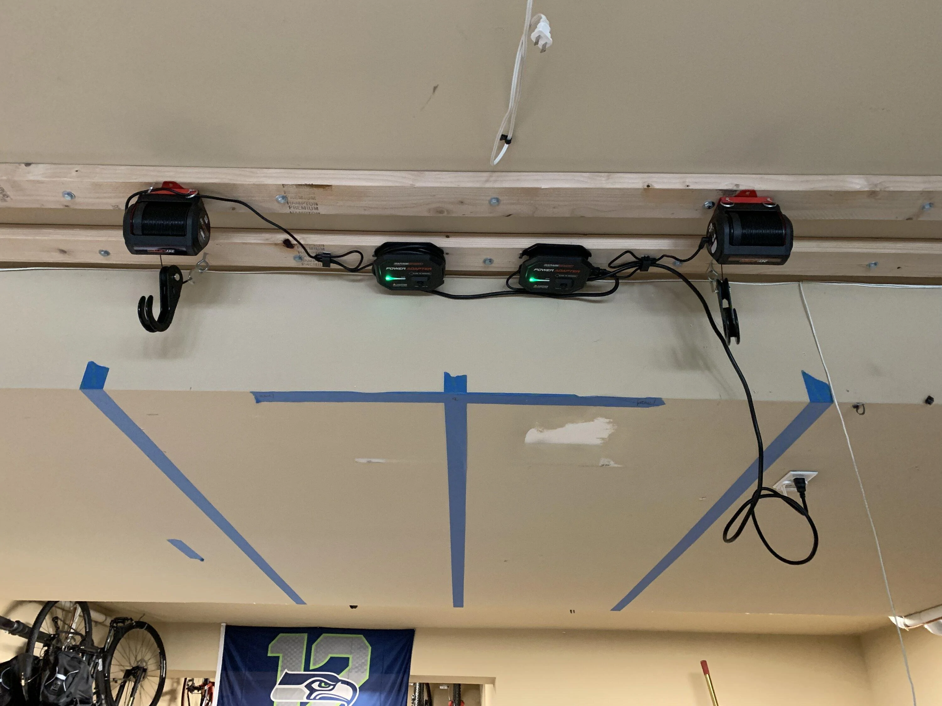

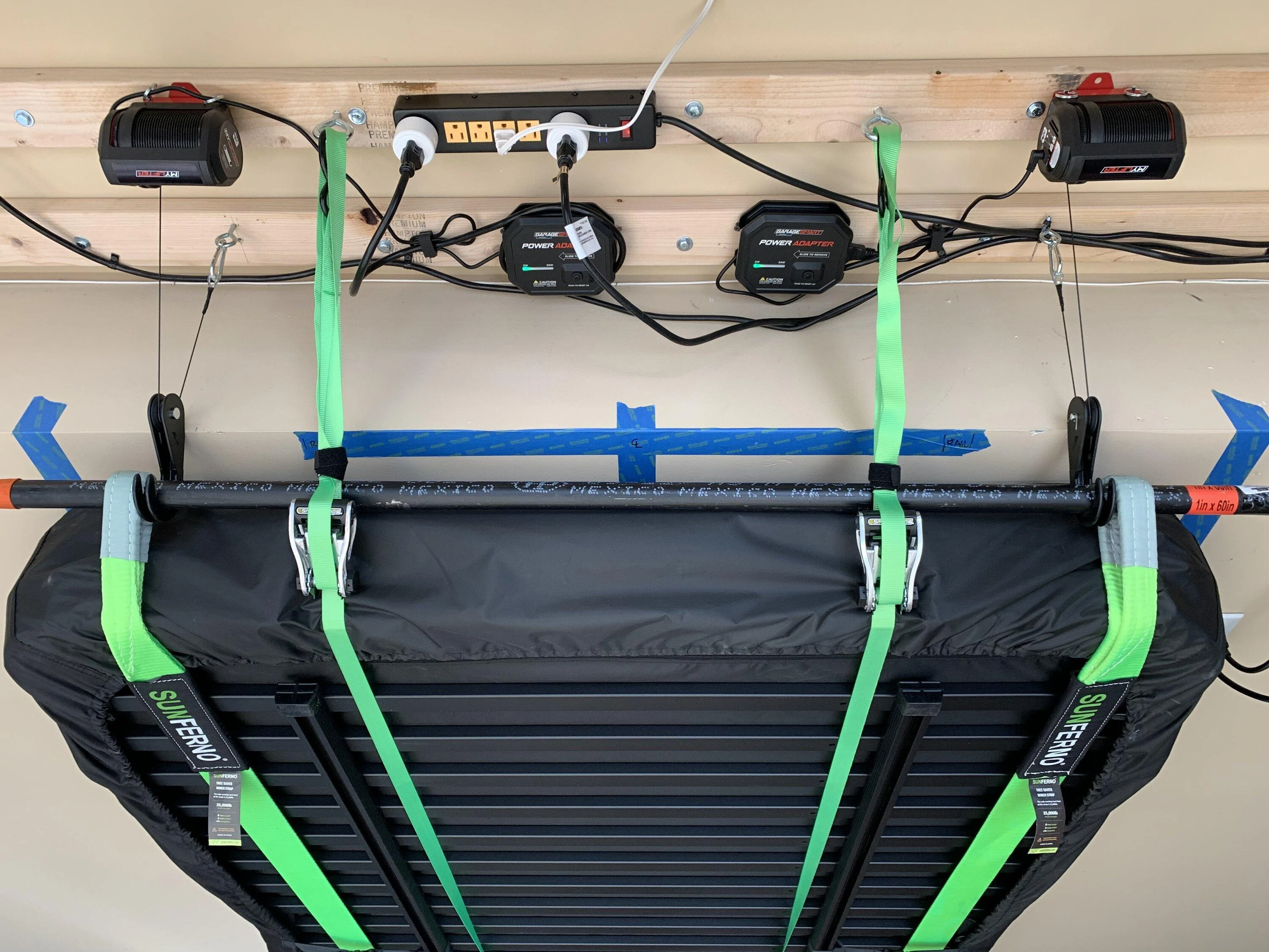

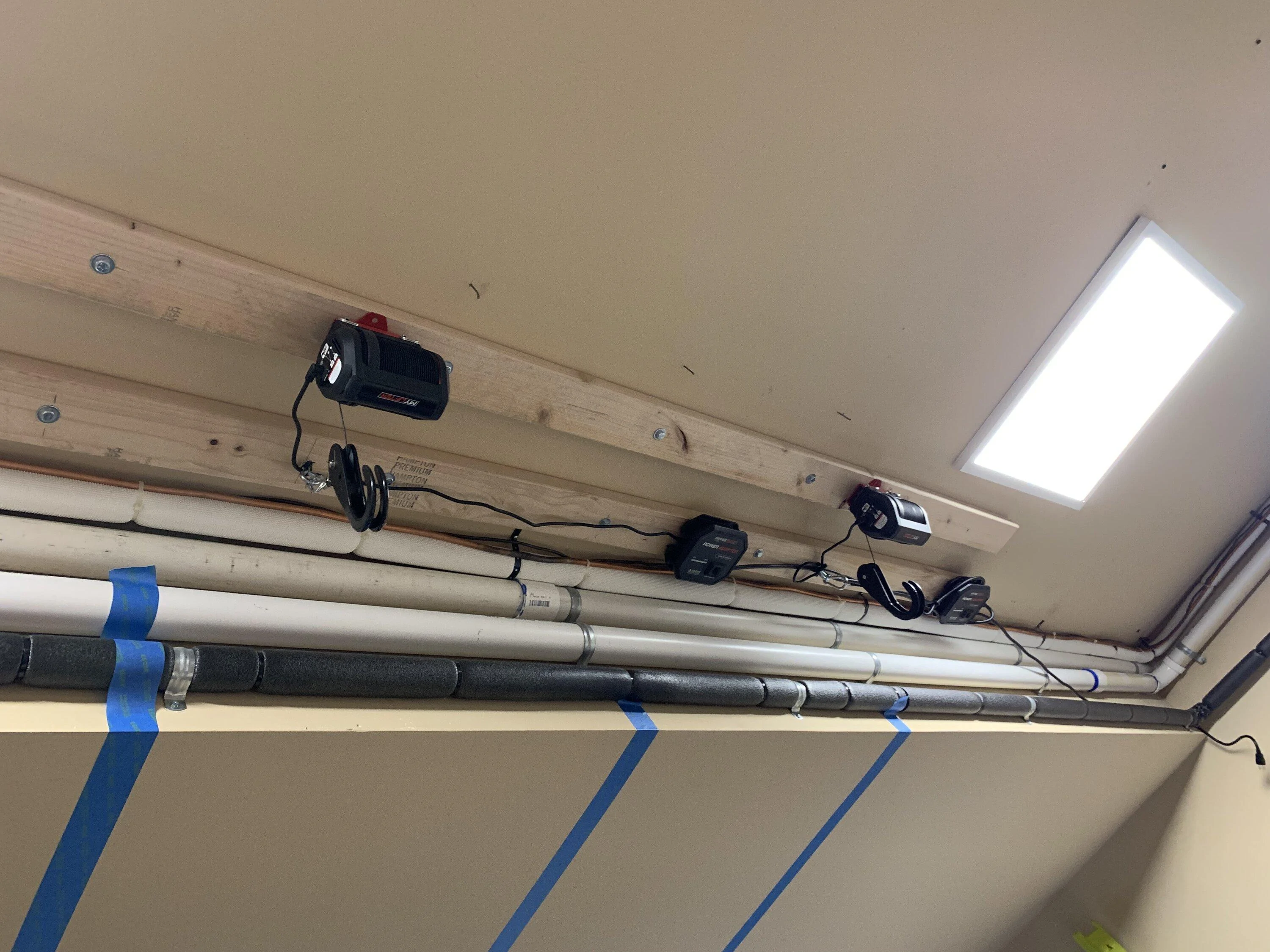

My Gobi rack/light setup is coming together. Most ordered parts are in my garage. I devised a plan to remove and store my 172lb RTT and installed winch/pulley system yesterday. Will test today. Using Smarterhome Garage Lifters.

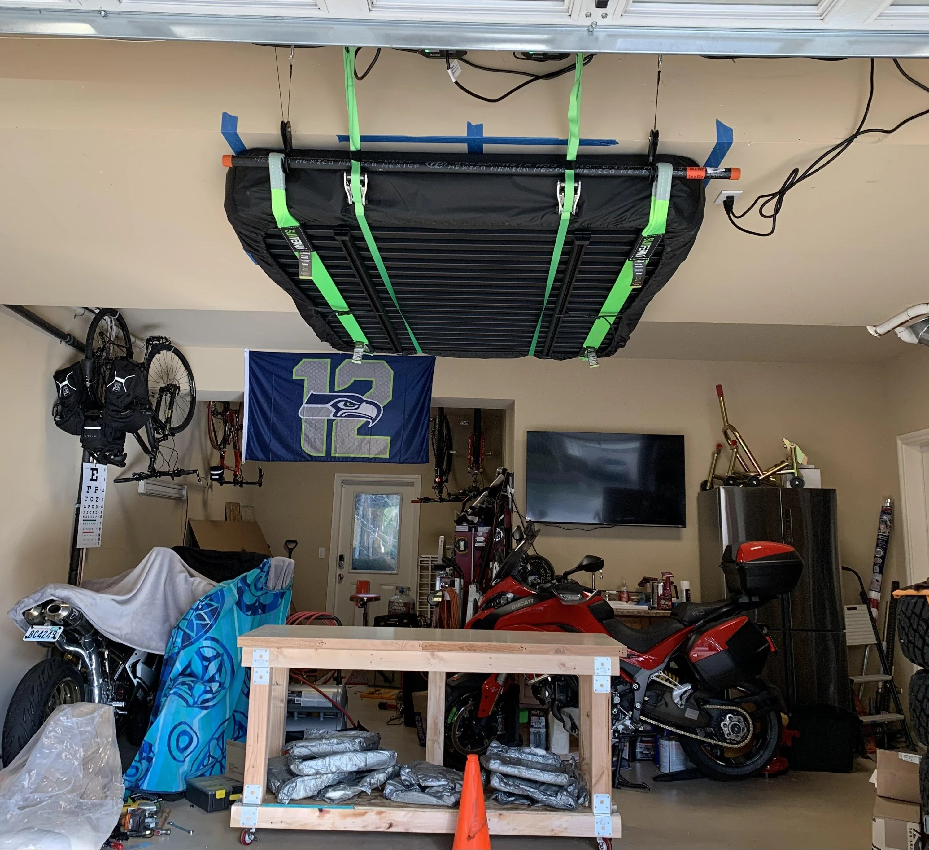

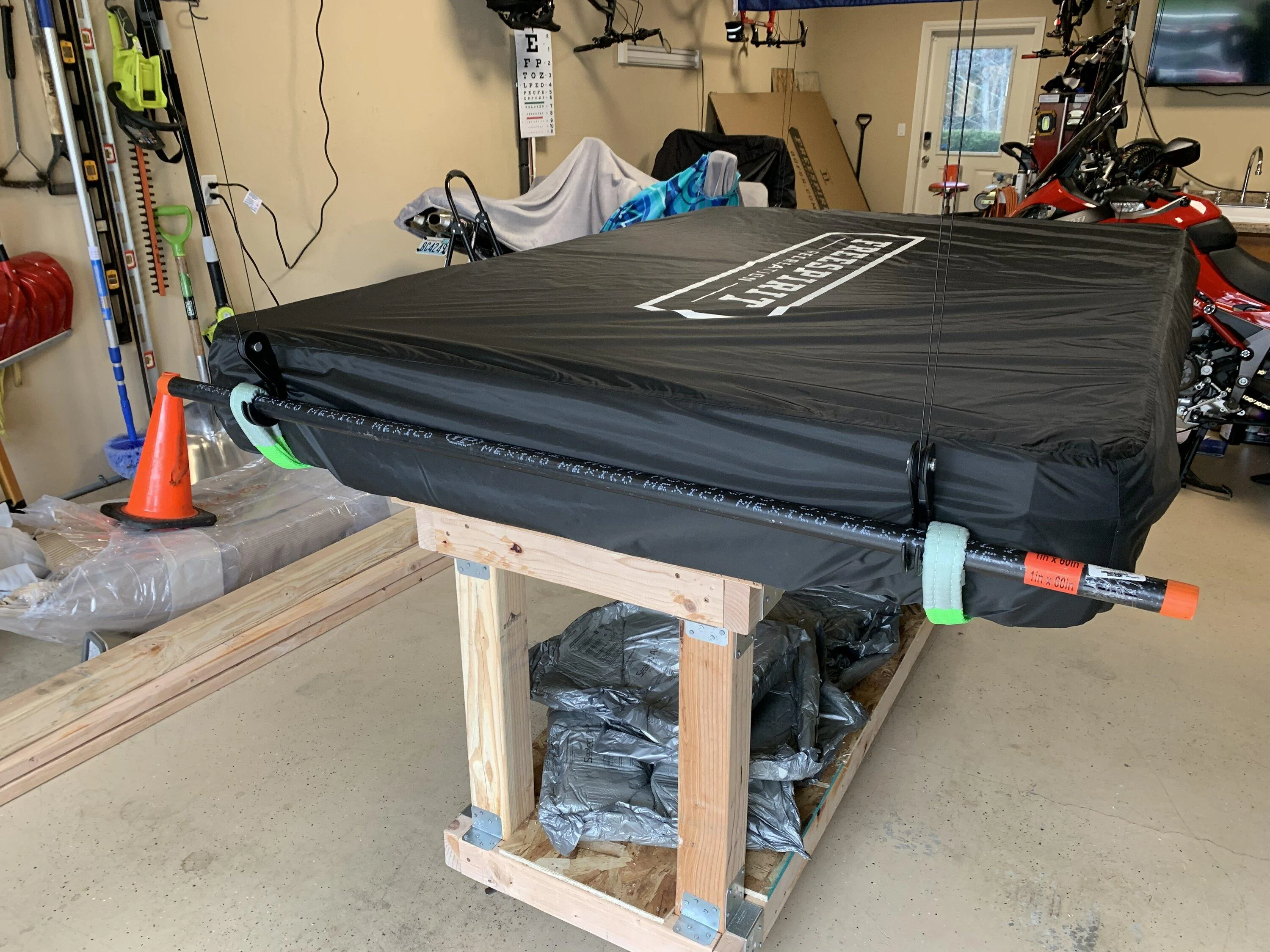

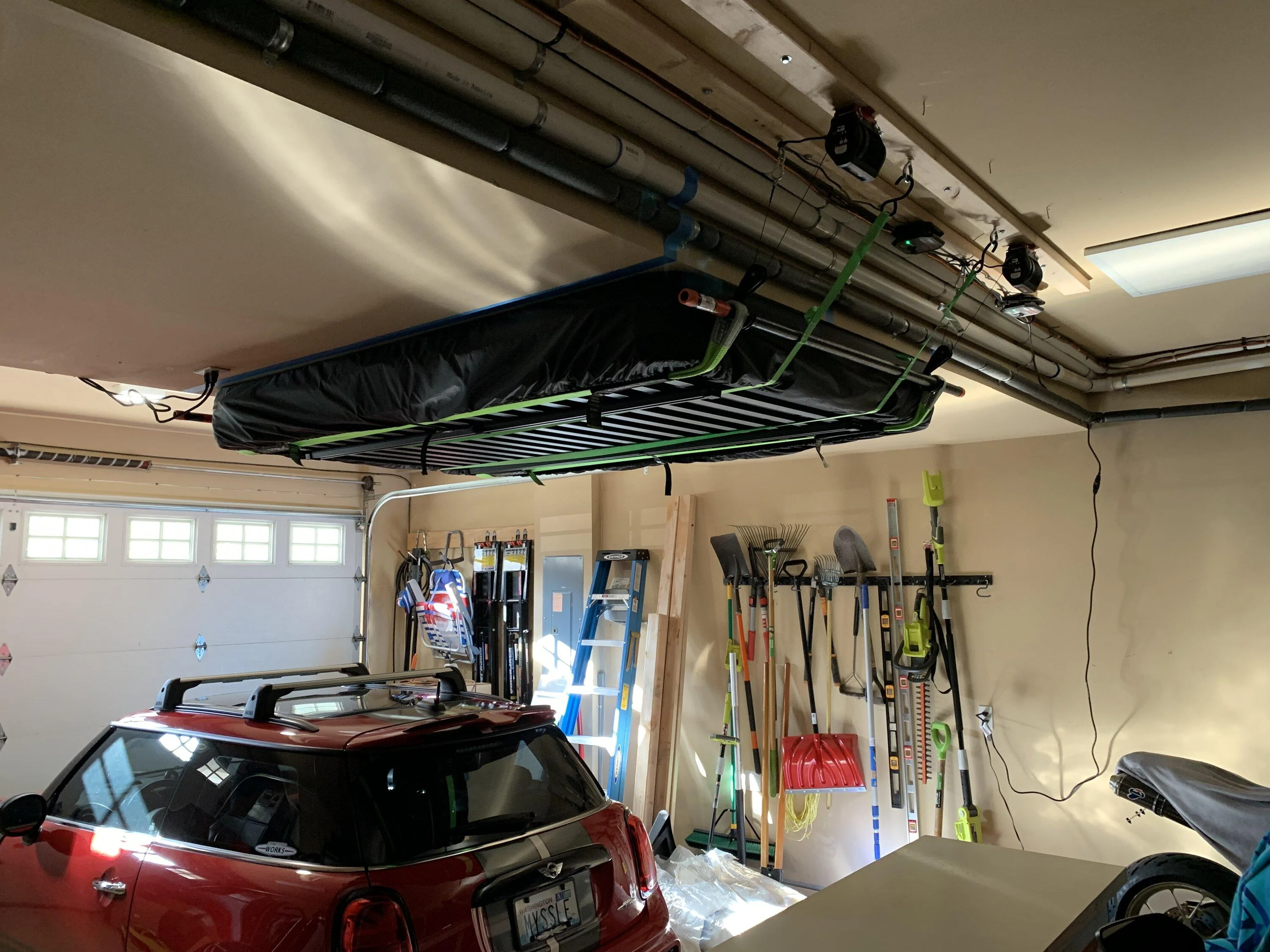

Freespirit Evo2 RTT secure to the ceiling. Lifted with Smarterhome Garage Lifters (4), secure with ratchet straps and straps connected to the lifters. A weekend job but accomplished and done. Super easy to raise/lower.

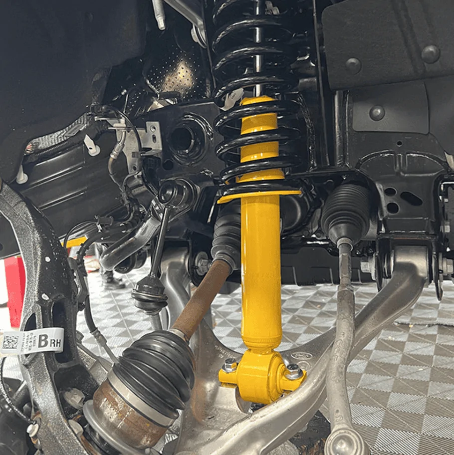

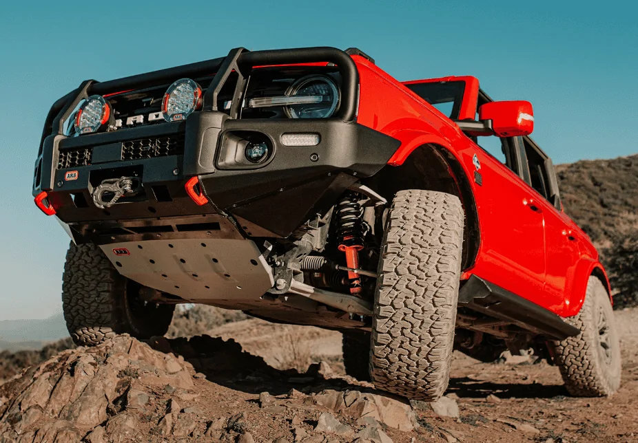

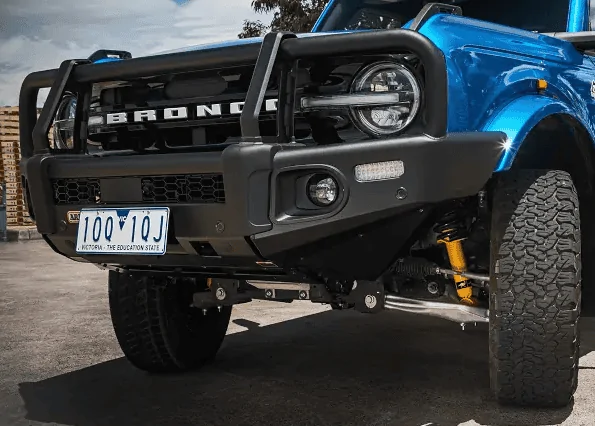

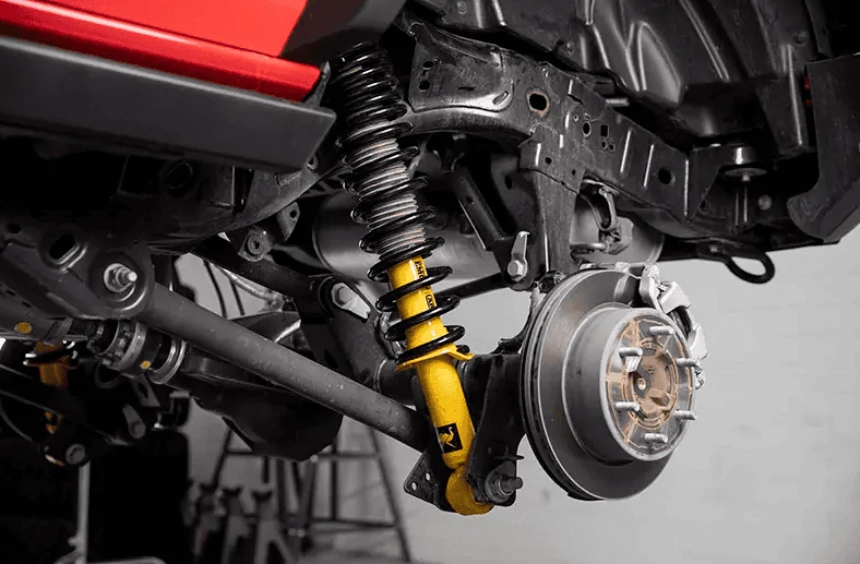

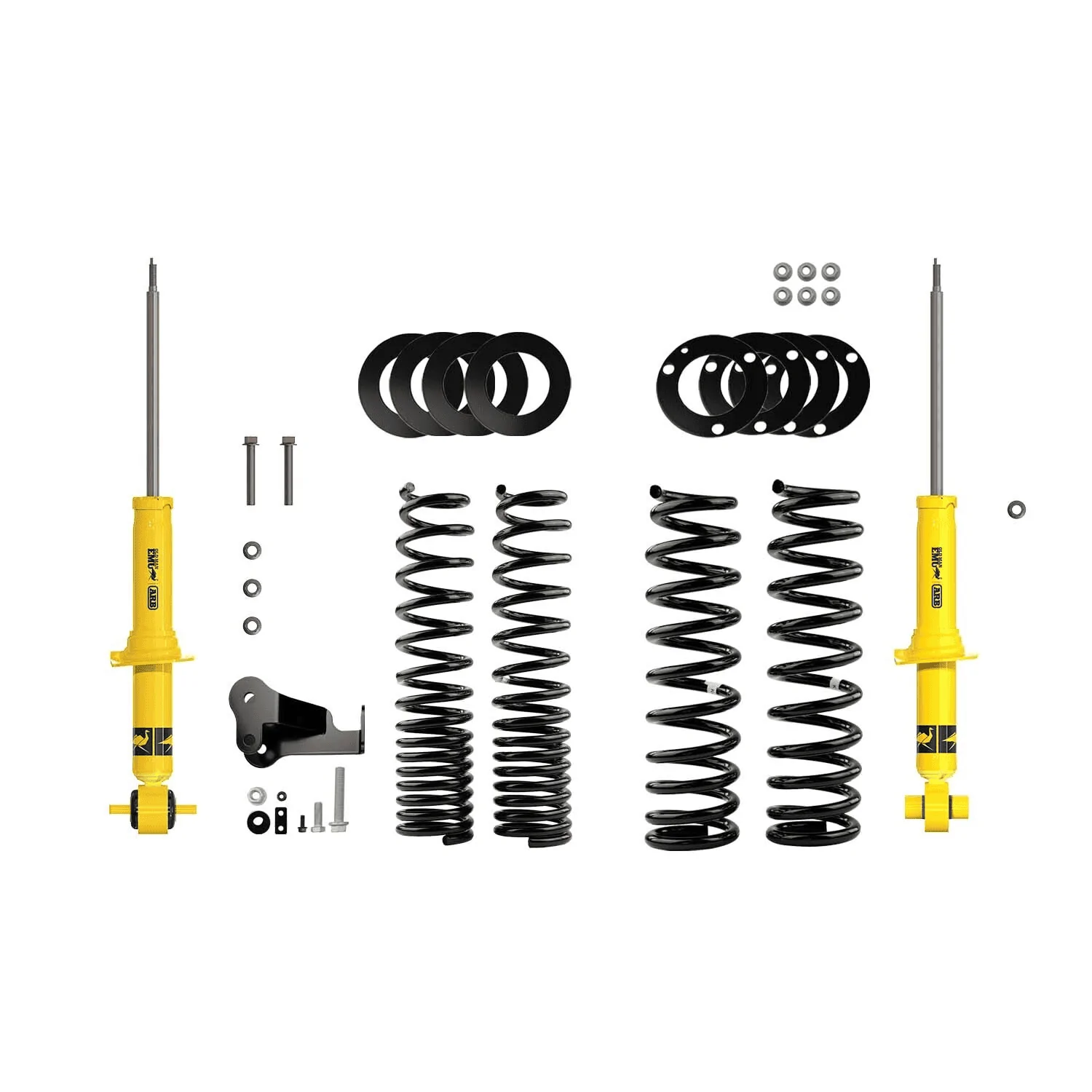

Suspension Update:
After an exhaustive search/research of suspension systems offered today for my application, I've decided to give OME Nitrochargers a try. I have ordered the BRONHK3 (Heavy/Heavy) kit. I looked at all companies I knew/learned about, made several phone calls to many of them, learned of what they offered TODAY and how it's not what I need for my build. Many of them are developing heavy springs for a future offering but OME has really dialed it in over years of usage on other rigs, so going to tried&true ARB/OME makes sense. I did become intrigued with Ironman4x4 FC Pro technology and maybe in the future I would upgrade but at the moment they have nothing for the Bronco. Bilstein 6112 was an option but even Bilstein agreed I need a heavy spring they don't offer yet (btw Eibach makes Bilstein springs). Both OME/Bilstein require use of my top hats.
The engineer in me researched this to death but I suspect I will be very happy with the OME choice and will report experience when I finally get it all done.
Any reservoir system was just not the application for me as they are designed for high speed off-roading of which I will not be doing. I will be loaded with upwards of an 1000lbs and plan to go slow off-road.
Anyway, that is my story and decision and hope my experiences and discoveries can help anyone in the same position.
Some great pics/videos that helped me make my decision are:

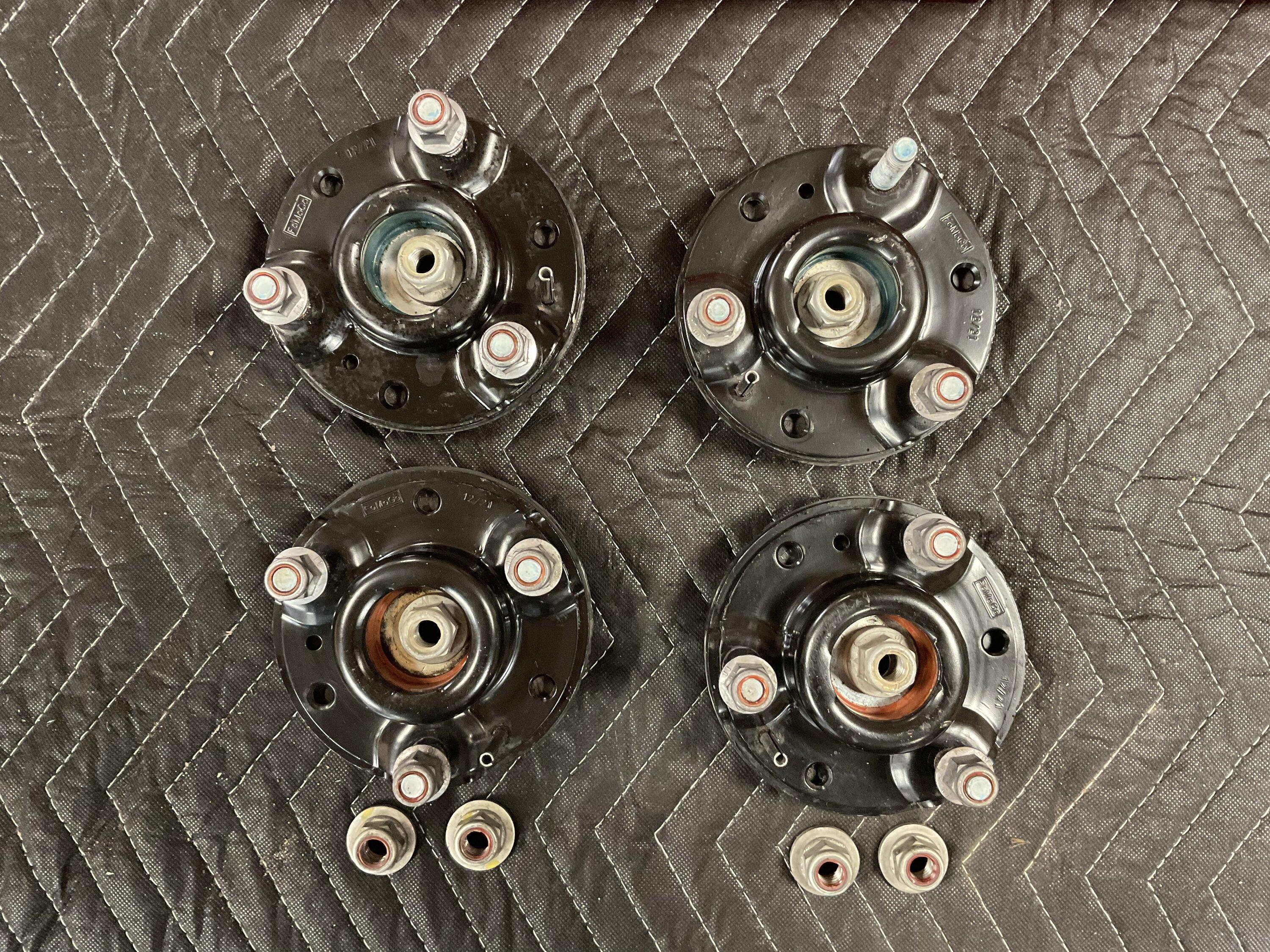

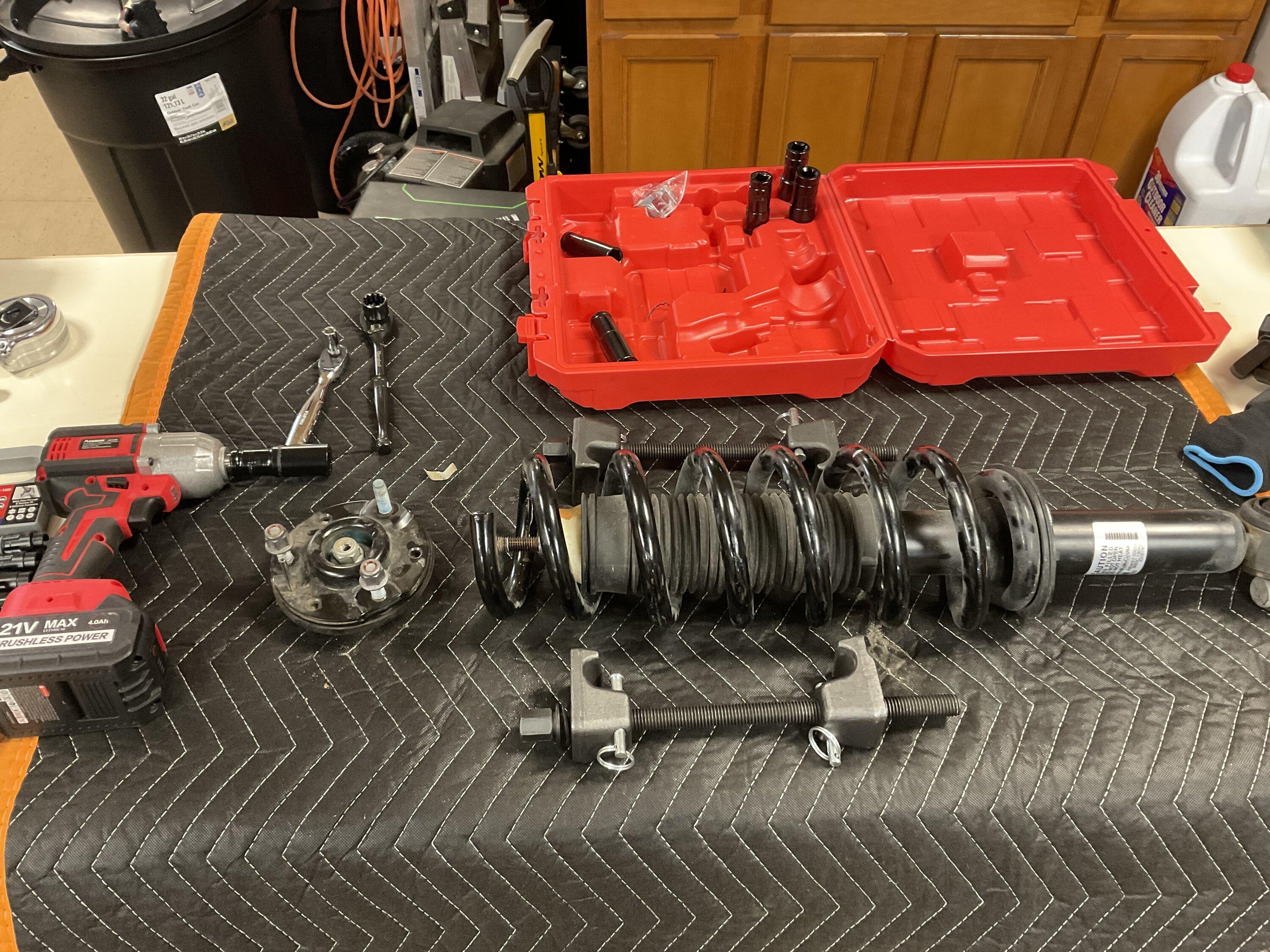

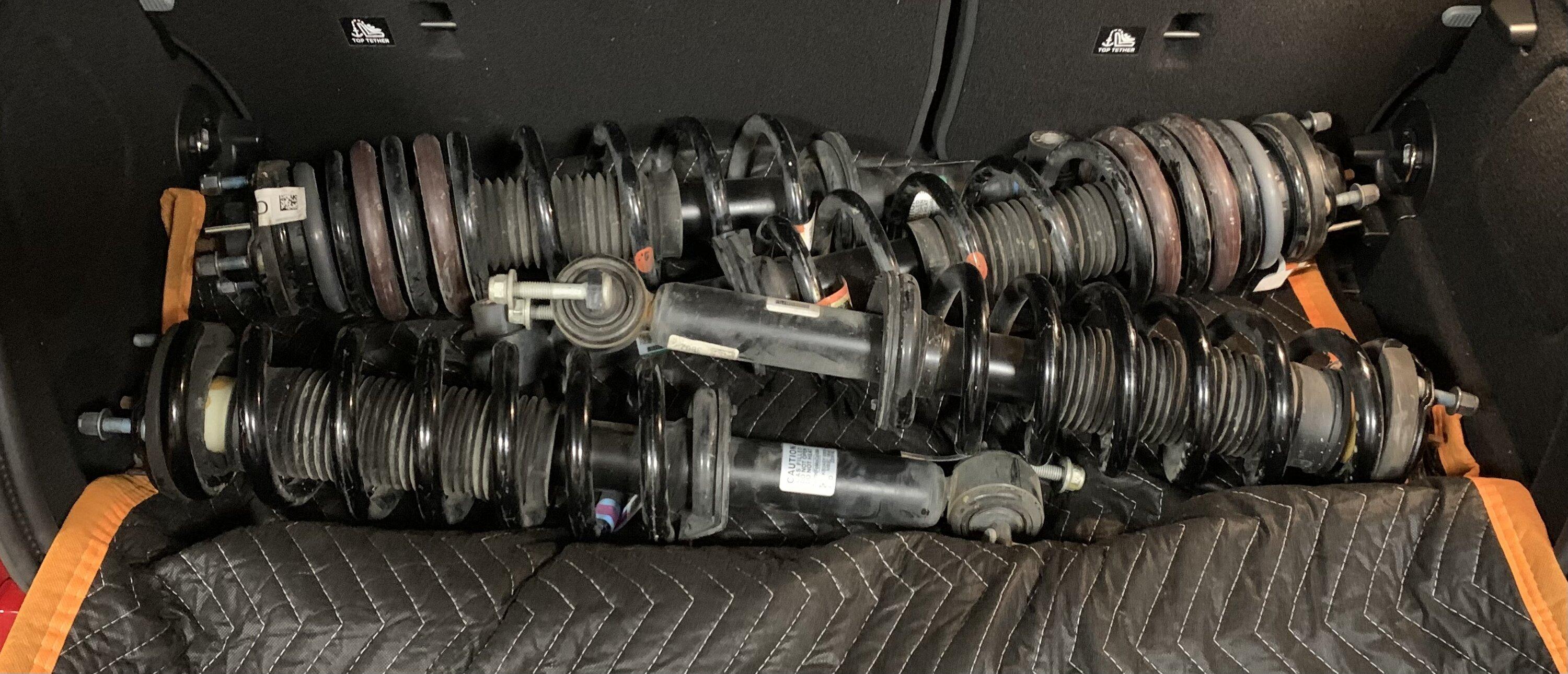

Got leftover suspension from a Bronco member so I could remove top hats, isolators, all nuts to use on OME when it arrives. I compressed springs and removed top hats easily myself at home.

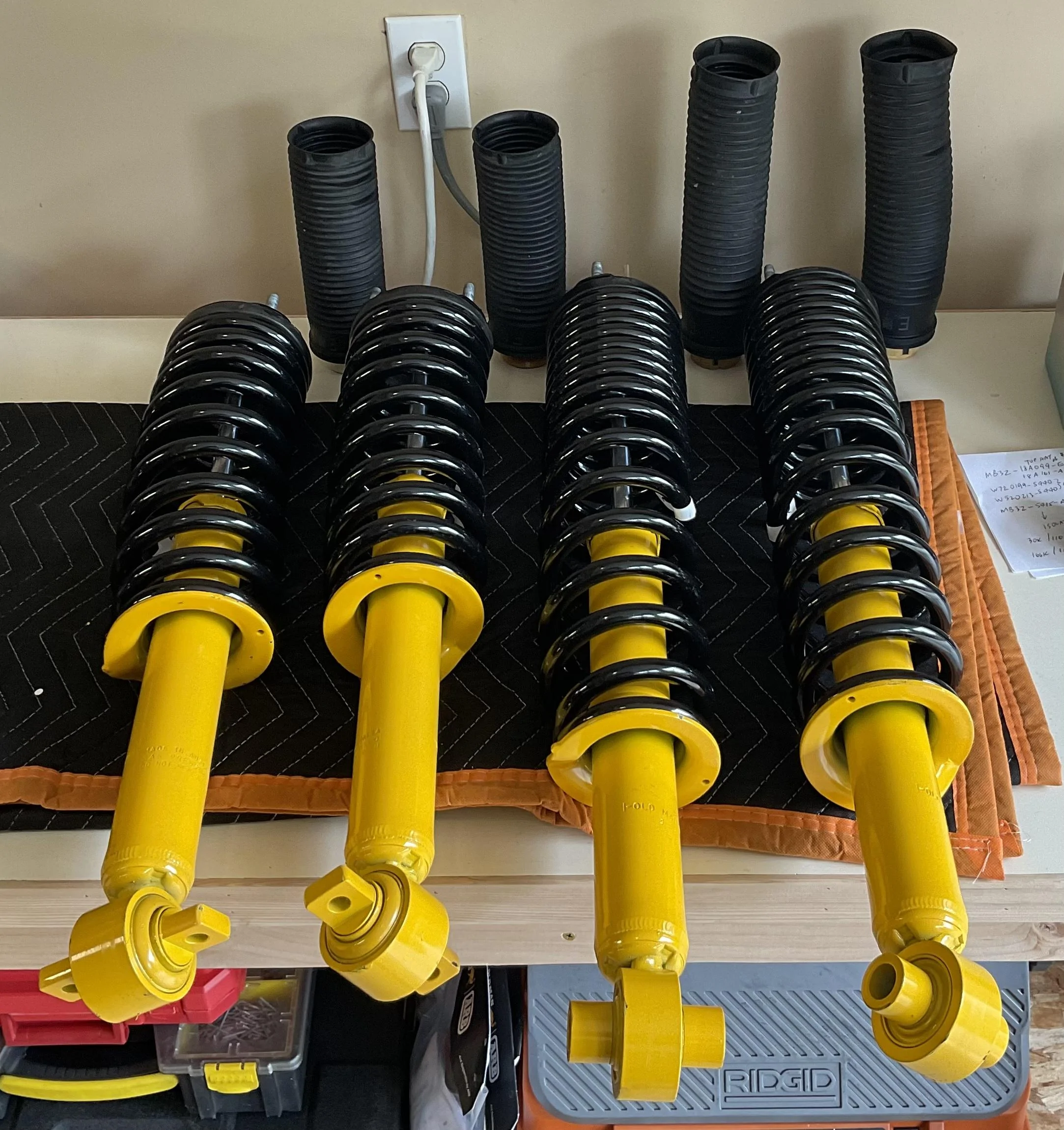

Ok…OME Nitrochargers assy experience:
I first started off trying to find someone willing to give up their stock suspension for free/cheap so I could reuse the top hats on the OME. I found Hitachis and researched to make sure the top hats were common with SAS. They are. On my bench with manual spring compressor I removed top hats and went to shop to get installed on my OME. In my “infinite wisdom” I forgot to bring with me bump stops and boot/dust covers. I proceeded to assemble anyway and then researched later. Turns out the parts from Hitachi would not have worked (too short) so I ordered SAS bumps/boots ($174) and will now have to disassemble OME again and install new parts. Bummer for sure but mechanic said compressing this second time will be easier and can be done on the bench vs wall compressor. I’m still perplexed by this but willing to try. I ordered a manual compressor from Amazon ( Amerbm Spring Compressor Tool Macpherson Interchangeable Fork Strut Coil Extractor Tool Set with Safety Guard and Carrying Case https://a.co/d/5QrQFTn ) and will try this one instead of my long bolt simple ones I’ve used on smaller applications.​
I wish OME would describe in more detail all the parts you need to reuse in their struts. I know I shoulda know better but alas here I am. It’s ok..I learn every time I screw up :)
First impression of OME in my hands is VERY nice, VERY stout, VERY heavy, VERY good quality. I thought my shocks would have the OME label with Emu in black but does not :( Just aesthetic but looks cool. I might search for labels and secure to shocks to make look cool.​
New bumps/boots will arrive in a couple weeks so I gotta just sit on the suspension until then.​

I really think the bumps/boots I took off Hitachi struts will work/fit on these OME
