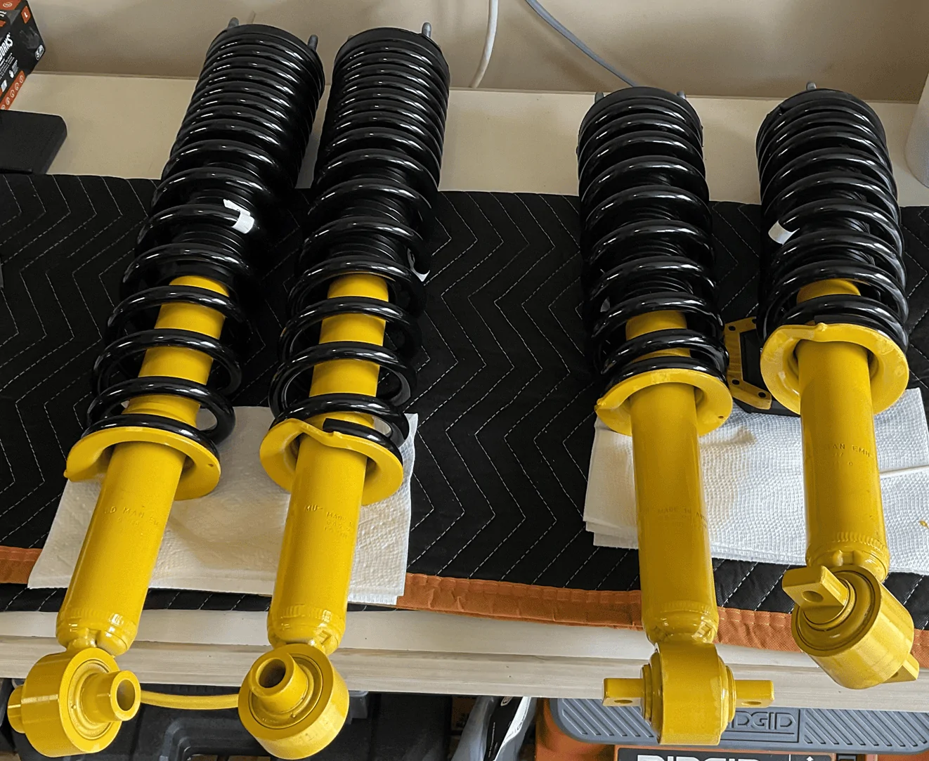

Got bump stops / dust boots installed today along with 2 spacers in front per strut. Spacers were part of OME kit and 2 add up to an additional .25" lift. Rear spacers go on during installation process on TOP of the top hats but the fronts go in between top hat and rubber isolator so MUST be installed during strut assy process.

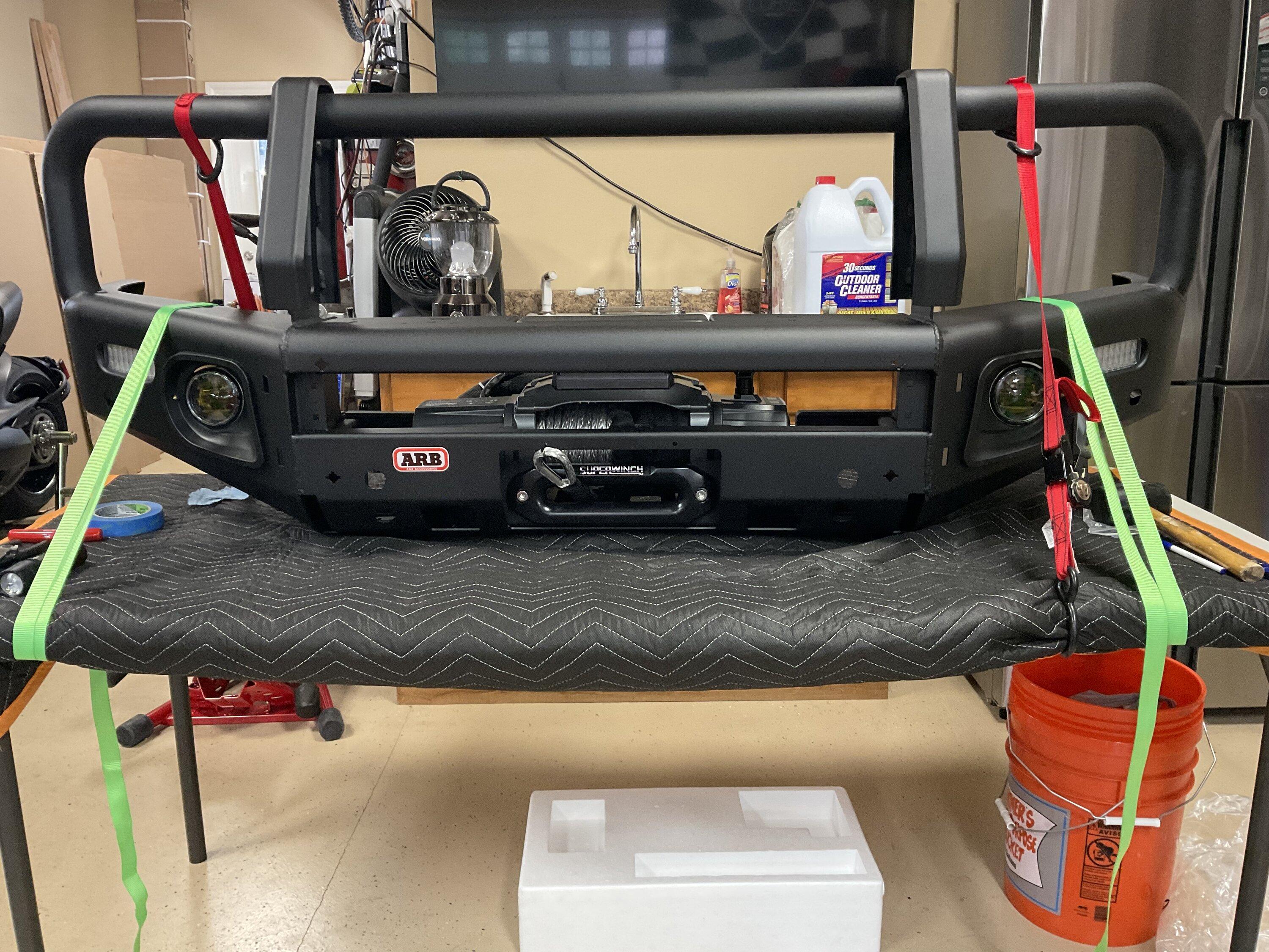

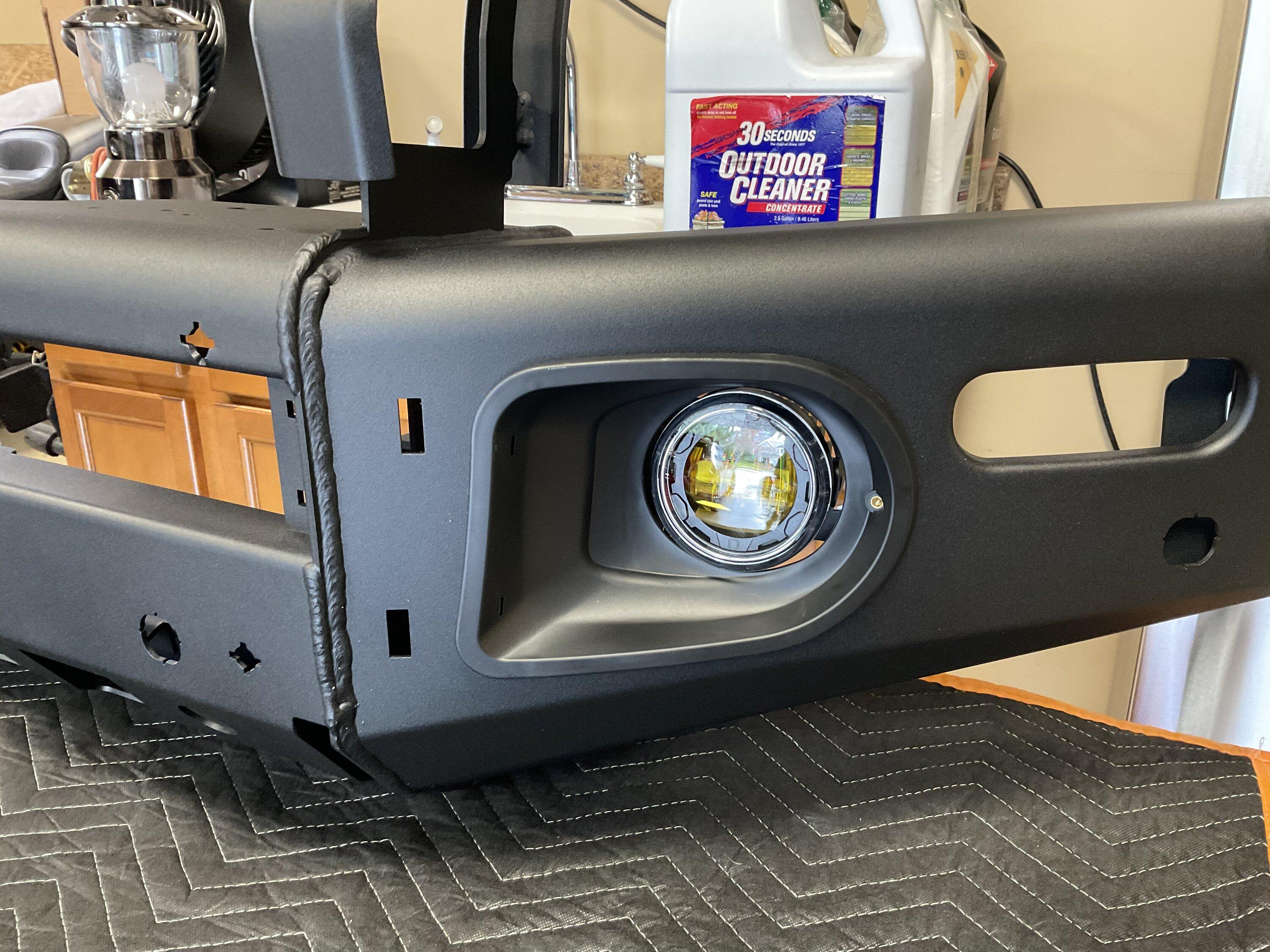

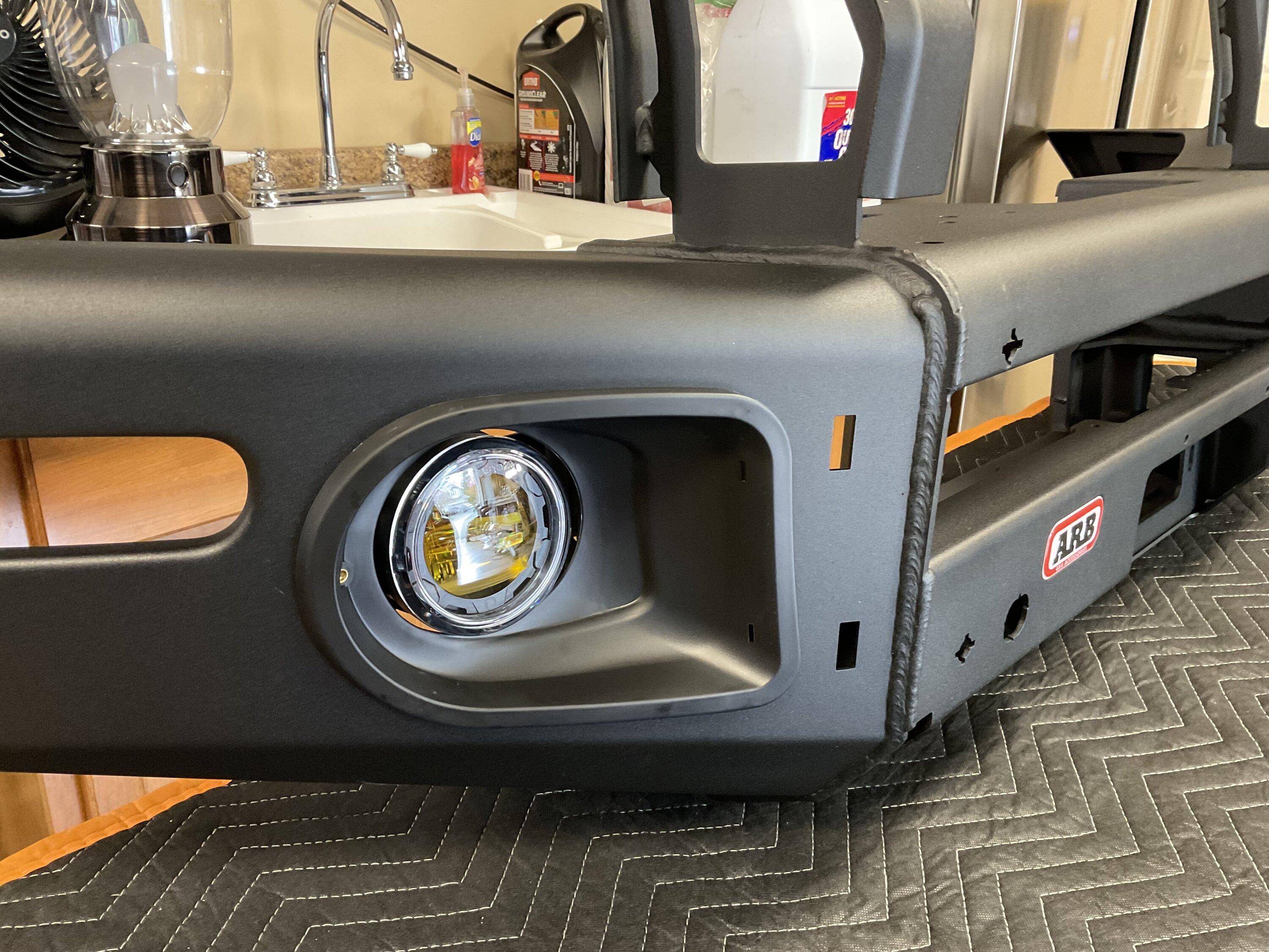

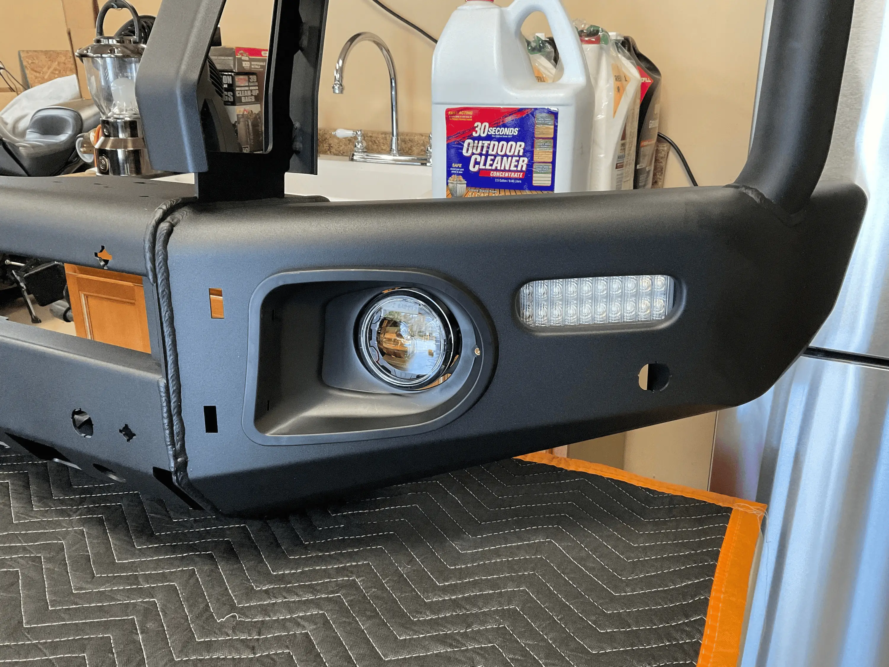

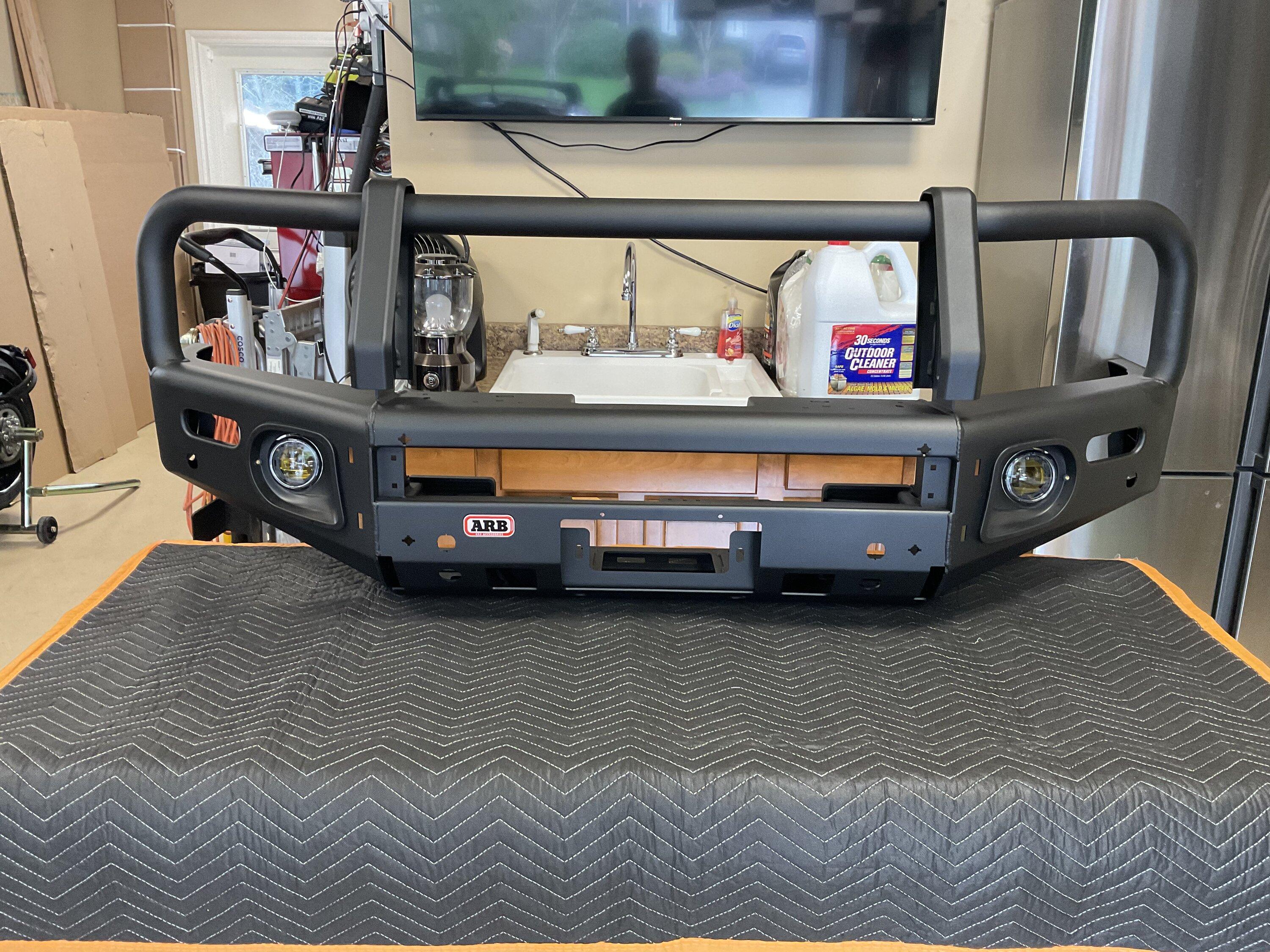

Today was starting to assy ARB Summit. Diode Dynamics Elite fogs installed…Turned out pretty nice. Got blinkers installed. Tmrw is winch (Superwinch)
LOVE this bumper...So nice/beautiful
Ford Bronco 2023 Badlands Story 7815AD2E-525C-4E59-BCD6-C99F441D122A
Ford Bronco 2023 Badlands Story C77CD57A-D9B7-455F-8DC3-7A99D81DFADD
Ford Bronco 2023 Badlands Story E4D3D6BA-5D28-4E0A-A831-7BE23D118E4C
Ford Bronco 2023 Badlands Story 1681949705733
Ford Bronco 2023 Badlands Story 1681949753749

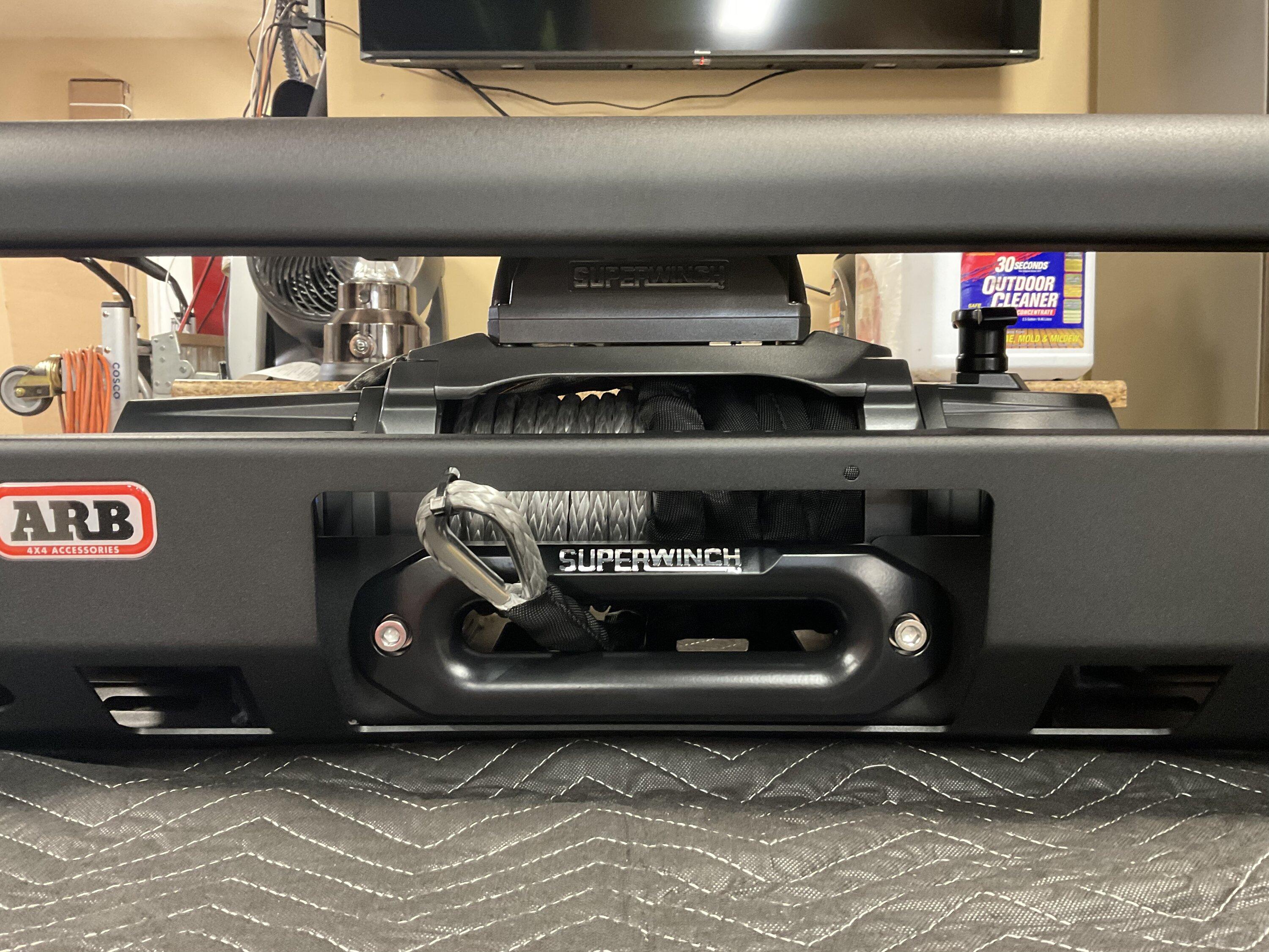

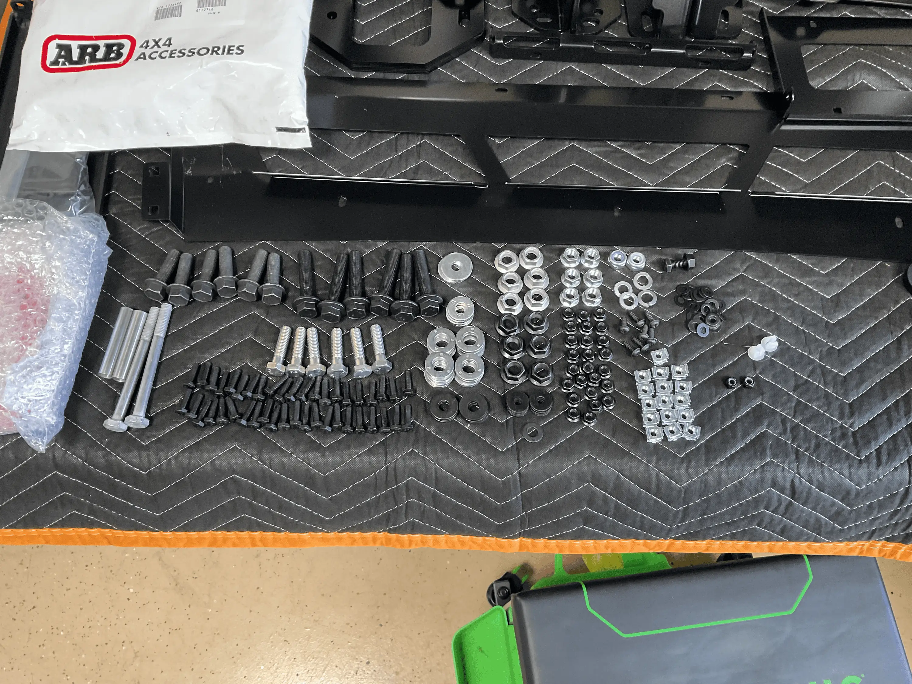

Winch installed, a few more parts, organize bolts/washers/nuts to their corresponding “friends”. A lot of parts to this bumper, but is coming together. Not much more I can do now as I need Bronco parts to put inside before I cover with mesh.
Ford Bronco 2023 Badlands Story EEAC3519-4DC3-4A20-970A-FEBB4CA523D1
Ford Bronco 2023 Badlands Story A4ACC946-B3E7-40F2-A00C-D256FF832C1D

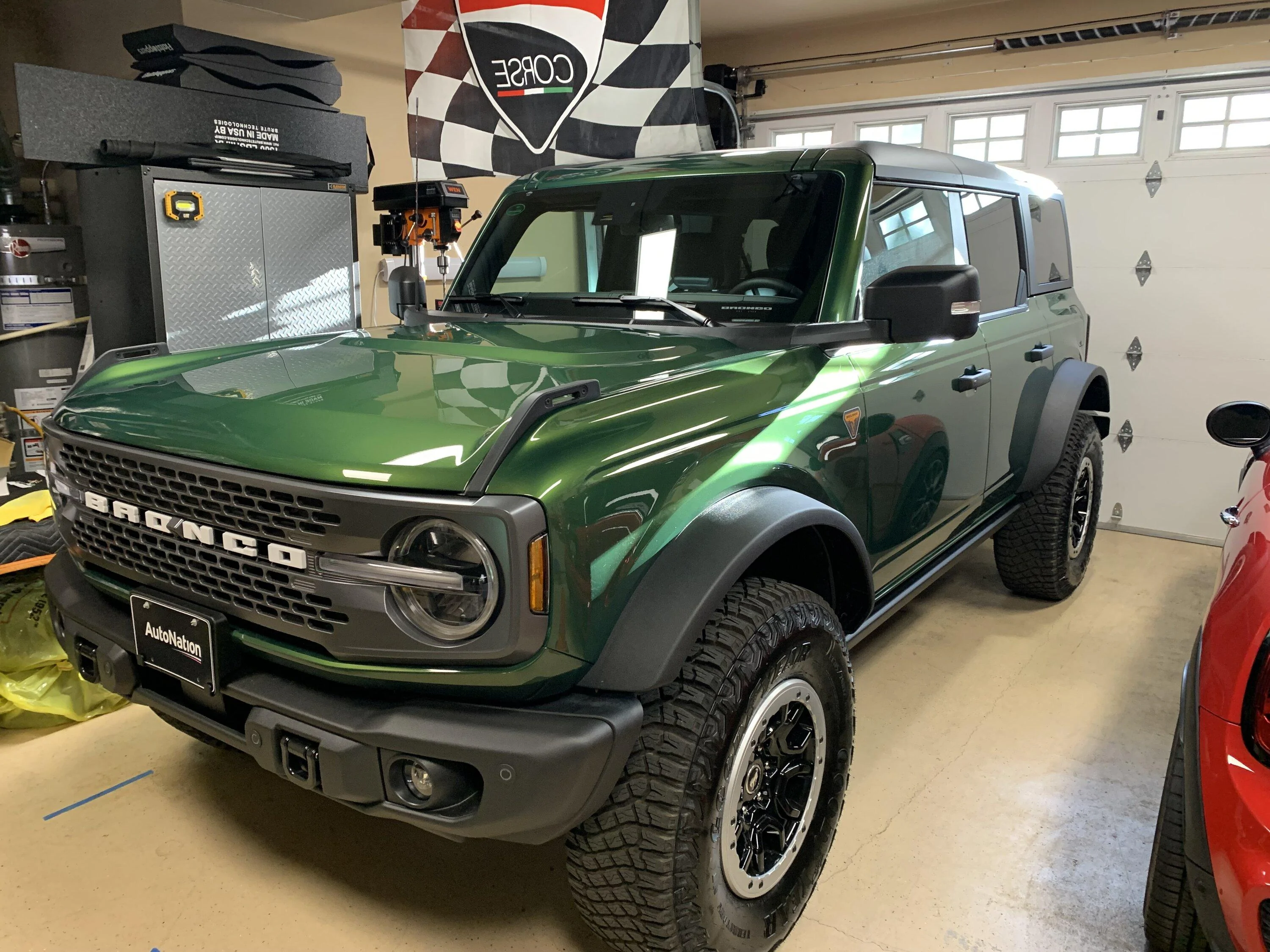

My Dealer Pick Up Bronco experience:
Yesterday was the big day for me. Overall it was wonderful experience, semi-long, no negotiating and I declined all extended warranties as they were too expensive. I will buy thru FloodFordESP as half the cost. I did decline windshield replacement warranty, but struggled with that one. $1000 seemed pretty steep and I'm gonna check with my insurance to see how I'm covered with them.
I inspected the entire vehicle via a checklist posted by a member and it was great. I didn't check everything as I was not about to check all drivetrain torques, could not find/see pulley belts, and some stuff I just didn't check. I did check all exterior/interior/operations/etc. The ONLY thing found was almost all the lug nuts were under 100ftlbs. We fixed that.
I left happy, exhausted (mentally) and with a smile. I forced them to fill the tank with Premium. Drive home was great aside from shit traffic. I'm glad I'm retired and don't commute in that crap anymore. I feared for my car the entire trip home.
I truly love this rig and am anxious to get to know her. Today is cuddle time. Tomorrow is new lift, wheels, tires, tie rods, UCA. I will post some pics but everyone's seen this operation over and over so I won't belabor it.
It's begun :)
P.s. hardly slept, even tho she was tucked in the garage all night.
And after months of bugging members to measure stuff, just before bed I measured ground to roof as this is a most important data point for garage fit when I'm all lifted, roof rack, RTT. The dimension was 75.5"
P.s.s. One "glitch". All paperwork said steel front bumper but I'd originally wanted fog lights, so was ok and would upgrade later. Alas Bronco came with capable bumper and fog lights...Weird and an error at FORD I suspect. Salesman tried to convince me TOW package changes the bumper but I did not agree. There were no charge on the paperwork for capable bumper but I seem to remember it was an additional cost.

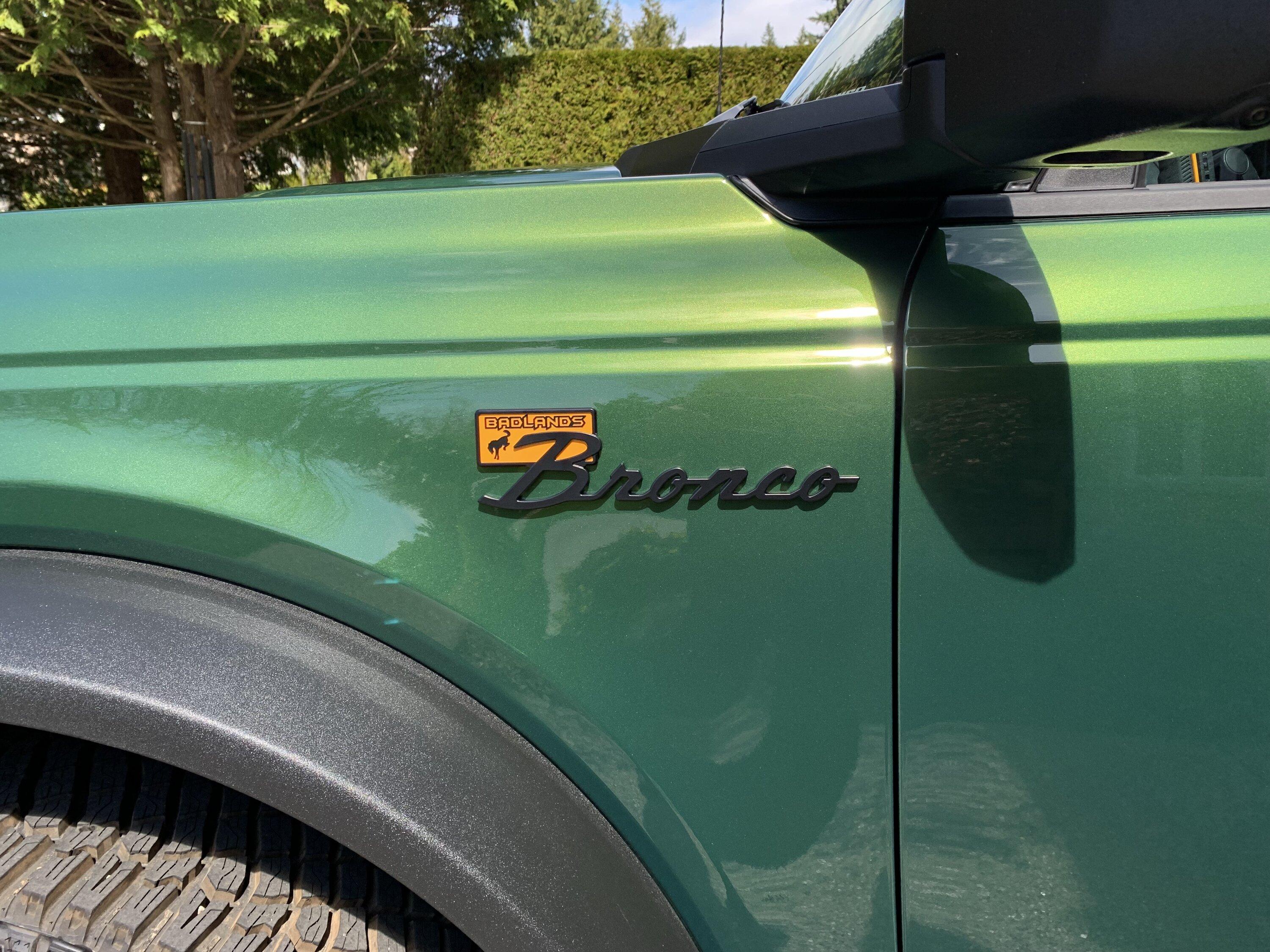

Some “glamour” shots yesterday. Got Archetype Racing scripts installed
Where did you find the Bronco scrip with the Badlands in it ? I was looking and looking could not find that style. That looks really good.
