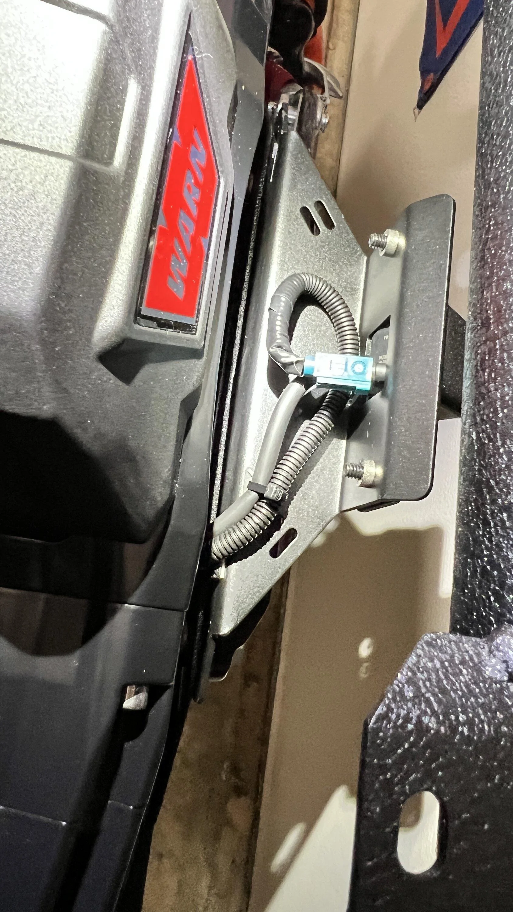

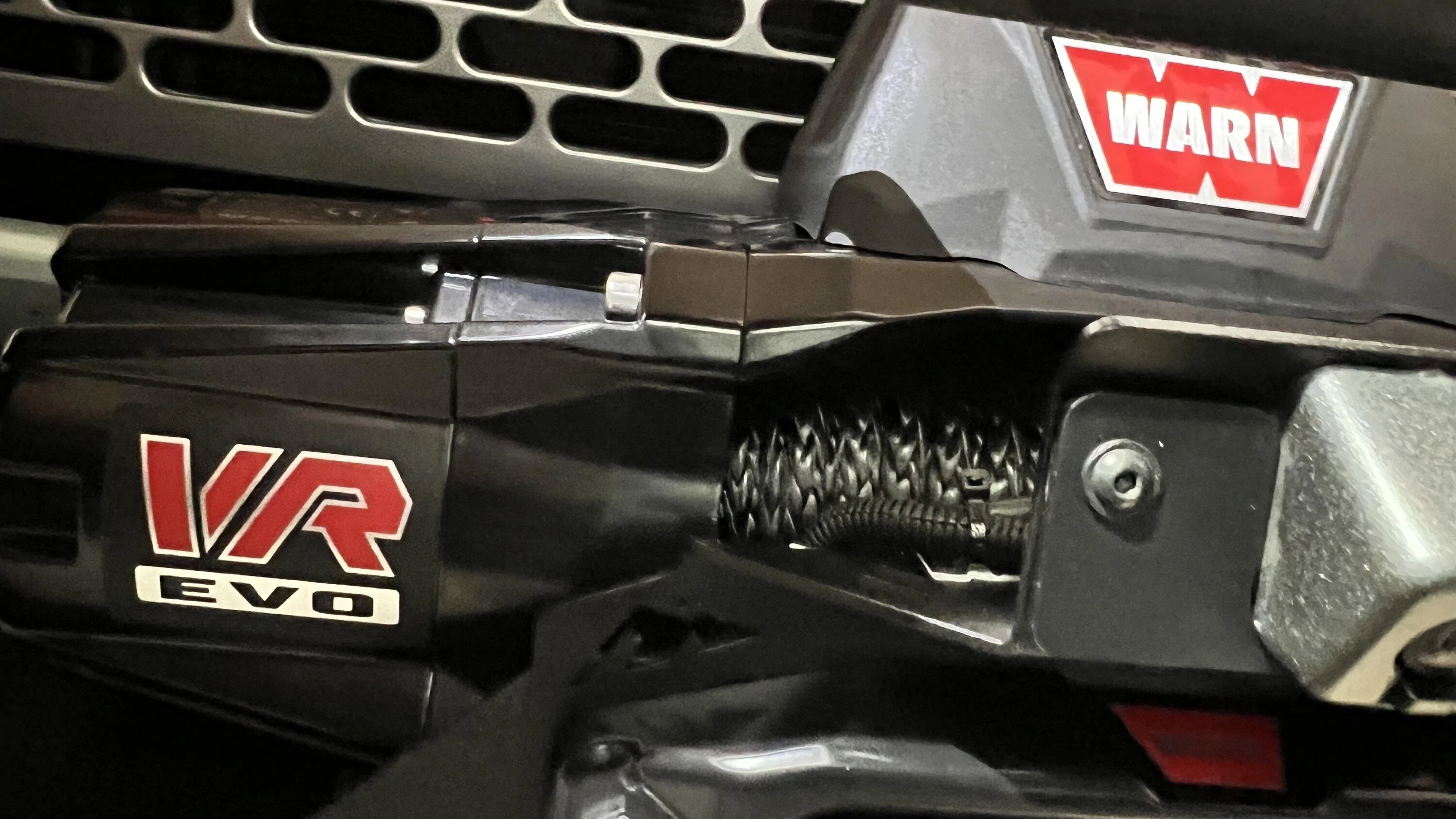

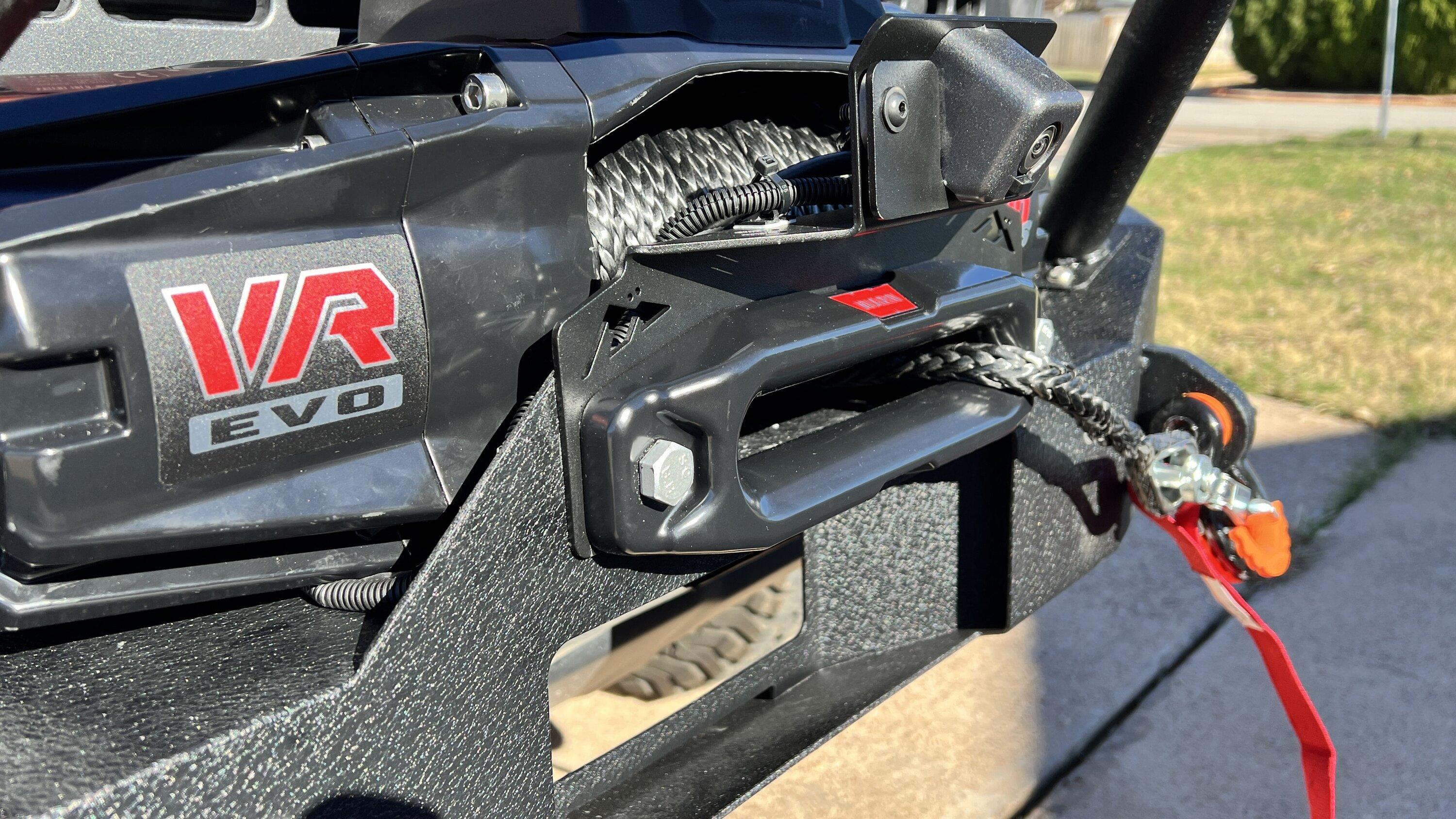

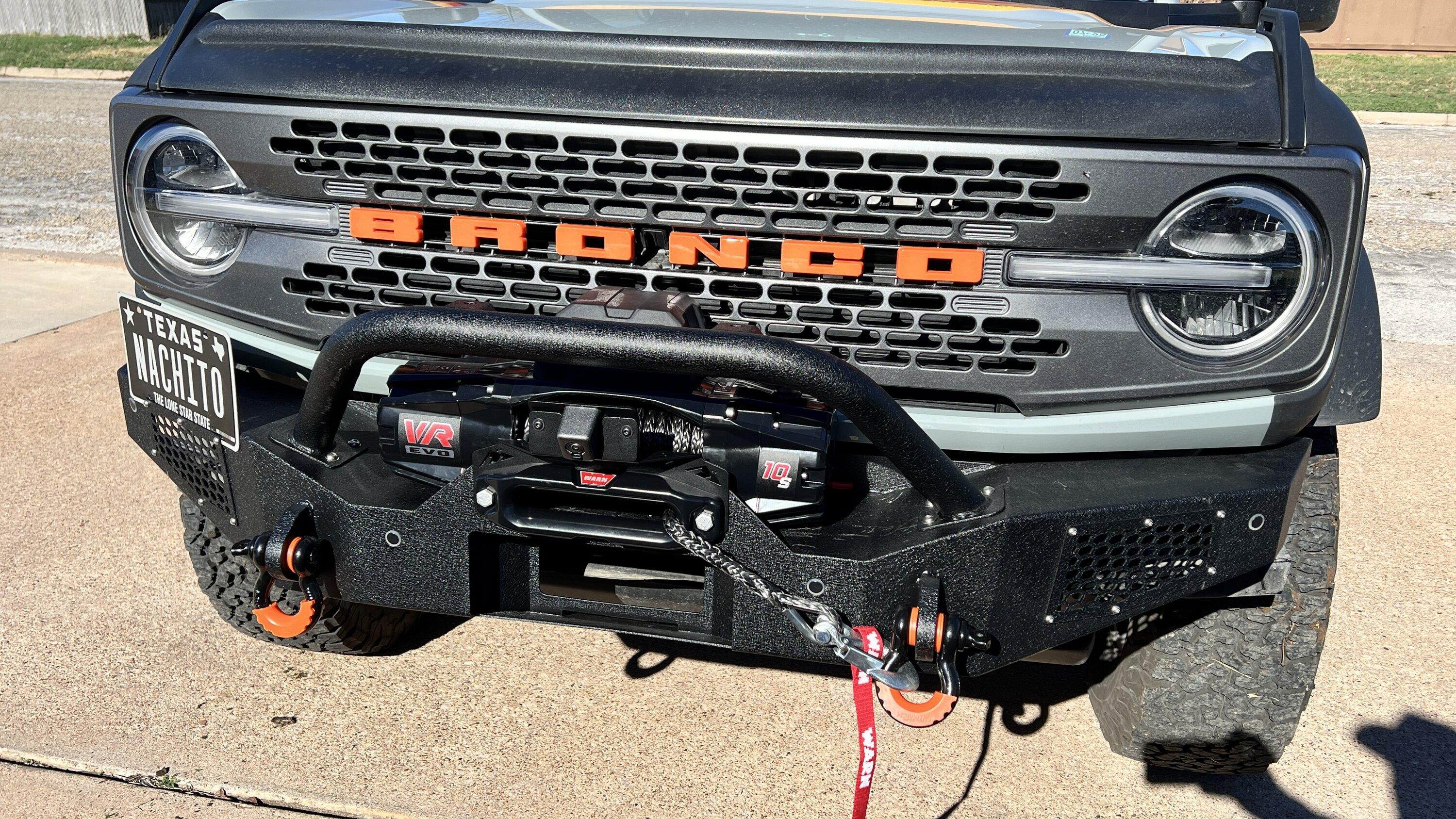

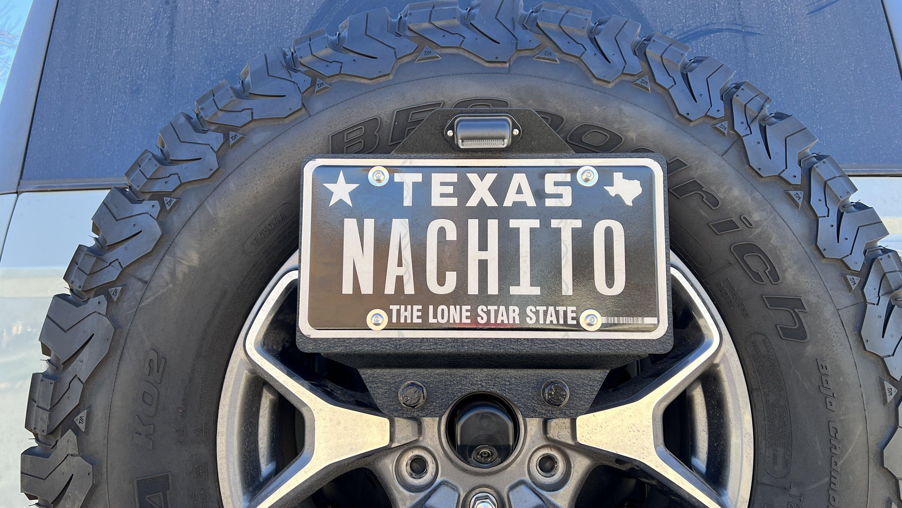

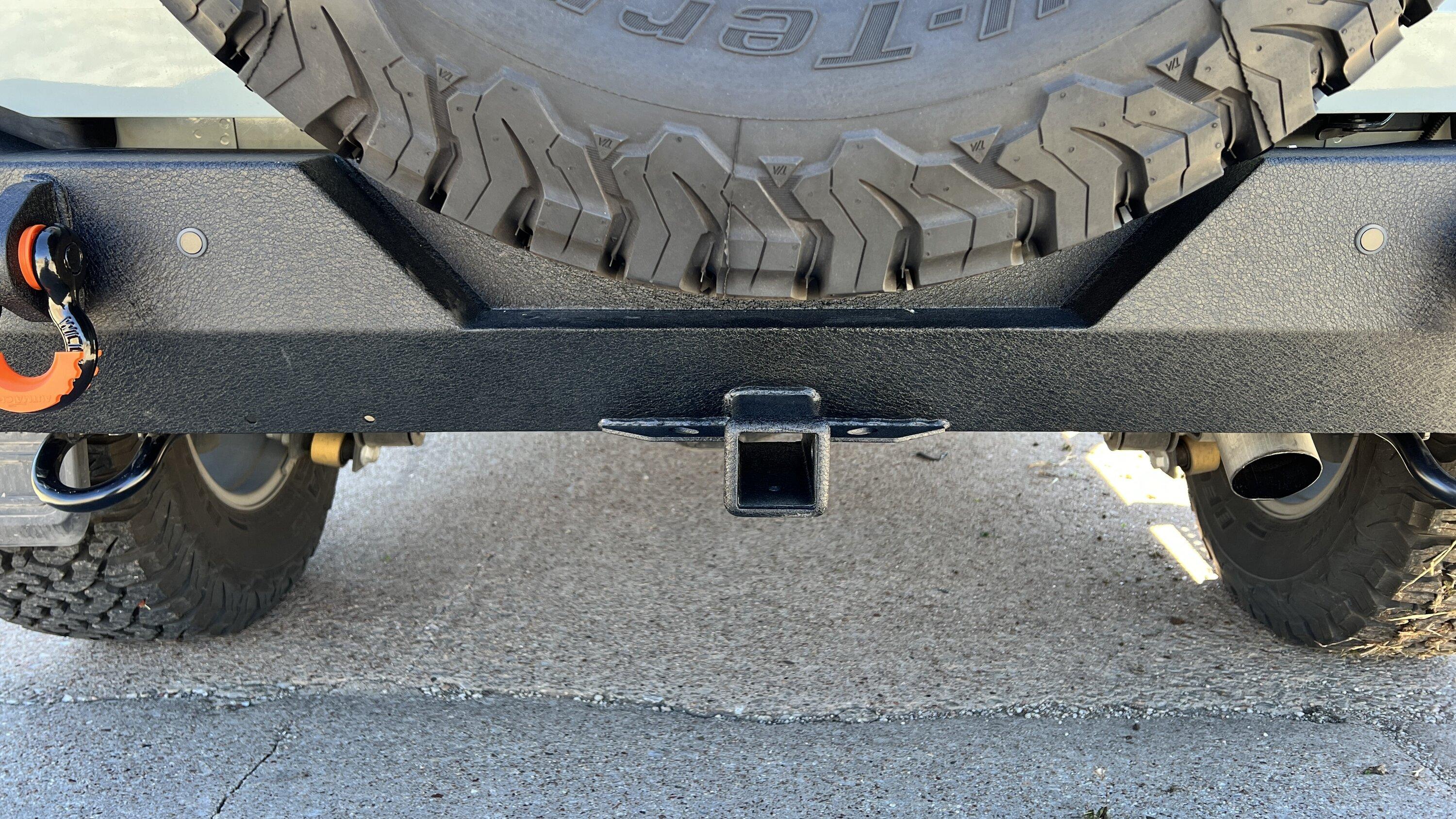

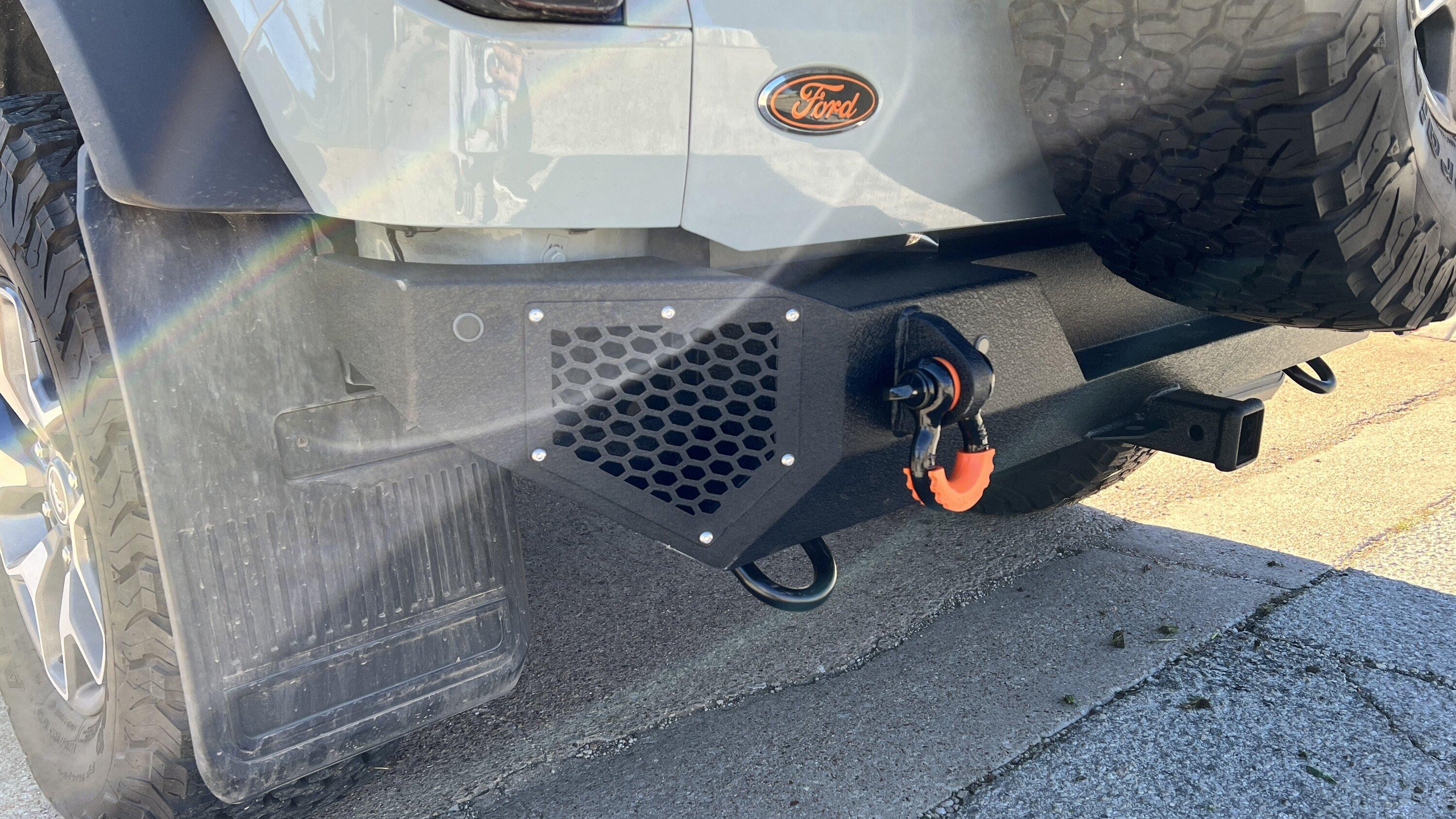

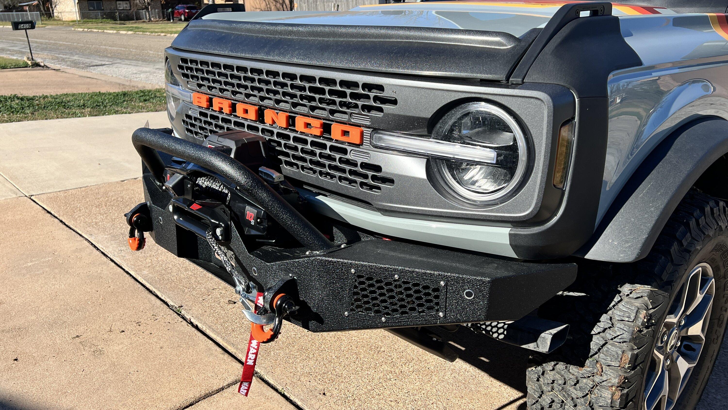

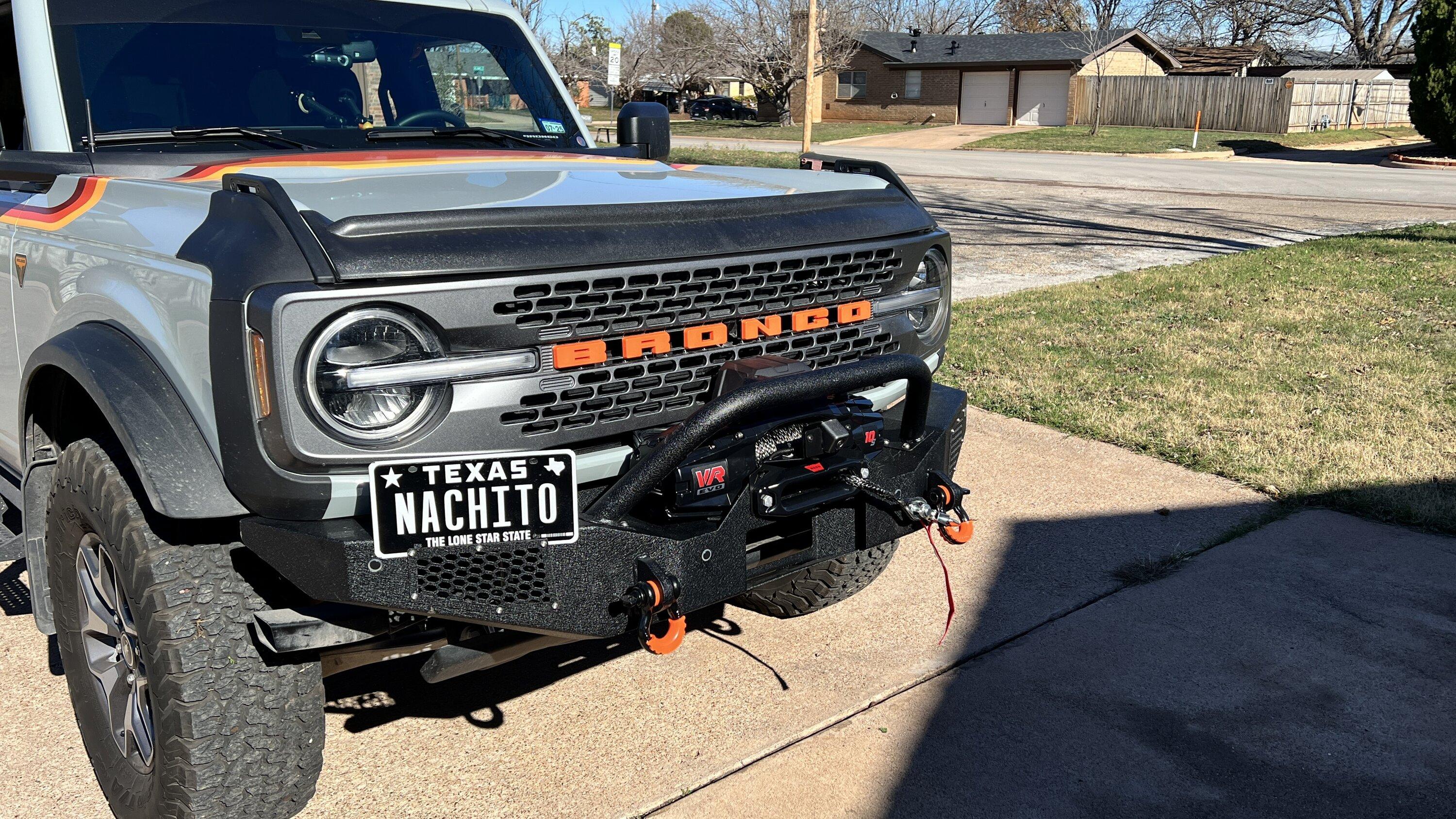

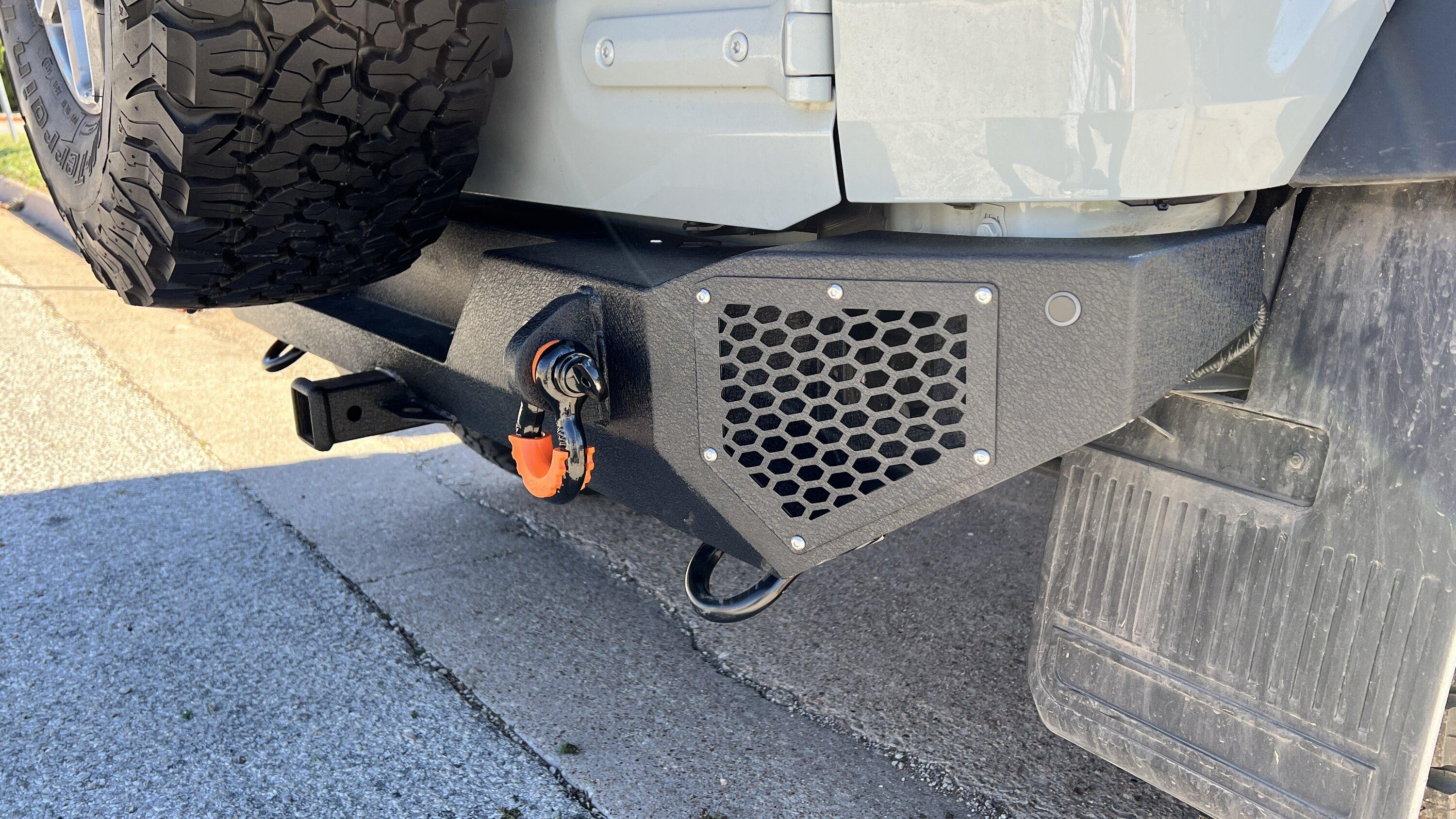

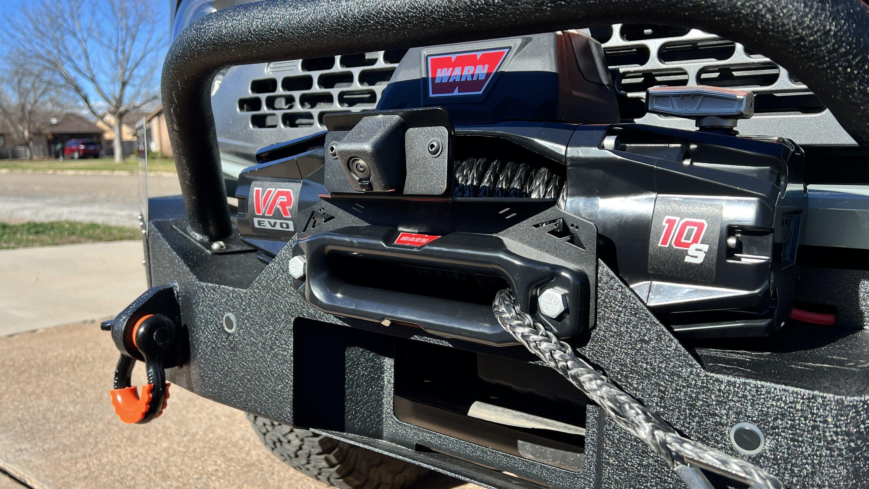

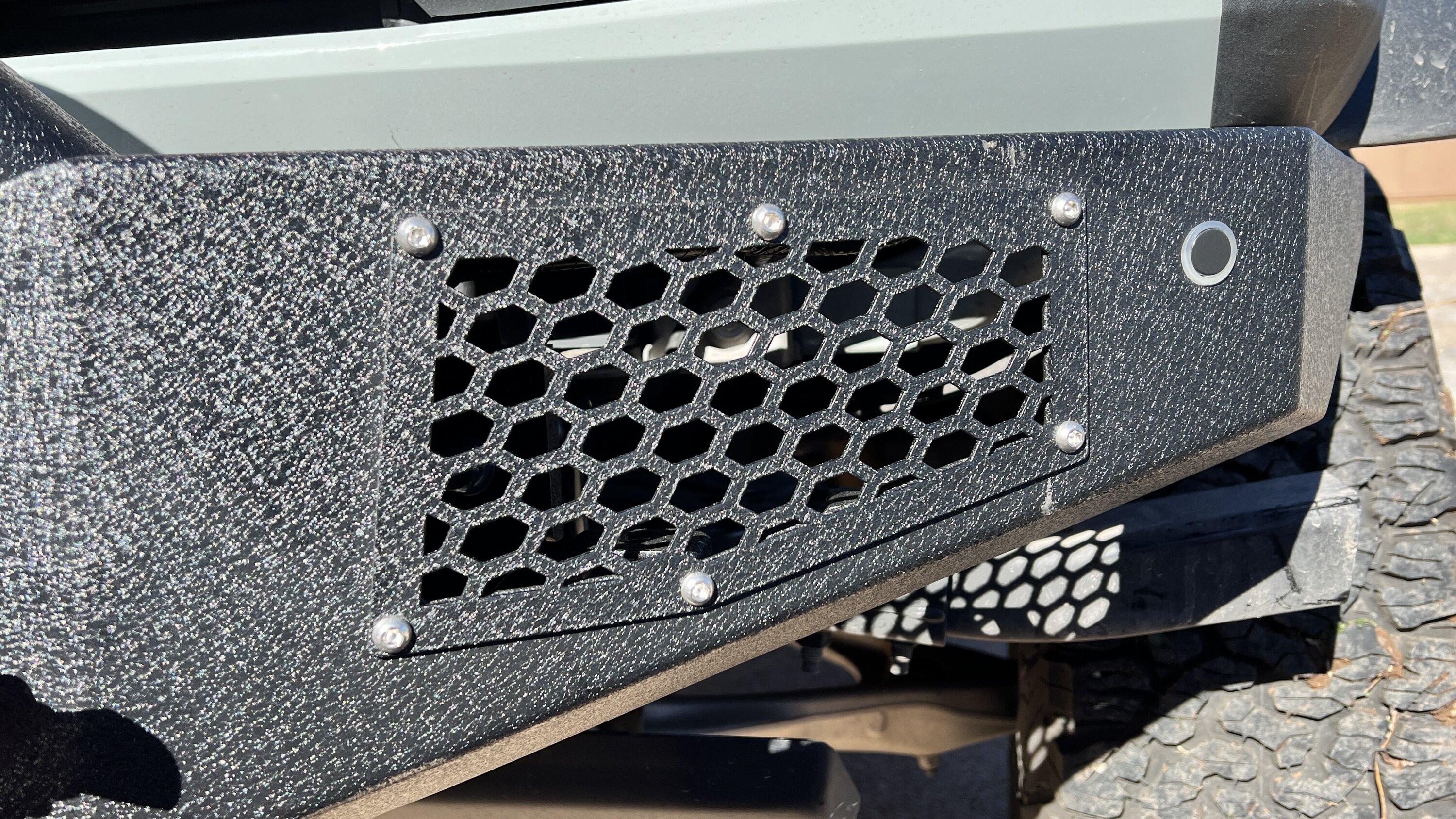

Just completed some upgrades.
- Unbranded front and rear bumpers.
- Unbranded rear license plate relocation kit.
- Mountain 2 Metal front camera relocation kit.
- Warn VR Evo 10-S winch.

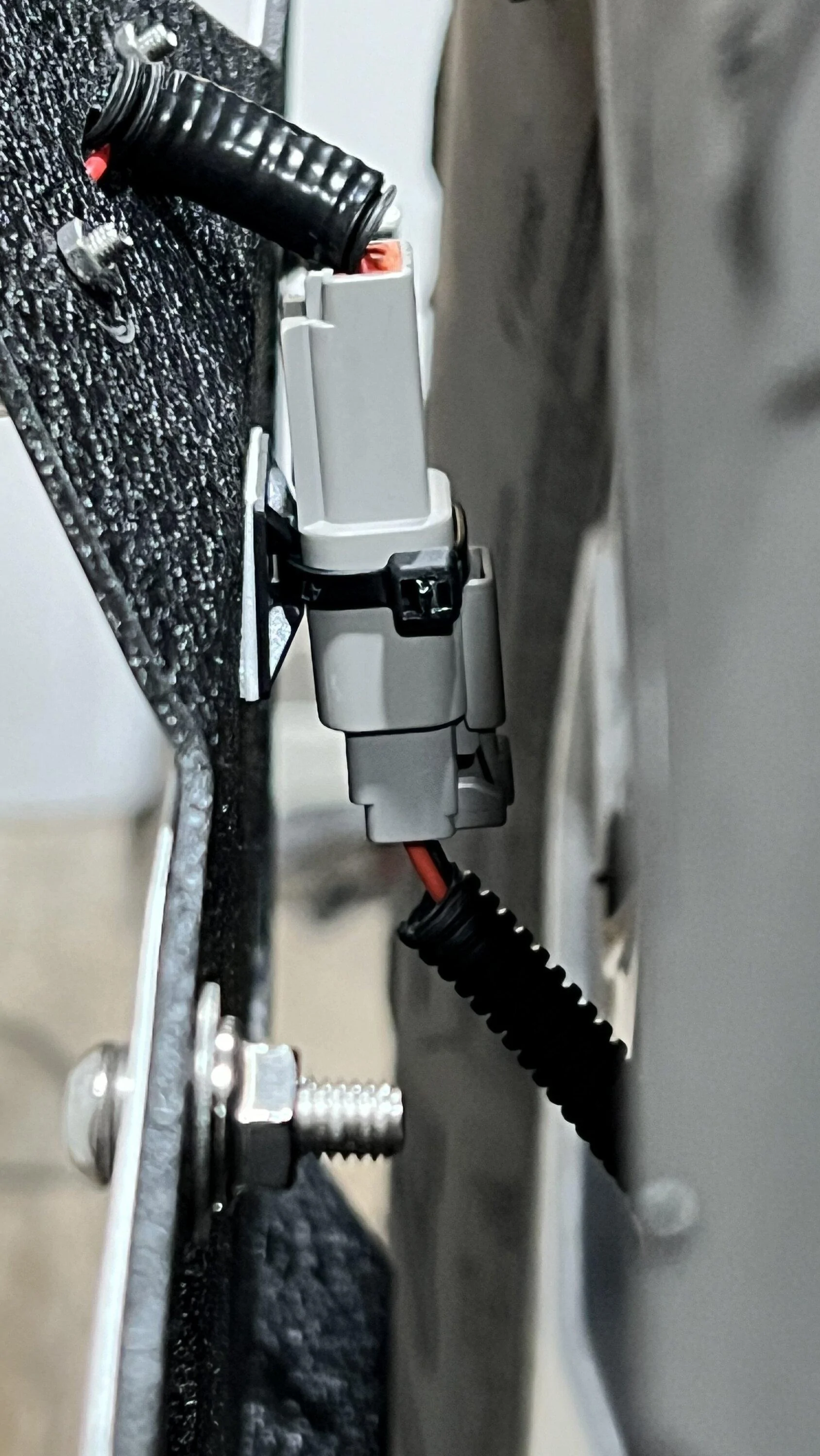

Used DT Connectors for weather tight electrical connections.
Rope is pretensioned and ready for action!
Tried my best to hide all wires for a clean install.

Looks like a clean install. Is the forward crash bar required to remain?
Skernie
Aug 4, 2020
93
180
So Cal
2013 F150, 2023 Bronco
Can you provide links to where you got the bumpers?
Thanks.
Nacho The Bronco
Aug 21, 2023
110
Abilene, Tx
2023 Ford Bronco Badlands 4Dr
They are both unbranded from eBay. I’m very pleased with their build and quality.
Front bumper ( I offered $400, they countered with $439.00. So I just offered 430 and they accepted ) https://www.ebay.com/itm/196042839711
Rear bumper ( I offered $300 and they took that offer with no counter ) https://www.ebay.com/itm/364559747147
There are many sellers on eBay with the same bumper.
Skernie
Aug 4, 2020
93
180
So Cal
Nacho The Bronco
Aug 21, 2023
110
Abilene, Tx
The outer shell is. 3 mm (1/8 inch)
The inner support that goes to the bumper mounts is 5 mm (3/16 inch)
I installed both bumpers by myself.
Recommend getting something like this for wire management. https://a.co/d/eu52tMO
