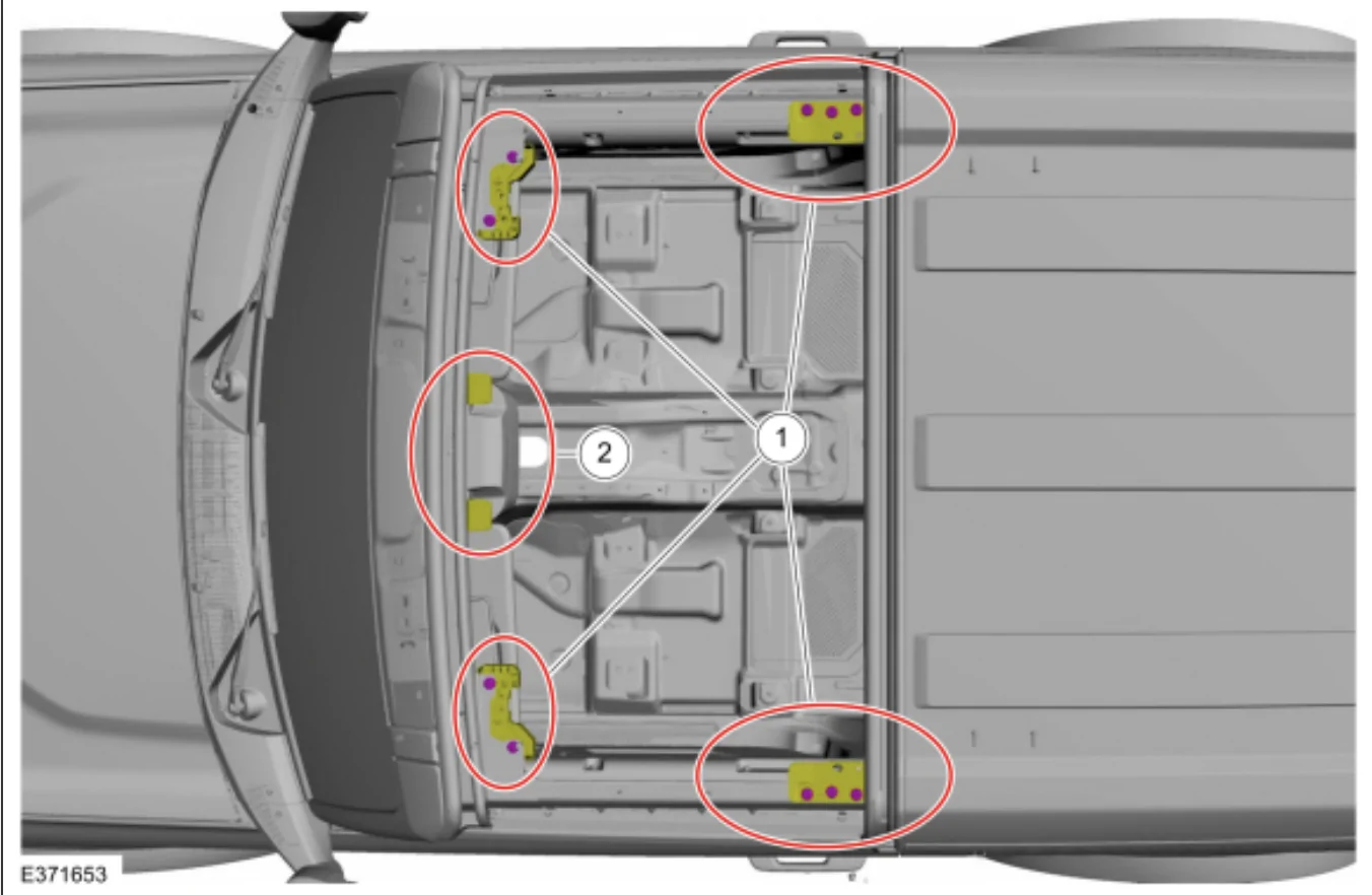

If your panels don't sit flush all the way around, don't be afraid to adjust all of the mounting bracket locations. I went for a couple of years without doing anything and just living with wind noise, and finally adjusted all of the brackets. While there's no getting away from the typical wind noise of a convertible, it did cure the random noises that are not typical. Every singly one of the brackets required tweaking.
