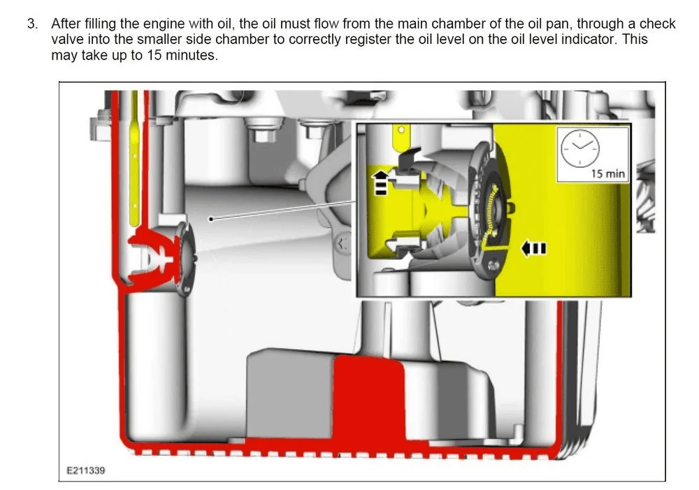

How about using one of these? I've never used one but everyone I know who has, swears by them .... so I'm thinking about getting one.
Its so much cleaner and easier too
https://www.amazon.com/SUPERFASTRAC...t=&hvlocphy=9030056&hvtargid=pla-781685089906
Harbor Freight sells 'em too.
Won't work on this engine, there is a separate chamber that the dipstick reads from.
Ford Bronco 2.7 Ecoboost engine details you should know 1635162649641
I changed my oil at 1200 miles and had some pointers for other people who are new to this engine like myself. It's by no means a step-by-step guide but might save you some headache. Grab a new drain plug before you start and only add 6 quarts until you figure out the correct dipstick procedure. Also, open the oil filter housing before draining the pan.
https://www.bronco6g.com/forum/threads/2-7l-oil-change-tips-replacement-drain-plugs.25658/
