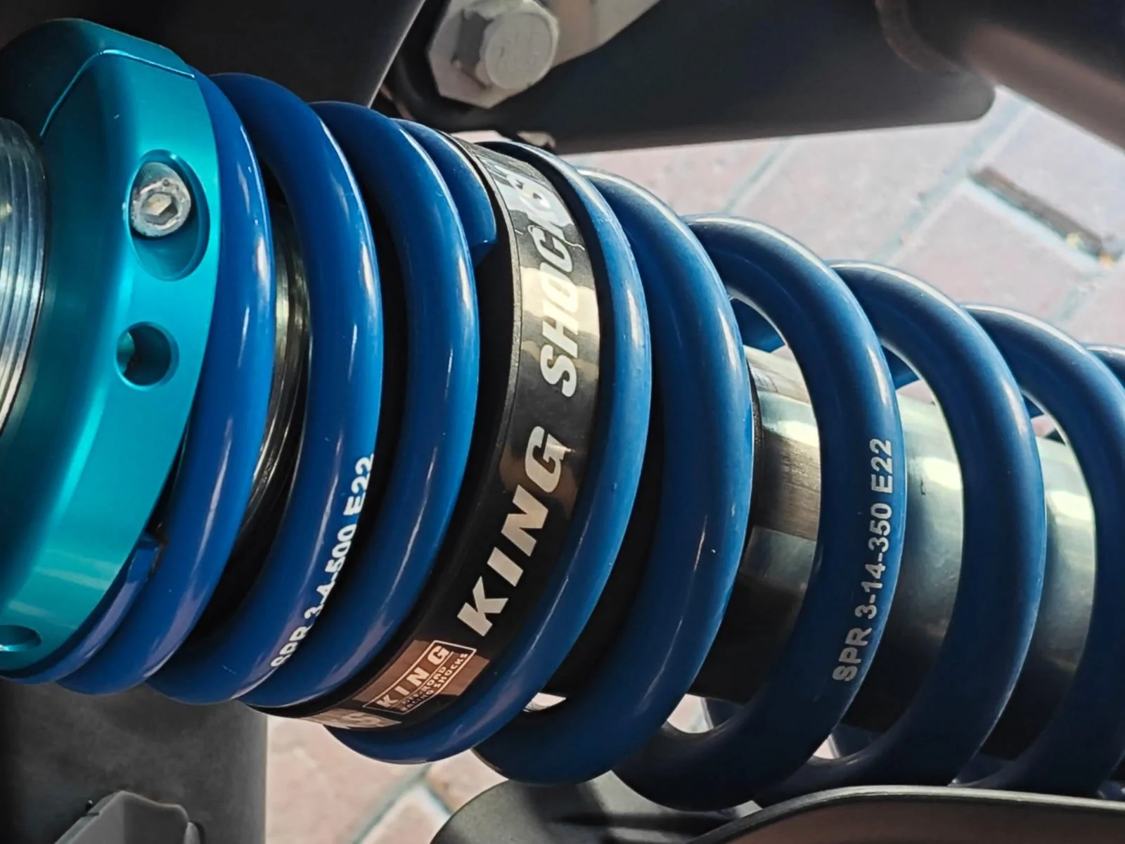

I dont know if this helps but I had a similar type of noise coming from the rear on my car with King shocks a while back.
Tried everything to diagnose but it was hard to make the sound when the car was not moving.
Upon closer inspection, I noticed that that the slider on the dual rate shock was rubbing the crap out of the shock body (picture attached). On the other side it was also rubbing but on the inside of the shock, so we could not see the marks.
Got in touch with Kings as it is under warranty, and the supplied a single rate spring instead to replace the dual rate so no more slider in the middle.
Once the new springs were installed, I was getting a different strange sound, like some keys jingling everytime I went over speed bumps. Turns out that the bumpstop was not all the way down and there was a small washer that kept going up and down making the jingling sound. This was an easy fix, just push the bumpstop all the way down.. Or Jump the car so it gets set down naturally haha.

Ford Bronco 2.5 coilovers making noise WhatsApp Image 2023-05-13 at 11.59.46 AM
