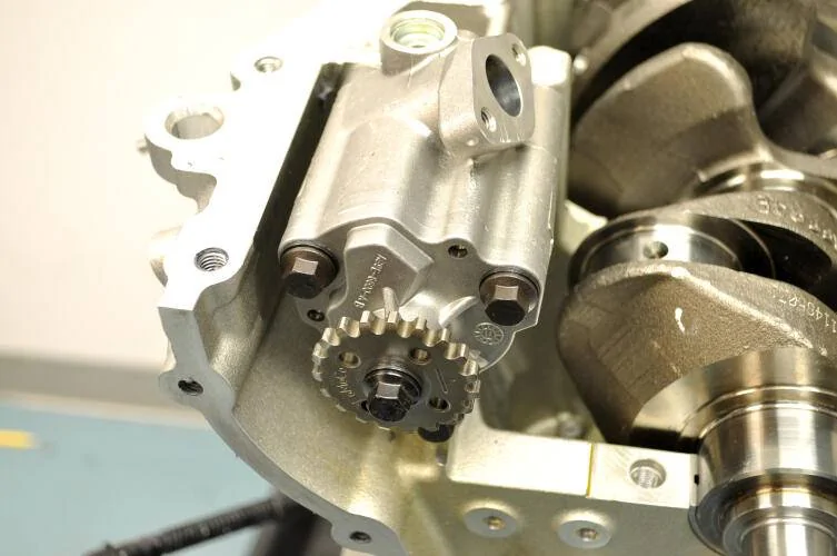

These may be the most ridiculously inadequate installation instructions I've ever seen - but this indicates it's chain driven from ... probably cam shaft if I had to guess
Here's a better pic, stolen from Livernois
Ford Bronco 2.3L Oil Pump - is it electric? ginal_P04_LPP701125_main_w760_h500_q75_t1640184962
So that would be RPM-driven, but it has an internal spring that sets the output pressure (or at least that aftermarket one does, I don't know if the stock one does or not, but ... probably works the same). Nothing electric there, but that spring may have some bounce/oscillation to it, not sure. That probably isn't what you are seeing.
There is usually an oil filter bypass for cold startups, and a lot of other things in that oil loop too.
The 2.7 mentions a belt-driven oil pump with electronic pressure modulation (my guess is solenoid operated bypass, similar to how a turbo wastegate works - but I don't know) - I wouldn't be surprised if the 2.3 has a similar electronic modulation as well.
Interested to hear an authoritative answer - I'm just speculating.
Ford hasn't used this style for the 2.3 since the Ranger came back out in 2019
