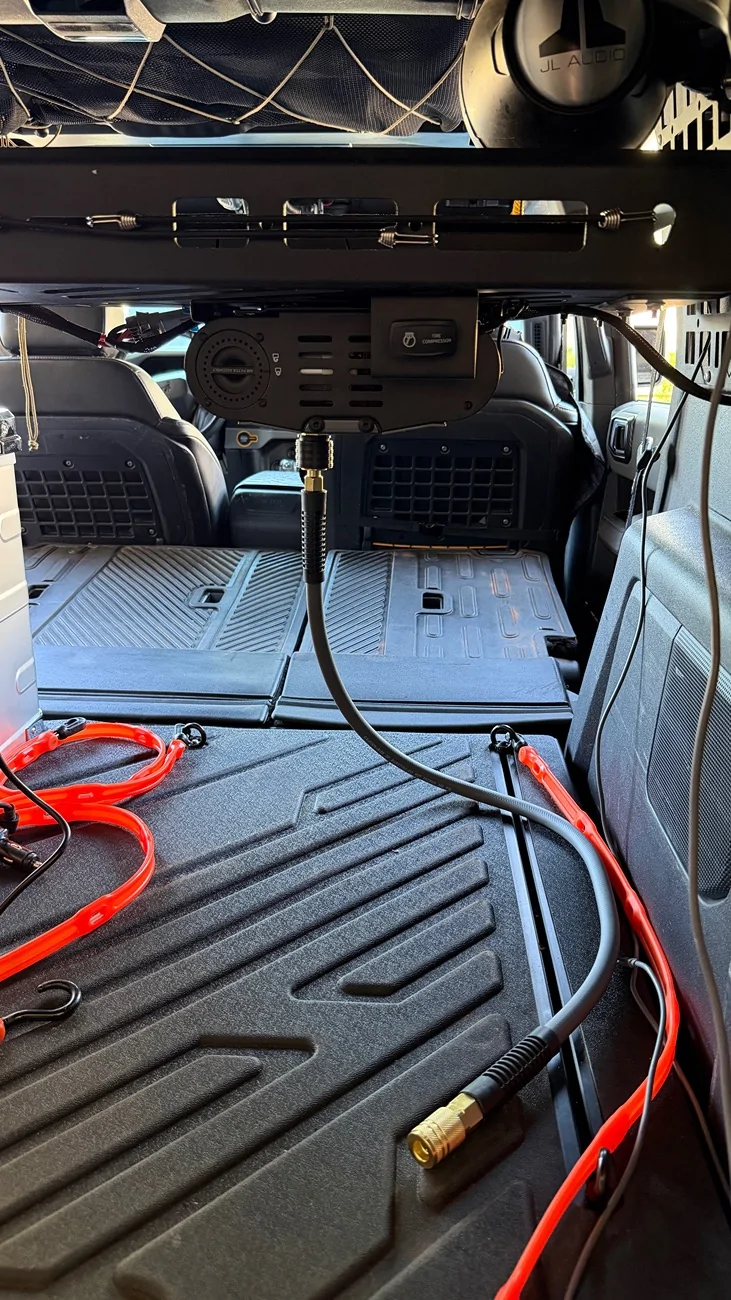

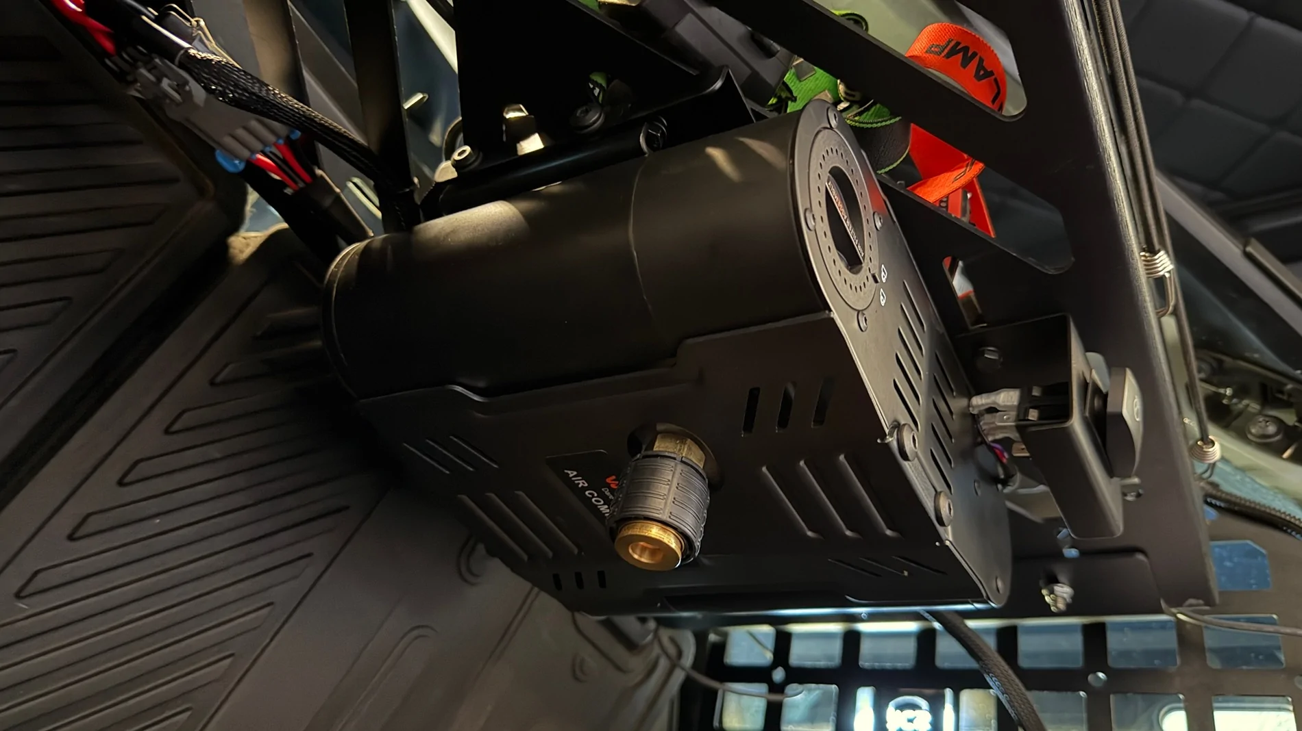

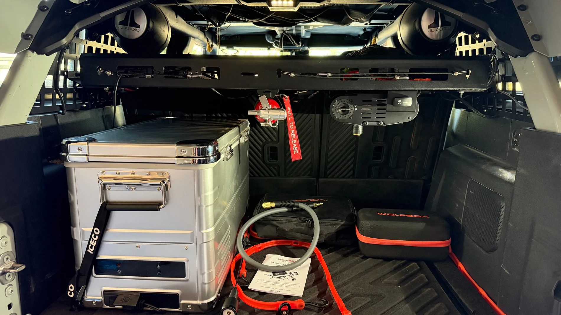

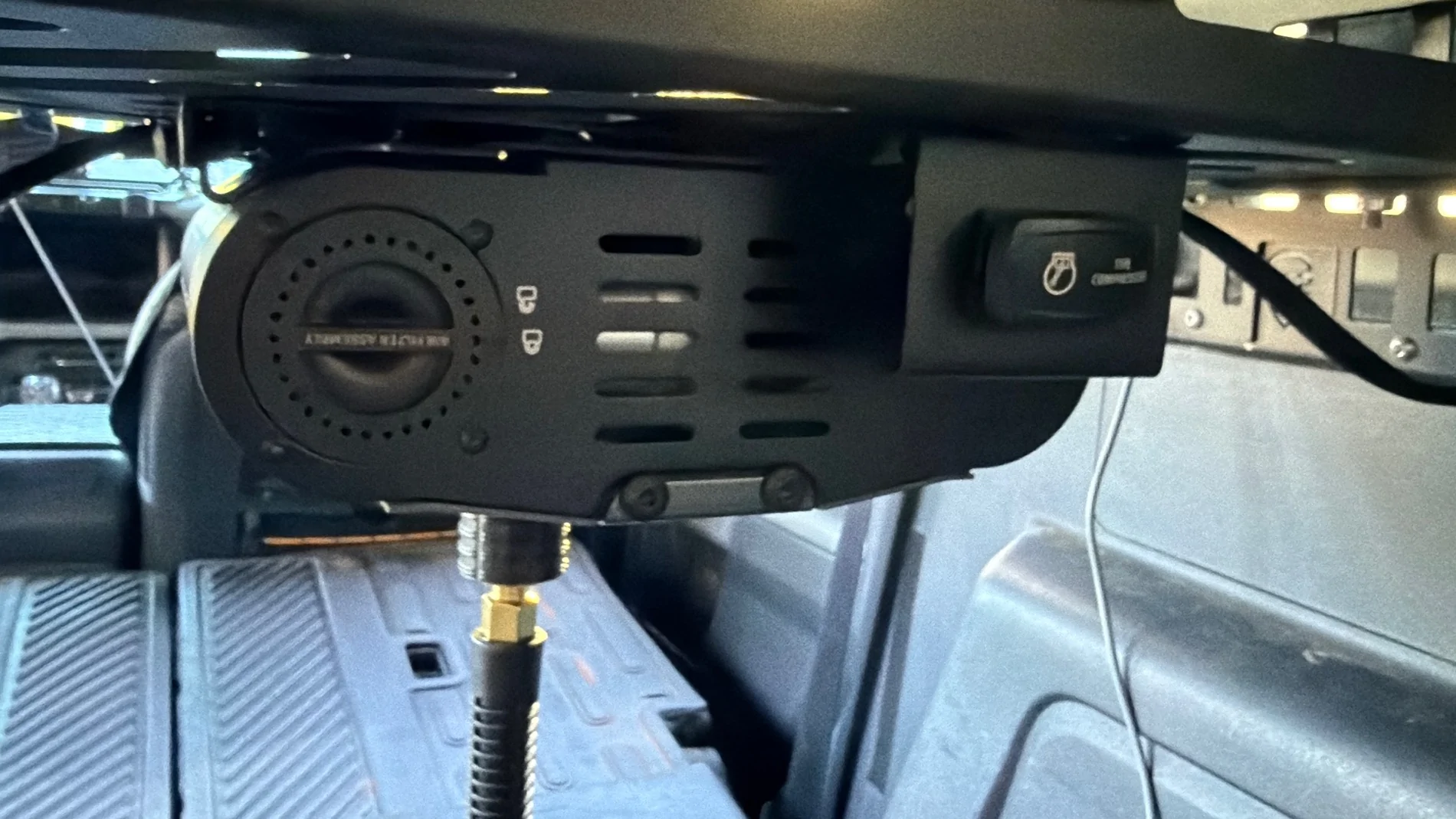

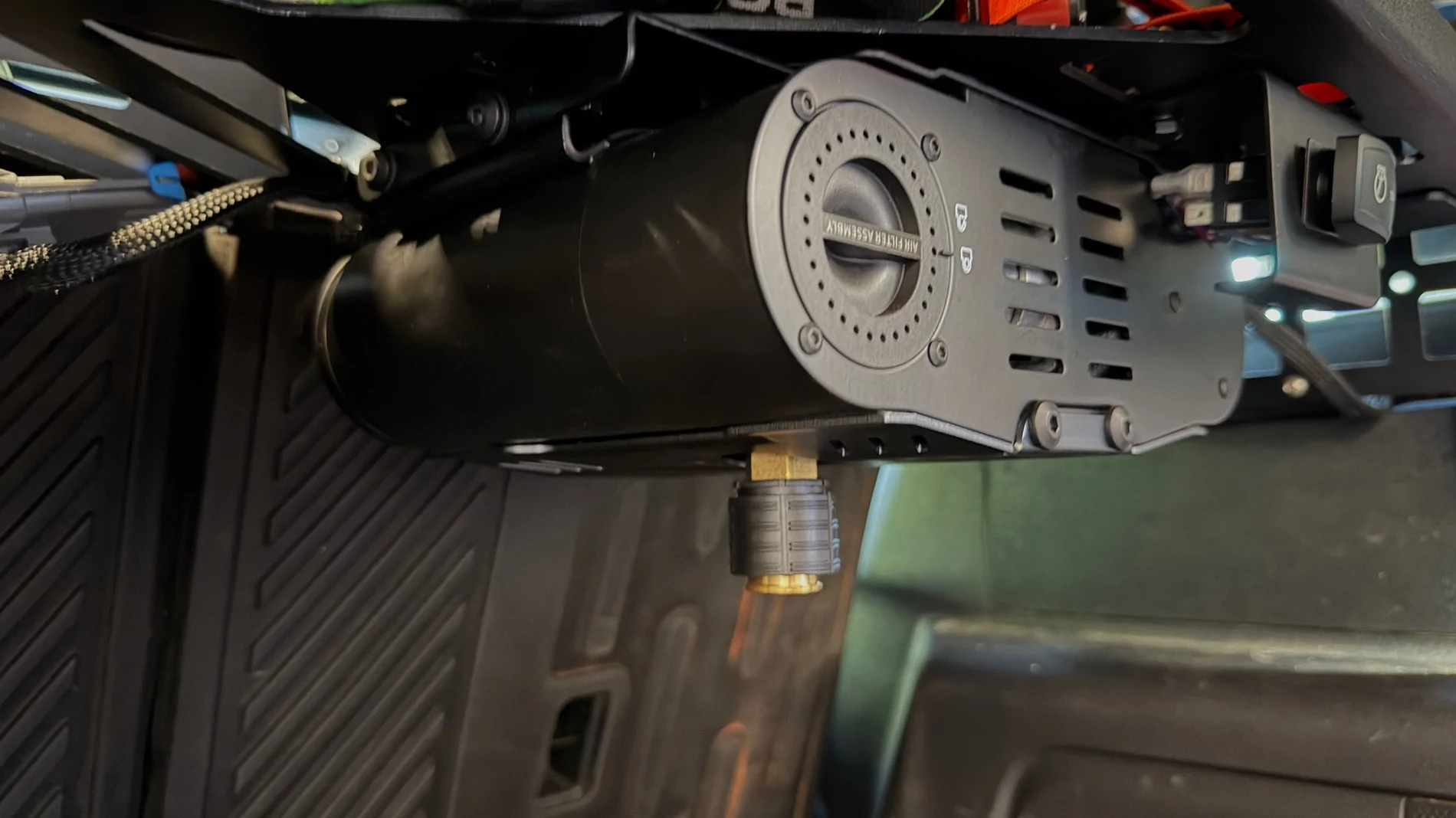

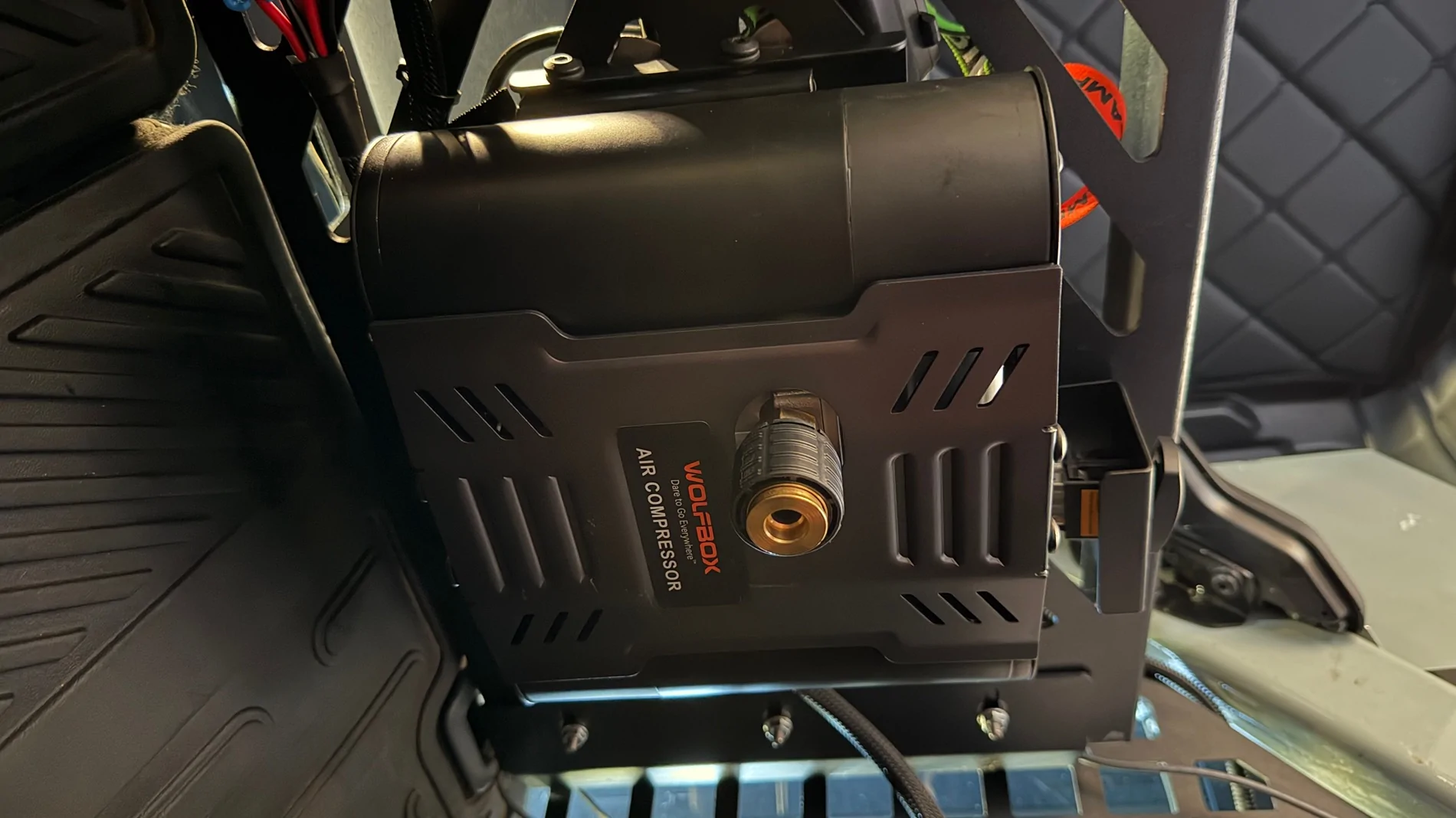

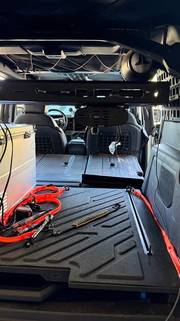

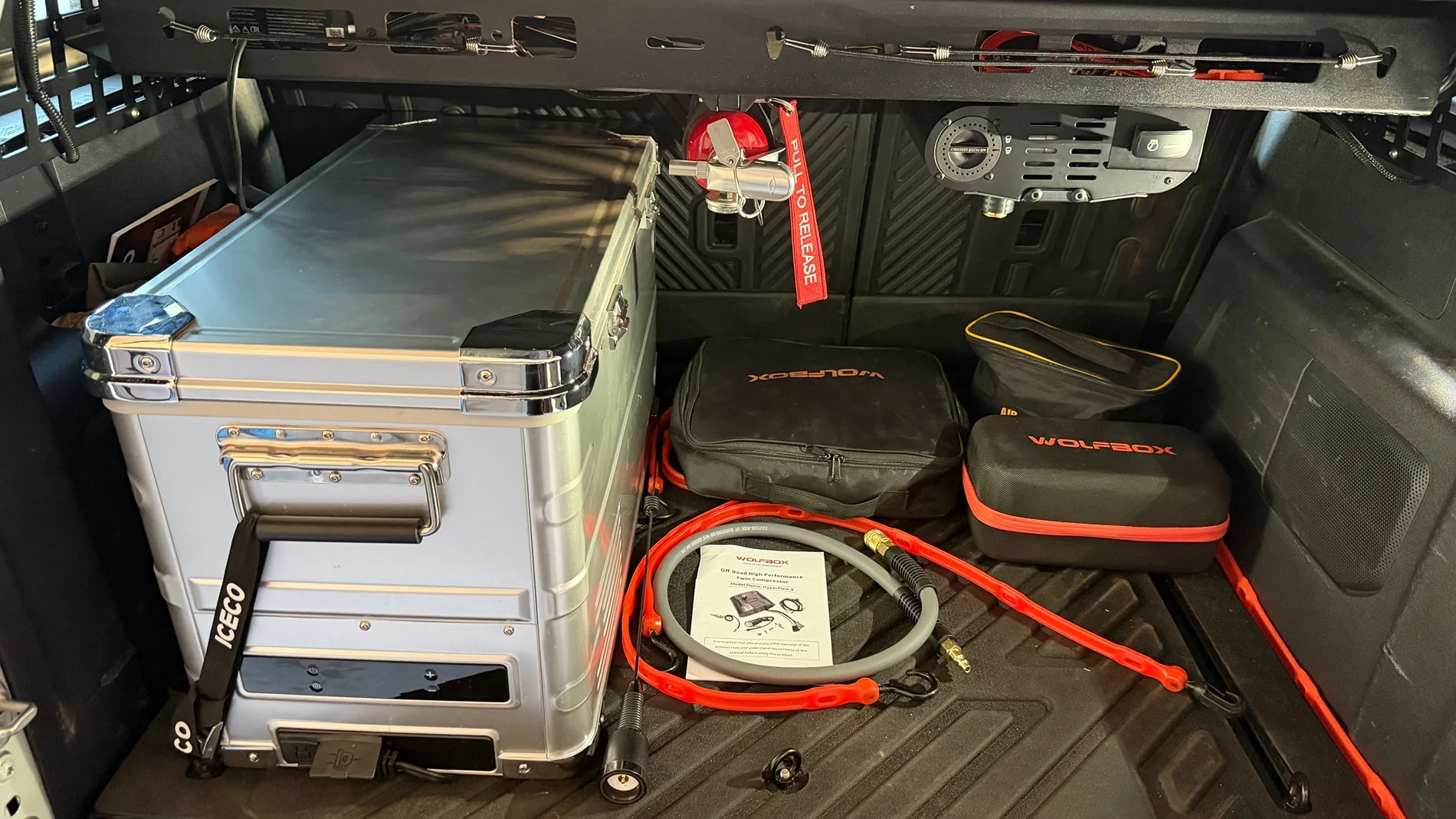

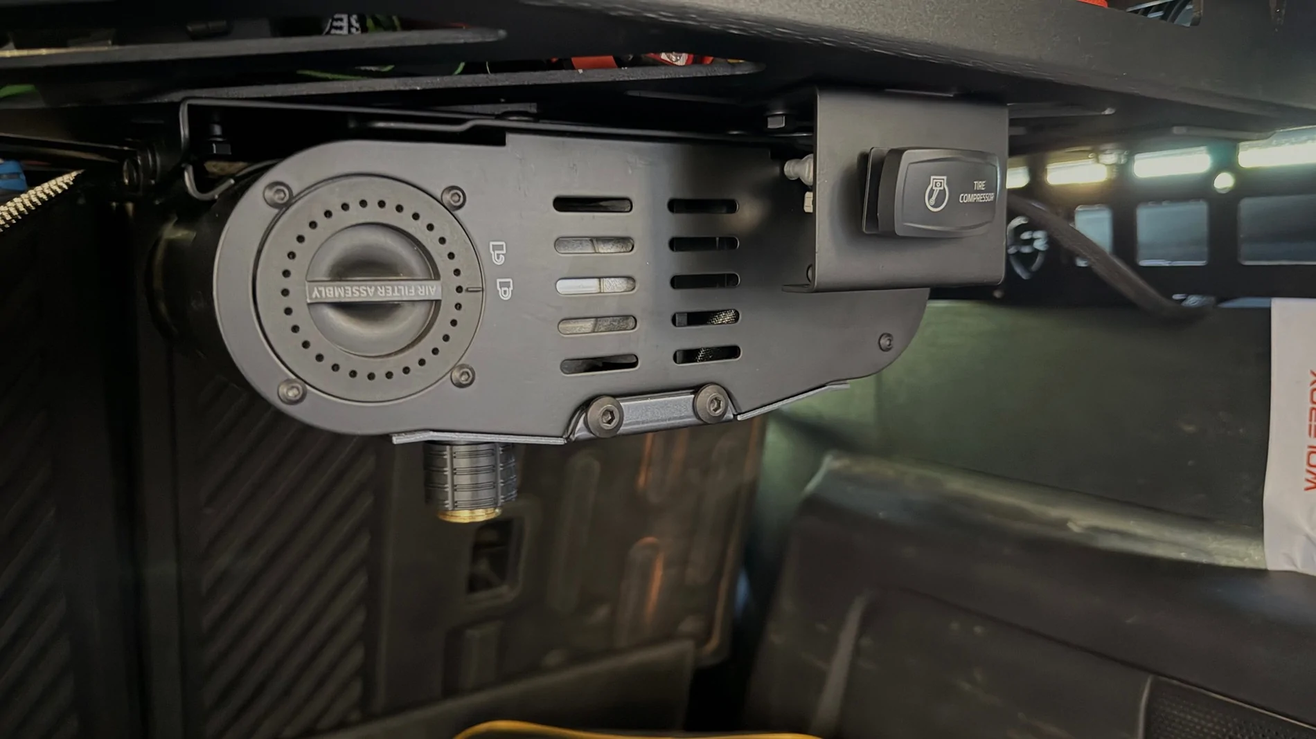

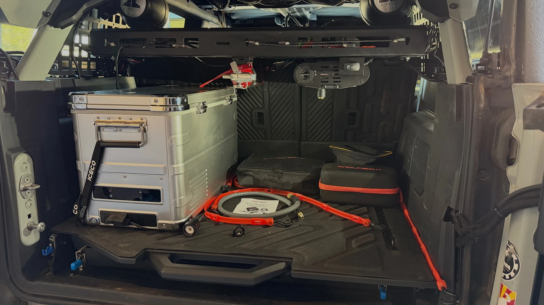

@WolfBox really taking the OffRoad air compressor market by storm. I recently installed the onboard twin motor compressor on the underside of my rear cargo shelf and love it. A lot quieter and quicker than the comparable ARB unit.
Ford Bronco Wolfbox HyperFlow X 12V Twin Motor On-Board Air Compressor install IMG_7444
Ford Bronco Wolfbox HyperFlow X 12V Twin Motor On-Board Air Compressor install IMG_7441
Ford Bronco Wolfbox HyperFlow X 12V Twin Motor On-Board Air Compressor install IMG_7413
Ford Bronco Wolfbox HyperFlow X 12V Twin Motor On-Board Air Compressor install IMG_7445
Ford Bronco Wolfbox HyperFlow X 12V Twin Motor On-Board Air Compressor install IMG_7446
Ford Bronco Wolfbox HyperFlow X 12V Twin Motor On-Board Air Compressor install IMG_7408
Ford Bronco Wolfbox HyperFlow X 12V Twin Motor On-Board Air Compressor install IMG_7430
Ford Bronco Wolfbox HyperFlow X 12V Twin Motor On-Board Air Compressor install IMG_7434
Ford Bronco Wolfbox HyperFlow X 12V Twin Motor On-Board Air Compressor install IMG_7416
Ford Bronco Wolfbox HyperFlow X 12V Twin Motor On-Board Air Compressor install IMG_7450

How's the 4k movie projection? lol Just kidding, looks good but in the way looking back, that would bug me I think. Nice addition to the compressor market and doesn't necessarily give the "many brands from one manufacturer" vibe.

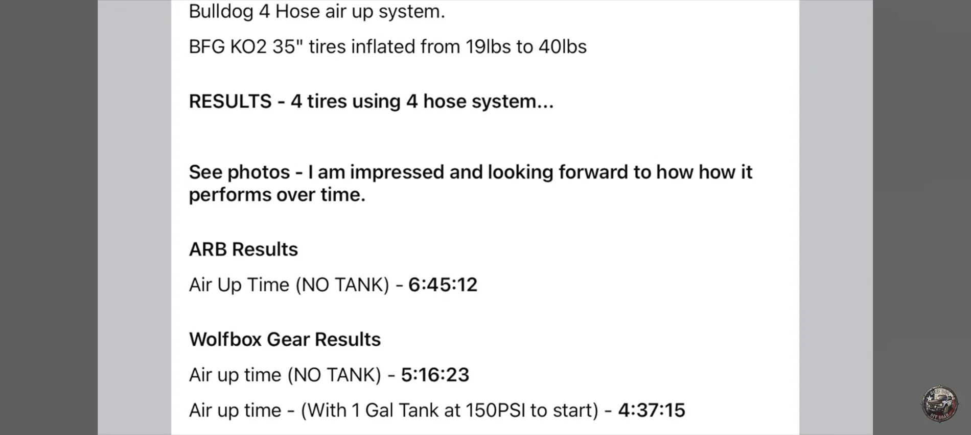

Maybe post some information like how long it takes to air up 4 x” tires from x to x pressure and what the outlet temperature is after doing so. Who cares what it looks like and how quiet it is.
From his video...
Ford Bronco Wolfbox HyperFlow X 12V Twin Motor On-Board Air Compressor install Screenshot_20260713-181128

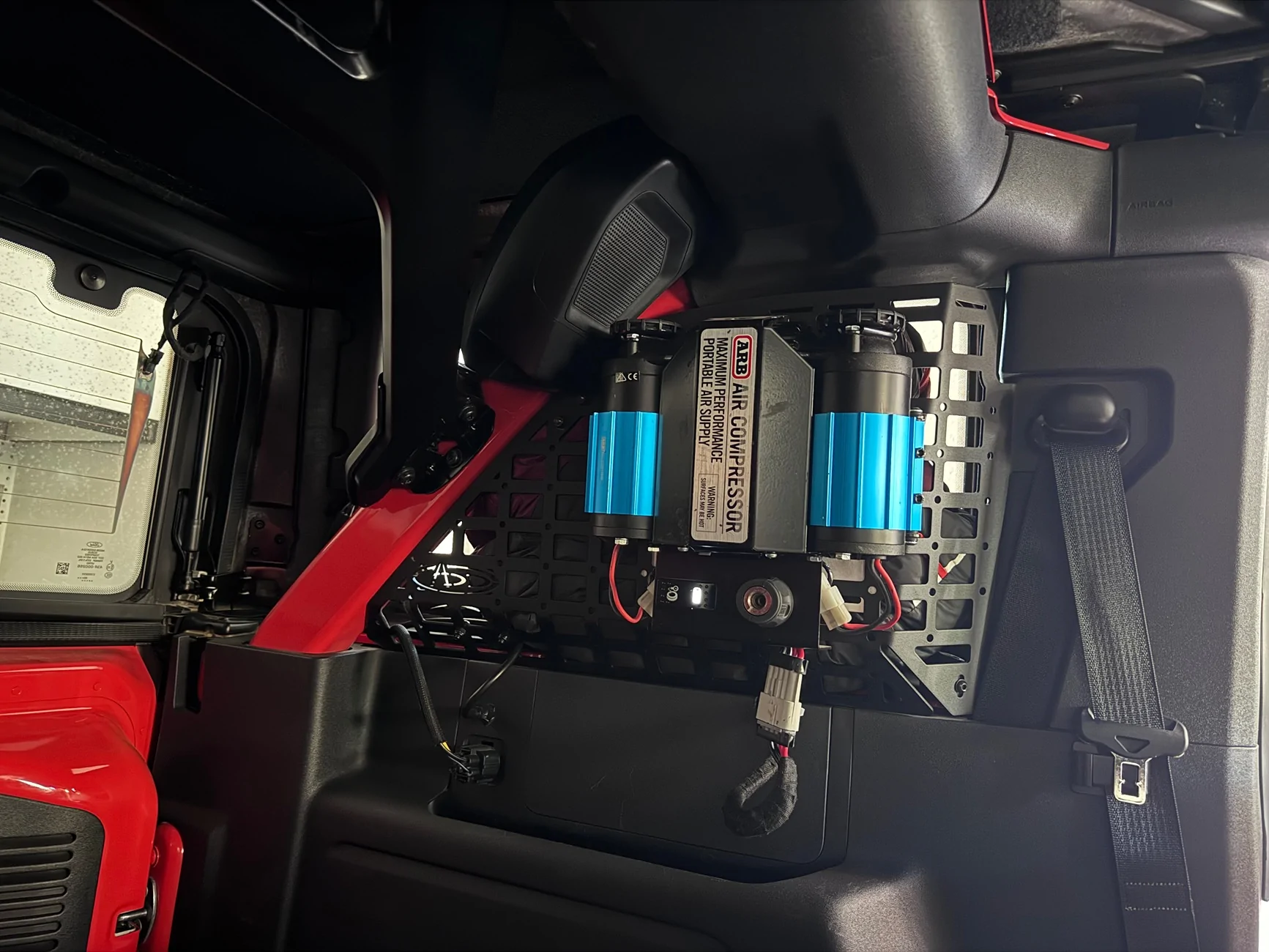

You mean mounted like this? My ADD panel has held this for two years through a lot of terrain with no issue. I’ve seen other window molles that I would not trust with the weight. So the molle design is probably a more important factor than compressor weight for mounting like this.
I checked the website it’s 20.4 lbs. and LWH is 10.4/6.5/5.35”. My ARB twin is 10.8/7.5/4” and 17.4 lbs. So ARB is a little lighter and more importantly to me close to 1.5” thinner.
Don’t know about the Wolfbox, but the ARB stays cool enough after filling 4 38” tires from 10 to 38 psi for me to leave my down sleeping bag stuffed behind it
