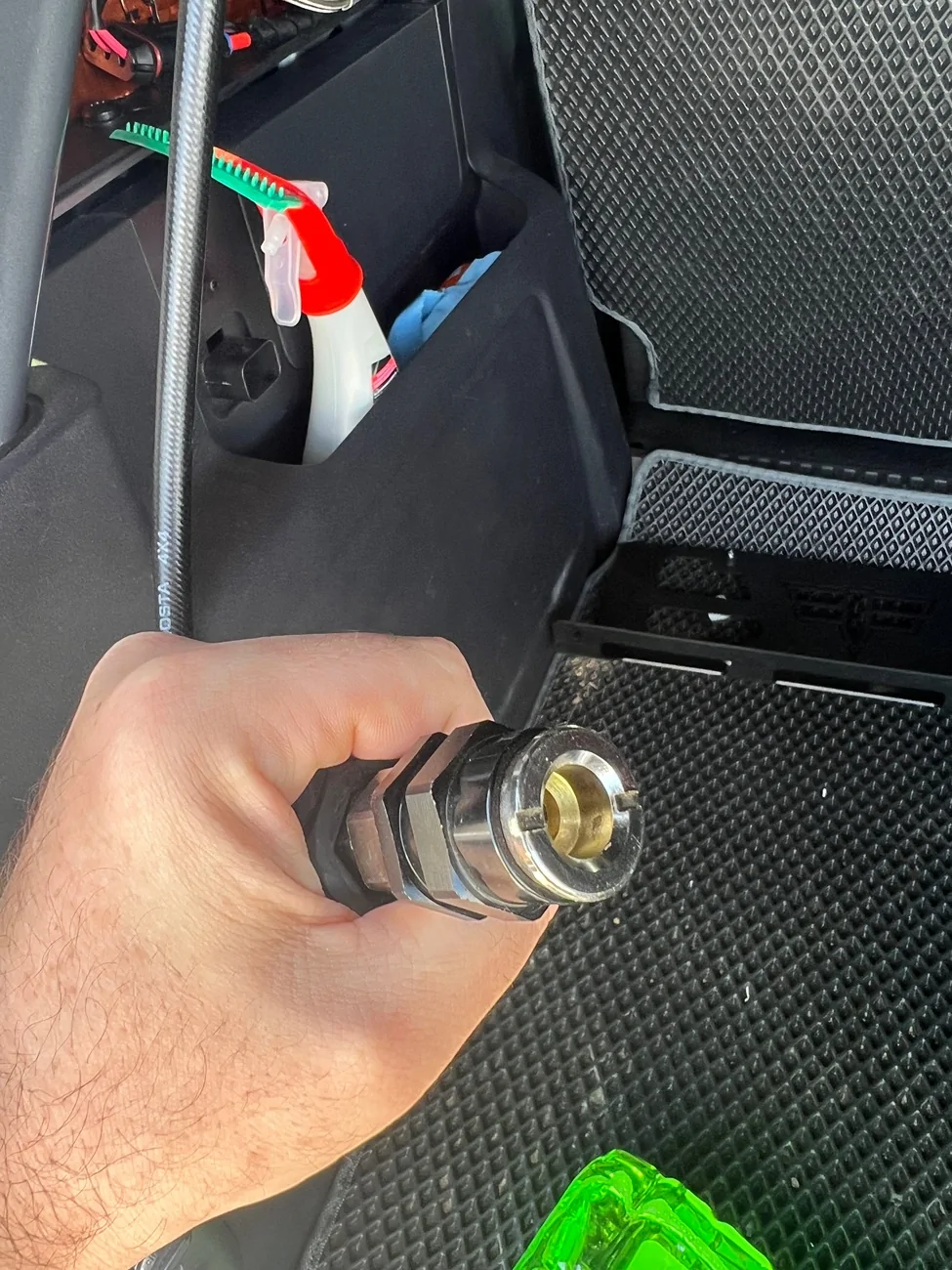

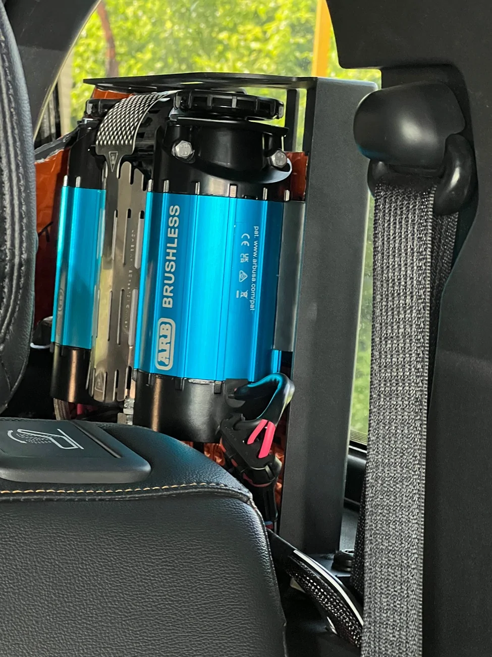

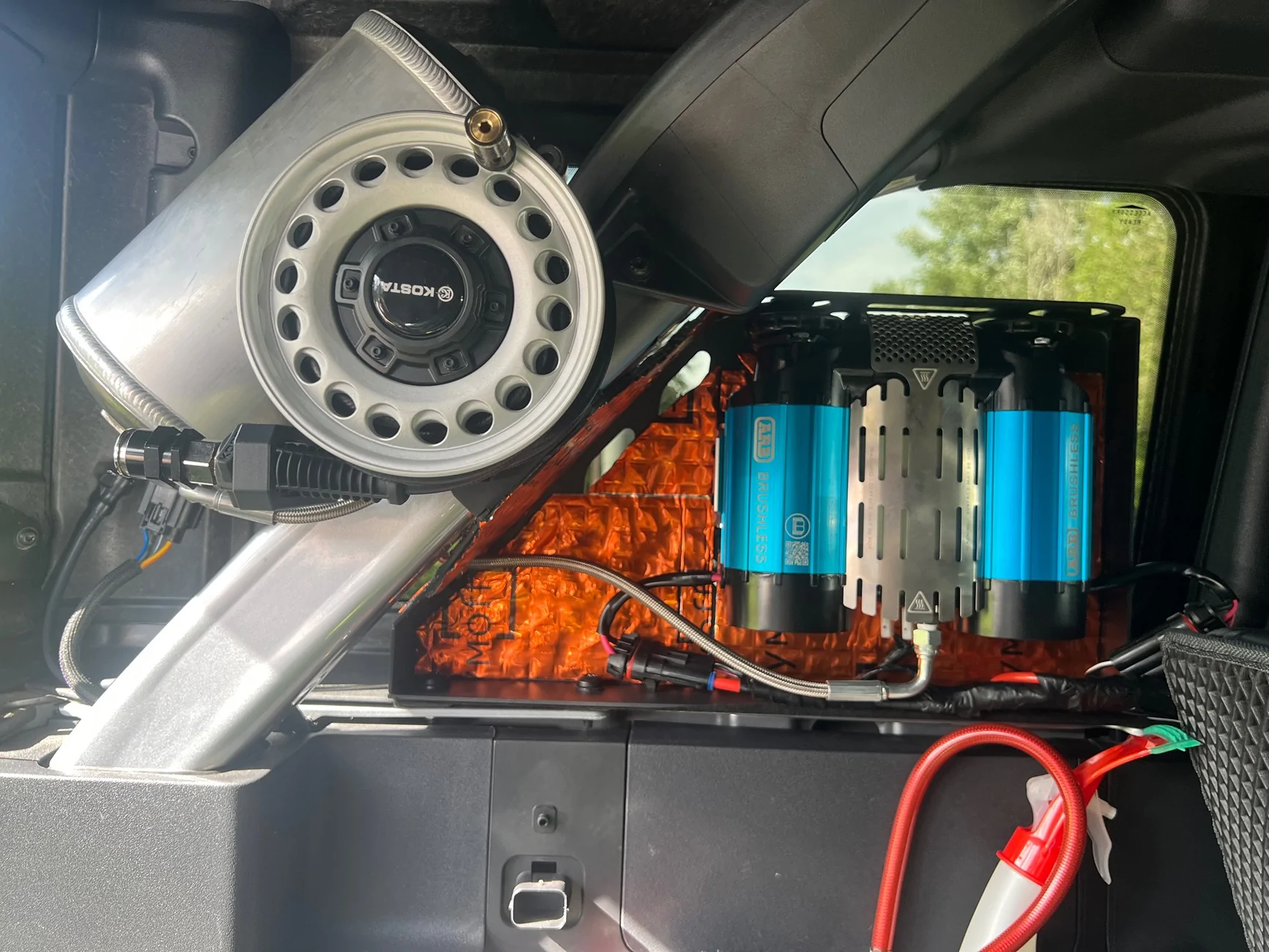

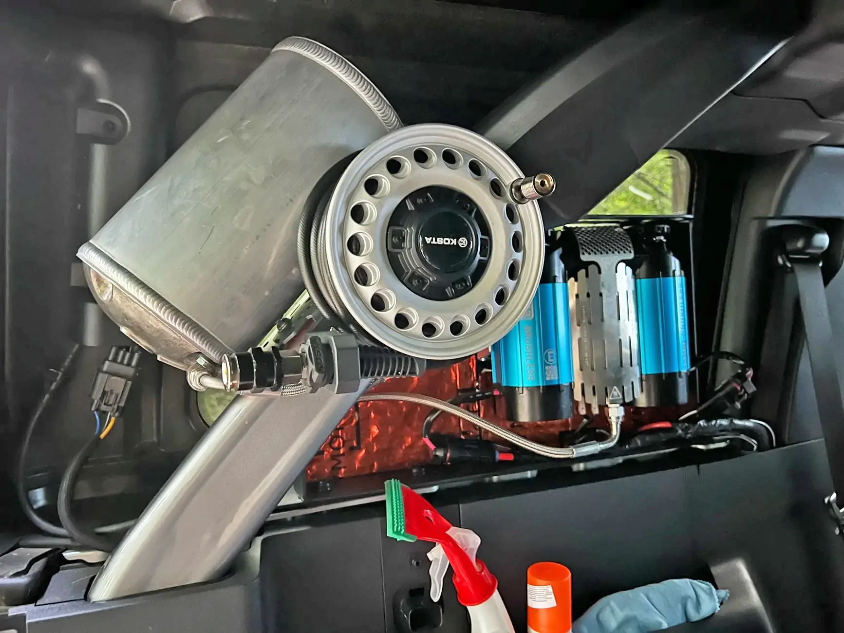

Hi everyone,
I just finished a project based on a brushless pump.
I bought the bracket, receiver, and hose reel from a Chinese website.
I also ordered a custom-made connection between the pump and receiver, as the kit came with a connection for a standard pump.
The wiring took a lot of time, so I decided against extending the wiring and replaced it entirely with the required length (about 5 meters).
When I first turned it on, I was shocked by the noise and vibration on the body (I think this is normal, but I've never encountered such powerful compressors). I decided to seal the entire bracket and the connections to the body with a vibration-insulating layer. The noise went down a bit, and the vibration is gone.
I'll post one photo for now; I'll take more in weekend.
Sorry, English isn't my native language.
Additions.
I'll set links to the bracket and pump where I bought . Also, a few photos.

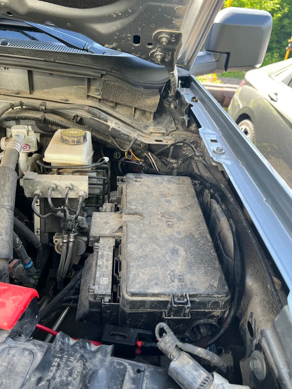

Please excuse the dirt under the hood; I was conquering a swamp. 🫣.
The pump is activated via AUX6.
Today I had time to test it. My size 35 tire was inflated from 0 to 2.7 bar in 1.5 minutes! I'm very pleased; it's faster than I expected!
I really liked the feature that allows you to fill the air tank with air, after which the pump stops working, but need to seal all the hoses. I did this with common plumbing tape. A filled tank instantly gives the wheel about 0.5 bar with the pump turned off.

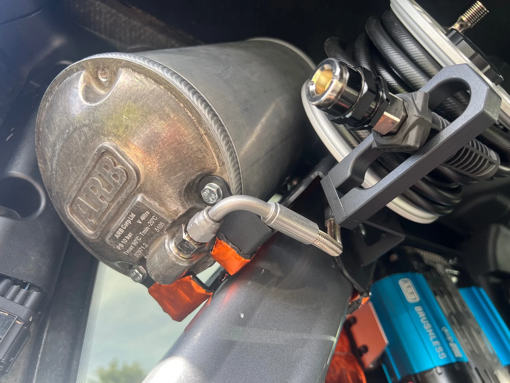

Some alarming things:
1. I was puzzled by the temperature of the hose coming out of the pump; I literally burned myself. Now I need to figure out how to prevent the wires from touching the hose;
2. I didn't wait for the cooling fan to turn off, even though 10 minutes had passed, so I had to leave the car with the fan

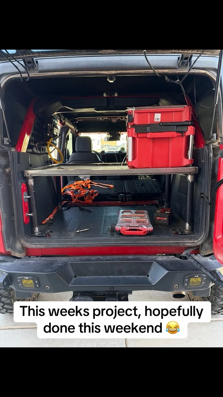

Mounted my ARB to a molle in the same spot, Its on the inside now cuz im redoing the entire rear section so dont mind the hose lol its just there so its not hanging down :)
