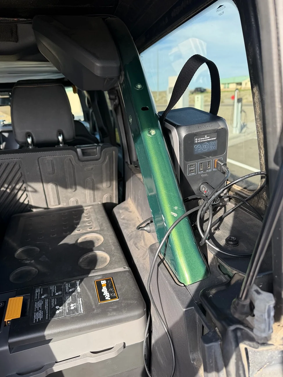

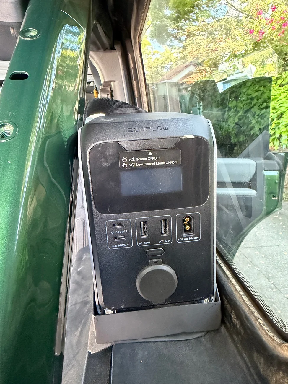

I finished a custom battery mount for the Bronco. It’s specifically for the Ecoflow Trail 200/300 battery series. It mounts to existing hardtop retention bolts next to the passenger side rollbar. Pics below.
It’s a small capacity 288Wh battery with USB and 12V outputs (no AC out). I don’t have large power needs. The main purpose is to power my BougeRV fridge, and keep it going should I have a one day layover with no other power. I’m usually moving everyday and the battery is charged from the 12V rear passenger outlet.

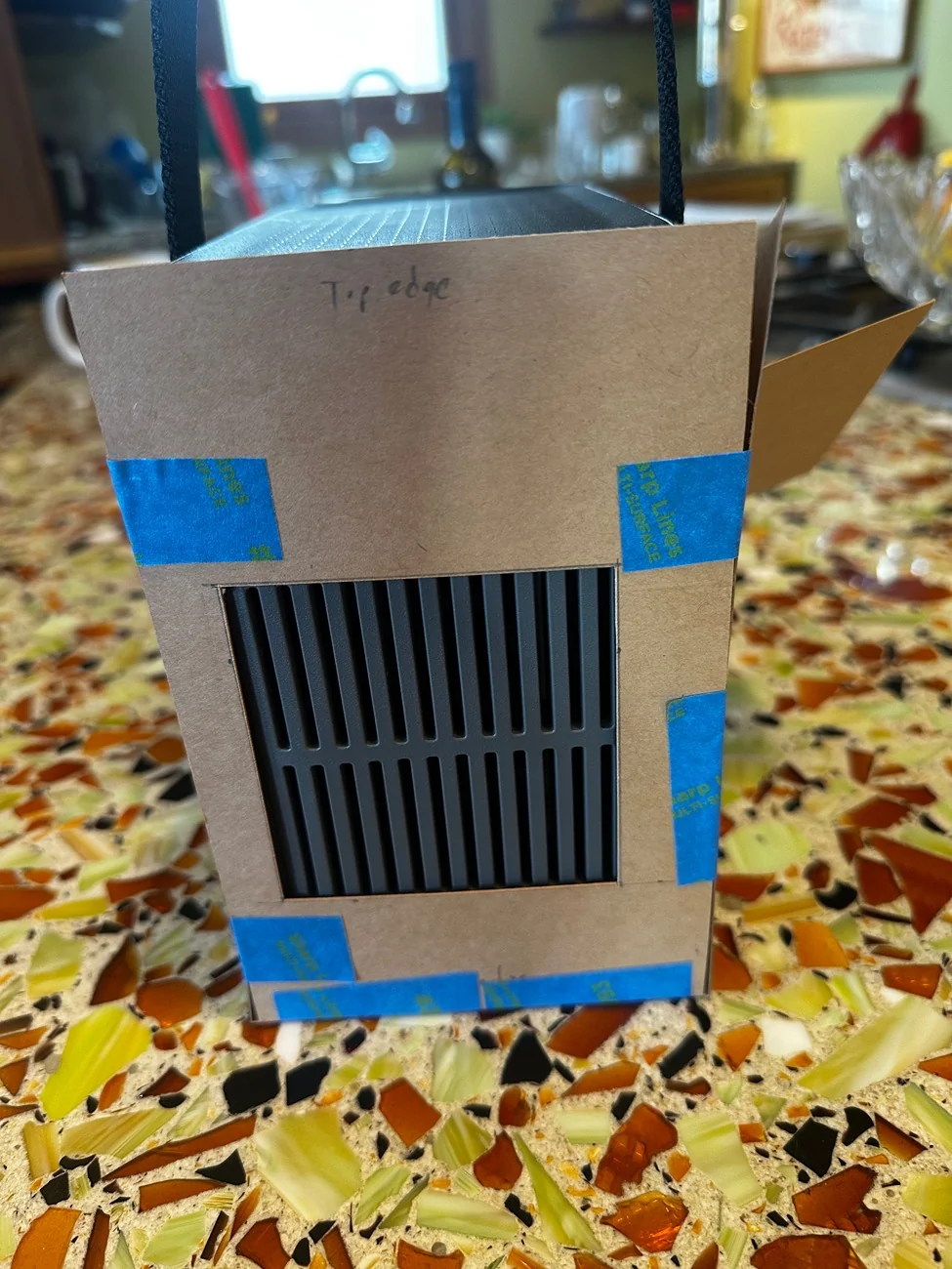

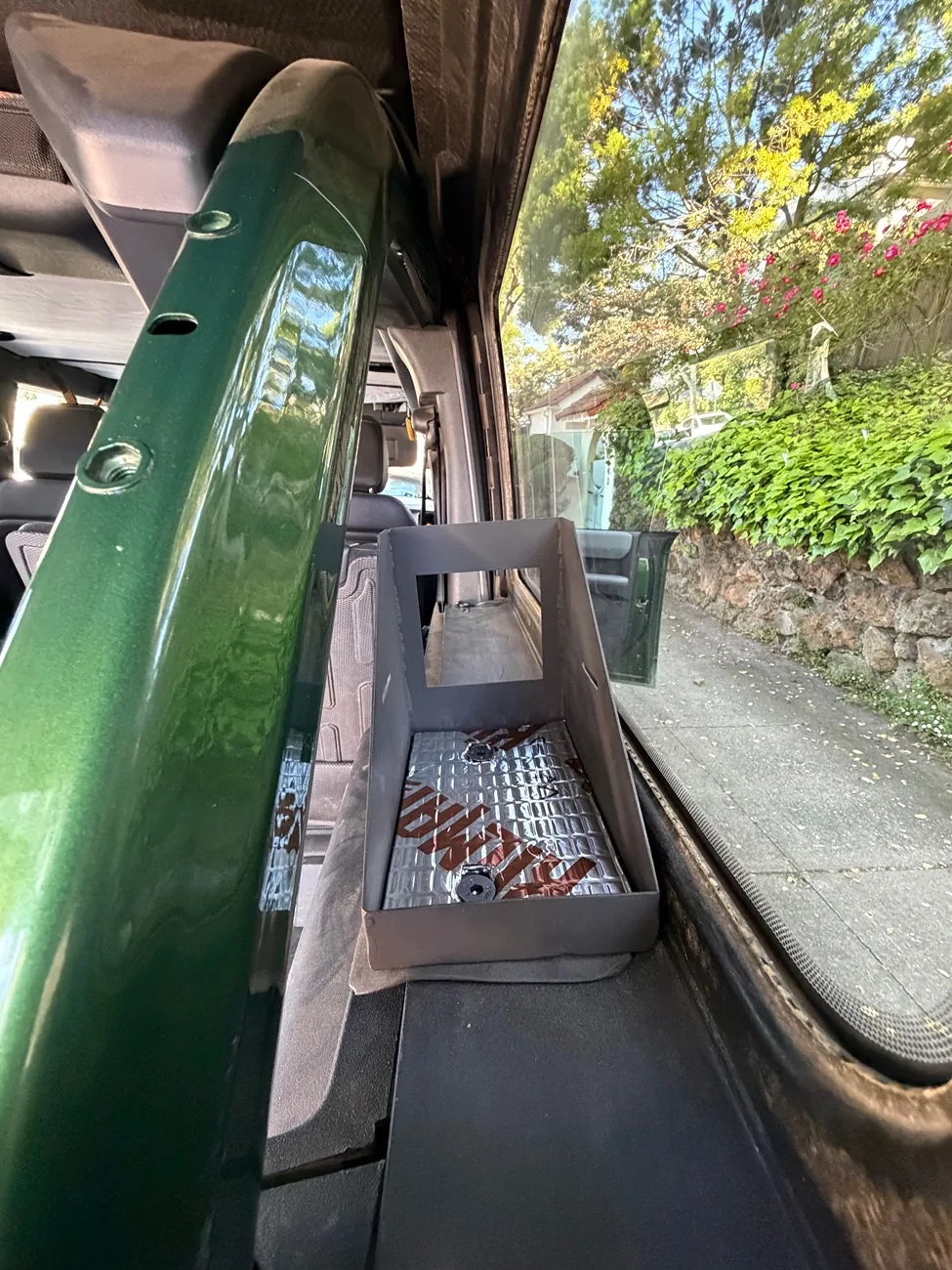

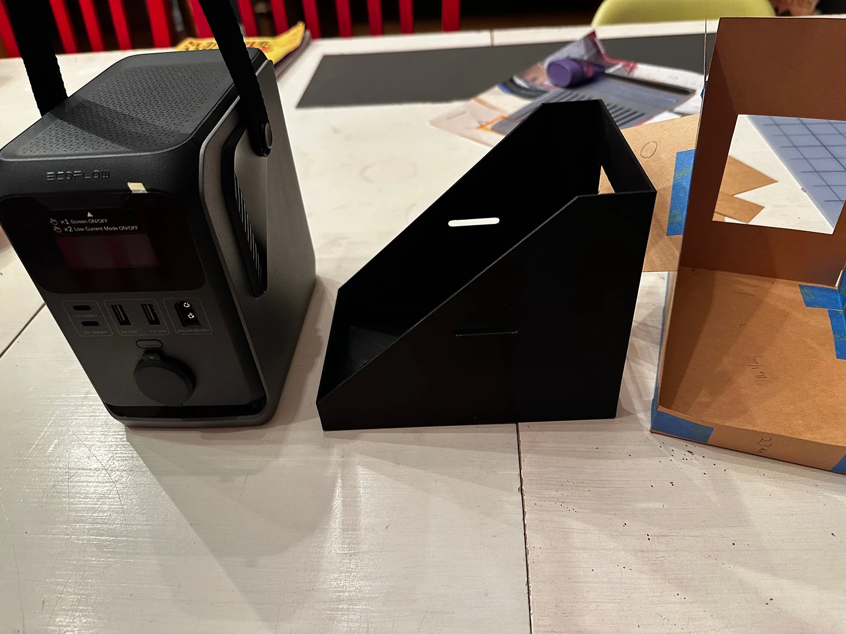

But I had no way to secure the battery. So I started the design process using CAD.V1 (cardboard…). Made a quick prototype and figured let’s keep going. A friend (the kind of friend you really want!) has a 3D printer, welder, etc. So we BS-ed during post-mountain bike beers and he agreed to do a Fusion360 CAD render.

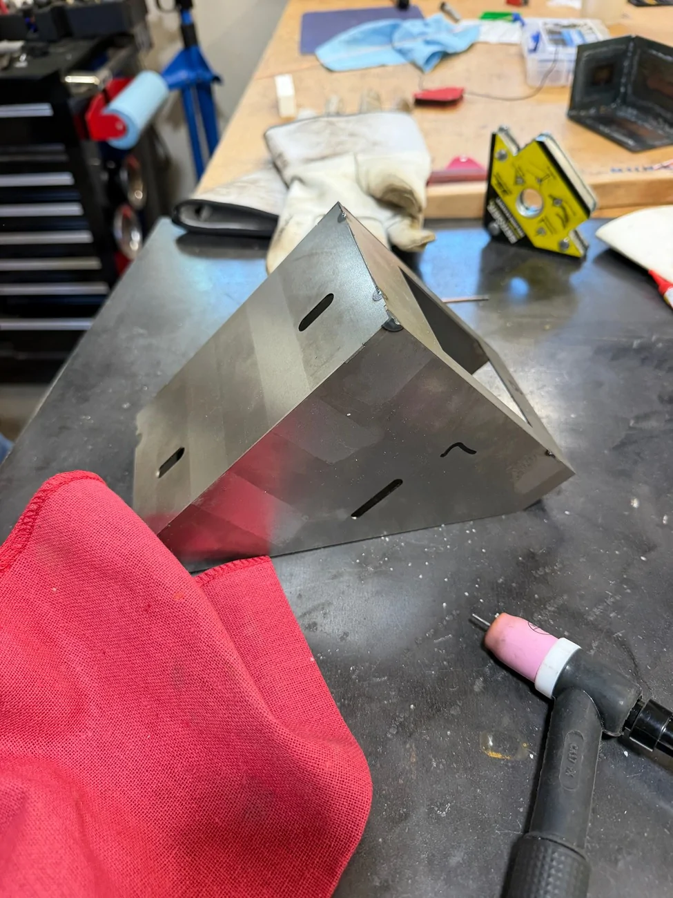

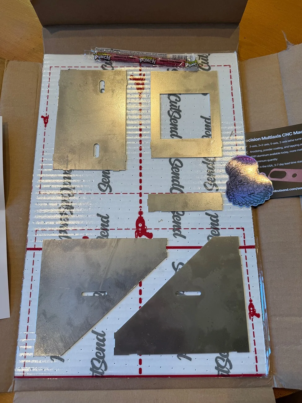

After a couple 3D prints, and test fits, I then sent it to Send-Cut-Send to have the metal parts cut. A few days later SCS delivered (what an amazing service!!!) and we welded, grinded it smooth, and then several coats of matte black.
Here’s the result. A small, integrated battery mount that fits between the rollbar and hardtop window. Uses existing hardtop bolt threads to secure it (I sourced low profile flat M8 bolts for the base). I’ve completed 20-30 twisty off-road miles so far and the tolerances seem to work between the rollbar and the window as the frame flexes.
I realize it’s not useful for everyone. But it works for my low power needs. And was fun! My first metal project and first CAD learning experience. A few more ideas are percolating.

I had the same concern about the battery going airborne. The design includes two slots through which I can run 1” webbing to hold down the battery. At least that was the plan. However after welding it seems like the heat shrunk the width slightly (or perhaps the tolerances were too tight) so the battery really wedges in the box tightly. It takes quite a bit of force to remove it. And the webbing doesn’t fit. I’ve thought about a second version to fix that. But haven’t bothered yet. I don’t think it’s going to fly out while speeding through the whoops.

sendcutsend fabrication cost was $43 including tax + free shipping using 1008 Mild Steel .048”/1.2mm. This is how it came packaged. And a few cents for 3D printer materials. And time.

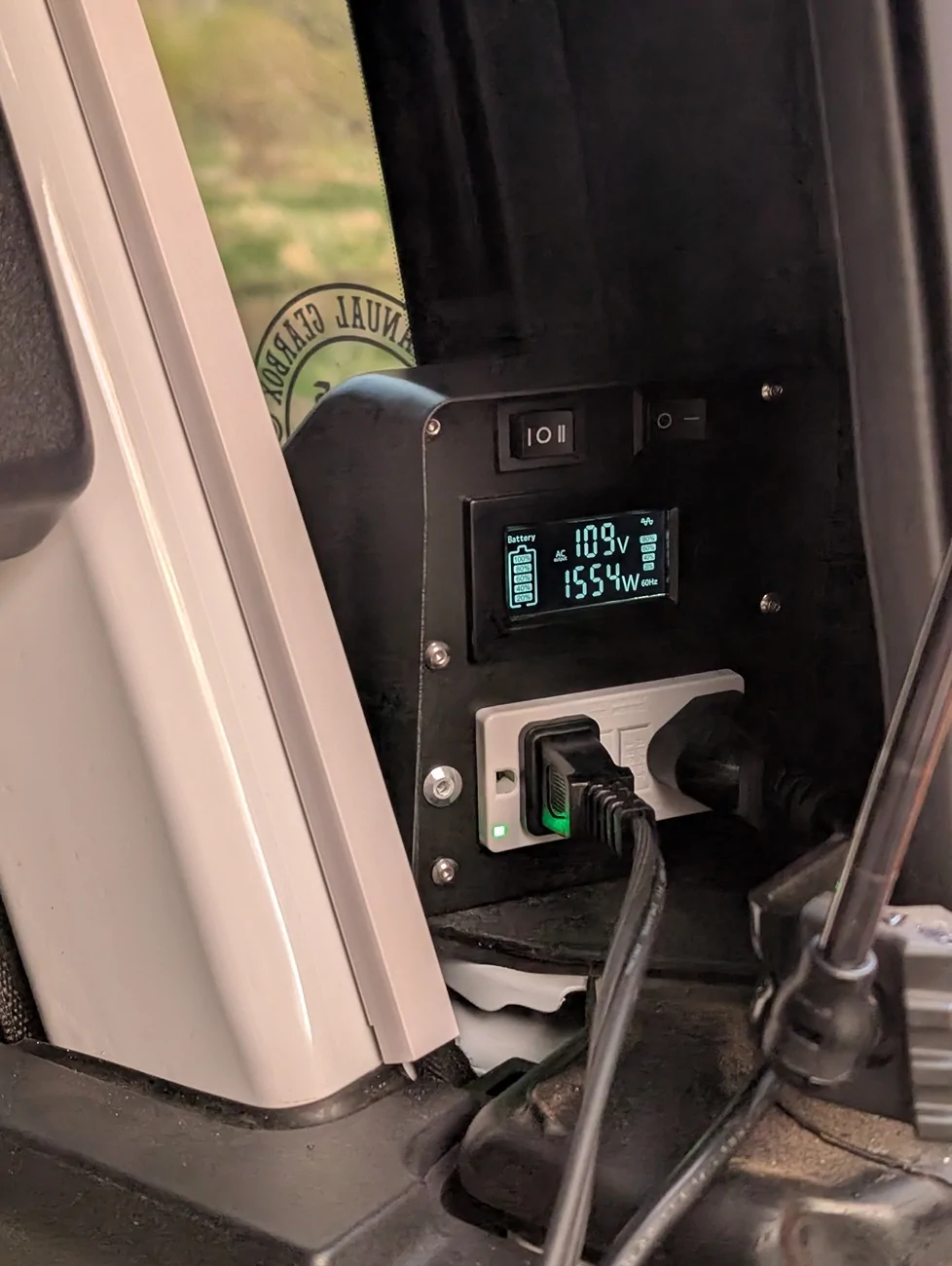

SCS does really good bending so you could have saved yourself a lot of welding! I have my 110VAC outlet for my much larger battery system in the same location.
