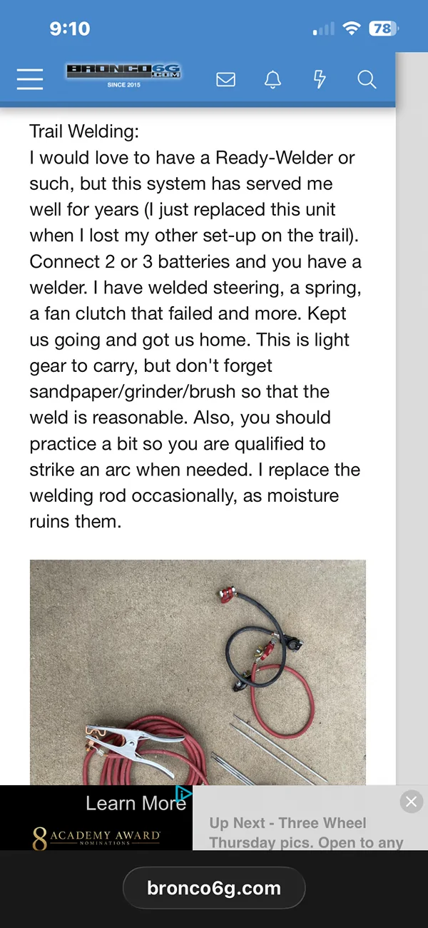

On a recent thread someone posted a couple of links , one was this one
https://www.bronco6g.com/forum/threads/my-recovery-gear-set-up.14803/#post-539816

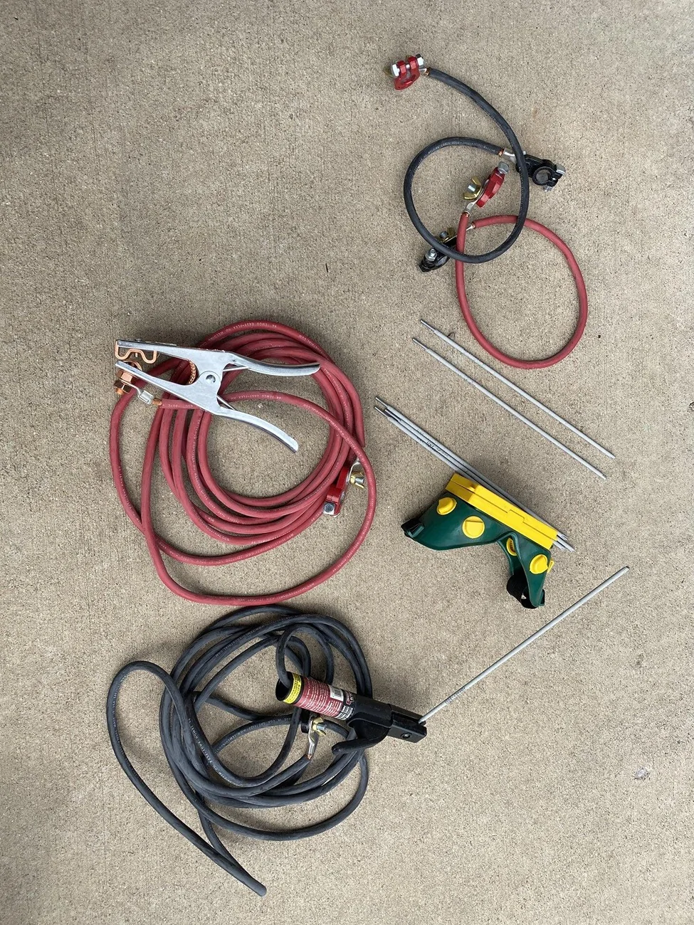

Ford Bronco Trail welding w/ vehicle battery? IMG_8540
I believe the Rod needed is a 1060, guessing small 1/16 is ideal for one battery, just will need multiple passes to get a solid weld.
I do weld (but not a welder ;^) ), so something in me keeps thinking ‘ battery goes boom.
I would like to hear from those that do this or not because….
Tks
Ford Bronco Trail welding w/ vehicle battery? IMG_8541

I welded my CJ2a frame together with two jumper cables, two batteries, 3 sets of sunglasses and some sticks of 1060 before all these fancy setups…

Not a welder either, but a I grew up a poor redneck for sure.
First, 1 battery isn't going to do it. 2 Might get an arc, but it's going to stick a lot. 3 batteries is as good as you get, and 4 is on the high end of too much voltage.
Keeping in mind that this is a makeshift, limp me off the trail tool. For safety, you can weld a tie rod or whatever you broke back together, but the welding should not be considered a repair, or a fix. This is a temp limp home at best and likely only a temp limp to the parking lot.
Considering the limited emergency use nature of this "welder", you should not be concerned that this will destroy the batteries...that's just the nature of the tool. Consider the batteries as limited-use and maybe "one-time use" depending if they are new or not and how low you draw them down. You could likely sleeve a broken tie rod going like 15 seconds at a time and resting a min or two in between to let the batteries equilibrate. This wouldn't destroy them and you can always charge them in your truck as the voltage gets low.
This hits the Fast and Cheap points of the Iron Triangle.
