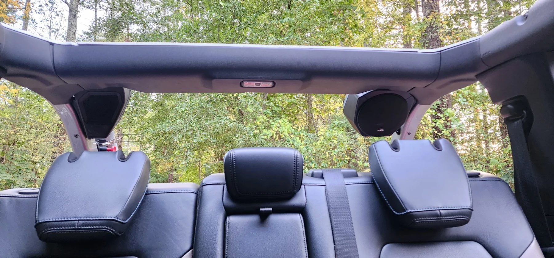

  1. [DONE] Replace rear speaker pods with SSV Works BR-B65U 6.5" unloaded pods. Install sound insulation inside pods to reduce internal resonance (I ended up using Second Skin PolyZorbe™ Vivid Hexagon Acoustic Panels, cutting one up into 4.75" squares, one per pod. One hexagon did the trick. I bought two just in case, since I didn't know if one would work, and wanted room for playing with them if needed. They're like $7 each.) Install Skar NPX65 6.5" 300 Watt Neodymium Mid-Range Loudspeaker in each pod.
  2. Install Skar SPX-T 320 Watt Max 1-Inch Elite Dome Tweeters in the rear roll bar, facing forward, since I want my driving audio experience to be good and I don't care much about the rear passengers since I'm a selfish jerk. :sunglasses: {NOTE: I have the tweeters leftover from my last build, but these tweeters came as part of the Skar SPX-65C 6.5" 400 Watt 2-Way Component Speaker System. The midwoofers that came with that system rusted away in the doors of my old vehicle, so I replaced them with the previously mentioned NPX65 loudspeakers, and I'm glad I did because those fit in the SSV pods, but the SPX-65C midwoofers do NOT fit in the pods without some trimming. Their mounting hole size is a slightly larger requirement (SPX-65C is 5.68") than the NPX65 (which is 5.59"). The SSV pods have a hole that is 5.589", which is just slightly too small for the SPX-65C midwoofers.} I intend to eventually drill holes into the overhead plastic panel to mount these tweeters to, but will first affix them temporarily to test the locations [TESTED LOCATIONS: they sound great facing forward in the roll bar, so I'm moving forward with drilling the holes!] I already have the crossovers that split the tweeters and woofers, and those will mount nicely inside that plastic trim on the roll bar without interfering with the airbag pressure tanks Turns out there's not much room inside the plastic roll bar, so I'm mounting them to the outside of the plastic. I like the 'exposed technology look anyway, kinda cool to show off the customness of the system. I will rewire the midwoofers in the pods to hook up to the crossovers, I'll of course wire the tweeters into the crossovers, and then I'll run my own speaker wires to the amplifier when I eventually get to that - but for now I will just hook the factory pod speaker wires into the input of the crossovers and have the rear channel drive the midwoofer pods and overhead tweeters.

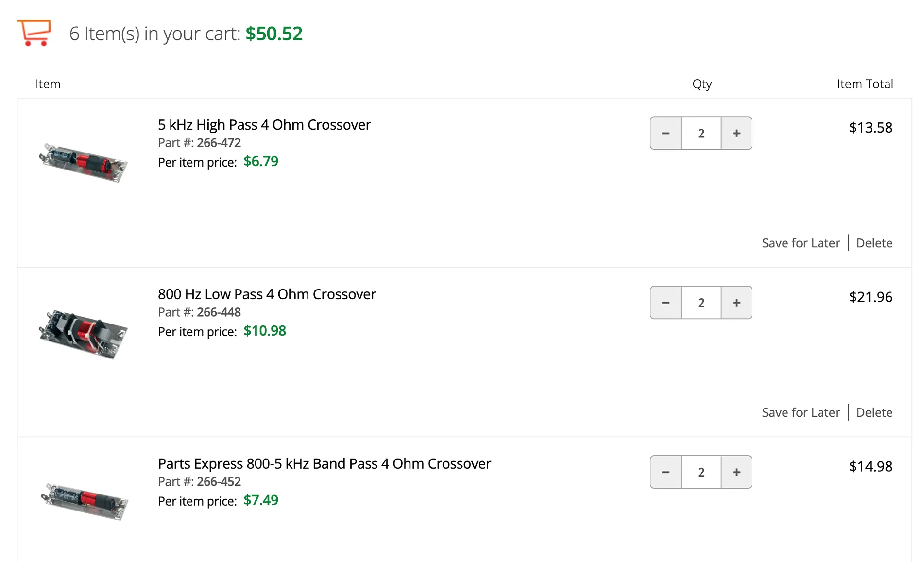

    • The following are from parts-express.com
    • 5 kHz High Pass 4 Ohm Crossover for the neodymium dome tweeter from SPX-65C
    • 800 Hz Low Pass 4 Ohm Crossover for the 6.5" midwoofer from SPX-65C
    • 800-5 kHz Band Pass 4 Ohm Crossover for the 4" TX4 coax

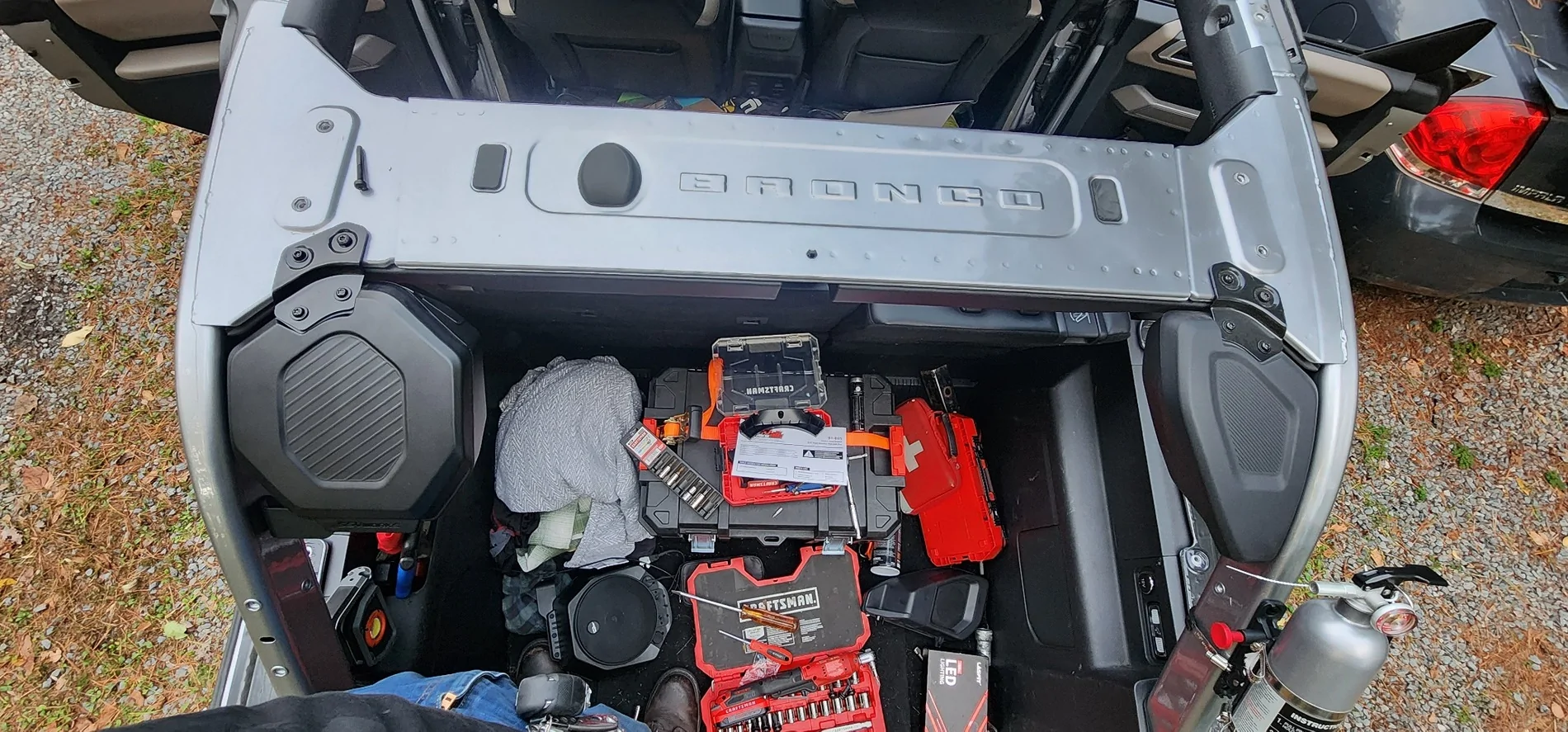

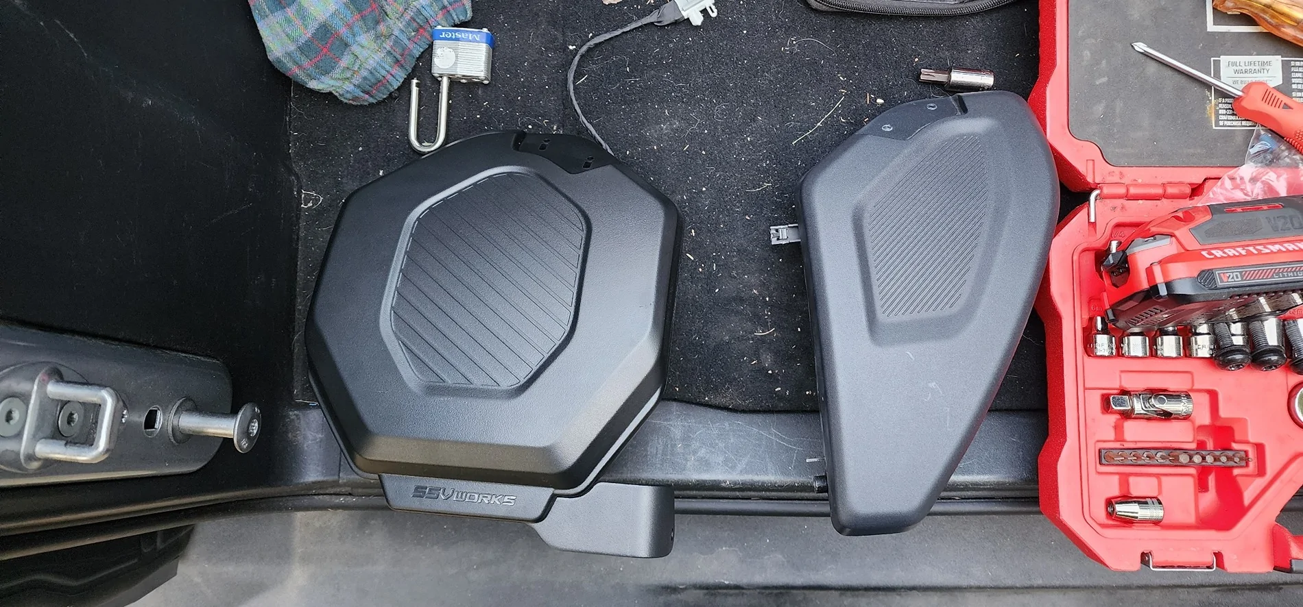

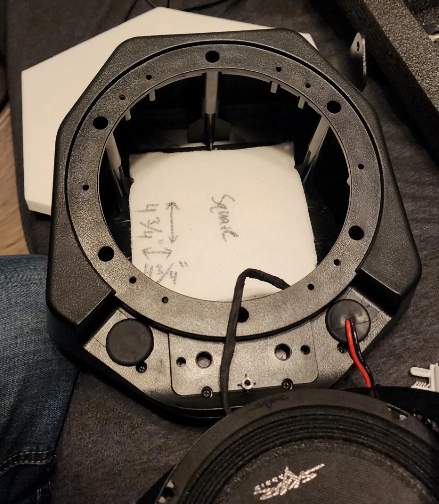

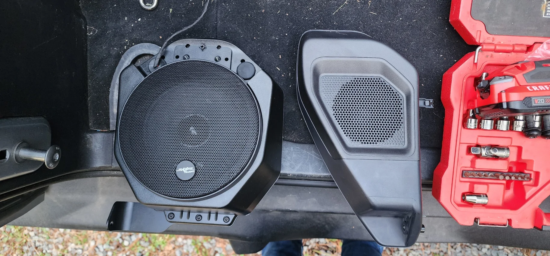

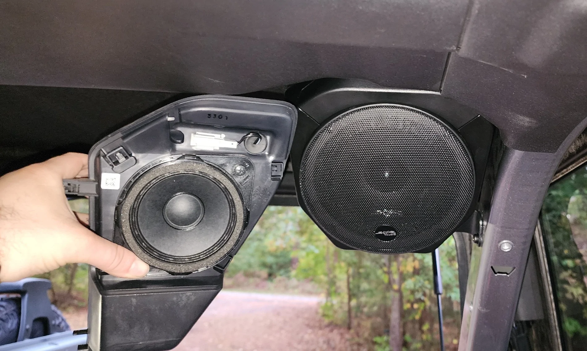

The speaker pods were super easy to replace. As planned, I loaded each SSV pod with a square of sound-damping material to reduce internal resonance.
Ford Bronco Audio System Upgrade Log - The WildeBeast 20251015_164913
I simply cut the hexagon of PolyZorbe into a 4.75" square and it pressed tightly into the pod between the structural support fin things. No adhesive needed as it was a very tight fit.
The SPX-65C kit comes with its own speaker grilles which I put to use here. Looks super clean in my opinion.
I took off my hard top to access the pods easier. Here are a few comparison pics of the old vs new pods. The old pod speakers are so wimpy and tiny! Little 4" speakers... No wonder it was so quiet at full volume with the top off at any speed higher than 40mph! These bigger speakers will do nicely to fill the air with more sound.

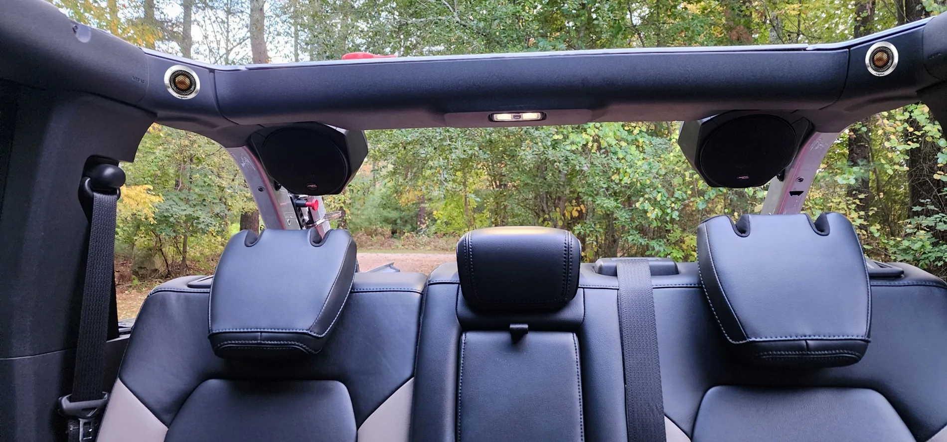

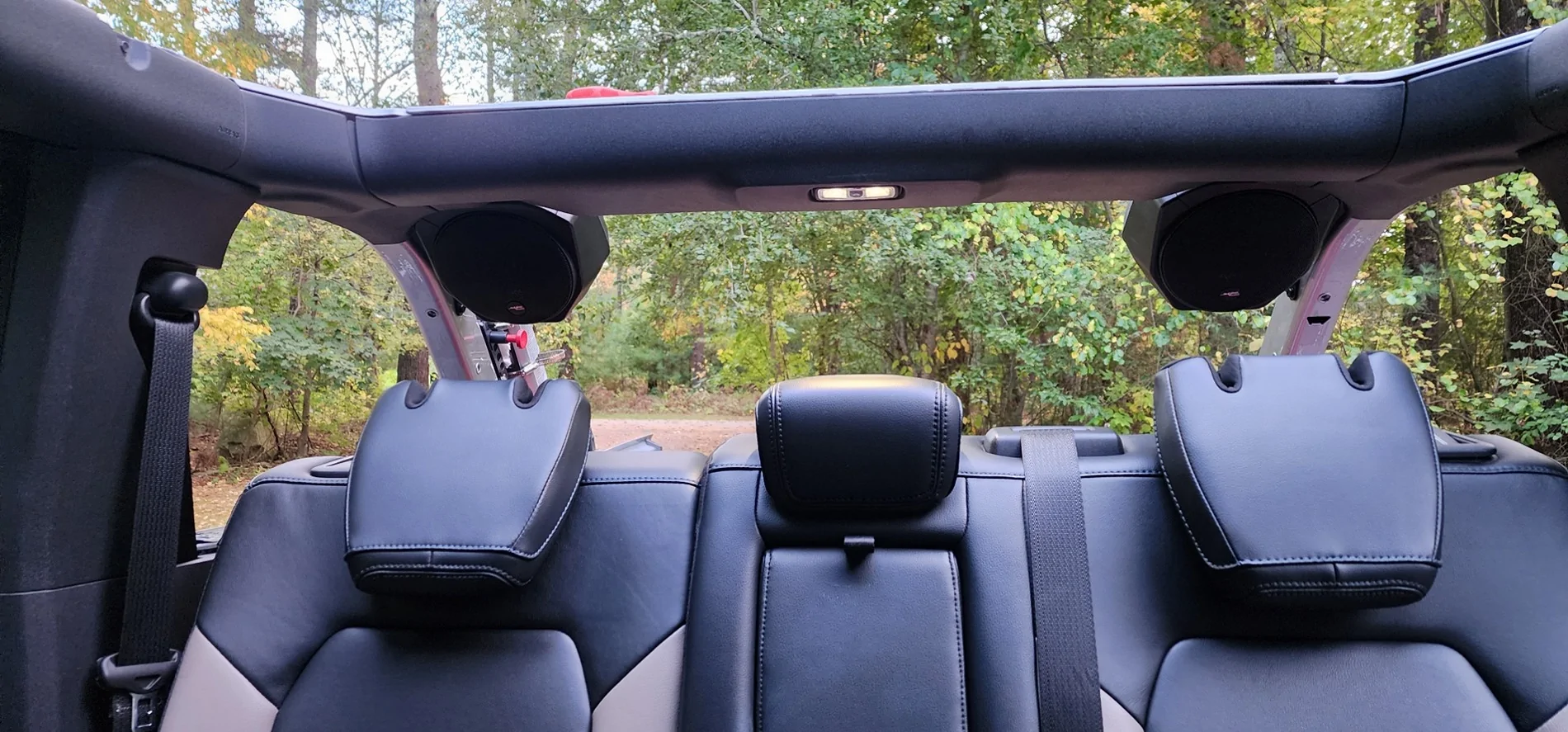

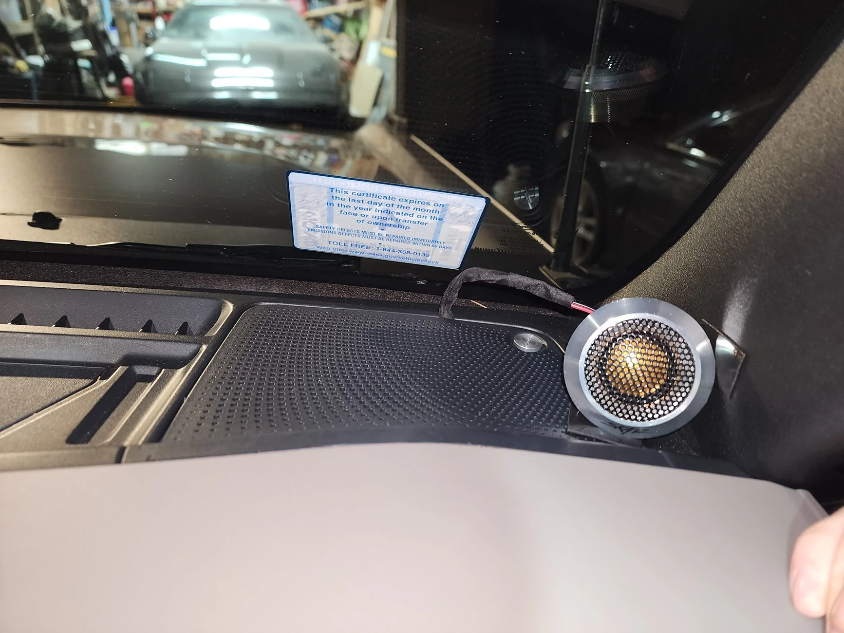

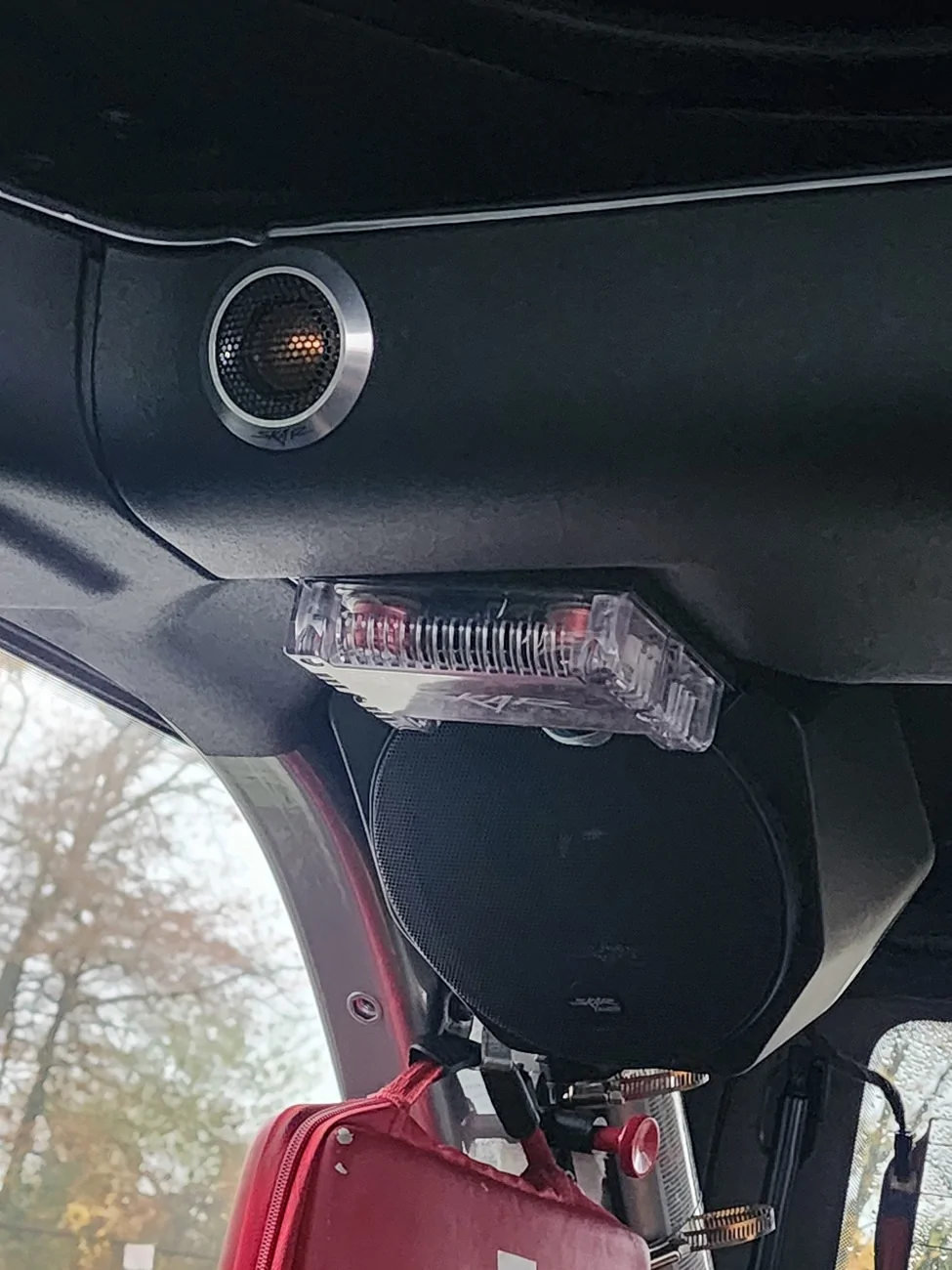

Now then... How should I mount the tweeters? I have two different locations in mind for the rear. What do you think would be a better option? My main concern is to not interfere with the airbags, so I'm thinking option 1 may be more suitable. Other ideas are more than welcome though!
Option 1: on the large overhead plastic trim piece [This is the option I ended up choosing. The side pieces in option 2 would interfere with the airbags slightly.]
Ford Bronco Audio System Upgrade Log - The WildeBeast 20251015_175251-idea1
Option 2: on the smaller side trim pieces
Ford Bronco Audio System Upgrade Log - The WildeBeast 20251015_175251-idea2

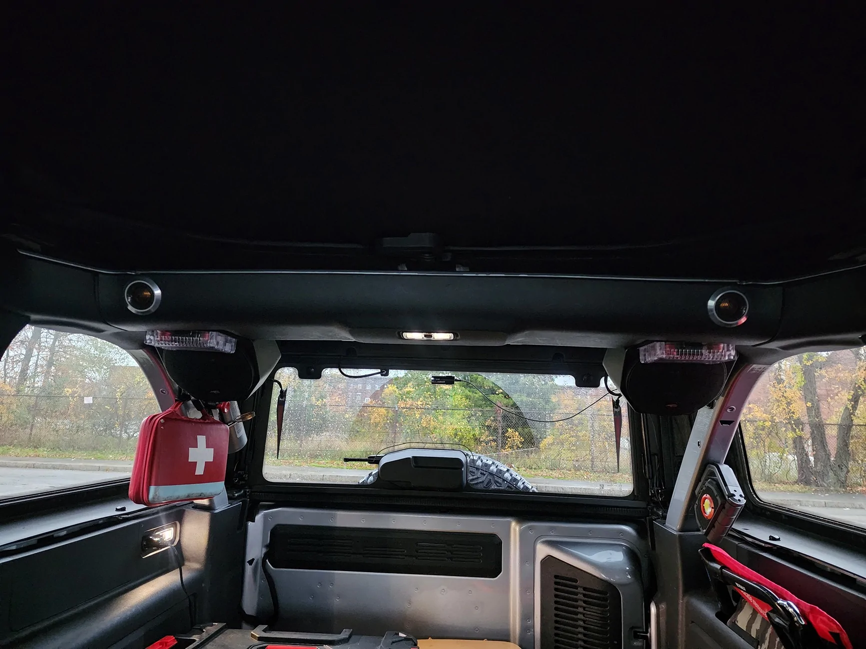

Complete! I mounted the crossovers on the outside of the plastic trim since there turned out to not be enough room behind it. I can now also easily fiddle about, fiddle about with the switches/settings on the crossovers, if the tweeters are too loud. I mounted the tweeters on the front of the large plastic piece (see: option 1) since they sound pretty good there especially in surround mode. We'll see how they sound once I get the amp installed though.
Needless to say it was nerve-wracking to cut 1⅞" holes in my Bronco. 😂
Ford Bronco Audio System Upgrade Log - The WildeBeast 1000024313
Ford Bronco Audio System Upgrade Log - The WildeBeast 1000024315

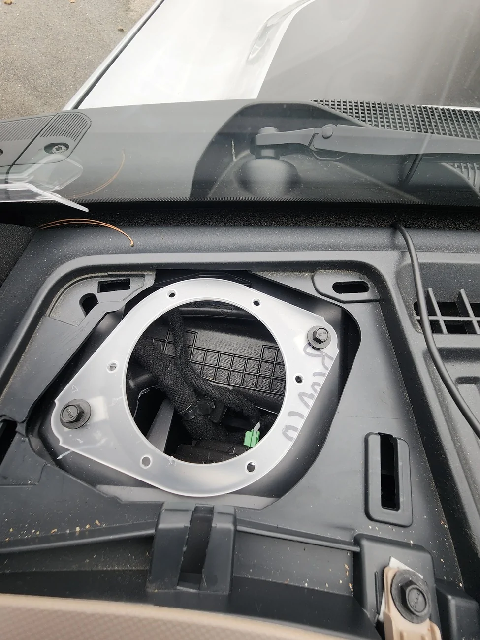

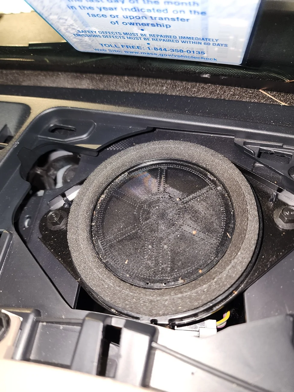

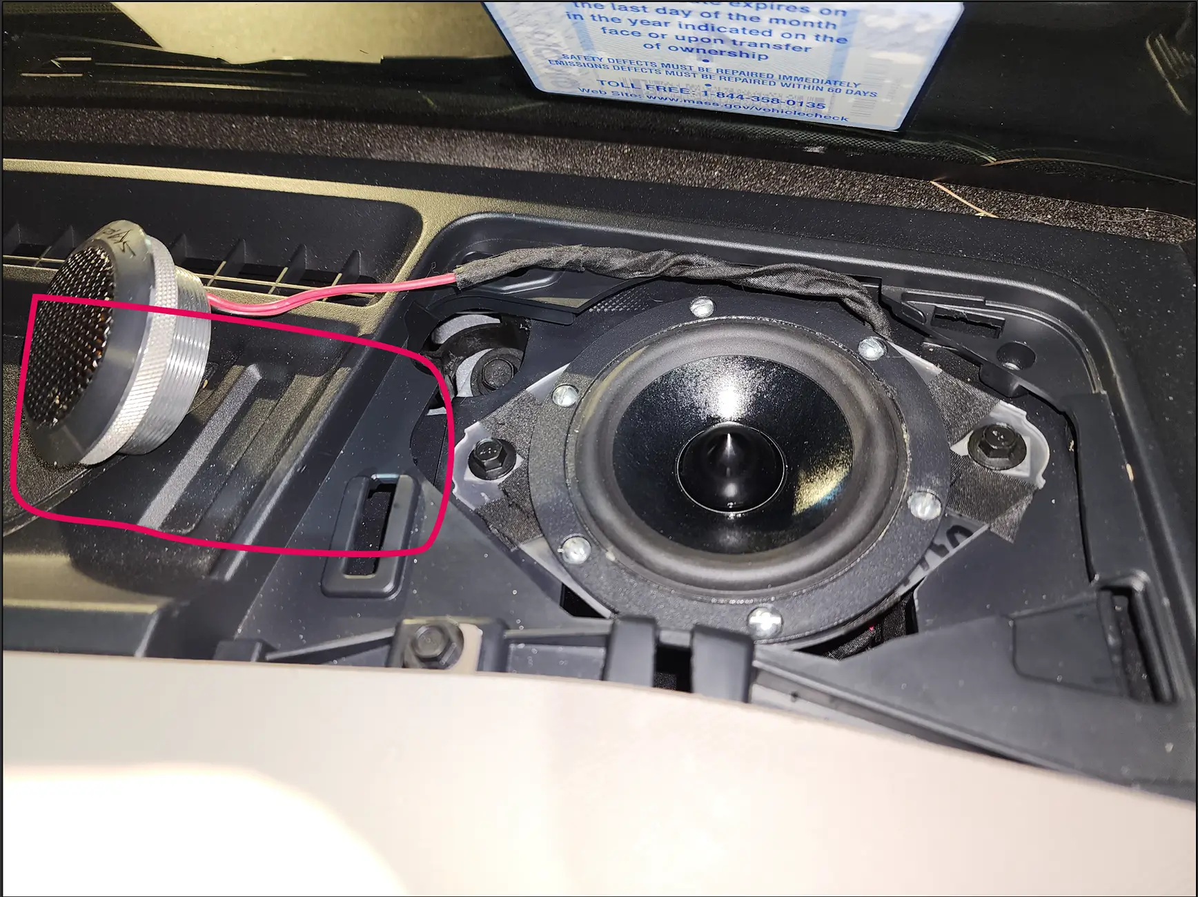

Since my job involves measuring customer chassis and creating vector files to create labels that fit on recessed parts of tools and things, I put my knowledge to use with the front dash speakers. I've attached a template I just made, using calipers to measure the factory speaker and Adobe Illustrator, that includes the shape and screw hole locations of the factory dash tweeters of the 2022 B&O system (not sure if it's the same for the 6 speaker system). I'm going to CNC route that template out with the right size hole for my 4" dash speakers that I got (Also attached). I couldn't find any templates that were just a flat cutout path, so I made my own! Feel free to use it and distribute as you please.

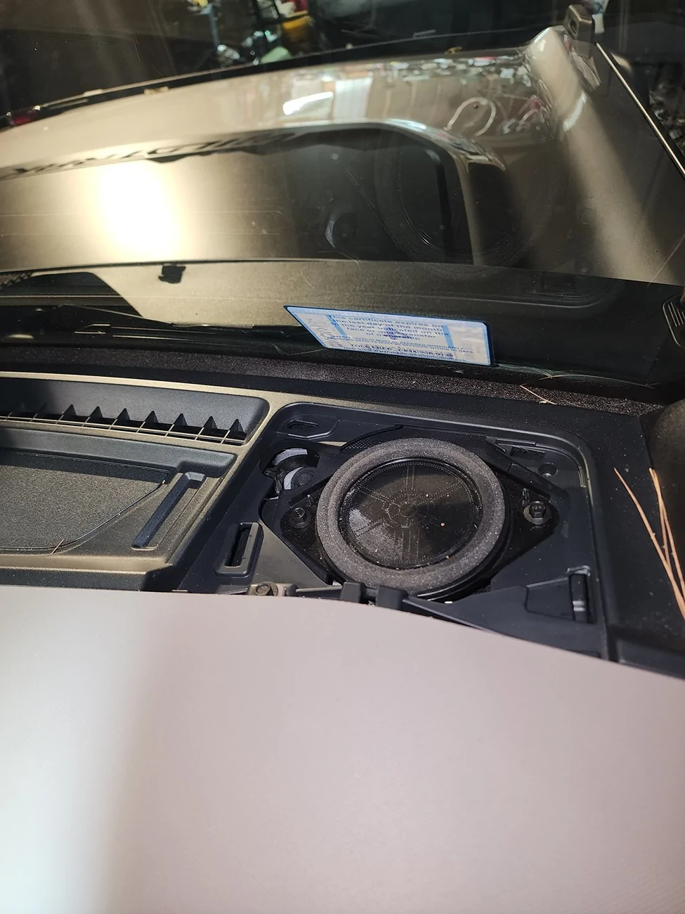

Before images of the dash speaker:
Ford Bronco Audio System Upgrade Log - The WildeBeast 20251104_201700
Ford Bronco Audio System Upgrade Log - The WildeBeast 20251104_201656

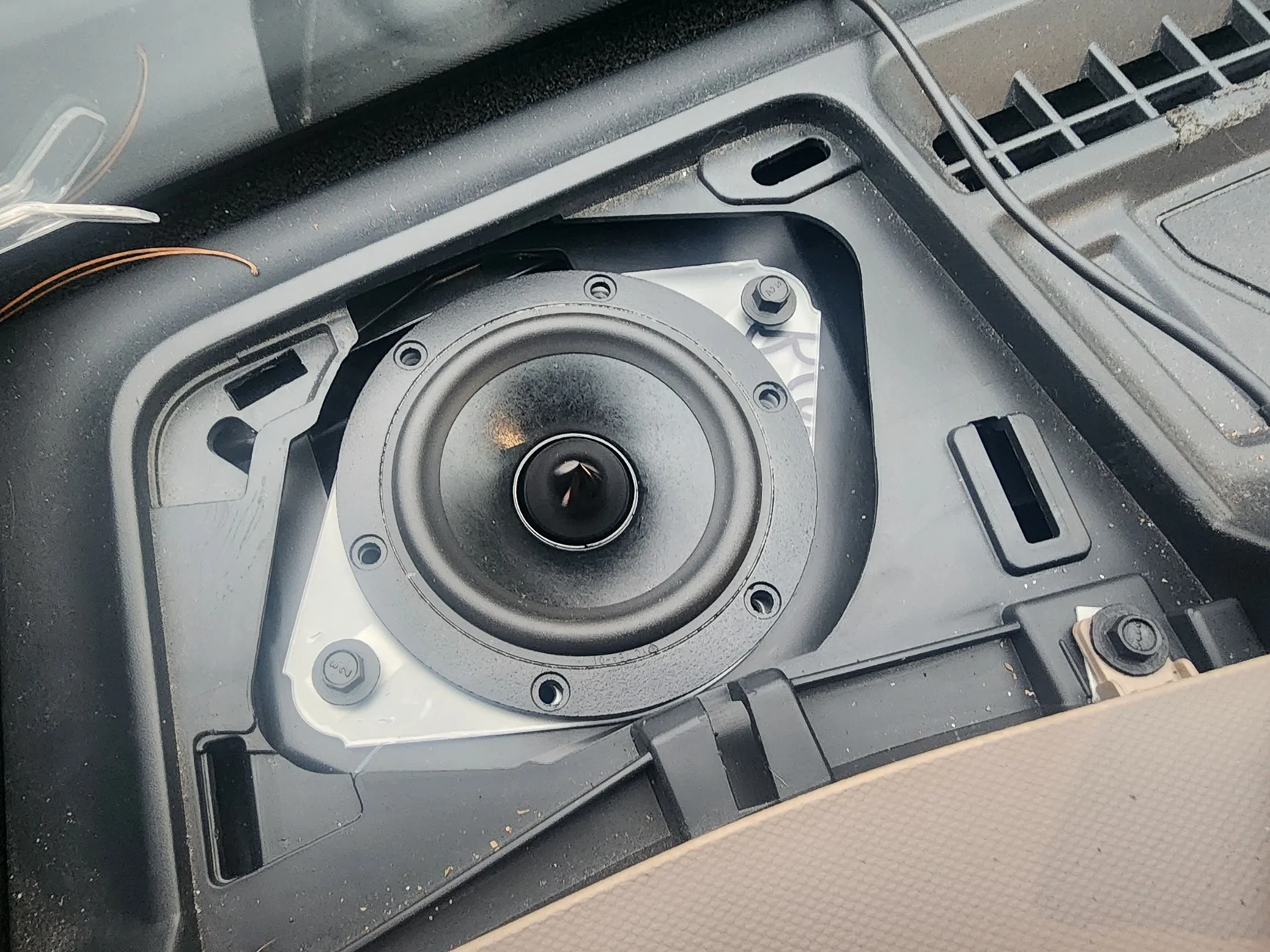

Here's my bracket with no speaker:
Ford Bronco Audio System Upgrade Log - The WildeBeast 20251030_111408

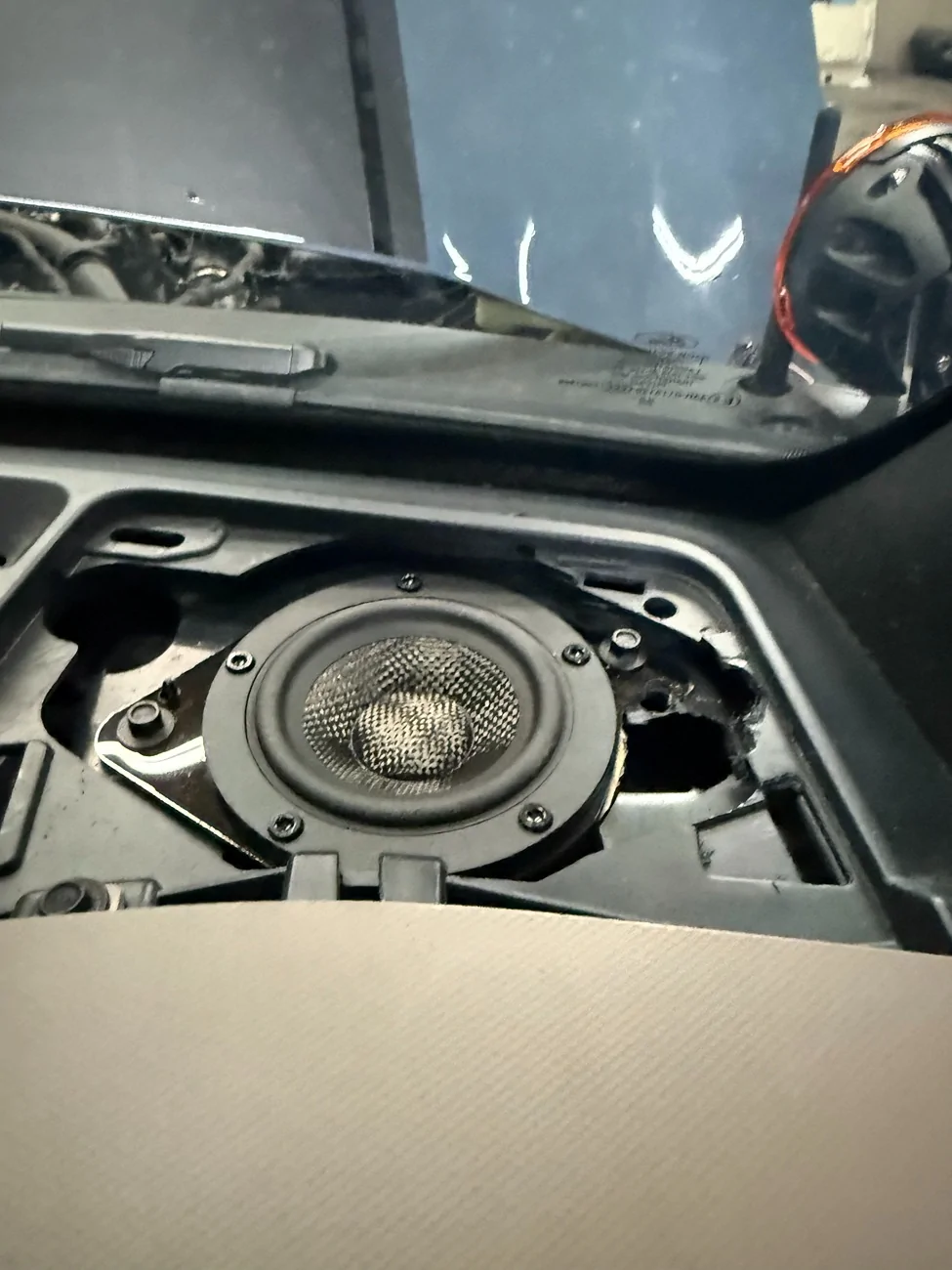

Here's the fit of it cut out with the speaker sitting in the plastic (dry-fit without bolts). I CNC cut the templates out of .030" 8010 polycarbonate. If I find that they're too flimsy, I'll route it out of .060" polycarb. (Using polycarb because it's readily available at work lol)
Ford Bronco Audio System Upgrade Log - The WildeBeast 1000024318

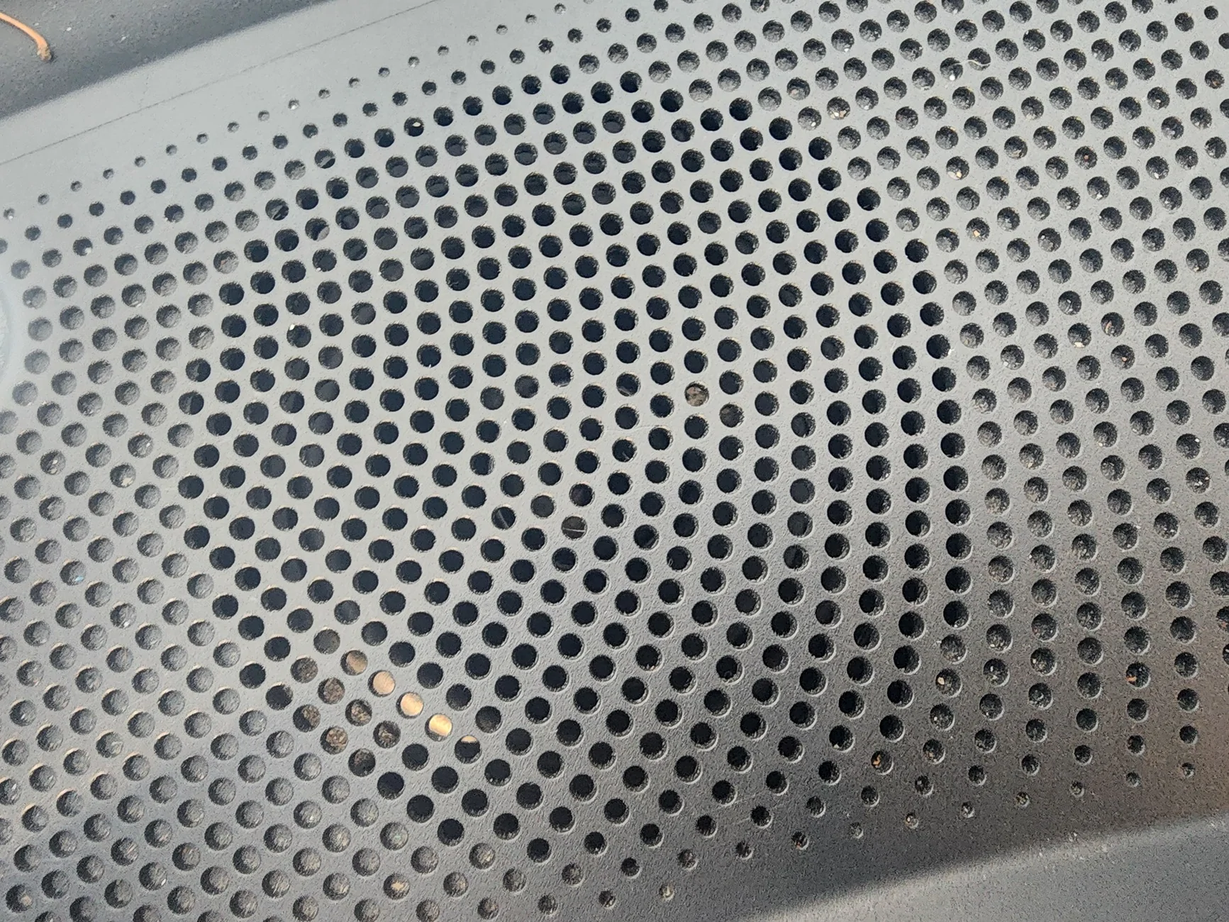

Hard to see, but it is indeed perfectly centered with the circle in the grille! And best part is, no trimming required of the bronco other than snapping off the two little alignment tabs where the screw holes are. Just a drop-in speaker replacement now. Aside from the wiring of course.
Ford Bronco Audio System Upgrade Log - The WildeBeast 1000024317

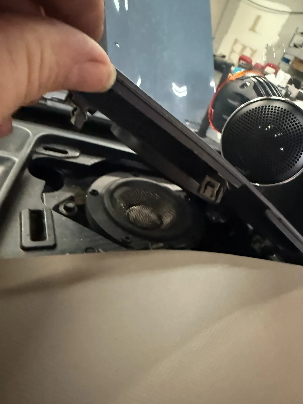

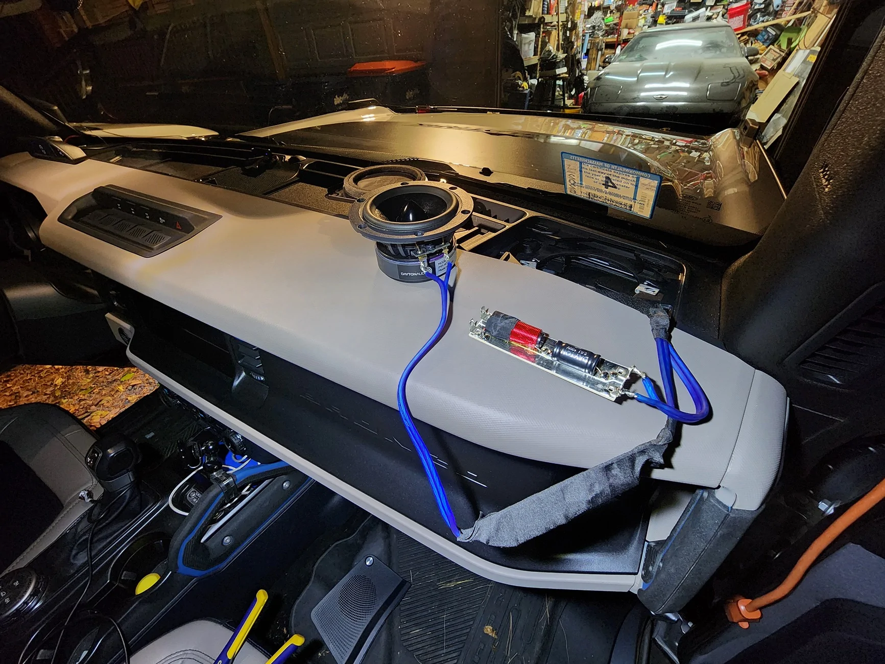

Next up is the wiring of the dash speakers. I used the existing bronco wiring for the dash and kick panel speakers, which I was able to tap into using the PAC audio splitter. I did not end up needing to use the T-harness under the radio up front; only had to use the harness in the rear where the subwoofer was. That means I retained the factory center channel, for whatever that's worth.
This is where the passive crossover filters come into play. They tucked nicely inside the dashboard after wiring them to the dash panel wires. There was plenty of room to tuck them away next to where the 4" speaker mounted.
Ford Bronco Audio System Upgrade Log - The WildeBeast 20251104_205759
The crossovers, being long and fairly thin, I wrapped in fabric tape and tucked into the dash in the circled area (mirrored on the driver's side the same way, just a little tighter with the instrument cluster)
Ford Bronco Audio System Upgrade Log - The WildeBeast Screenshot 2025-11-14 at 7.33.11 AM

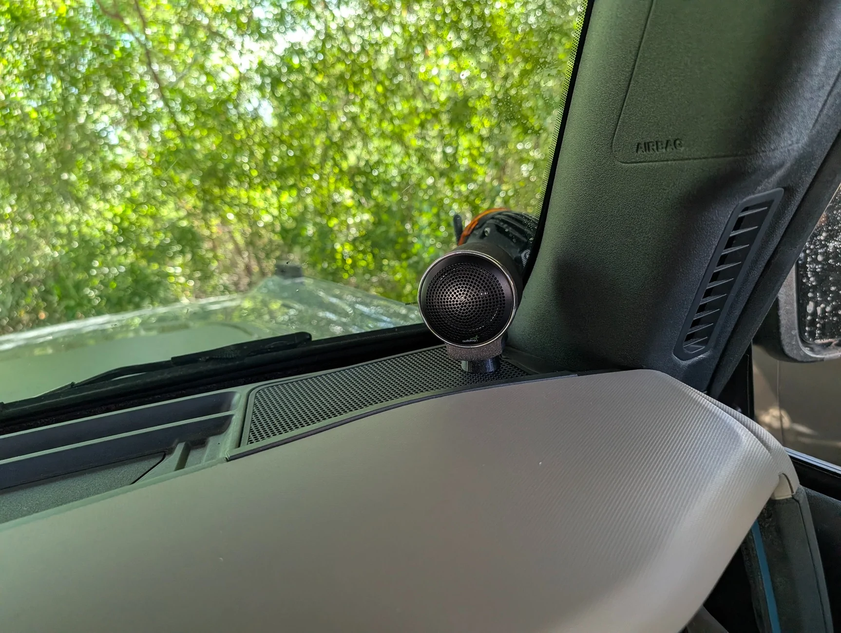

And here's the current look until I fabricate brackets for the tweeters. I just used some mounting tape to hold them in place till then.
Ford Bronco Audio System Upgrade Log - The WildeBeast 20251104_213649
The dash speakers sound GREAT. Fantastic decision going with the 4" midrange speaker in addition to the tweeter and kick panel midwoofers. Speaking of the kick panels...

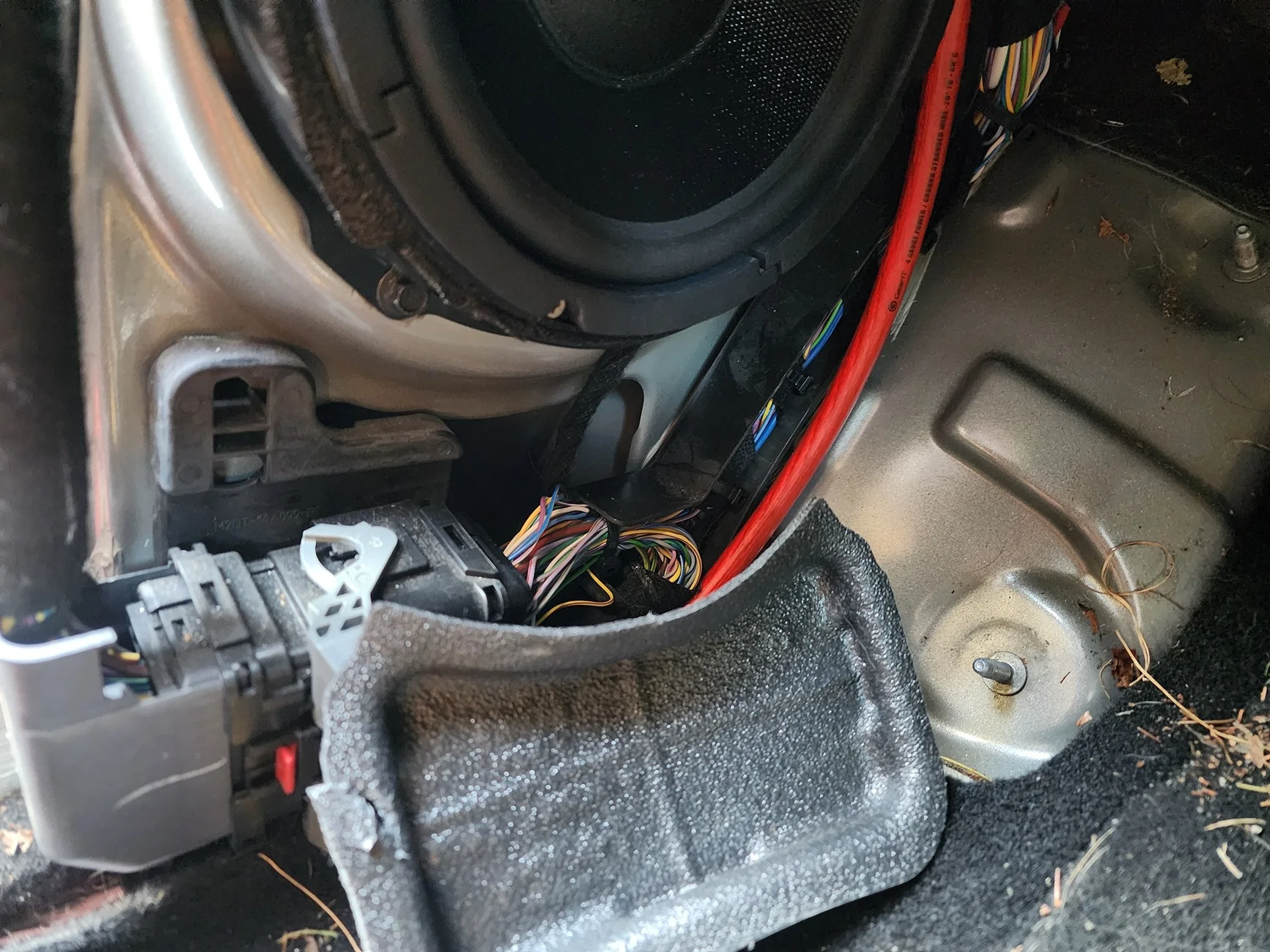

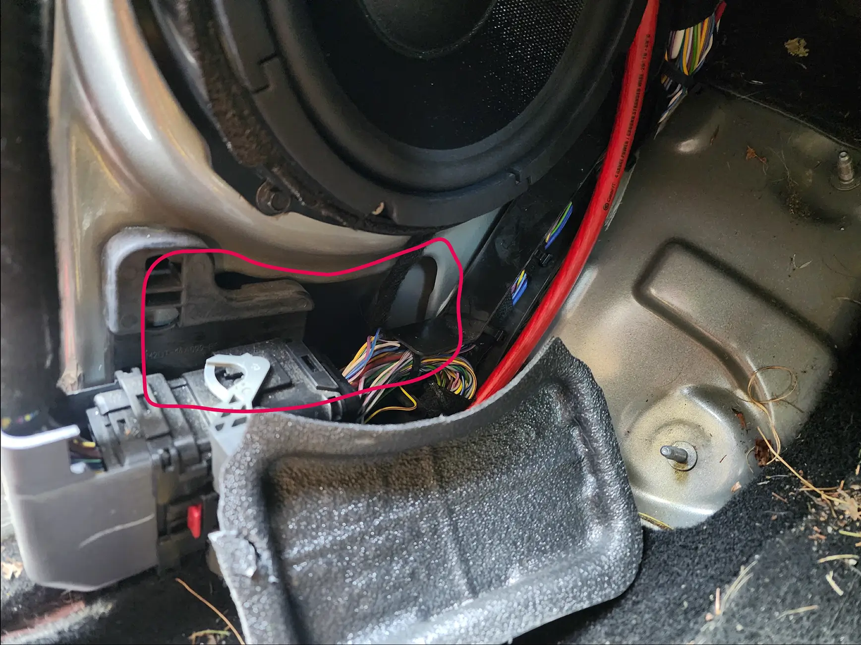

Here was my one issue with the kick panels. Installed them, immediately noticed what sounded like voice-coil separation (a vibrating, rattly noise at higher volumes). Thought "Oh great, time to buy new midwoofers. These must've been damaged while I stored them in my bedroom." Bought new ones (went with Dayton Audio DC160-4 6-1/2" Classic Woofer Speaker) and installed them... Same issue, same exact sound! So I started doing what I should have done in the first place, touching things in the area to see what's vibrating. Lo and behold, these speakers sit in a somewhat sealed metal pocket of the body, and at the bottom of the pocket, there's an access hole of sorts, plugged with a foam piece. That foam piece was vibrating like crazy due to the wind from the speakers on both sides. See photo for what I'm talking about. Red shape represents where the black foam piece was sitting, no adhesive holding it in place or anything.
Ford Bronco Audio System Upgrade Log - The WildeBeast Screenshot 2025-11-14 at 7.51.22 AM

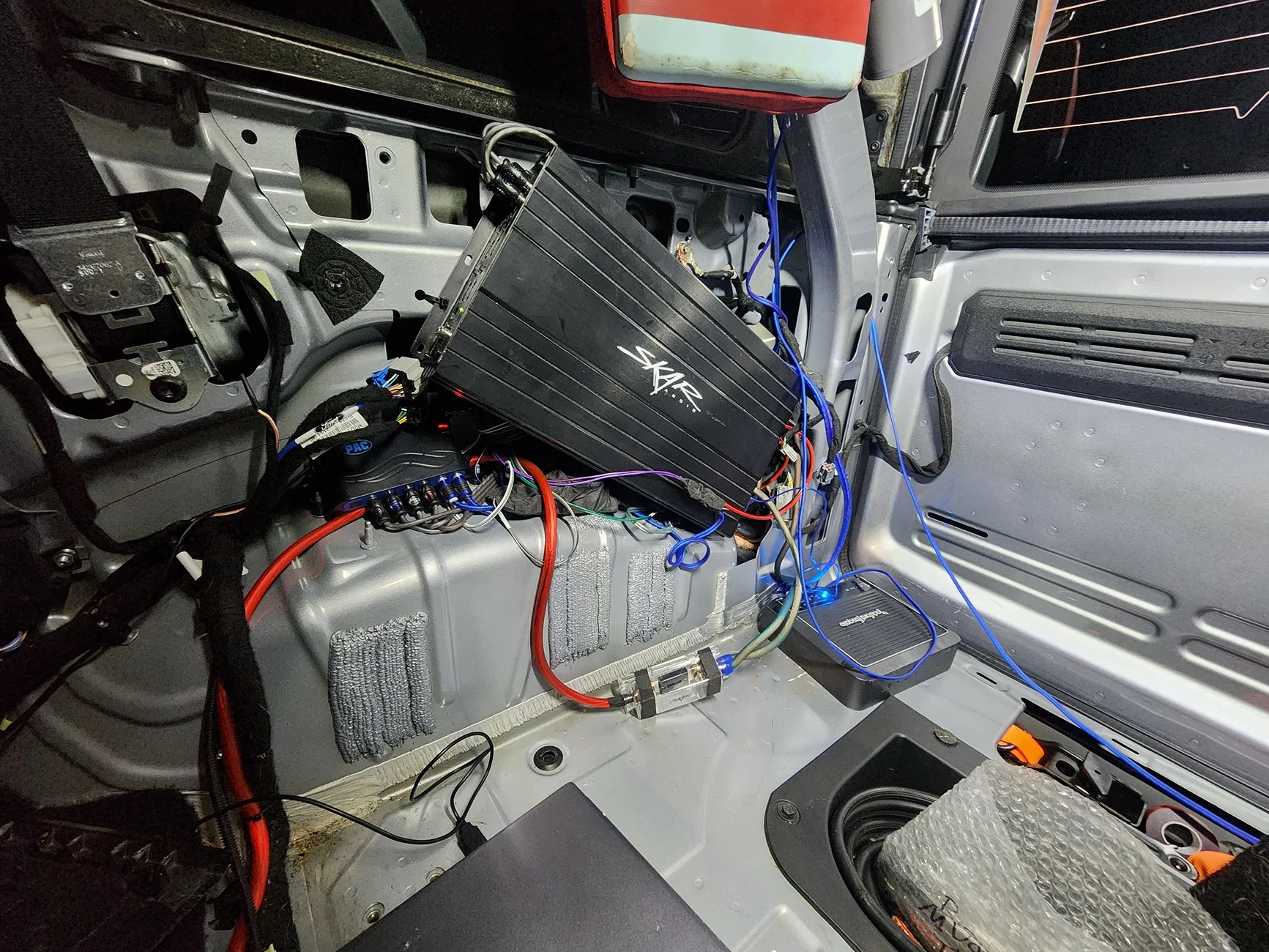

Installing the amplifier wasn't bad at all. I ran a 4-gauge positive wire from the battery, through the driver's side firewall (the small grommet with the big ears on it - will add pics soon), through the wire tunnel along the driver's side door sills to the point where the back of the rear seats transition to the cargo area, and crossed to the passenger side of the cargo area from there. I bolted the positive wire to my 100-amp fuse in the cargo area, where I forked it apart into two positive 4-gauge connections on the "exit" side of the fuse. I won't be coming close to maxing out these two amps by any means, so this method is completely safe for my use case. Kinda jerry-rigged but so far I've had no issues and the wire isn't warm to the touch at all after extensive listening at full volume for hours.
Here's the rough positioning of the amplifiers. The skar amp for the 4 channels is the big one that's diagonal, and the the Rockford sub amp is now positioned inside the wheel well body panel area (not depicted in this photo). I just zip tied everything to whatever I was able to, no crazy mounting plates or anything because I didn't have room. In fact, I did indeed need to trim the trim panel to get it to fit over the top-left corner of the amp, unfortunately. But clearly I'm kinda going for function over form with this build lol. You can also see what I'm talking about with the fuse below the amp in the photo.
Ford Bronco Audio System Upgrade Log - The WildeBeast 20251104_205656
For the rear channel speakers, I just ran blue speaker wire up the roll bar to the speakers. I considered running it through the D-pillar instead of along the outside of it, but honestly, I kinda like having a little visible wiring going on... Shows that it's custom a bit more I guess. Same way how in Cyberpunk 2077 in all the vehicles there's exposed wire channels and such lol.

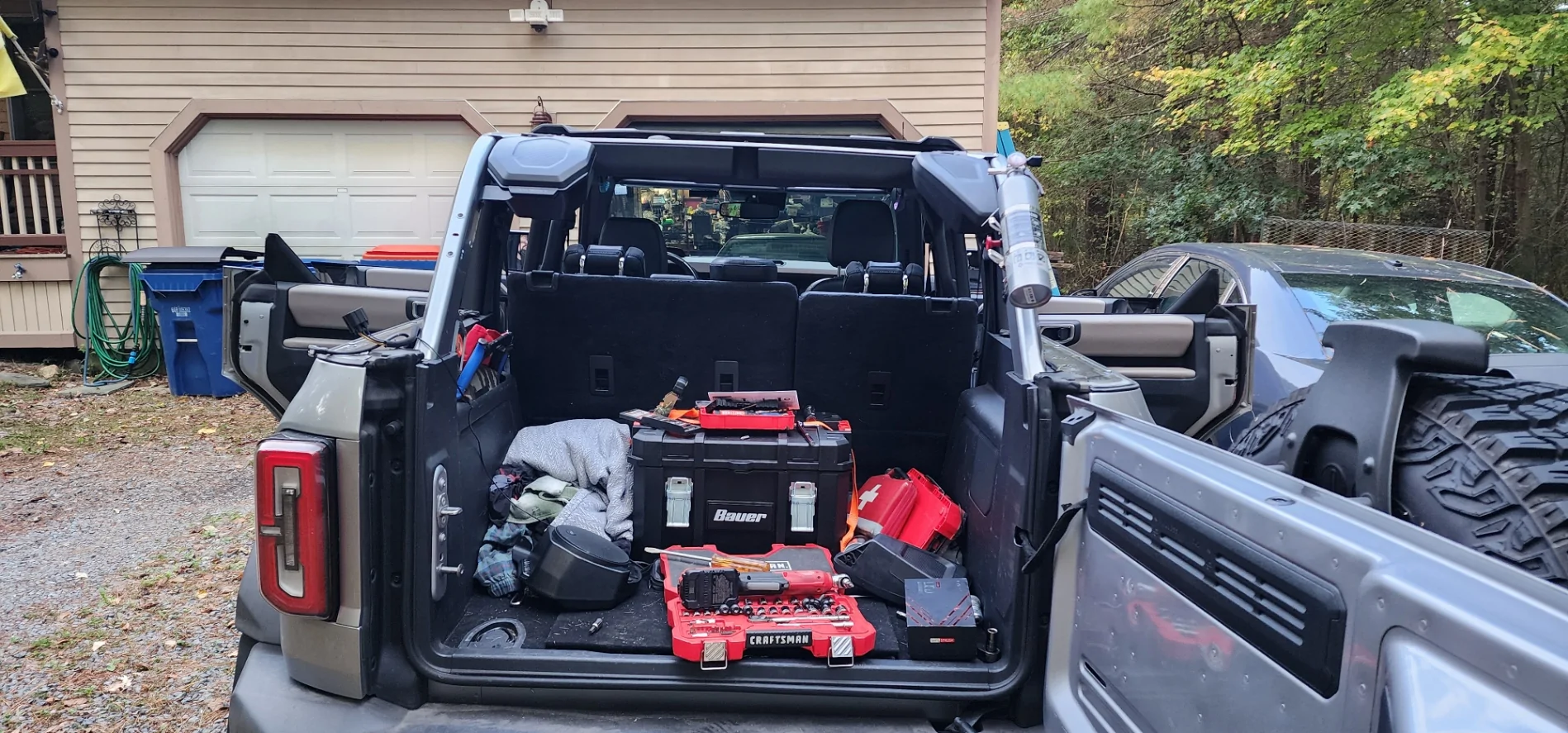

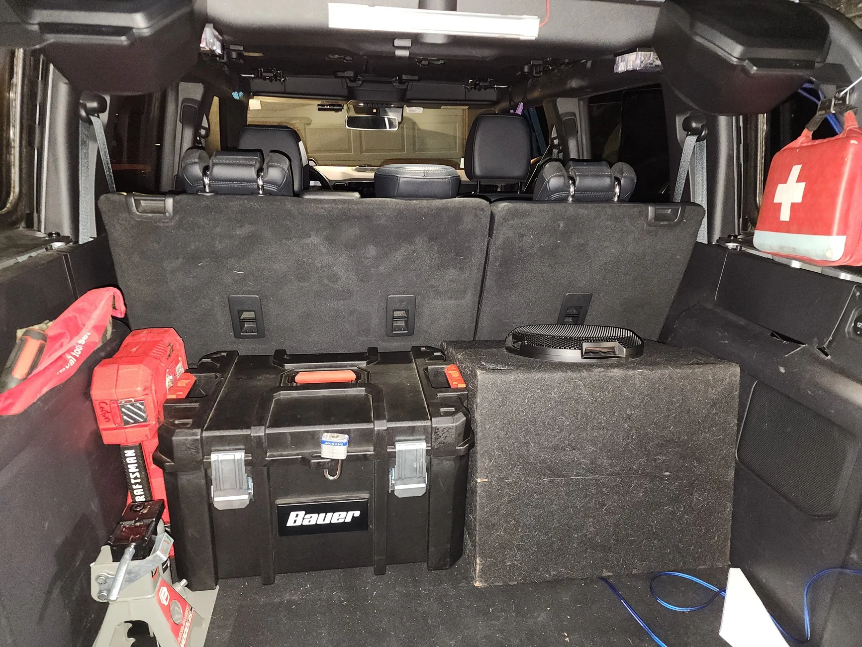

Finally, here is what the sub box looks like in the back next to my toolboxes! It nestles in perfectly between my Braun toolbox and my craftsman ⅜" socket case. I have the wire loosely in the cargo area in case I need to move things around. Also, here you can see the slight trimming I had to do to the quarter trim panel. It's a bit of a hack job but I got it to fit without cutting any metal, at least! Clearly, I'm not worried about resale value 🤣
Ford Bronco Audio System Upgrade Log - The WildeBeast 1000024360
And holy moly, all it took after all that was just tuning.
For all the naysayers about the rear tweeters... The cabin sound is much more full and immersive with them installed. I tried unhooking them to see the difference and the stereo image is actually worse without them. It sounds like everything's coming from the front. With them, it sounds like guitars and background vocals come from behind a bit, while vocals are clear and crisp up front from the tweeters and 4" midranges. This is a hell of a setup now and I can finally say that I'm more than happy with it! Listening to Big Bad John literally rumbles my chest.
Thanks for reading along on this journey with me!! Will update with the front tweeter brackets I make soon!
Ford Bronco Audio System Upgrade Log - The WildeBeast 20251112_151420

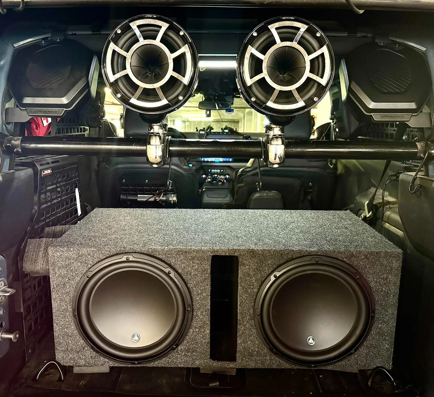

More important question is Why. Tweeters are very directional. You will be drawing attention to the rear stage which is the opposite of SQ install. If max volume is the plan for top down blasting sound, then maybe buy a plastic tweeter pod and attach next to the 6.5 pod? I’d personally just leave them off.
A 3 way setup at the front will give you the best performance if you only have 2 amp channels available. A few people make a 6.5 + 3 + tweet with a passive crossover that would still be 4 ohms. That’s what would do in your situation since you already have so much hardware.

My amp has 4 channels, so the front channel will be stronger than the rear. If the tweeters in the rear are too powerful, the crossovers have a 0db, -6db and -12db switch so I can dim the volume of the tweeters to match. I'm gonna temporarily attach the tweeters to the rear until the amp is fully installed before I go drilling holes anywhere - this way I can see with the amp hooked up if the tweeters are too overpowering or throw off the sound stage like you were describing. I kinda like the idea of attaching them to the rear pods, though. I'm sure I could easily 3d print a grille with a mount for them that way they're centered just like how a coaxial speaker has a tweeter in the center. Maybe that'll be my first "permanent" option before drilling holes haha. Definitely don't want to drill holes in panels only to find out that it wasn't a good result!
I really appreciate all your input about the 3-way channel at the front too - after doing some research while writing and re-writing and re-re-rewriting this comment lmao, I'm quickly talking myself into adding some 3" mid-tweeters. I'd need to add in a band-pass filter in place of my current crossovers, with a high-pass filter around 500 Hz and a low-pass filter around 3,500 Hz. Or maybe this band pass filter would do, 800 Hz to 5,000 Hz: https://www.parts-express.com/800-5-kHz-Band-Pass-4-Ohm-Crossover-266-452?quantity=1 Then the midwoofer would handle 500 and below, and the tweeter would handle 3,500+. I'm sure that would isolate vocals a bit more and keep vocals from being distorted at higher volumes.
If you have any input on the frequency split though definitely lmk, would be curious to hear your input on that if you have any! Always excited to learn about stuff like this.
Thanks again for the input - my course of action may be changing a bit (for the better) thanks to you lol!

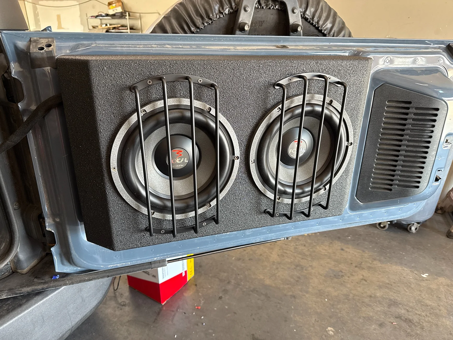

I used 2 Focal 11"s in a tailgate box and they're enough to vibrate anything you want. I didn't like the shallow subs.
I'm going to post up my build soon - GB15's in 3d printed fully adjustable pods, SI Carbon 3"s in dash, SI TM6IV's in kicks, GS62 rear pods, mobridge & alpine amps.
In hindsight, the GB10's would have done just as well and been easier to fit.

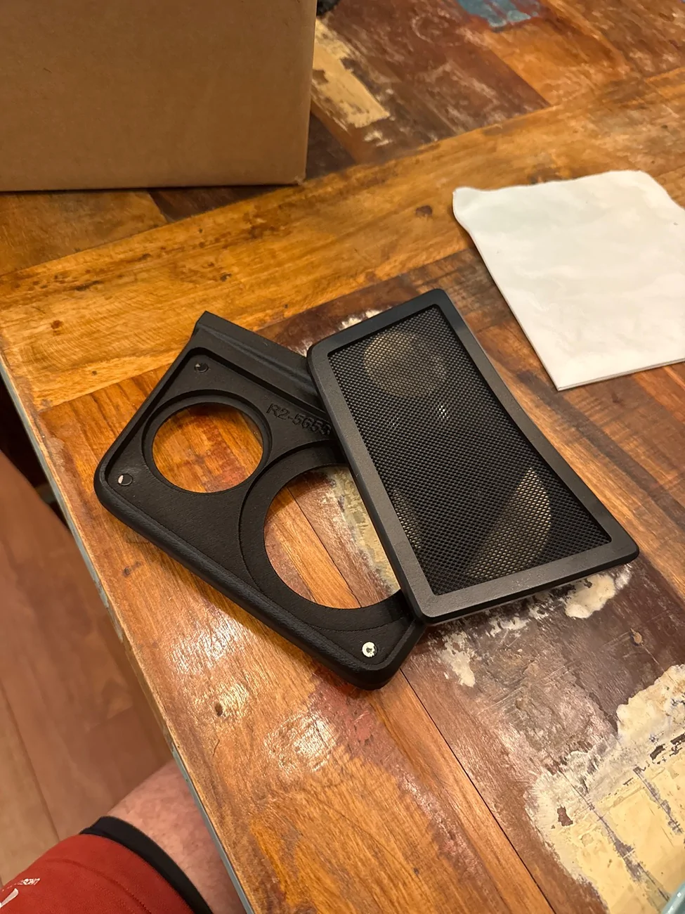

It's looking like I'm gonna do something similar with the 4" midrange speakers I'm putting in the dash. Gonna have to make my own bracket for them. Did you get a template for the dash speakers somewhere or did you buy custom brackets? If I could get a template for the dash adapter with at least just the screw holes on it to mount to the dash, then I could design the holes I need to route on my CNC cutter for the speakers I'm using. Just need a PDF or dimensions or somethign to go by lol. Super nice setuip you've got, I like the adjustable tweeter mounts too.
I spent the money for the MTI dash plates because I was already buying their rear pods because they’re the only ones that make rear pods that fit a raptor and when I called them with fit questions around the dash plates and questions they gave me a pretty good deal on all of it if I bought it all together. And I live in an urban area where if I mounted tweeters to the dash and pods somebody would break in just to steal them unfortunately. They are not cheap, but they will make them specifically for whatever components that you’re going to go with, in my case the focal flax Evo and you just have to wait a little bit for them to print them.
Whose tailgate box is this? I bought the trail seven box and the only subs that would fit in there were Alpine S or Hertz, which I didn’t really like the sound of either. And since I was doing a full focal build, I thought that my guy and I looked at the folk house subs and they wouldn’t have fit in the box I bought.
