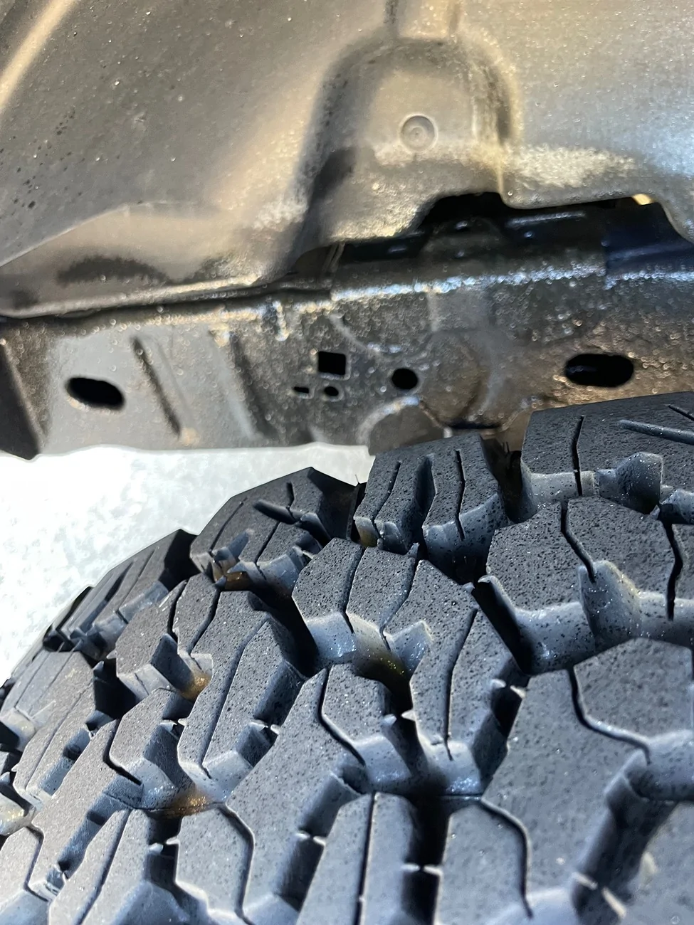

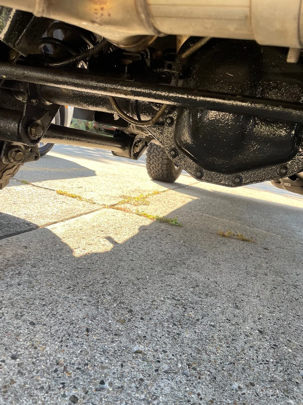

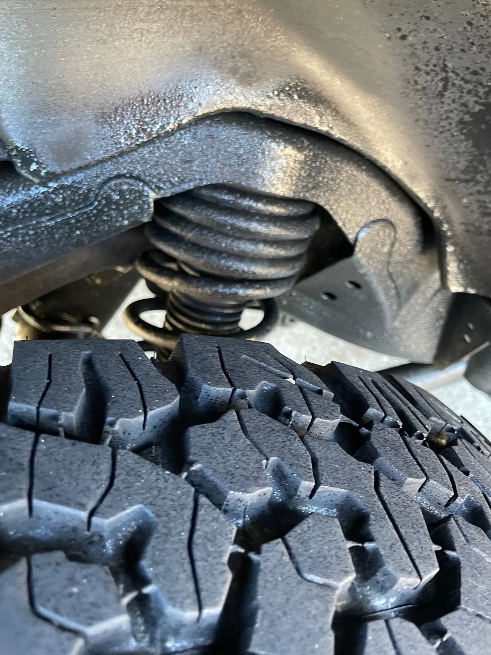

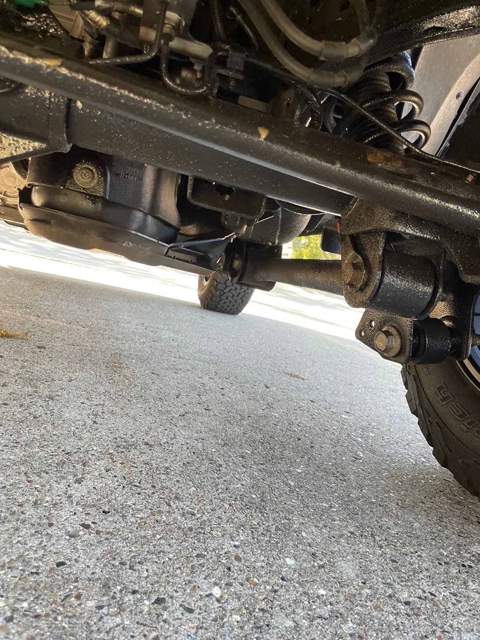

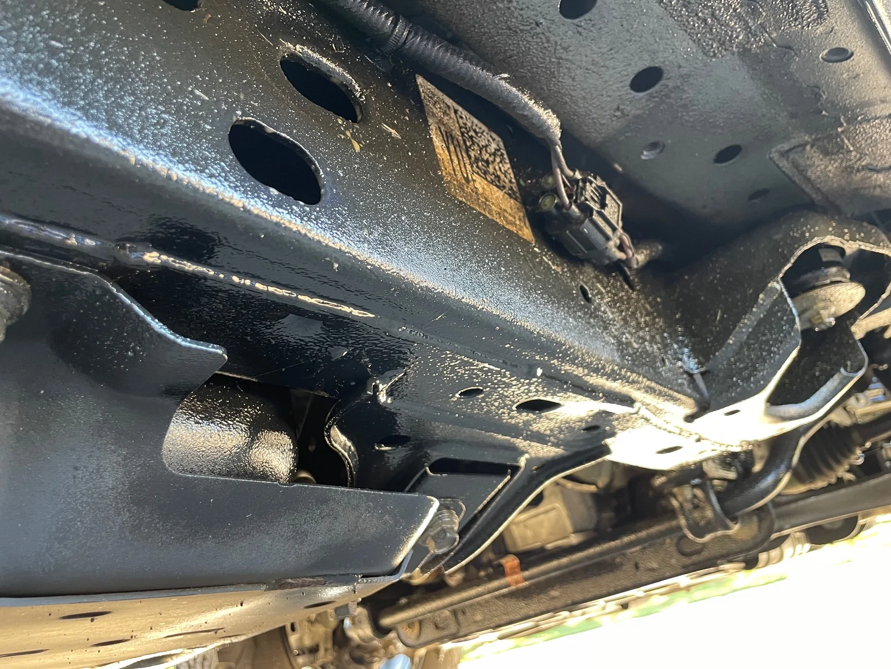

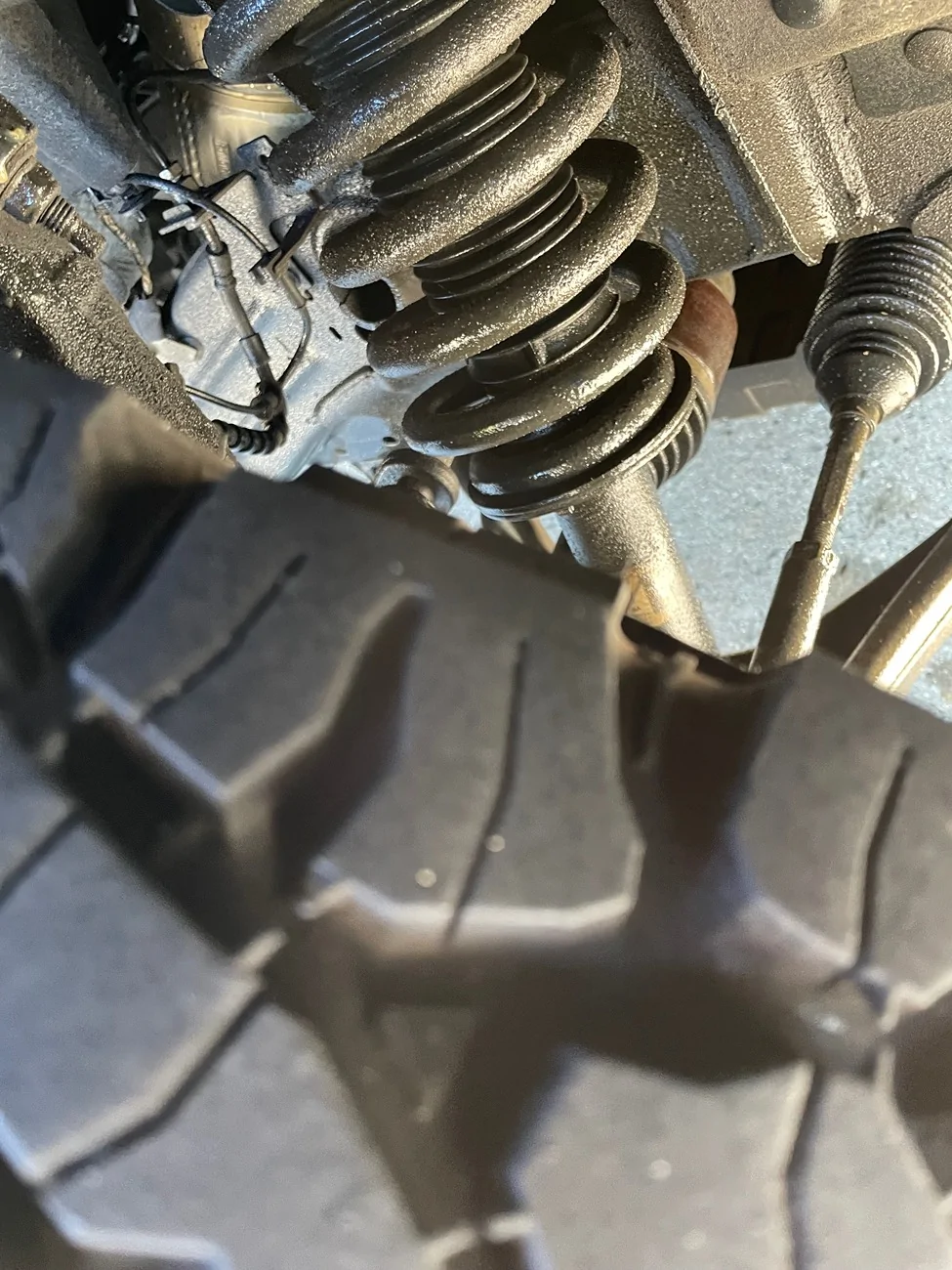

2nd year coating the frame with Blaster Shield on the outside and Fluid Film on the inside. Seems to work very well so far. Ahhh, the joys of living in the rust belt.
Ford Bronco Ready for salty winter w/ Blaster Shield + Fluid Film anti rust protection spray IMG_0574
Ford Bronco Ready for salty winter w/ Blaster Shield + Fluid Film anti rust protection spray IMG_0569
Ford Bronco Ready for salty winter w/ Blaster Shield + Fluid Film anti rust protection spray IMG_0570
Ford Bronco Ready for salty winter w/ Blaster Shield + Fluid Film anti rust protection spray IMG_0573
Ford Bronco Ready for salty winter w/ Blaster Shield + Fluid Film anti rust protection spray IMG_0571
Ford Bronco Ready for salty winter w/ Blaster Shield + Fluid Film anti rust protection spray IMG_0572

What was the application like? Do you just spray everything underneath the vehicle?
Pretty much, but I try to stay away from the rubber portions of the brake lines. It shouldn't hurt them but I try to stay away just cause it's not necessary for the to be coated.

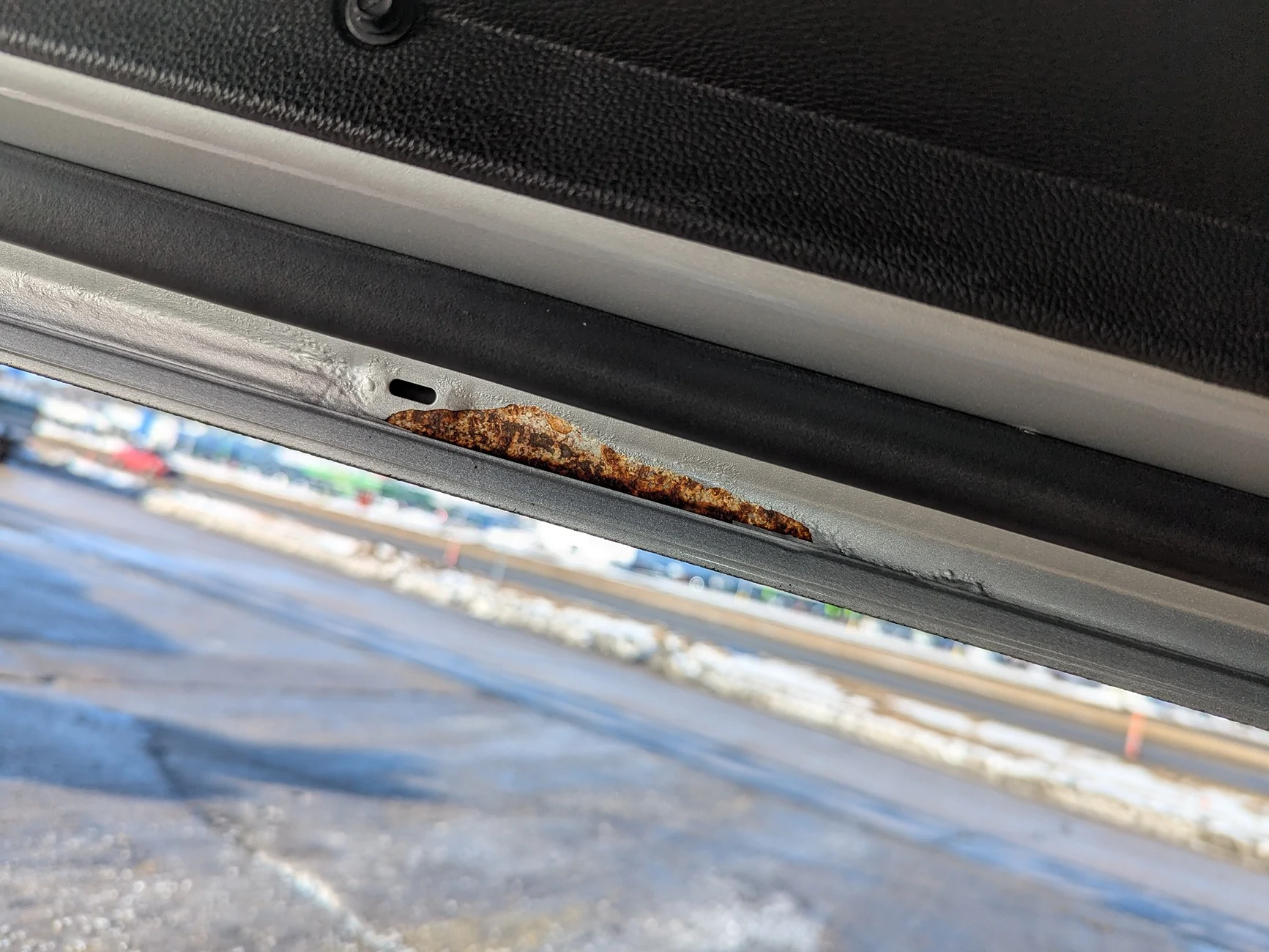

Nice...thinking of something like this for my ride. These road treatment/chemicals are brutal...my driveway's pitting @ street-end & former 2018 Colorado lost paint on DD bottom - even when I religiously ran through washes year-round, and always wiped door edges.
