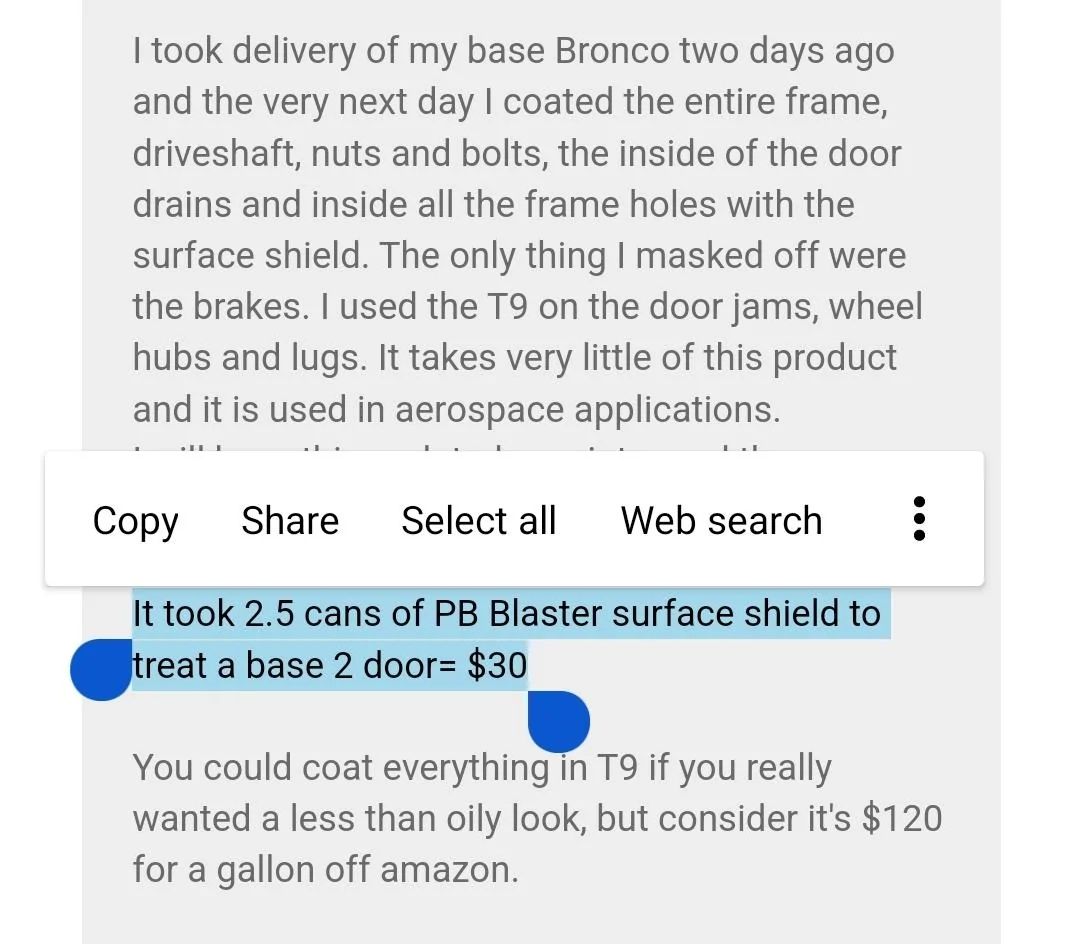

It took 2.5 cans of PB Blaster surface shield to treat a base 2 door= $30

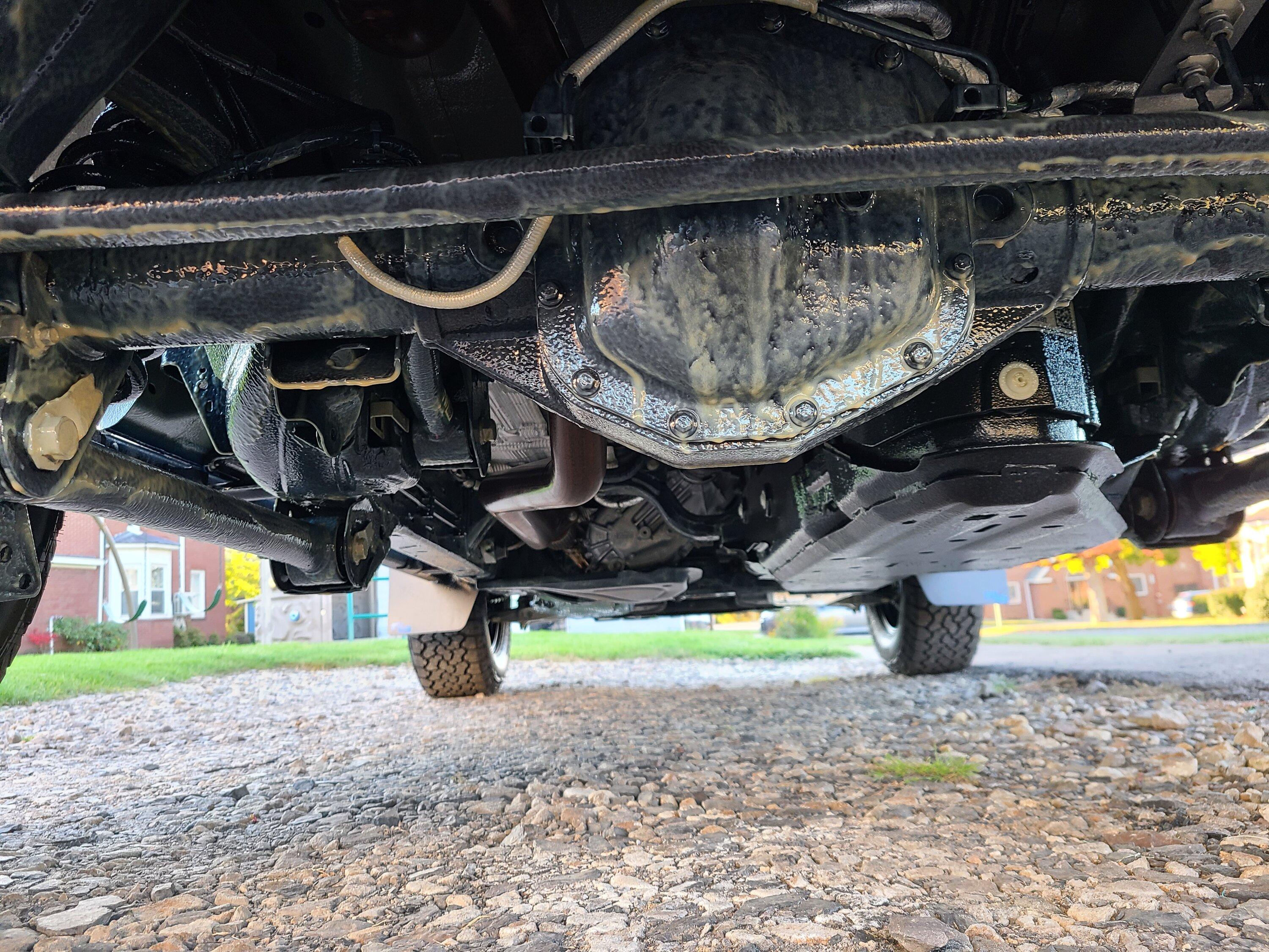

Any lanolin based rustproofing works great. This pic is from when i initially had it spayed. Now you couldn't even tell mine was sprayed unless you crawled underneath it. Fender wells look clear. Im glad i had mine sprayed with woolwax. Friday my bronco was white from salt here in PA. Por 15 stops rust but it doesn't prevent it especially when your state mixes shale with salt to treat the roads in winter. The po15 eventually gets chipped off and that area rusts. Its a good product though. The best part about these lanolin based sprays are if you ever wanna remove them they will come off with a pressure washer leaving a like new surface underneath.

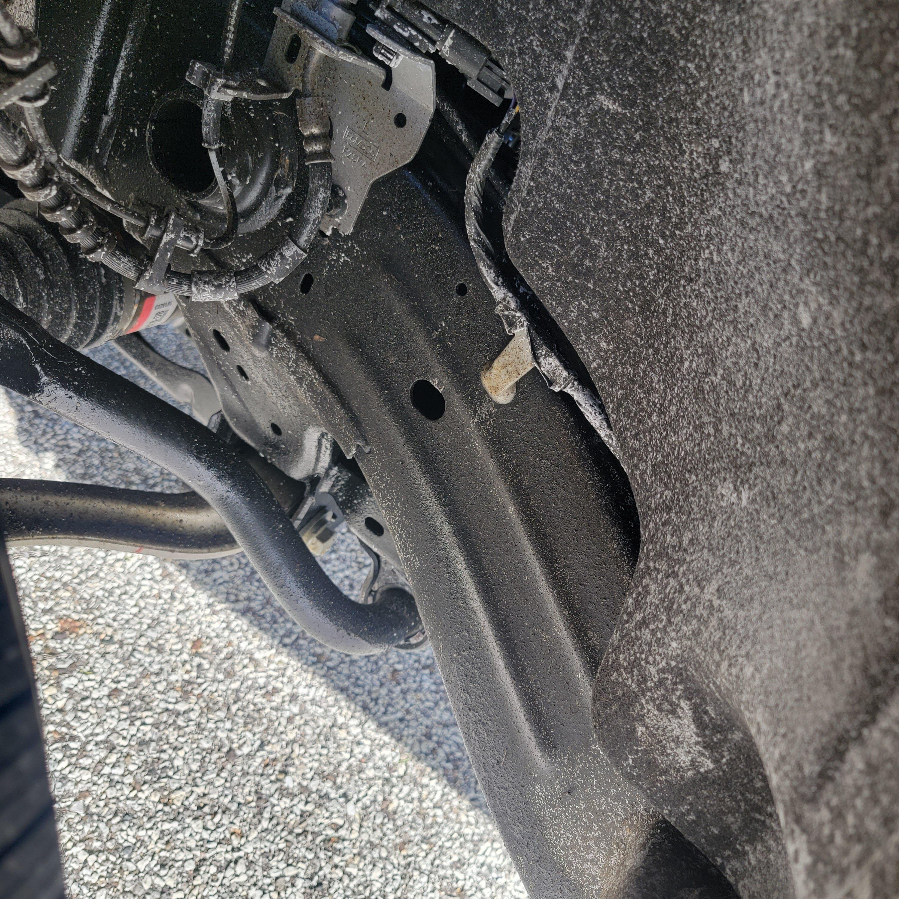

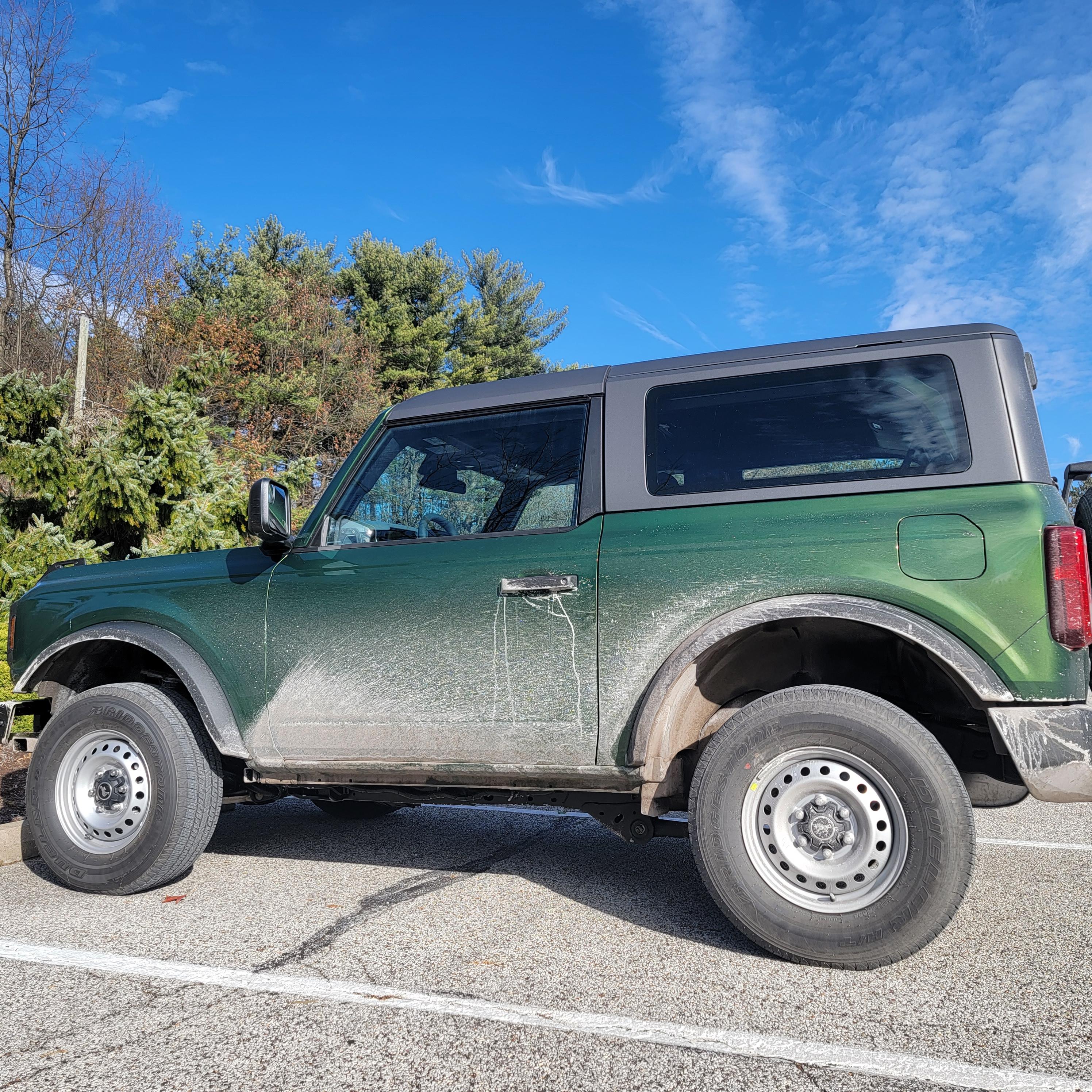

First week of ownership and first snow\salt\steel mill muck exposure. You can see how everything has stuck to the spray as intended, when winter is through I will do a thorough cleaning with pictures and then re-apply.
I also discovered these tires are way worse than I intitially expected in light snow so I am replacing them this week with either 265/75r16 or 285/75r16 Geolandar G015'S. Had Cooper Discoverer ATIII's on my Ram 1500 that were great in the rain but they sort of had a wandering feel on the highway, felt heavy and want to try the Yokohama's out.

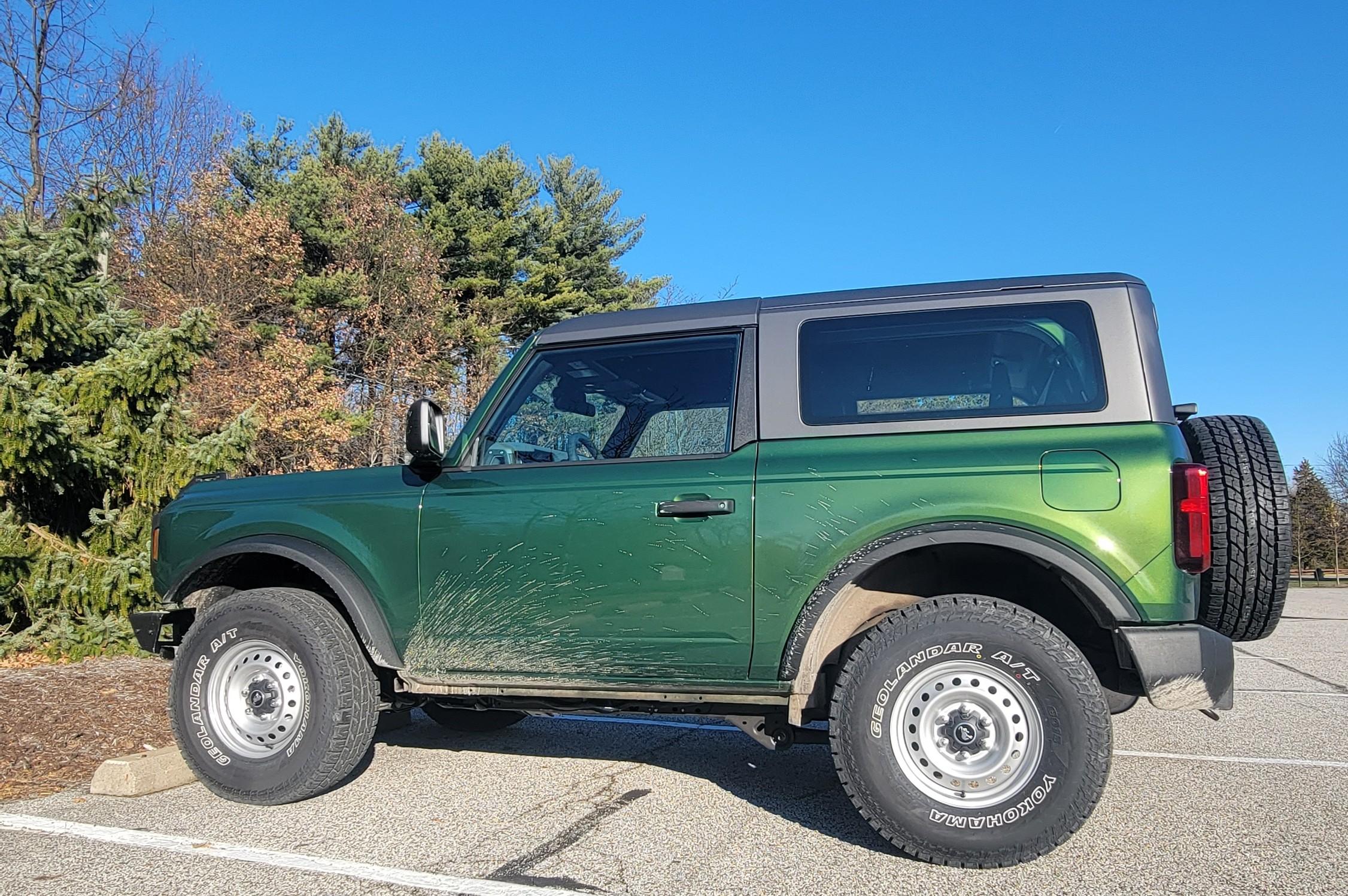

They are sprayed and this is what she looks like with new 33" Geolandar G015's. Right where you'd install a rock slider or step rails I also sprayed, which is why is looks so dirty all of the time. That will be covered with an aluminum one just for aesthetics.
