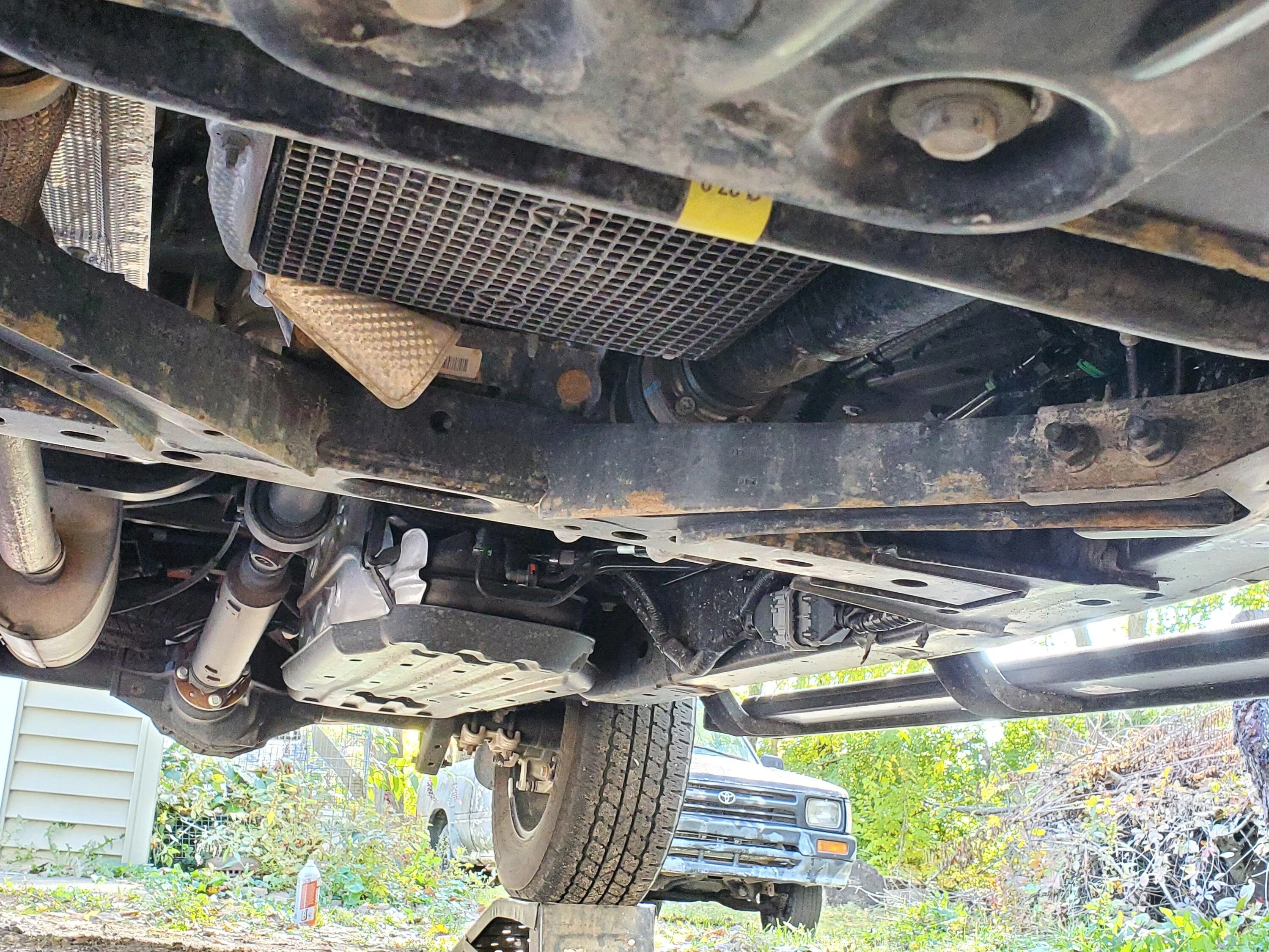

Wanted to show how I undercoated using PB Blaster's new surface shield product. This is comparable to fluid film and woolwax- it's lanolin base so it stays oily and does not dry and harden- does not crack off.
Previous career I used to electrostatic spray rust preventive on truck frames and I can tell you I personally shy away from such products due to cracking and peeling issues. Long story short, if you cannot get a specific mill spec on the coating it will break off so more is not better. You need a professional commercial setup and tools to do this job correctly.
I live in the rust belt and work in a steel mill- This is the ultimate way to destroy anything so this will be the test of all test.
I took delivery of my base Bronco two days ago and the very next day I coated the entire frame, driveshaft, nuts and bolts, the inside of the door drains and inside all the frame holes with the surface shield. The only thing I masked off were the brakes. I used the T9 on the door jams, wheel hubs and lugs. It takes very little of this product and it is used in aerospace applications.
I will keep this updated as winter and the years progress.
It took 2.5 cans of PB Blaster surface shield to treat a base 2 door= $30
You could coat everything in T9 if you really wanted a less than oily look, but consider it's $120 for a gallon off amazon.
Areosol cans are $20 but this can also be used to clean off everything so I'd be wary of getting it on certain connectors and sensors without properly masking them first and not having a spray booth. Overspray isn't much of an issue with the PB blaster just place a tarp underneath and it's easy cleanup and you're done.
Happy winter everyone.

Worth it. Did my wife's 2019 ranger for this upcoming winter after noticing how bad it was starting to get. Had enough cans do do the bronco as well. Want to get more thorough next time. I appreciate the heads up.

Oh, for context, the ranger is a 2019, and has less than 25,000 miles on it. It is mostly surface rust, but there is bubbling starting to form.

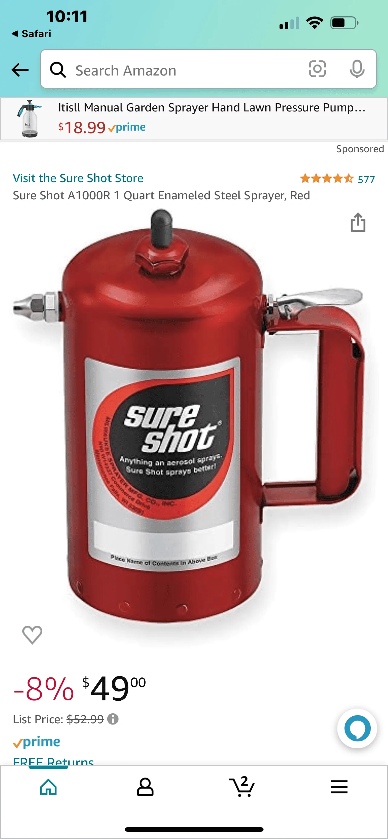

I have a sureshot pressure pot and Coat the bottom of my vehicles. Also works great with Armorall you wheel wells with too!

That looks pretty useful. I don't think you can get away from gravity feed, like I imagine the wool wax gun would be the same. Just watched a quick video on it. How often would you say you refill? I assume there are attachments, or at least you can make a fitting work for hose with 360 tip for deep inner frame spraying.
Not having to drag air hose through overspray on the ground would be nice... Also, the utility of different products going through the spray system would be useful. Weed killer, deck stain, liquid fertilizer...
