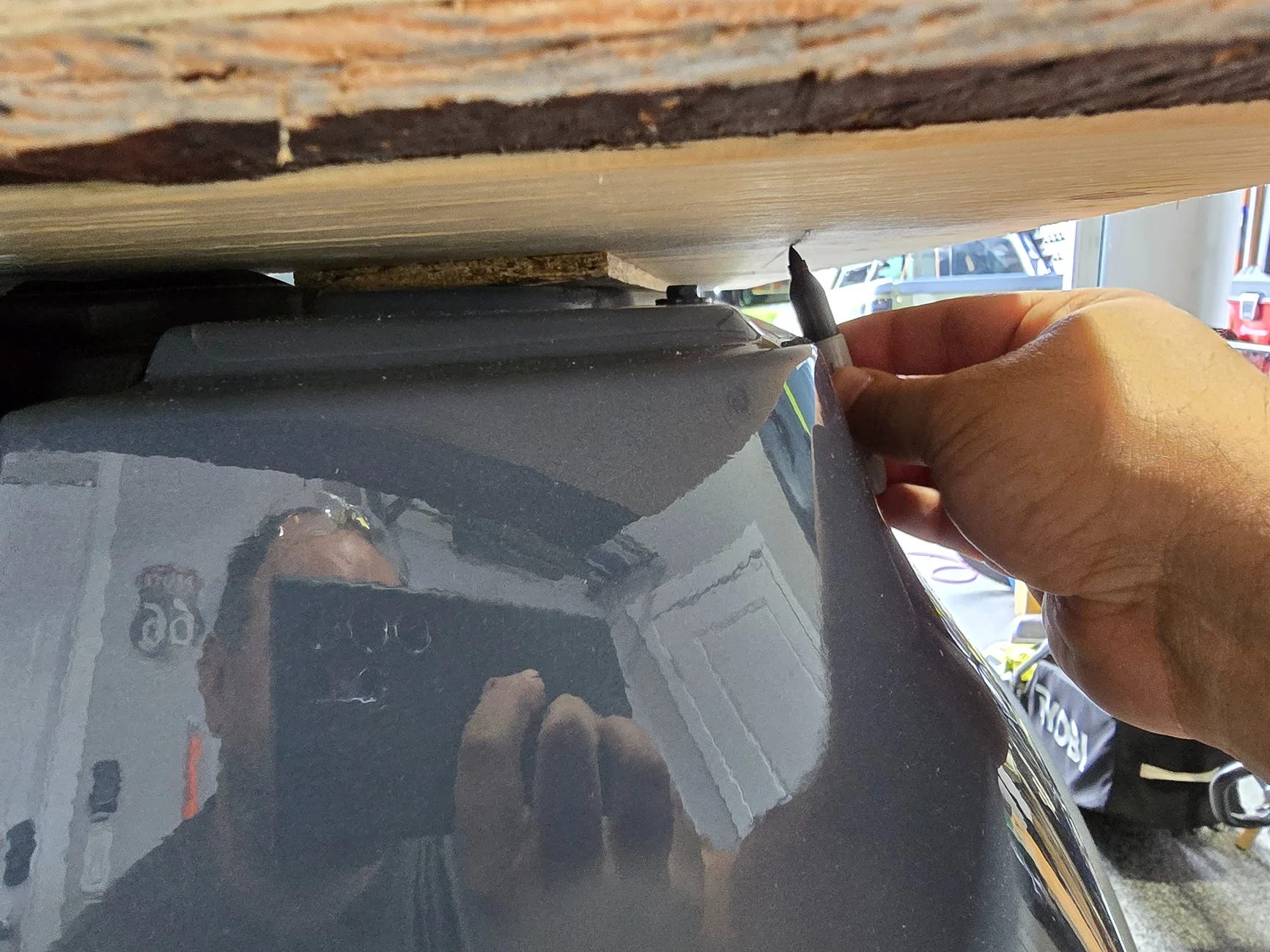

Then I traced the body lines on the underside of the plywood using a miniature sharpie
Ford Bronco Another DIY 2-Door Cargo/Tonneau Cover 1000035020

I really like the creative solutions people come up with for storage and covers. Yours is the first I've seen of this style and I like it more than I thought I would.
Couple of questions -
It looks like it is all open underneath. You can reach back between the front seats to grab something or access by opening the tailgate, correct?
Did you consider a hinged/locking access port on top? If so, what made you decide to omit that?
I would probably add some tiedown hooks and a small cargo net to secure things on top, when needed, but that's just me thinking about how I'd use it.
Thanks for posting the details!

Yes you can access the cargo area with the tailgate open or between the front seats. With the back seats folded up, it restricts access a little from the front (which is good in my opinion).
I considered a hinge for the rear most piece but range of motion would be limited by the speaker pods, so not very much benefit for the complications. Plus then its no longer two pieces and it wouldn't clamshell around the roll cage anymore.
I do plan to add some small tie downs to the top of it at the bolt holes but its such a long span for plywood that itll sag with too much weight. For now I have thrown my tops up there in the bag and that works well. Next year I will probably add either angle iron or a vertical divider to provide support against sagging.
